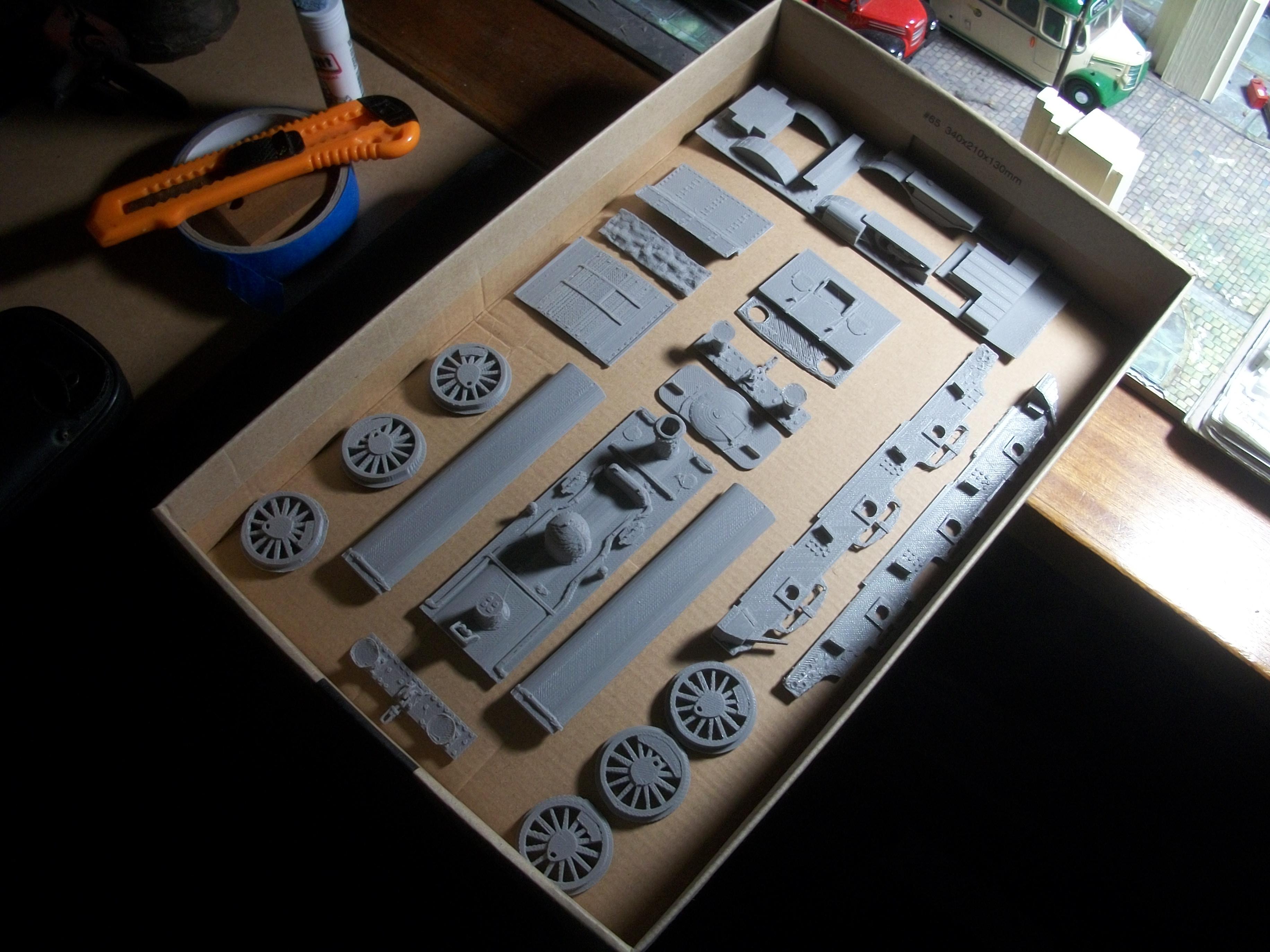

Having 3D printed the 34 parts that I need to get started on the assembly of this steam loco, in 14 days, work has commenced, with good results so far. As you can see from the following photos, the boiler underside part was not fully printed properly, so I measured and cut two pieces of thin styrene sheet to make the part good. The two side frame parts have been joined together using four spacers, for which I used super glue and baking powder. After selecting one wheel and one driving rod, I then applied some red oxide primer by brush to these few parts. For the top coat of paint I have purchased some Satin Black enamel, to be applied by brush over the red primer. The essential first step was to make sure that the frame sides are square, level and straight, so that when the three axles and six wheels are in place, everything will line up on top and this will also determine the track width. It seems the super glue takes a long time to actually ' grab ' the two parts of PLA printed material, but the bond is stronger later. This is one reason why I chose to use the baking powder to increase the overall strength of the join. David

I have just 3D printed 34 parts for my steam locomotive build in 1:43 scale ( O gauge ), which has taken 14 days over the festive period. David

Here are some recent 3D printed parts for the steam loco in 1:48 scale ( O gauge) . . . I can print two center wheels in 3 hours, then four non center wheels in 6 hours, and the main frame of this loco in 9 hours. David
