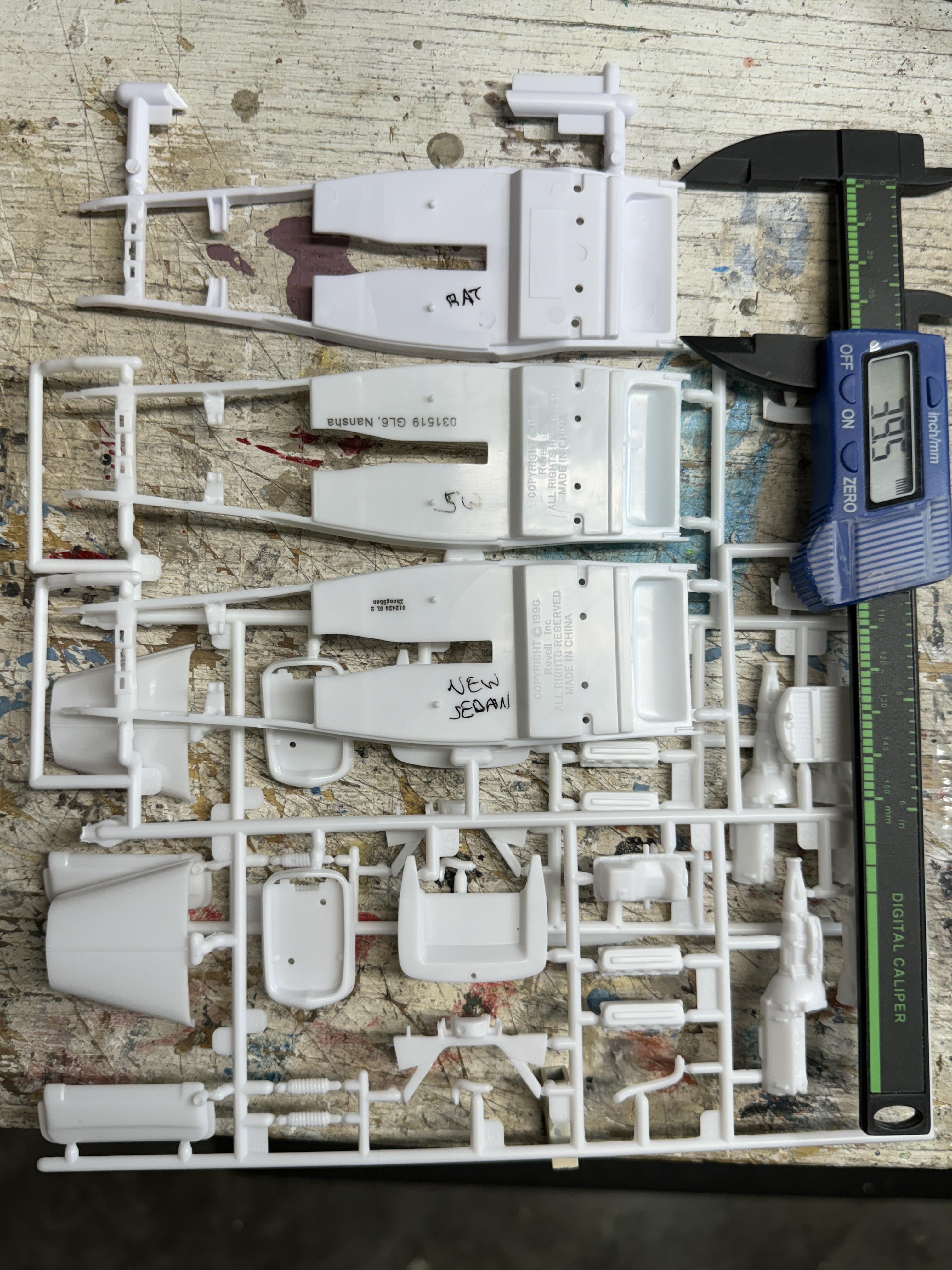

  6. @Dennis Lacy I just pulled some '32 frames and measured them with my calipers. Rat Roaster (AKA new roadster) frame, 5ive window frame and one from the new sedan kit. I took a measurement at the axle center line/exhaust attach points and all the frames measure the same. I also measured the 'hat' area front to back and they all line up widthwise. I wonder if the resin body is the reason for the fitment issues? I used the rat roaster/new roadster frame under a 3 window (RMCM resin) body and a sedan body (turned into a phaeton) and had no fitment issues in that area....strange... -RRR
