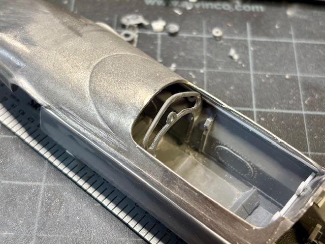

  1. The low temp solder used in the Lotus 25 build was applied along the seams - it didn’t flow well into the seams - gaps - but i manged to apply enough solder to secure - i think - the seams …
  2. I’ve “re-skinned” the monocoque - this was actually Lotus’ first full monocoque design - to make more accurate rivet lines … i can add the rivets later - probably the Archer rivet lines decals - when i put the build aside i had gaps that i couldn’t bond well along the top/bottom seams …. Gaps that would surely open at the wrong time - like after i had finished the paint …

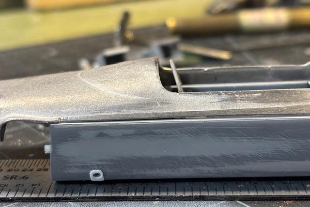

  3. The nose needed some surgery - cut apart and put back together following 24th scale outline drawings made by the late Bob Clidinst - but putty shrinkage has left me with some surfaces that are relatively flat - needing correction …
  4. I had put this one aside years [and years] ago - Matt Bacon has posted a number of White metal kit builds - but not the Lotus 38 Clark Indy winner - its getting a little hard to find/buy like the other Auto-kits open wheelers - it’s a curbside - i’m going to apply some new found - thanks Matt - lo temp soldering skills - and i’ve got the engine …

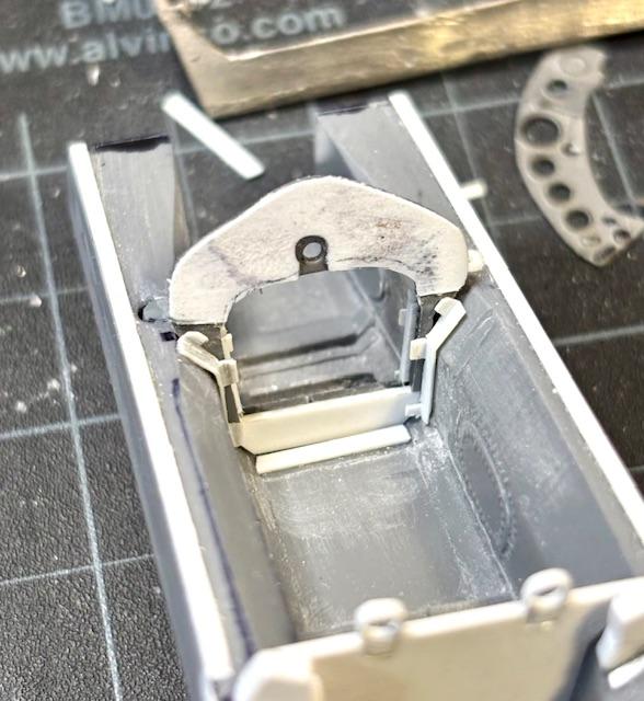

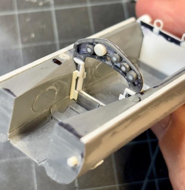

  10. Gear selector casing with frame plate and added bolts and a reverse gear lock-out clip … dress in should work for the shifter …
  11. Some additional changes to make a decent engine mounting on the bottom frame members …
