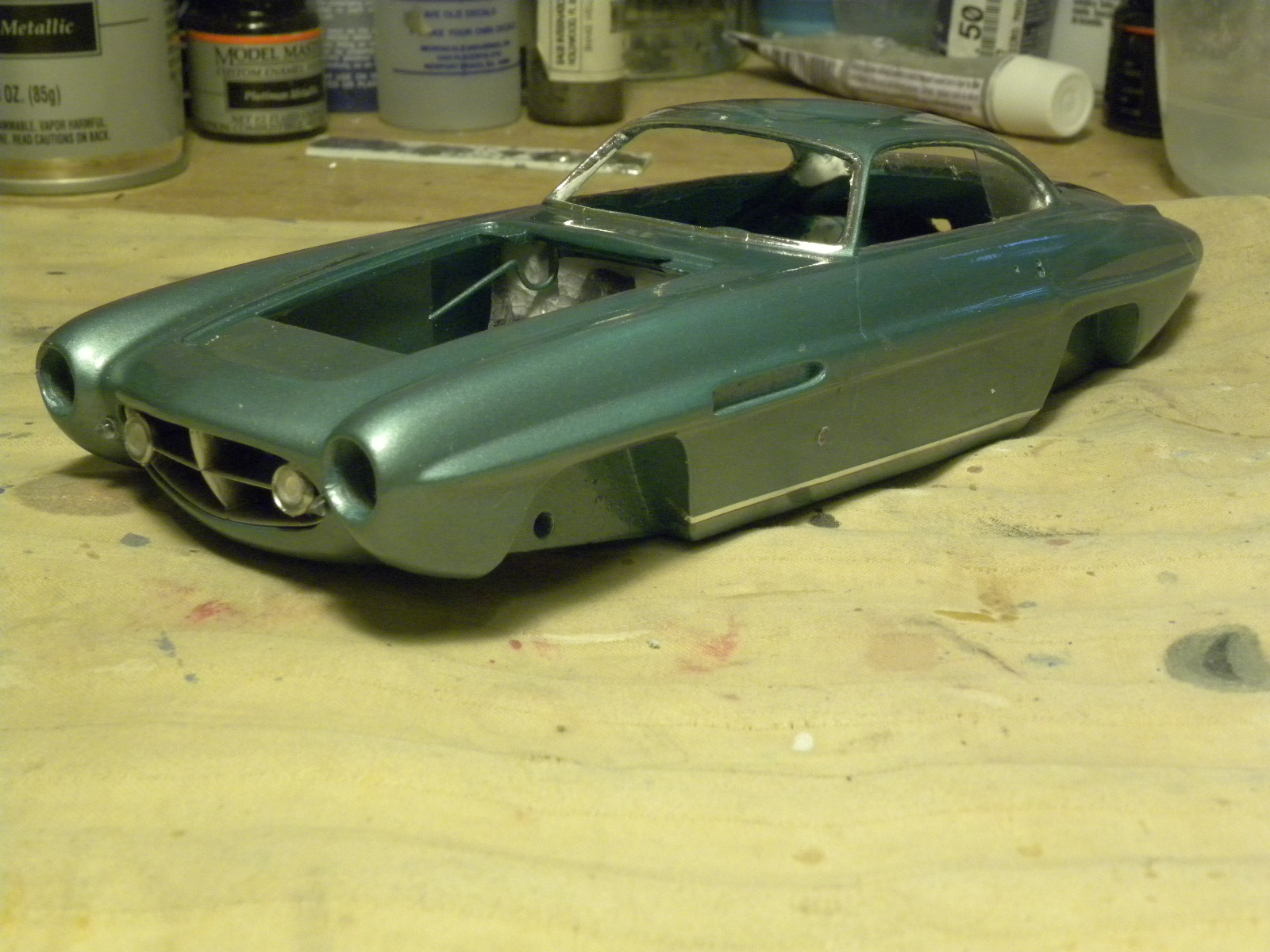

  7. Your models were made from two different materials. The COE was made from what they call SWF - strong white flexible - I think they have changed the name recently. It's finish is rough and "sandy" and requires a lot of primering and sanding. It can be finished well with a lot of work. The Ferrari was made from a high detail material and is much higher resolution and the material is much easier to finish but is more expensive, and it's worth it. The file size does not matter if the digital file is well made and detailed. You can print a 1/43rd model or cut out a 1:1 master using a CNC machine.
  8. This was printed by an Atlanta area 3d printer, and he will print one for you for $150 plus shipping. PM me for details. Engine and engine compartment are included.
  9. I used Sketchup to modify the file for 3d printing. The file for the body was obtained elsewhere, PM me for details.

  18. It was on the project table at out show, I'm having trouble making the yellow decals for the fenders; as well as working on another project and moving my model building shop from my unheated basement to guest bedroom. I have tons of time in it and will finish it.
