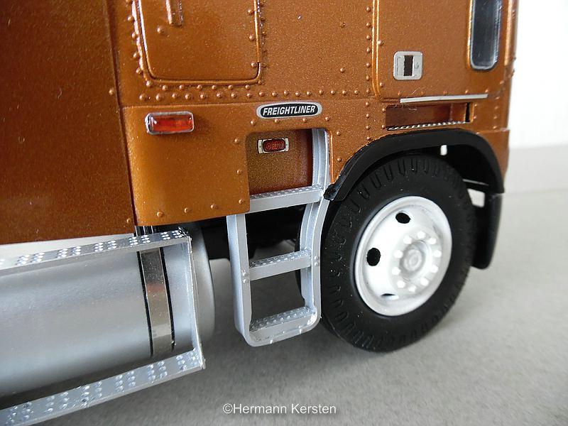

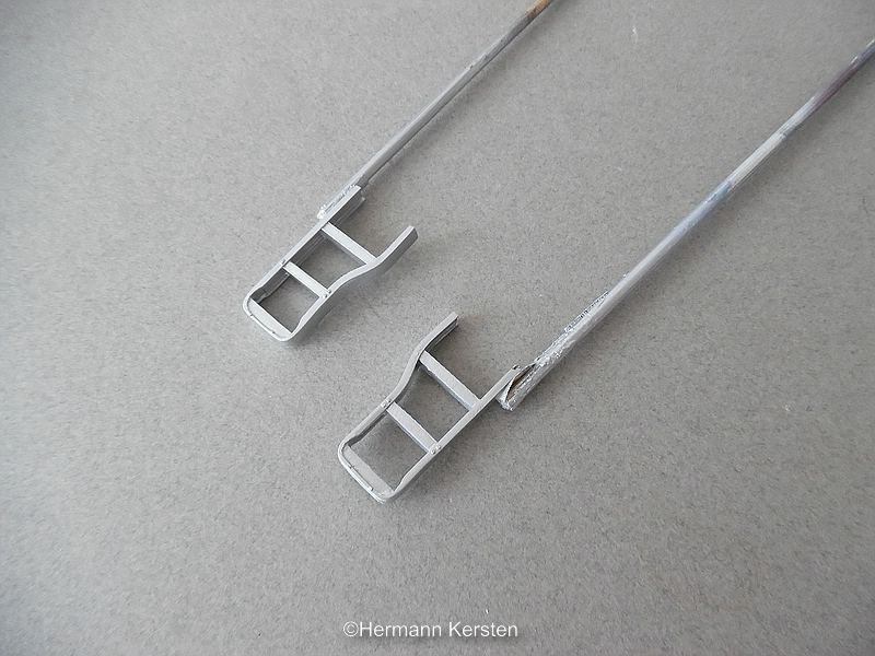

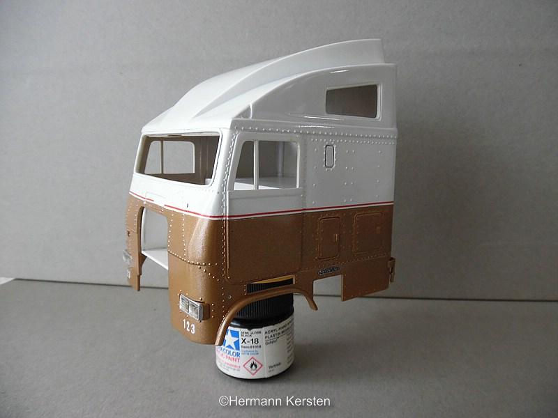

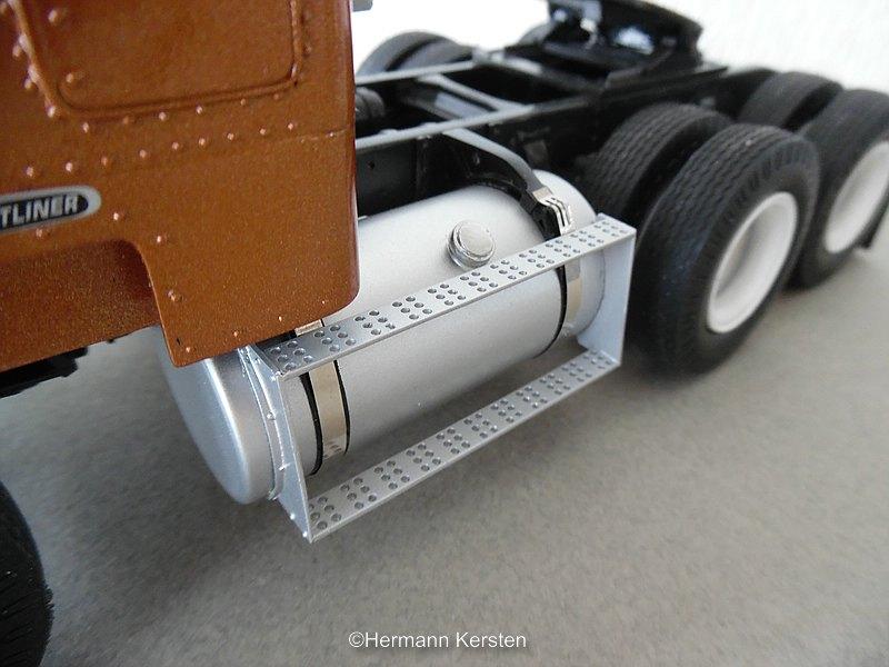

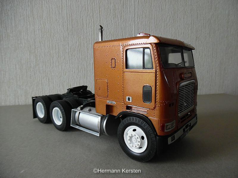

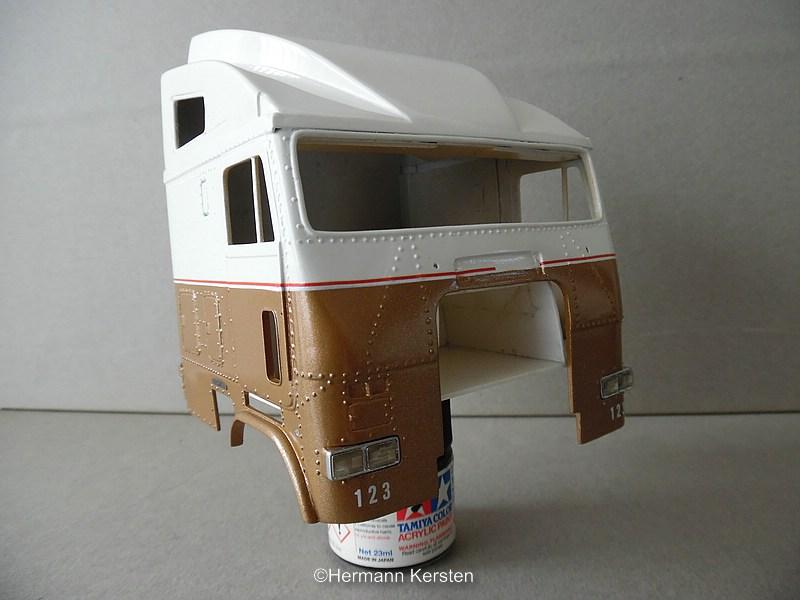

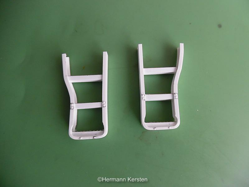

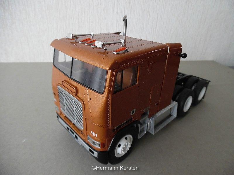

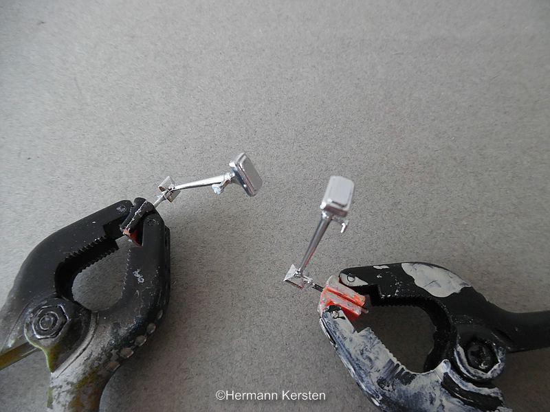

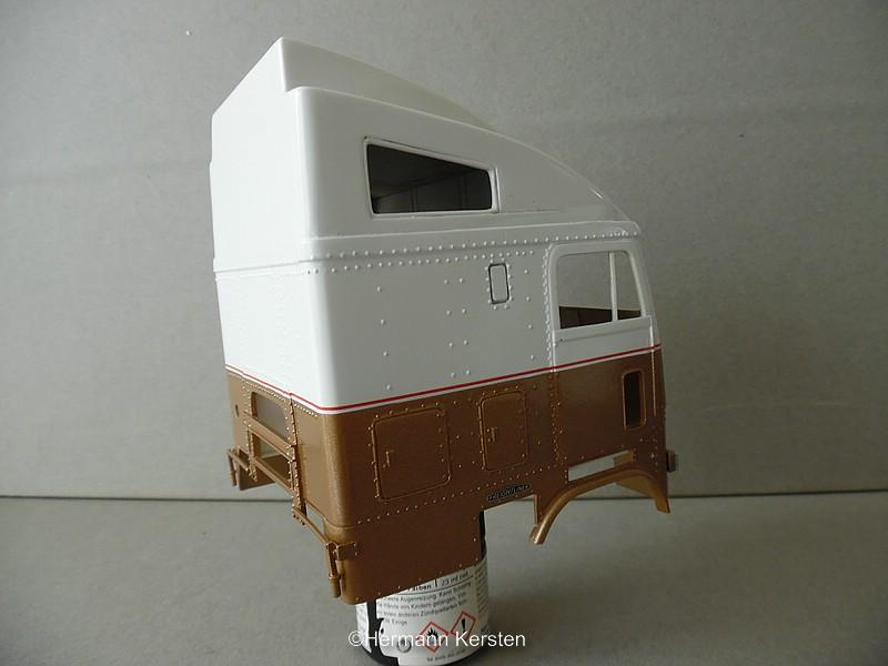

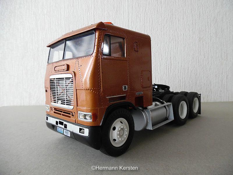

Thank you guys! Well gentlemen, I'm in the final stage of this project. I finished the steps of the cab, and attached them to the cab. Now all i have to do is make the mirrors and wipers. Before these can be mounted, I first wait for the 2nd set of decals from Jerry, these are already shipped, and if these cab decals do fit and are on the cab, then I can finish these last things. For now, just a few pictures of the progress of this conversion. For the steps I used a polystyrene U-beam of 4mm and sand the corners thinner, just like the real one, and finish the frame with some rivets. Then bend it with hot water and glue the first step , which is rounded at the edges, with a squeezer and from here the other steps. After the paint job attach them on the cab with this as the result...... Then attach the air horns, which have been edited with the chrome marker, and stick the side fenders on the cabin with a piece of tape for the overall picture. These side fenders are only placed definitively when the decals and mirrors are mounted. So, now just finish the last parts and the cab decals! See you later! Hermann.

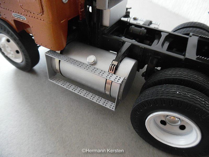

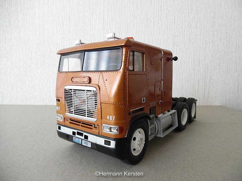

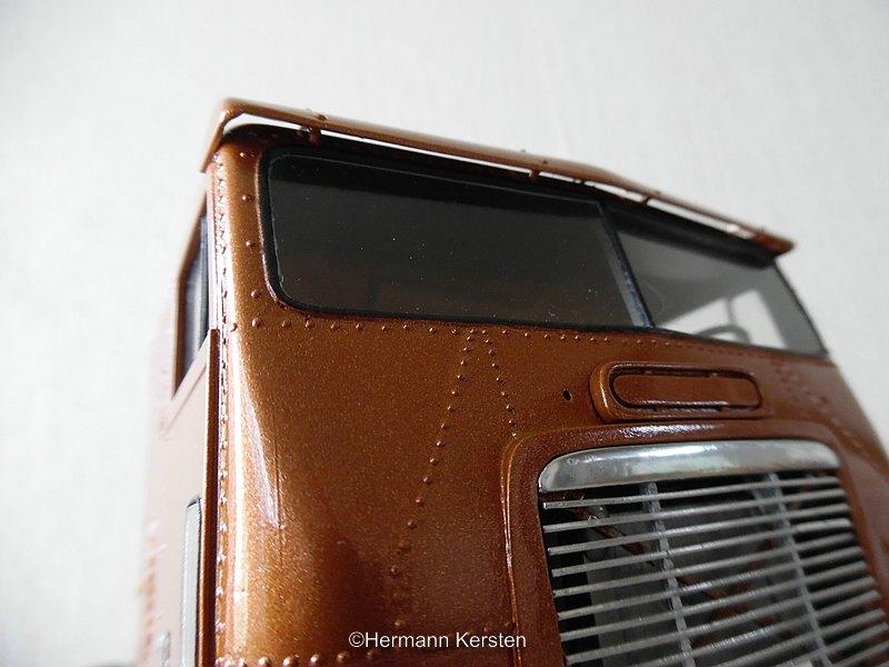

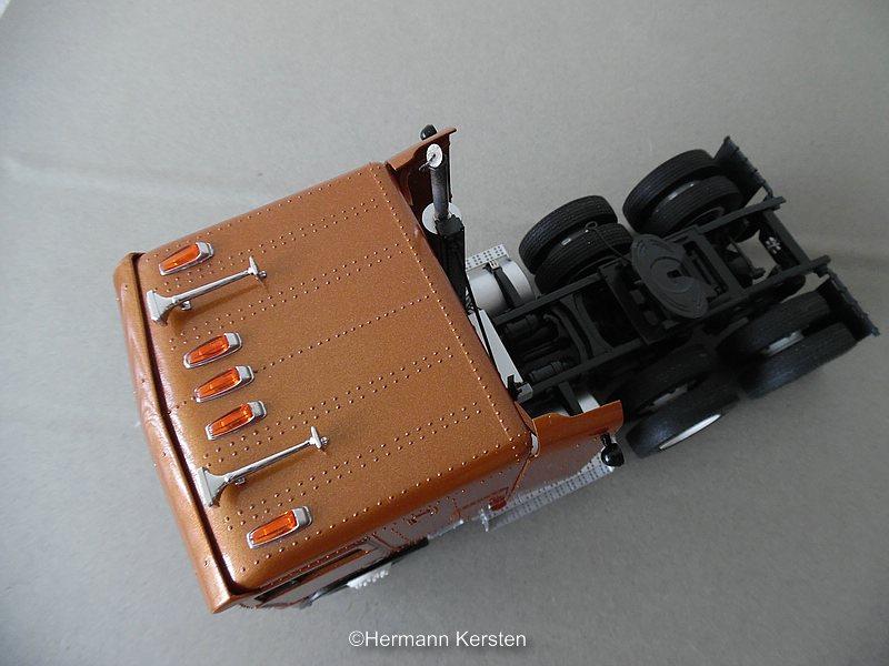

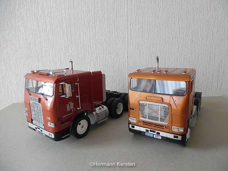

Hello everyone, So...I started with the small and time consuming details to get the FLB done. First I changed the air horns of the FLD kit somewhat so that they would be a better fit in this 1/25 scale. Again the rectangular, like the FLA, because I find this a nicer fit to this FLB than the round ones. Edit everything with the well-known chrome marker and let it dry for a second layer. Also the steps that will be placed on the sides of the cabin. The boxed areas in which these steps are will be glued are already attached to the cabin. Then the intensive job of the sun visor. Now that I was working on this sun visor, I made a 2nd one at the same time and sprayed both sunvisors in the correct color and attached it to the FLA and FLB cabin. Then I scratched the steps of the fuel tanks, in this case I chose a version chosen that will be almost have the full length of the fuel tanks. With the reference photos, styren, and glue at the ready, these steps are the result. Well guys, I only have to make the mirrors, a pair of wipers, an antenna and some finishing touches here and there. That's it for today and see you next round! Hermann.

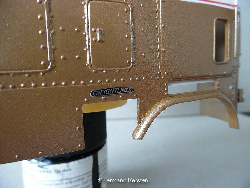

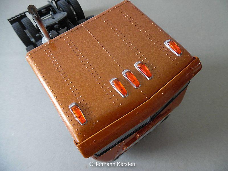

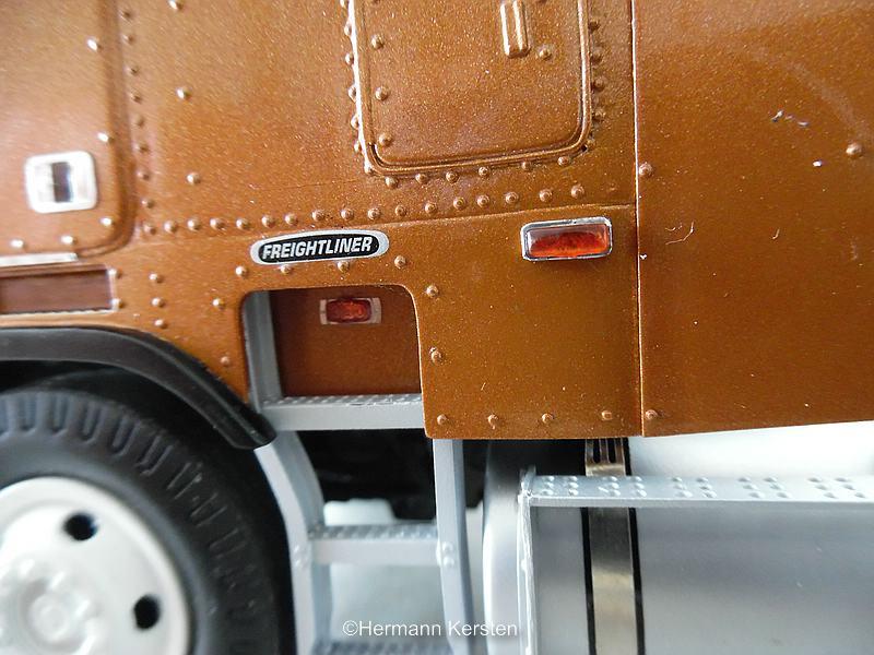

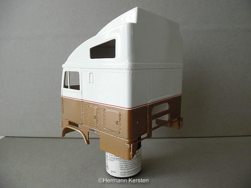

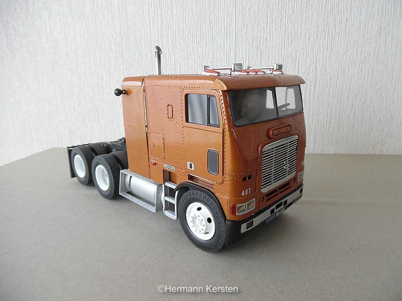

Thank you for the comments guys! Yeah, after I painted the cab in the 2nd color, I sprayed the clear coat on the cab. Let it rest for at least 2 till 3 weeks so that the clear coat could harden. In the main time I received the decals from Jerry, I started with the first white striping what is on the edge of the white and dark gold color. After the white striping I put the red striping on the cab, because in my opinion this is a nice nuance between the 2 colors, and gives a nice contrast. Later the 3 or 4 white stripes will be done on the lower dark gold part, with different distances between the stripes. First I made 2 side fenders, which are at the front corners of the cabin. Later I will see if these fenders get the cabin colors, or if I make them completely chrome, I'm not sure yet. Then the result so far..... The CTM Freightliner emblems.... The shine of the clear coat.... And the rest. Yep, that's it for today guys, see you next round! Hermann.

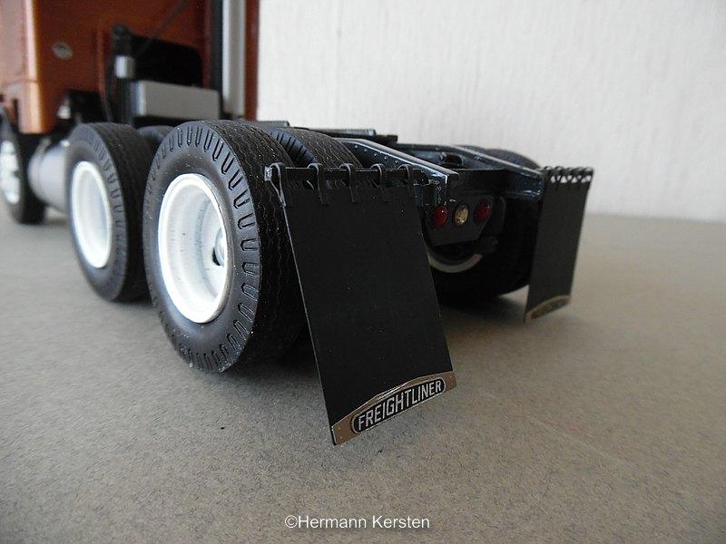

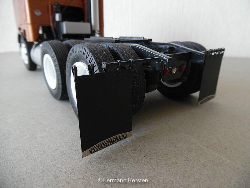

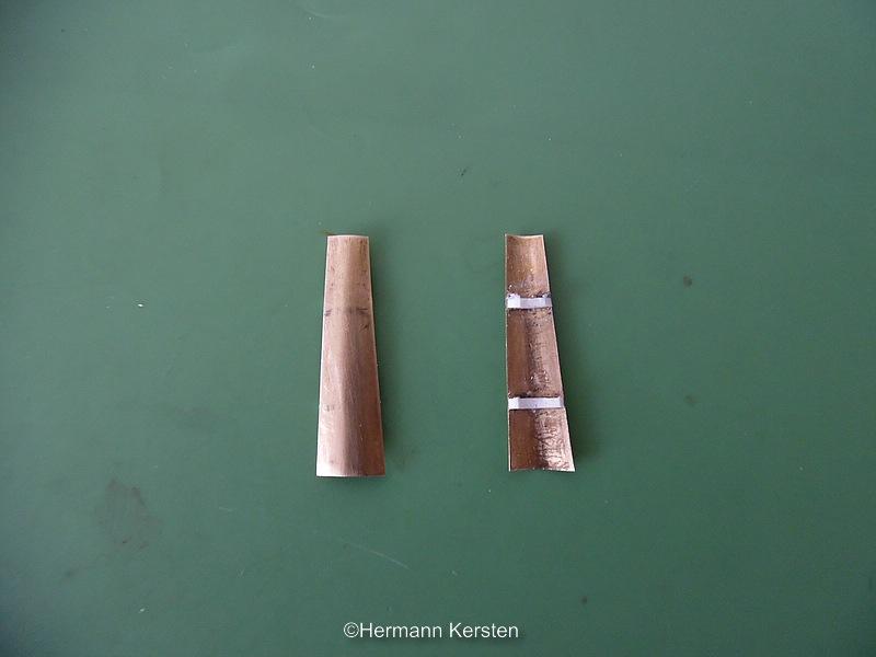

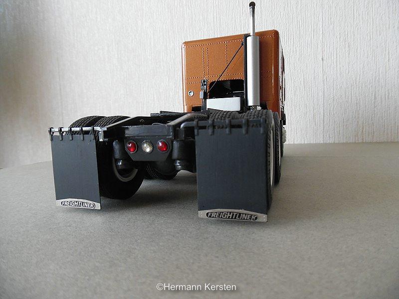

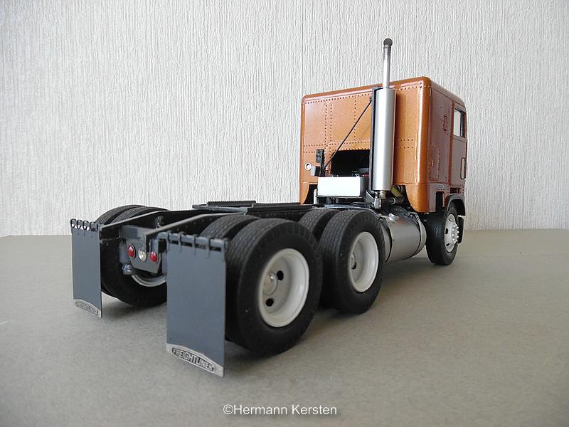

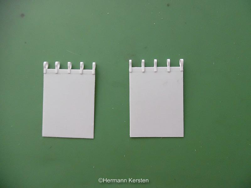

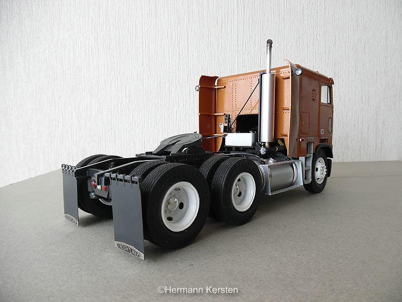

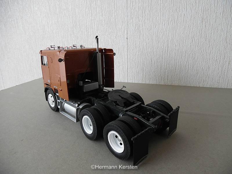

Hello everyone, Today a small update of small details. We start with the construction of the mudflaps. After a lot of searching and looking at pictures, I saw that many different mud flaps are or were used, or even not at all, with this FLB. It was a bit of a choice and I finally chose this kind of mudflaps. They are the so-called, self made "Dummy Proof Mudflaps" . What do I mean by this.... well .. the mud flaps themselves are not glued, but simply slid onto the loose holders. In the event of accidental bumping or tapping, these mud flaps will not break off, but simply move with them, so that you can always push them back into the correct position. We are all familiar with this kind of si"mishaps", and I have already had it happen to my self. To start, I cut 2 mud flaps out of a sheet of styrene from 0,30mm thickness, and made the separate loops from 0.25mm x 1mm polystyrene strips. Then made from square tubes 2 supports and glued them on the chassis, then the square mud flap holders, which are cut to size, bent into shape and sprayed in the gray paint, are placed in these square hollow supports ... not glued, but just placed loosely. From the Freightliner CTM set, the weights and Freighliner emblems are glued at the bottom of the mud flaps and with a test I show you all how this all works. The mud flaps can move forwards and backwards, and can even be completely removed from the mudflap holders. The mud flap holders can therefore also simply be removed. Then the the steps which are detailed with perforated plate and place the Freightliner decals on the side of the cabin. The front wheel arch rubbers are now also painted black. And a few license plates from Jerry . And now the final touches to this Freightliner such as, mirrors, horns, wipers, sun visor, some decals and striping and some other small stuff what I have forgotten right now to mention. This was it for today and see you next round! Hermann.

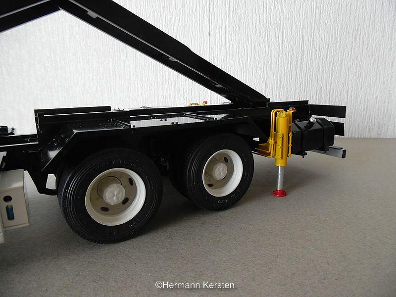

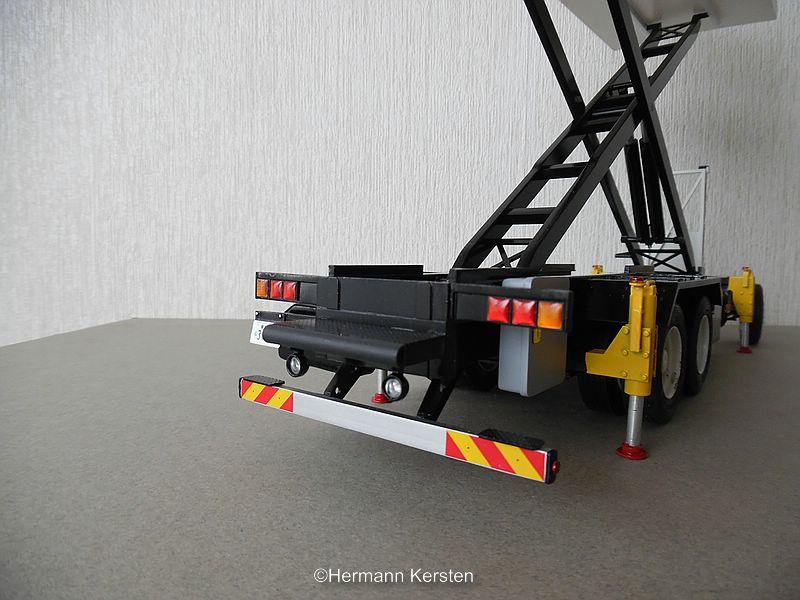

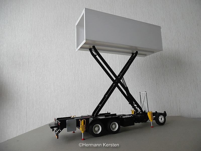

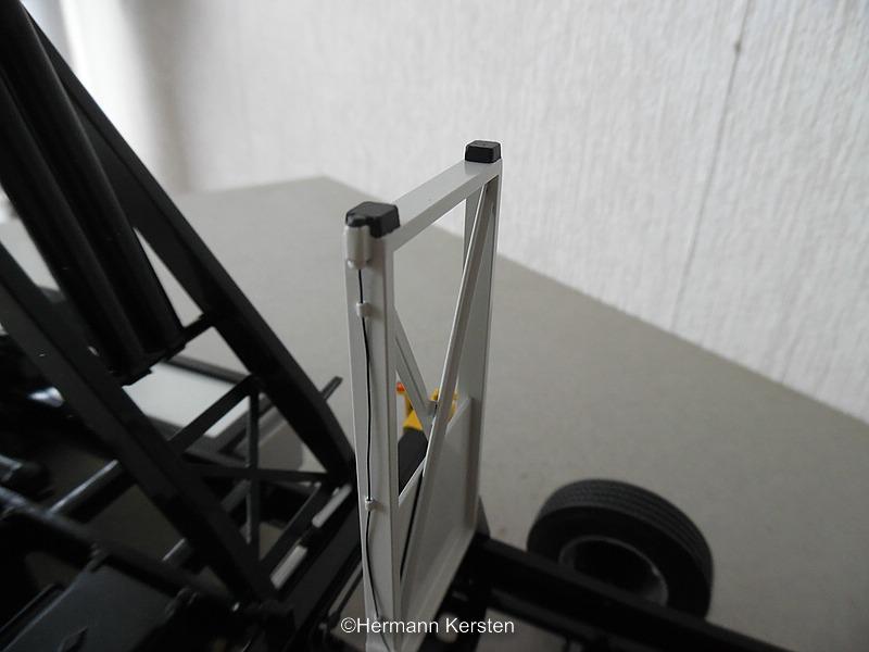

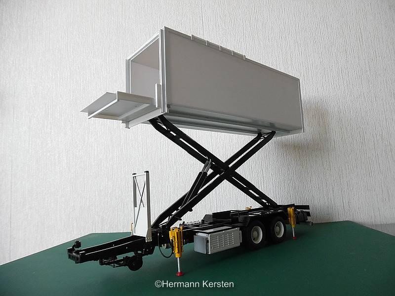

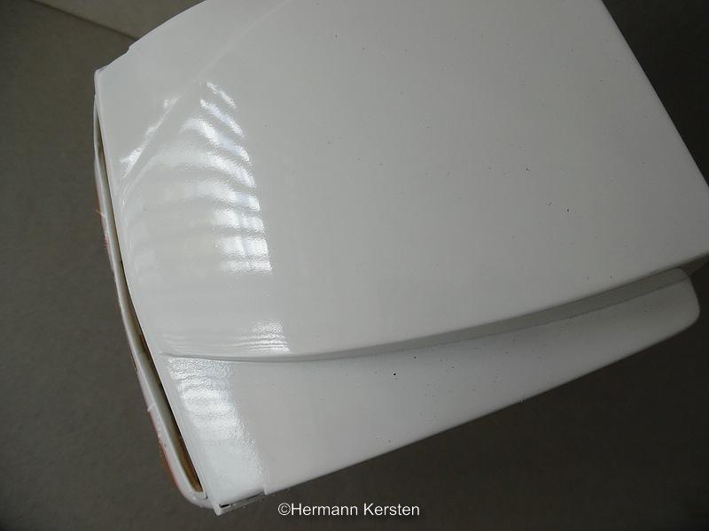

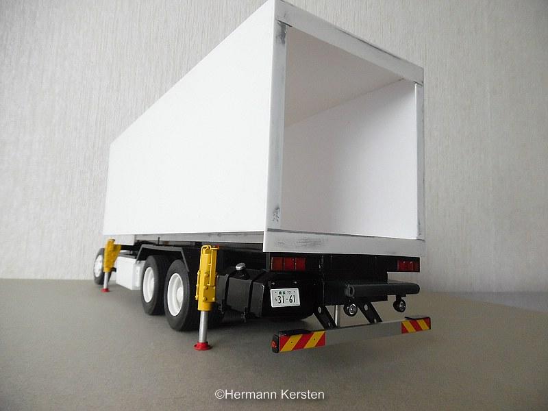

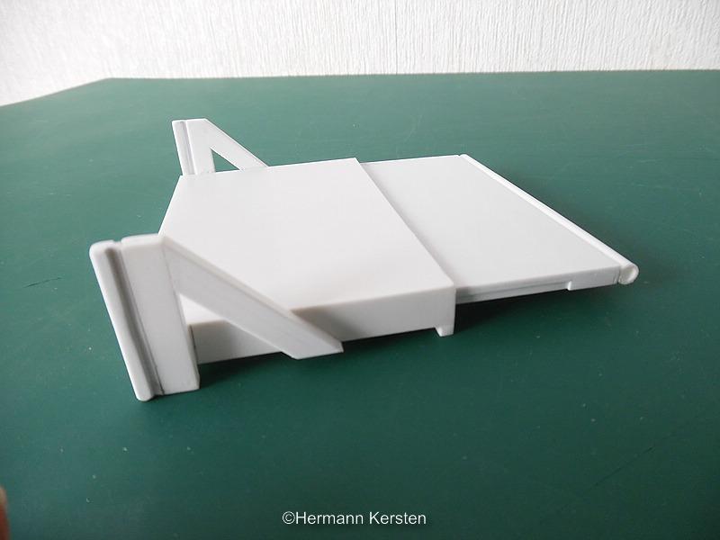

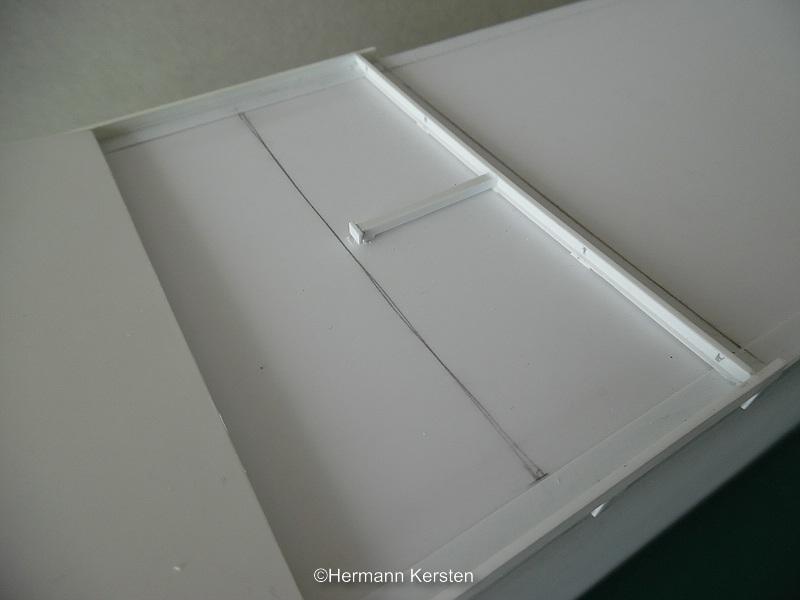

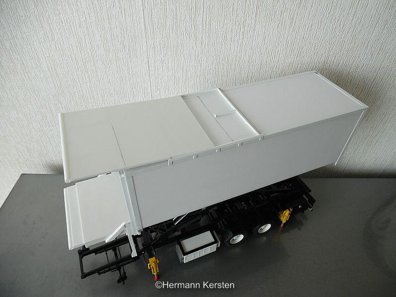

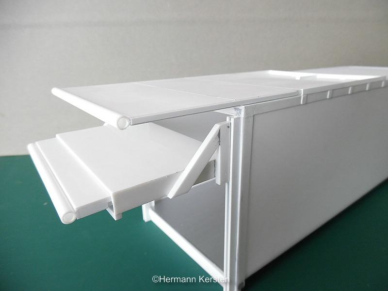

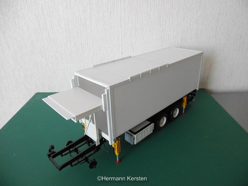

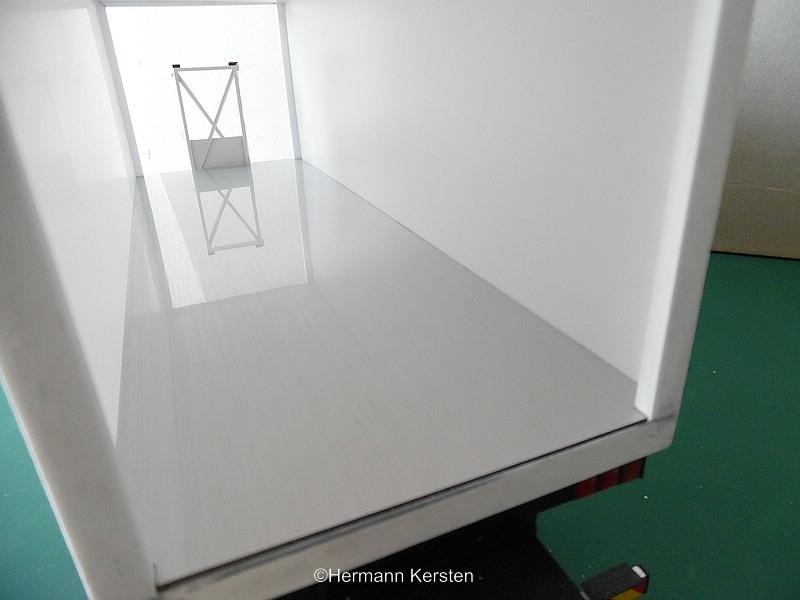

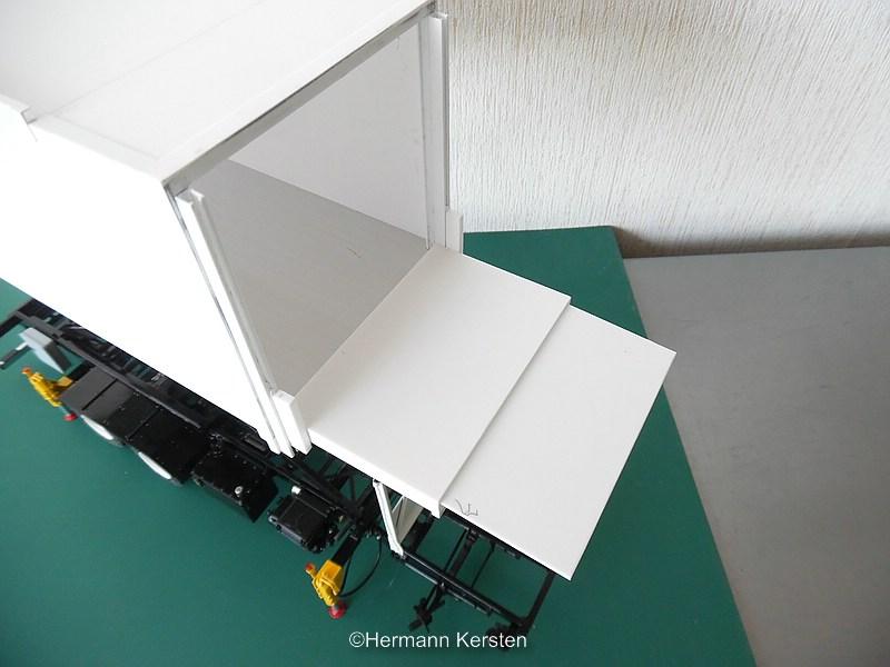

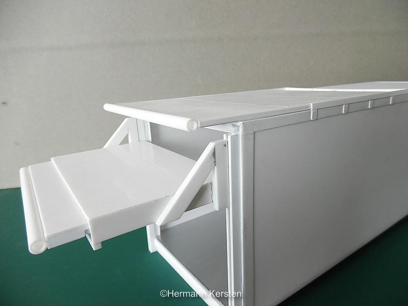

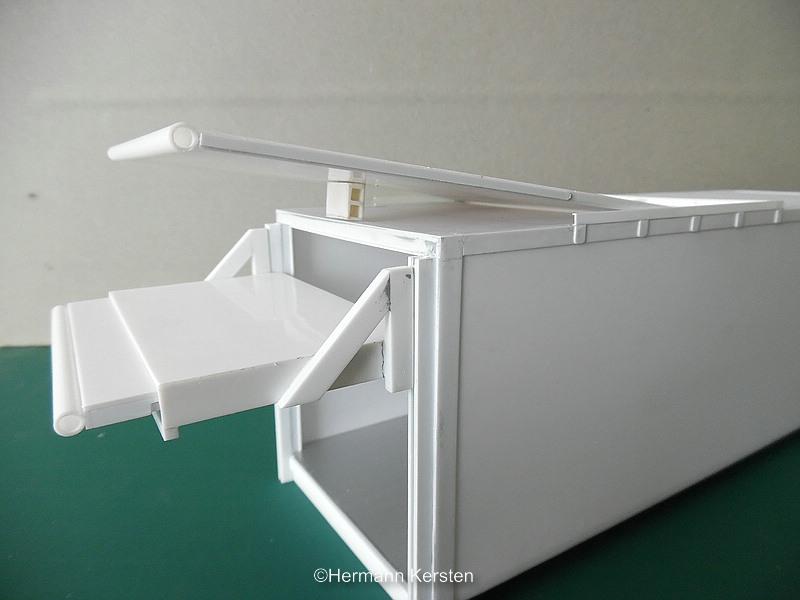

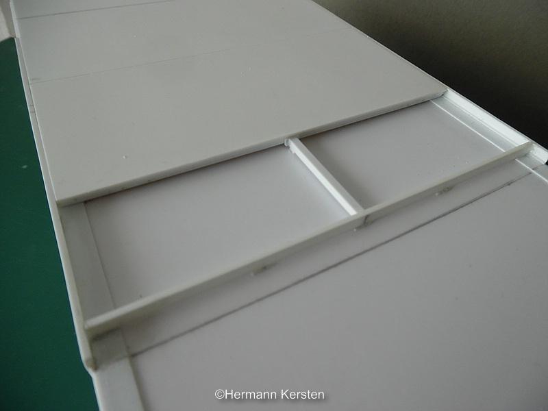

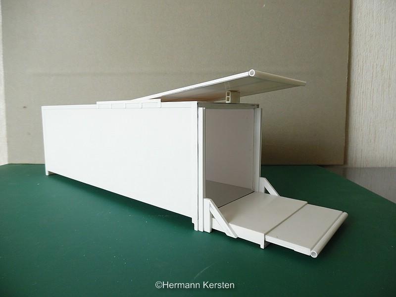

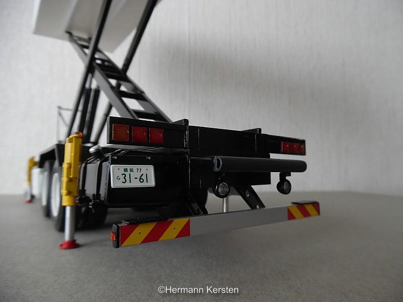

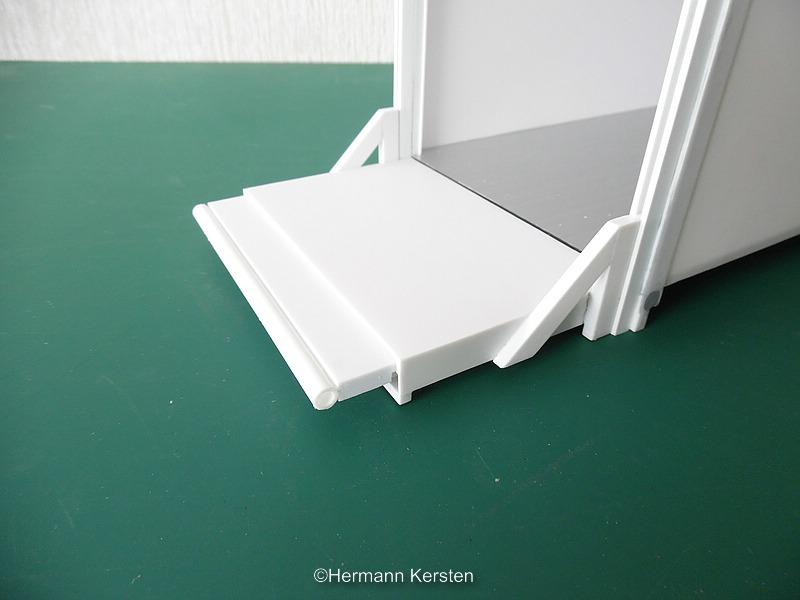

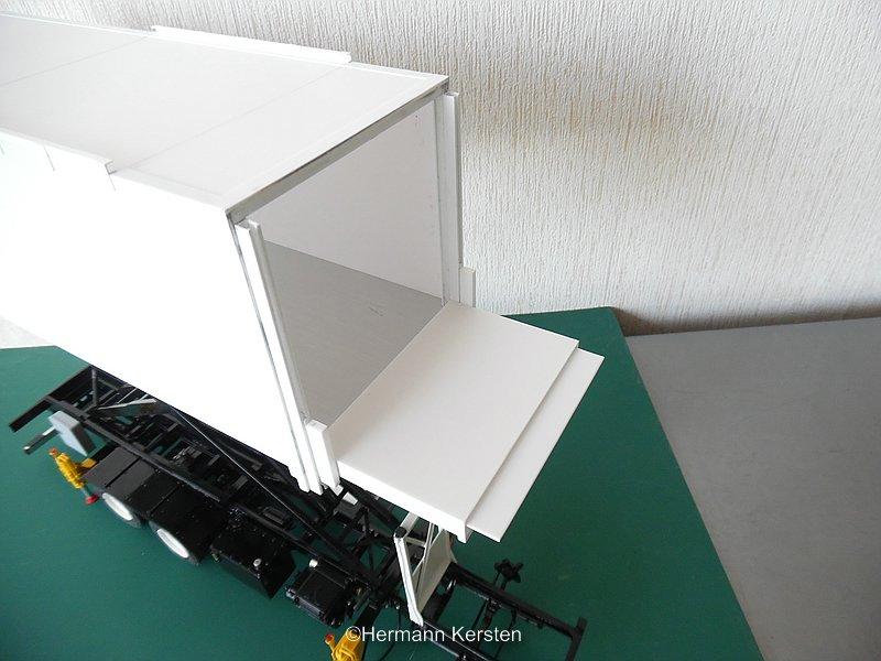

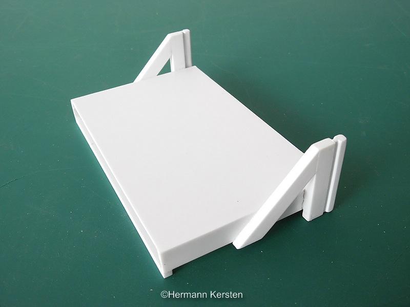

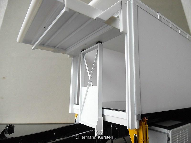

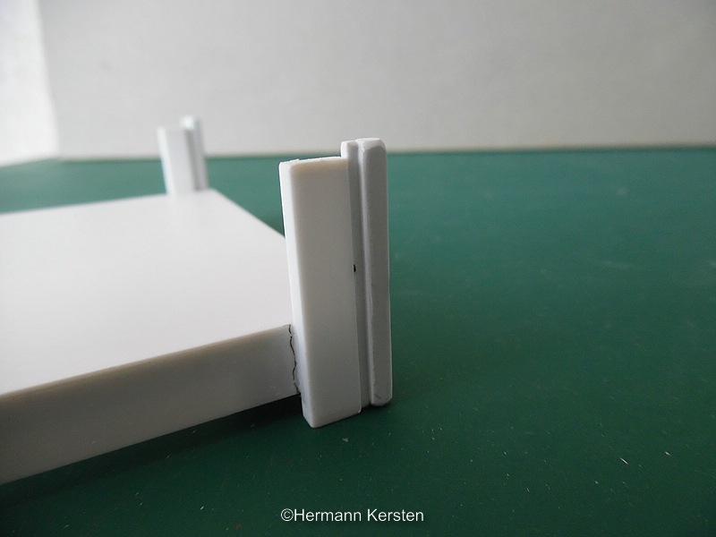

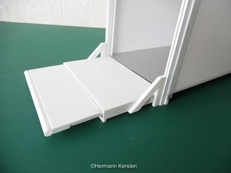

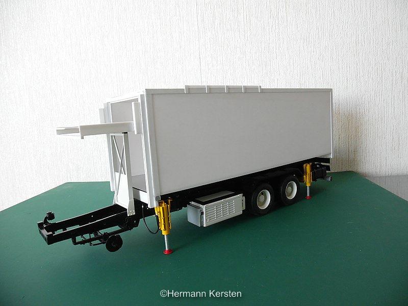

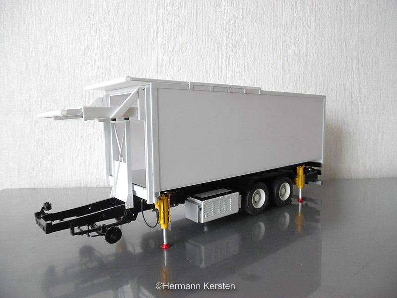

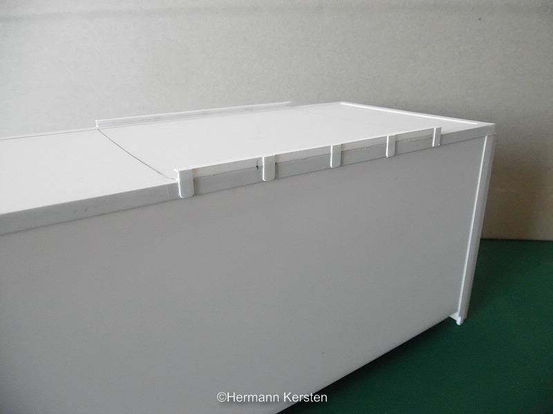

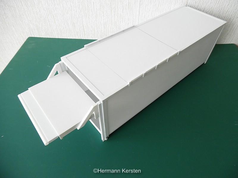

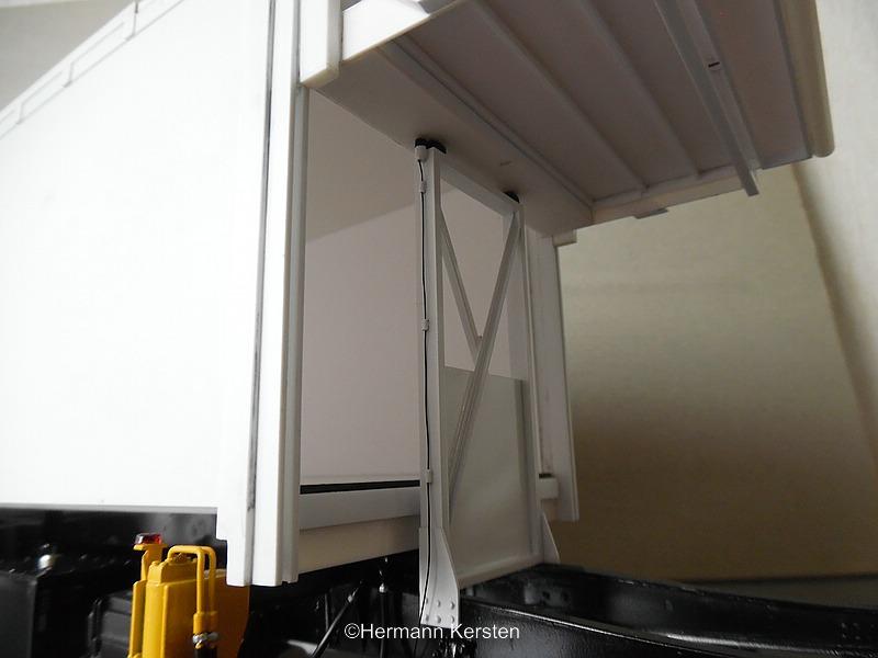

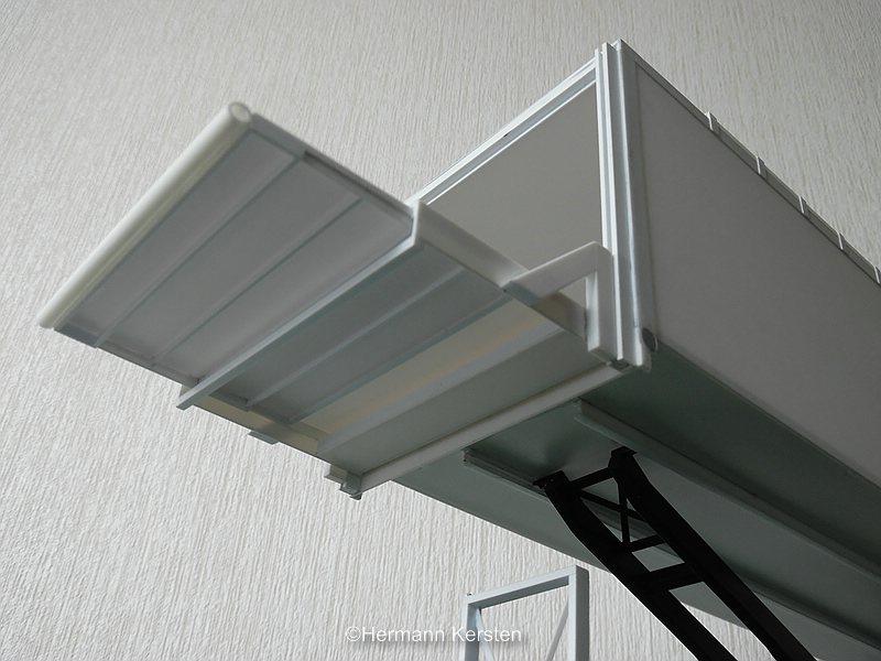

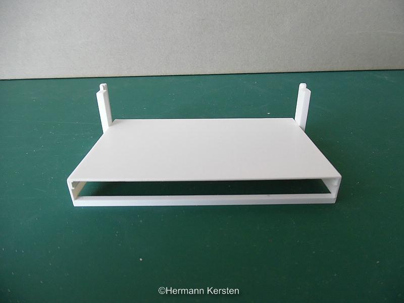

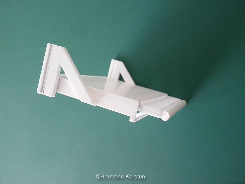

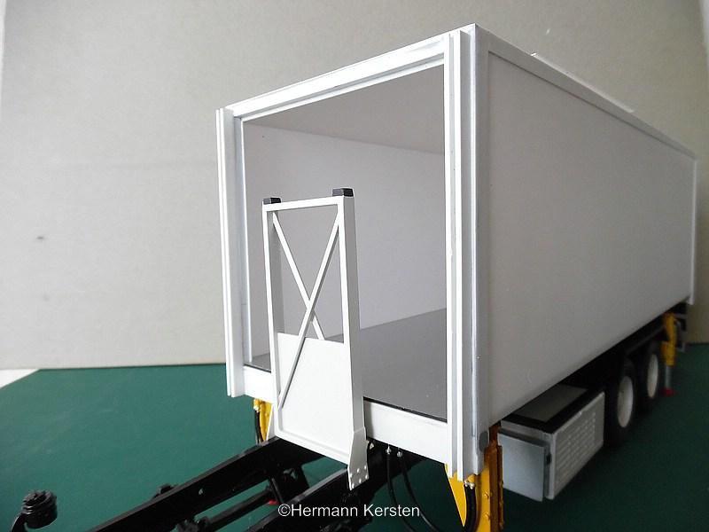

Hello everyone, Today the progress at the front end of the Van-Body. In the main time I finished the movable floor and after that, the extendable roof cover. First I made the sliding supports and mounted the floor on it and made the reinforcement parts on it. The rubber on the front of the extendable floor plate just had to be round, just as it will also be the same with the extendable roof later. Then the extendable roof which later there are 2 hydraulic cylinders will be made on the front rail, which can push the roof up a bit. This is to be able to follow the curved line of the aircraft fuselage, and the worker is currently protected from the elements of the weather and the hot sharp sun, as there are countries where 30+ degrees is very normal every day. And the upper position, which I use a piece of styrene for the main time for showing how it will look like. At the back is a stopper that stops the roof, I had seen this in several preference pictures that this was done in this way, and later there will be made a tube, from the other side of this stopper to the back of the roof, with some wiring in it. Then a threshold to keep the movable floor at the correct height.... And the support which I made again, which has now become 5mm higher, and has been brought to the correct height. And all together so far.... That's it for today and see you next round! Source Hermann.

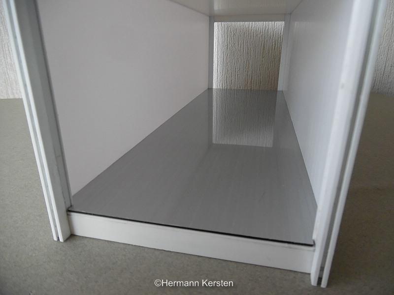

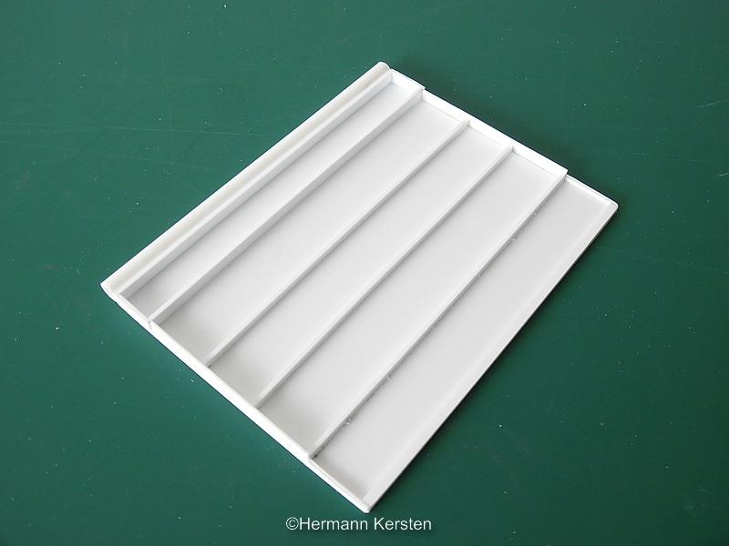

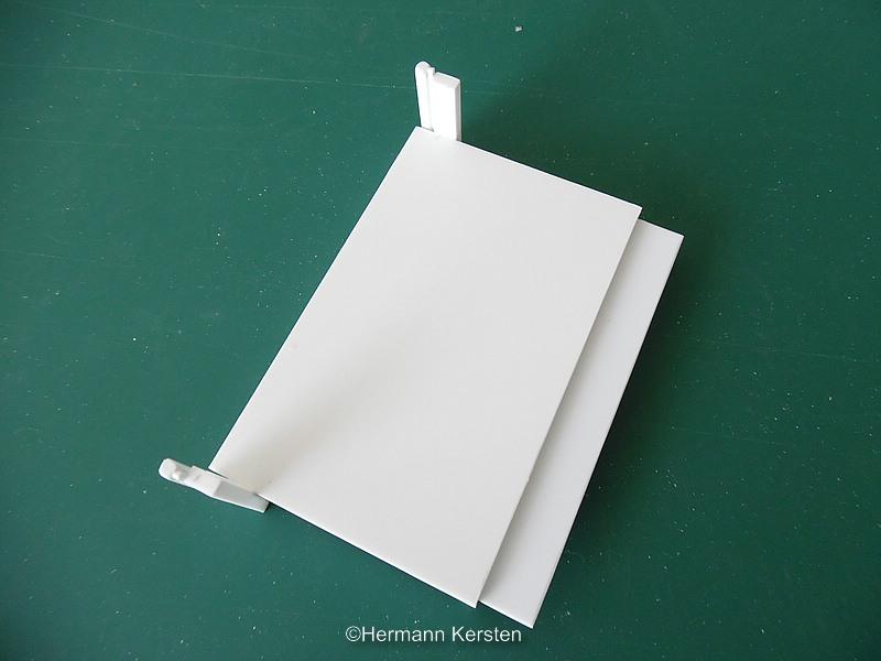

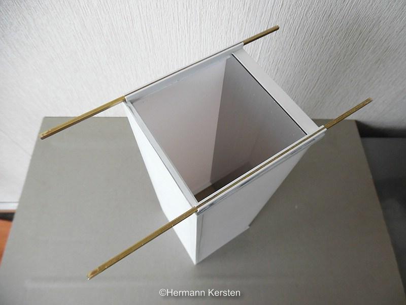

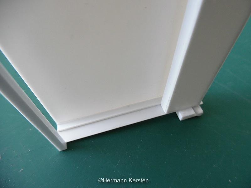

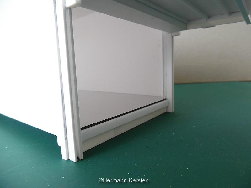

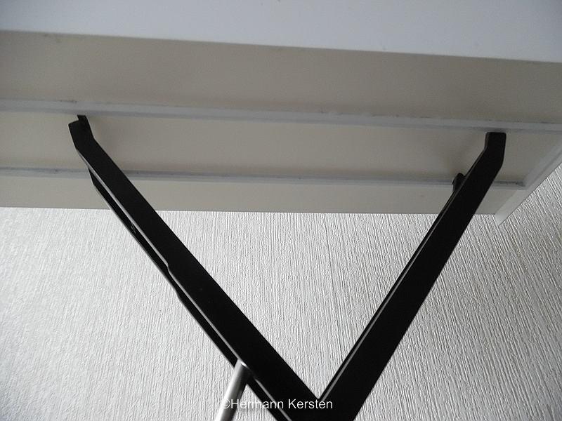

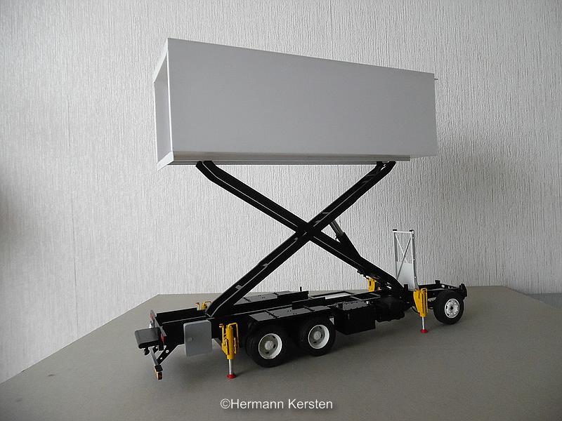

Hello everyone! Yeah, today some more progress, some small things and some big things. These days I'm very busy with the Van-Body, Now I don't pin myself on 1 specific box, because with the JAL / TFK group there are many different types of Van-Body's, older and newer. This Fuso is mainly one of the earlier versions that was and is active at the Jal / TFK group. First I made the rails of the front, in which the movable floor plate will hang. This was built around 3.2mm brass profiles, so that this job is done nicely and above all, absolutely straight. Then the reinforcement strips on the corners of the box and a styrene plate with an aluminum foil on the top cut to size for the inside floor. I had bought this styrene sheet once in the past, and after a long time no using, now it comes in handy. In the photo this plate shines a lot, but that is due to the light and the macro of the camera, in reality it shines a little less. Then the 2 rails on the roof, where on later term a large extendable plate will be build and placed, which completely covers the movable floor plate, against rain. These rails are also built around brass profiles. What now also becomes clear are the small details on the frames of the box. At the front, the bottom of the strip has a cut out, because the support leg must move freely along this strip. Now on my model this actually exactly the same situation. First with retracted support leg .... And with the support leg extended .... Then the construction of the movable walkway. This bridge has a second bridge that can be extended, because these caterers are never touching the plane, but stay a bit off it. With this extension, the distance from Van-Body to aircraft entrance can be shortened to 12cm. On the inside I made 2 rails with styrene U-profile in which this floor moves. And 2 sliding supports that hang in the rails, and the bridge can move freely in these profiles. And now some pictures of how this looks and works so far. It is now starting to become quite a large model. The fun only gets more, because until now it has all been fairly smooth and easy. I also quickly ordered a Fujimi kit from a Hino dump truck. This was the last kit, because supplies from Japan are not yet optimal, and this Hino was also sold out at the hobby shop in Japan. Fortunately there was a shop that still had it ..... the last one ..... waiting for me. From this kit I get the rims because they come more to the reality of this Fuso than the rims that are now underneath. I had checked this with the Fuso car transporter, which I also have, and in the Hino kit are the same rims and tires. The tires match perfectly in terms of size, because these rims and tires has remained a small dislike for me until now. A project will be made up for the Hino later on. Also, I am not entirely happy with these 3d printed rims, it takes a lot of time to get them smooth, because the roughness is through and through and there is no use to sanding them. So you have to work with filler and after the final layers of color the details are a bit to fade, because of the many layers. For this kind of stuff Resin is more preferable for me, or in my case, the right rims of a kit. Well guys, this was it for today and see you next round! Source Hermann.

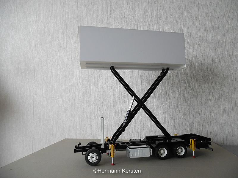

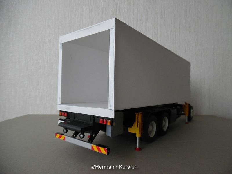

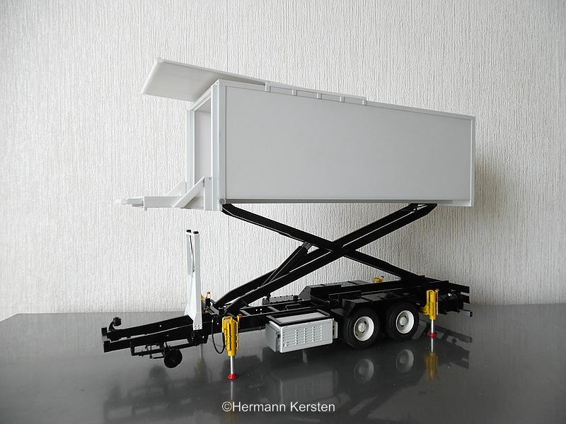

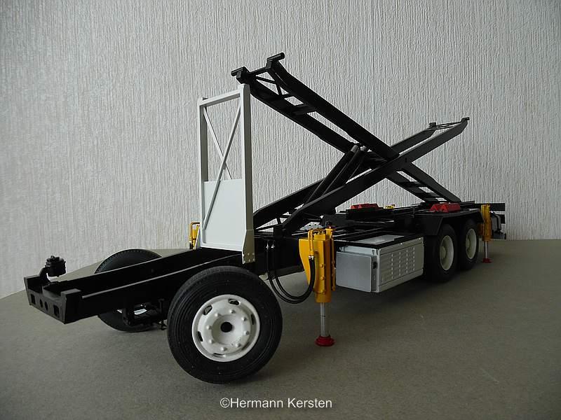

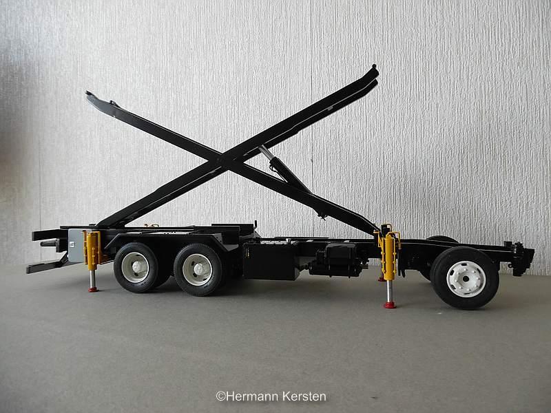

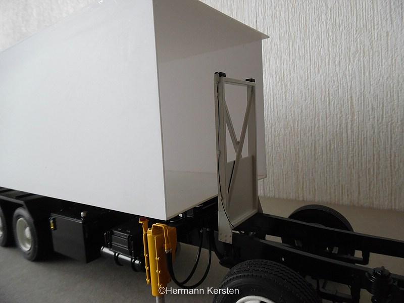

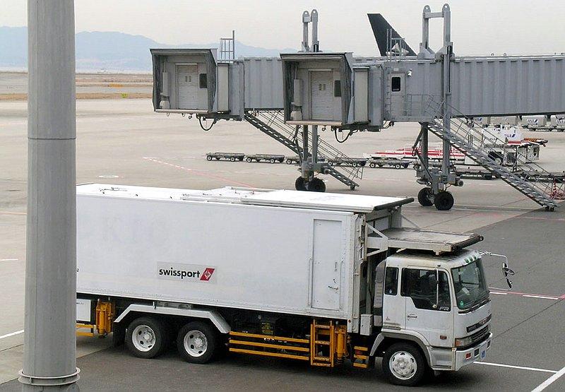

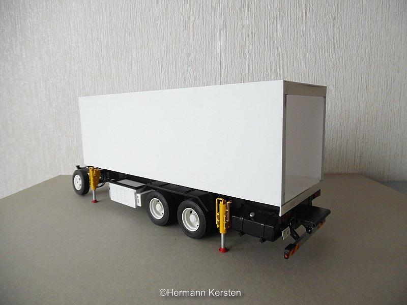

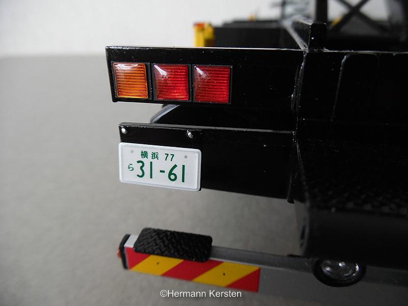

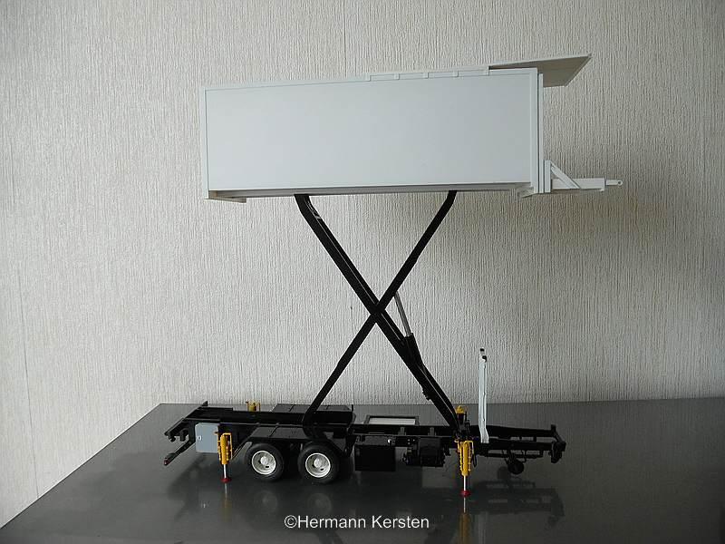

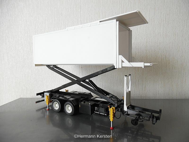

Hello everyone, Today the start of the Van-Body. After viewing the PDF of Doll GSE, it turned out that I was quite good in terms of sizes, this means that with the length of the catering box, in this category, I had enough lenght and the height would also be quite right. The Van-Body itself is 2400mm high and on the chassis together with the scissor lift I get pretty much the sizes of Doll ..... how is it possible , and this while I determine the length and height of the chassis with scissor lift when I did not yet had the Doll-GSE PDF. Well, even a few pictures from the very beginning of this box ... And the maximum height..... The support is now also more detailed, and the position on the chassis is now also known. Then the square taillights from KFS with the self-made black housings on the back and a license plate on the holder. This license plate is an aluminum plate from an Aoshima set, of which I bought a set at the time, painted this white, decal on it and then varnished with Vallejo varnish for the metallic look. The reversing lights are attached under the foot board .... And with the Van-Body down..... Yeah guys, the start is made and now I have still a lot to do for the movable parts on the Van-Body, like the rear roller door, at the front the movable floor plate with an extendable part and the 4 doors, 2 for closing and 2 doors for extending to protect the walk bridge from falling down. Enough to do but I will come back to that later, step by step. That's it for today and see you next round! Source Hermann.

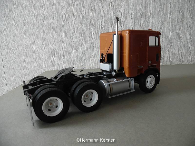

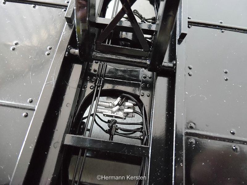

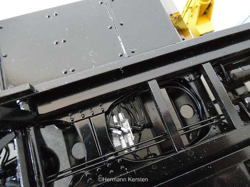

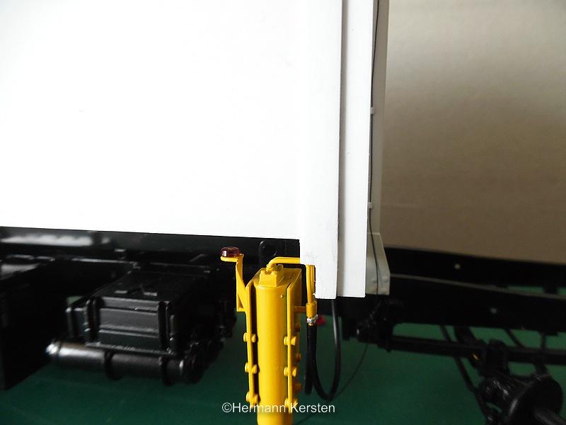

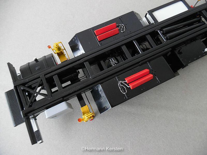

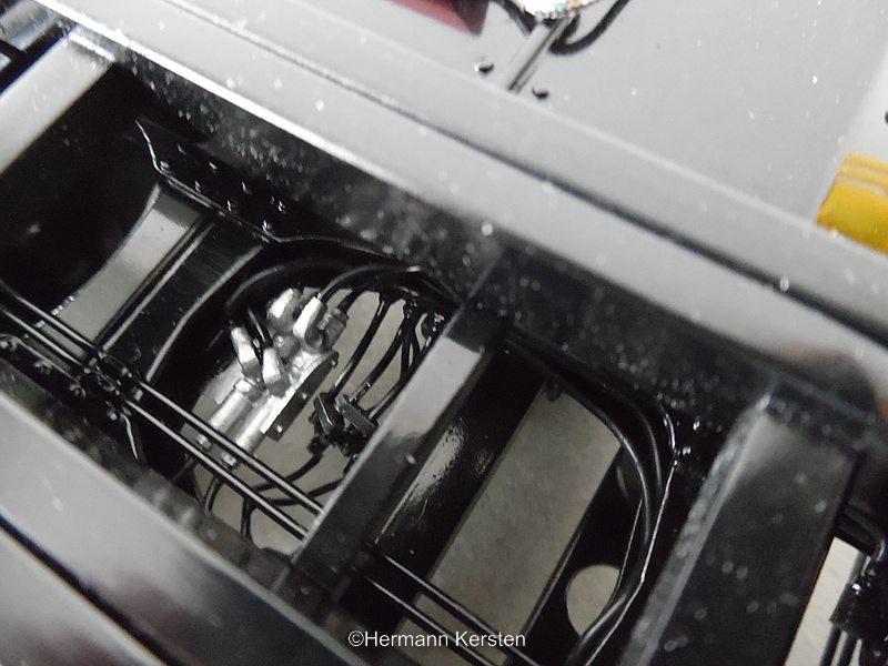

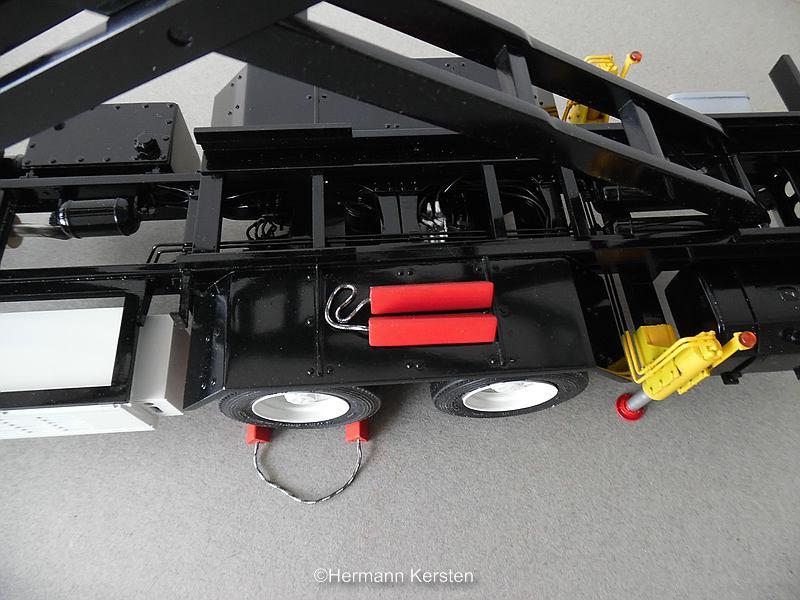

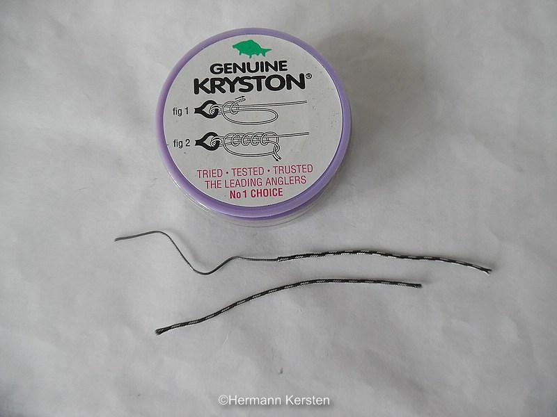

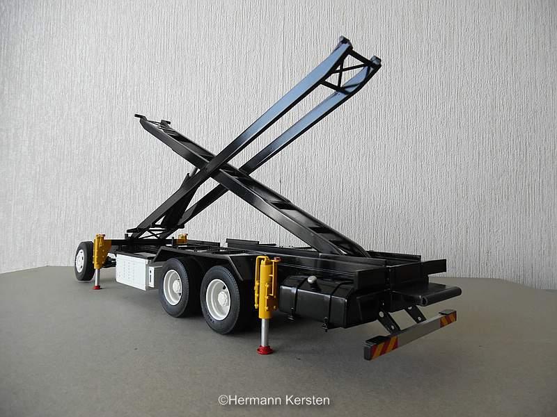

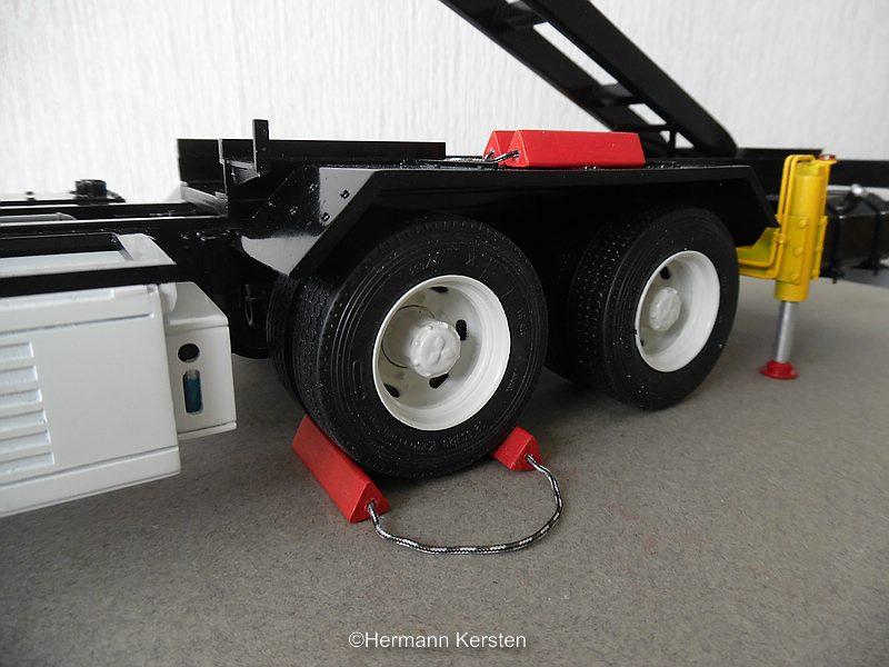

Yes Peter, I'm also more satisfied with these tires. Today some small details of the wiring and the rubber wheel chocks. The wiring of the brakes and the air suspension of the rear axles are done now, this is done with electric wires for electric model railway. Normally I use 3 different sizes to get these wiring job done. Then I made with polystyrene the big wheel chocks and connect a pair with a lead fishing wire. This lead fishing wire has a nylon jacket that you can slide off and if you spray this silver, you have a fuel pipe that looks like a reinforced tube. I left this nylon jacket for these wheel chocks. So you see again that stuff from a fishing store has various useful things for model building, such as various sizes of fishinglead for weighting models, and rubber tubes in various thicknesses, which are cheaper per meter or inch than in a hobby shop. Then a overall picture so far, together with the support for the floor plate of the Van-Body. Hermann.

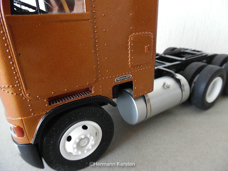

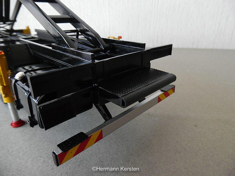

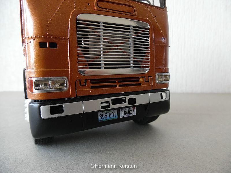

First of all, thank you for the nice comments and interest in this project guys! Yes Peter, you are absolutely right, but it didn't pay attention to it....."yet", later i was just checking which tires fit this truck the most, and I ended up with the Italeri truck tires. At the first i thought the AMT tires from the Freightliner kit would do the job, but I was still not satisfied, then the Kenworth tires from the Papa Truck, and still not really wow. With these tires that I have mounted now I think it is the best fit with this truck. Ok guys, the first part of the wiring is done.... Then the warning plates on the Under Ride Protection bar and I painted the rubber at the end of the big step in a rubber looking paint, which is done with Revell black-anthracite nr.9. Then the new tires, which I think it will fit this truck the most. As you all can see, the scissor lift is also in a black gloss paint and is already mounted on the chassis. It is not a spectacular update, but slowly this Fuso will grow. That's it for today and see you next round! Source Hermann.
