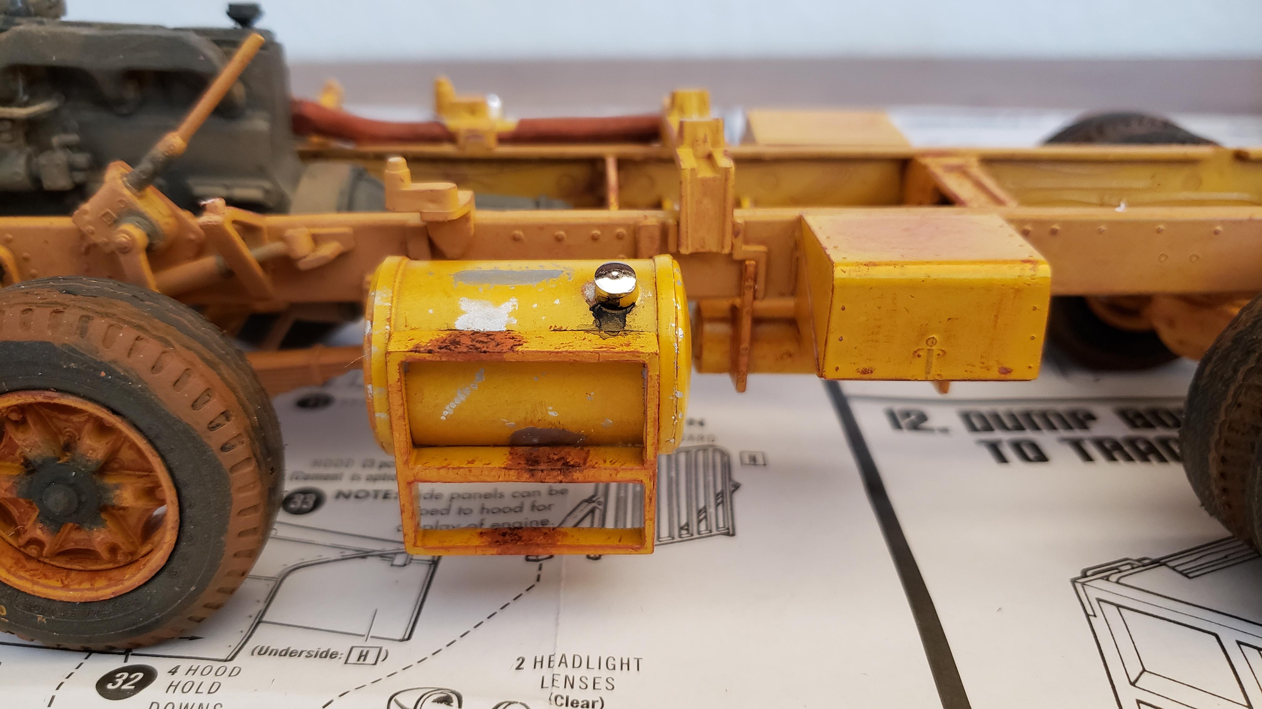

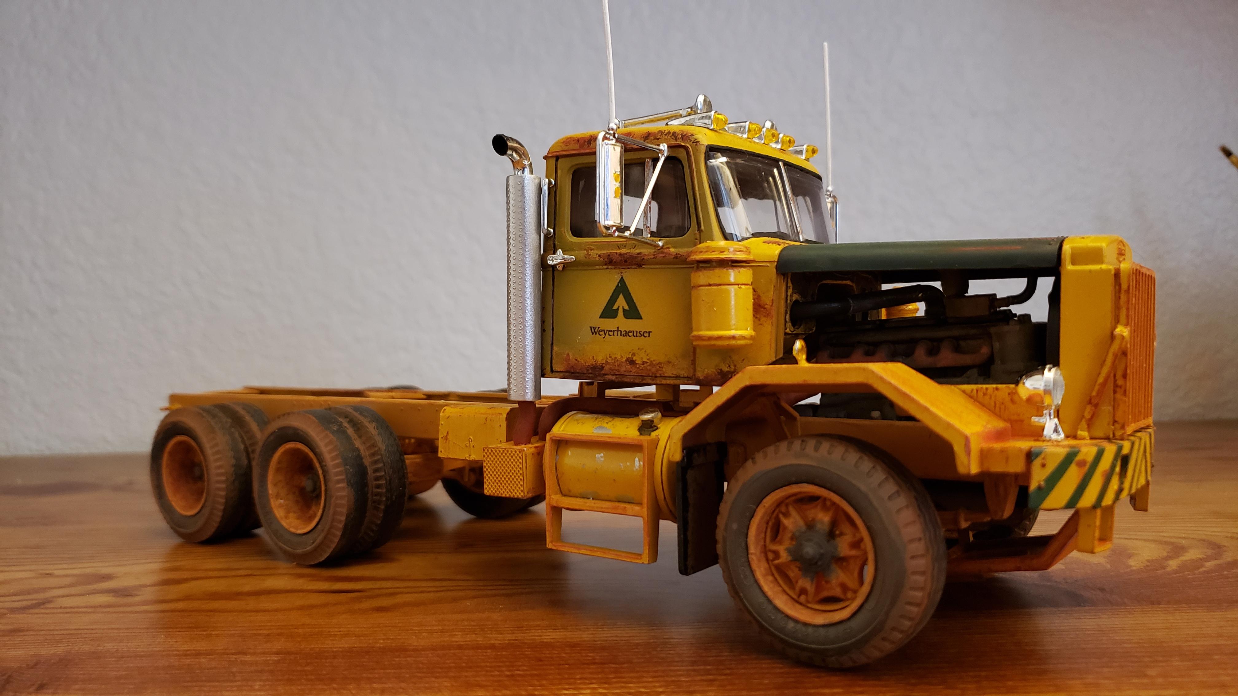

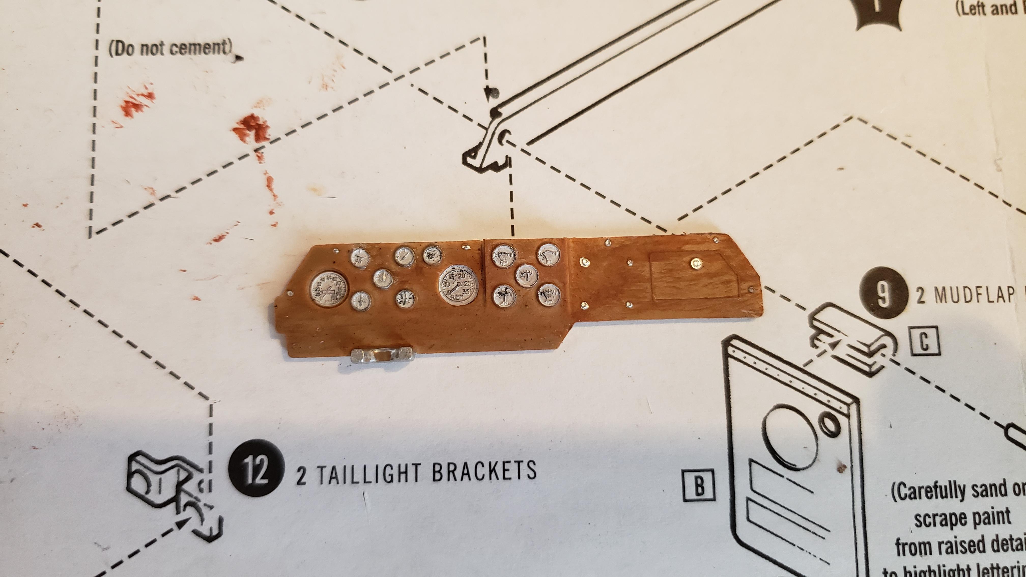

A bunch of progress made on this. First I got the fuel tanks and battery boxes mounted. And the weird muffler Then I worked on the interior Next I got the radiator mounted I got the roof accessories mounted Masked off bumper stripes Skid plate mounted I made custom decals, got air filter, lube finer and power steering resevrior mounted Mounted the cab Hood and fenders And bumper I got the stack mounted from the weird muffler. As you can see in the photos, I used mirrors from the snap pete kit. Since the provided mirror brackets are a scale 1 1/2" diameter, I decided to scale it down a bit. It's now time to start on the logging bunk -
I'm building the autocar dc dump as a logger. I want to weather the fuel tanks and steps. Does anyone know if they are steel or aluminum? Not sure whether to make them a little rusty, or just some chipped paint exposing aluminum
Autocar Logger
delta99 replied to delta99's topic in WIP: Model Trucks: Big Rigs and Heavy Equipment
I'm now at the point of adding the fuel tanks to the frame. I'd like to weather them a bit. Does anyone know if the tanks were made of steel or aluminum? I don't know whether to add a little rust or maybe just some chipped paint exposing aluminum. How about the steps also. Can anyone help me? -

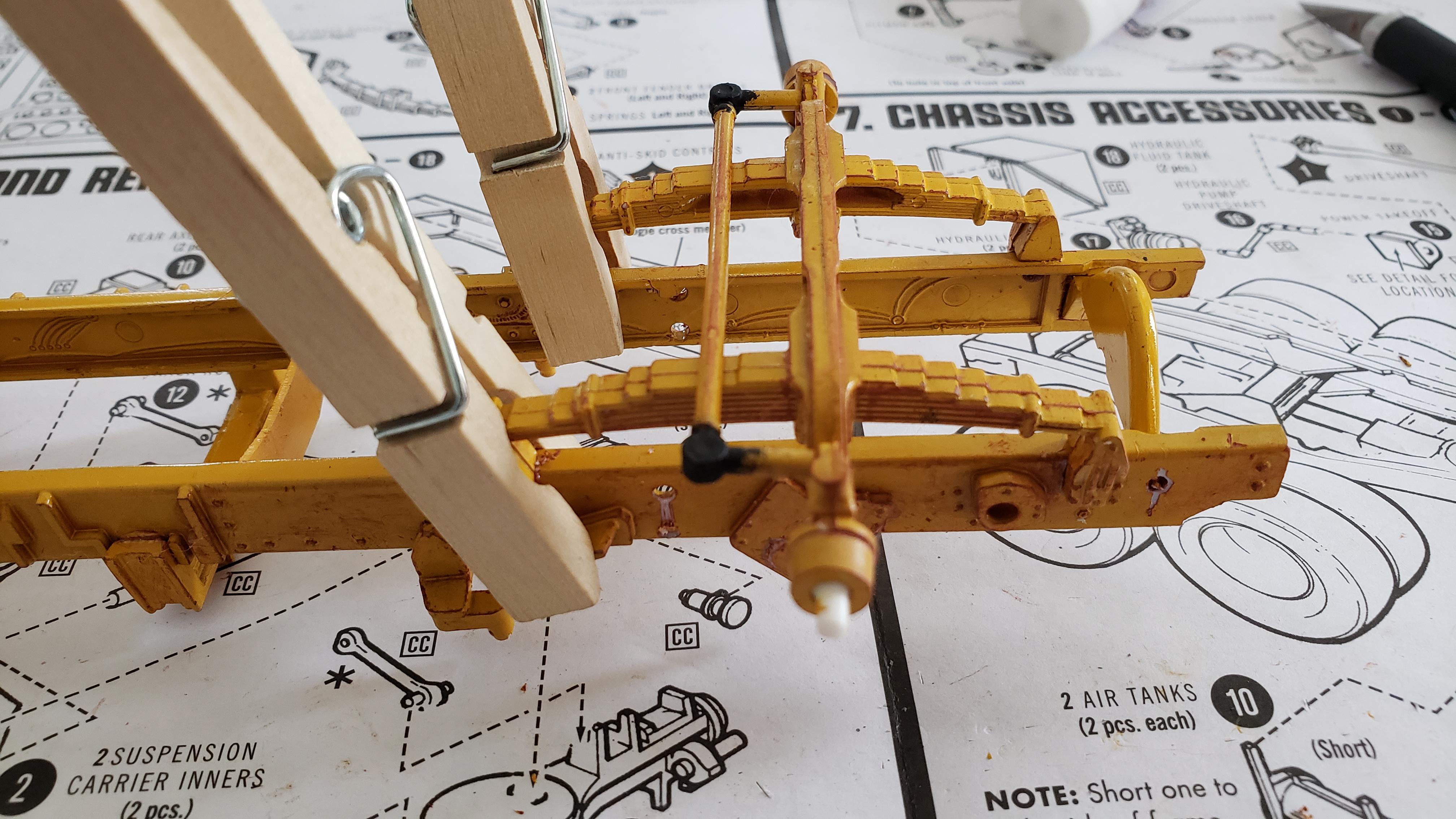

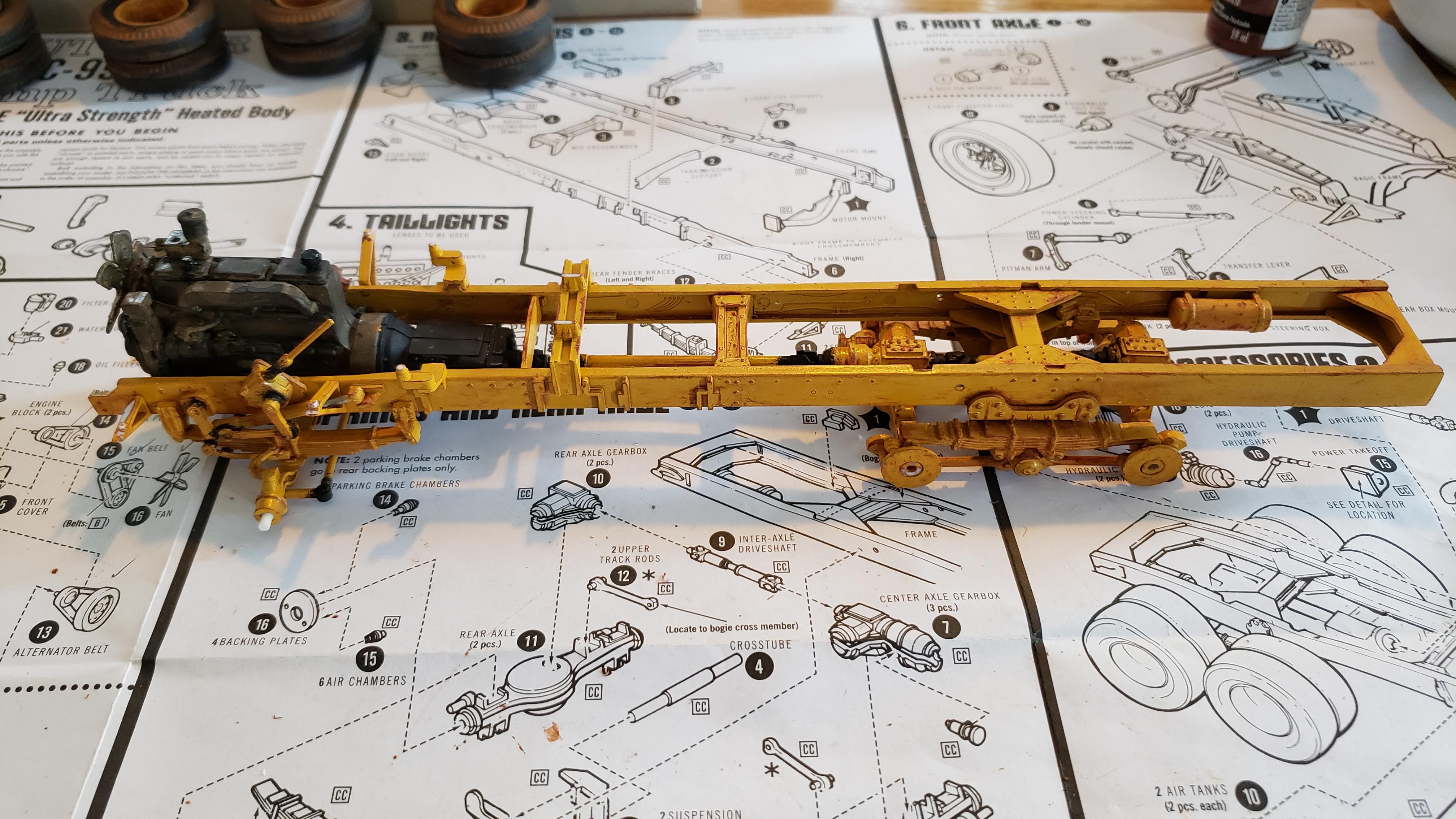

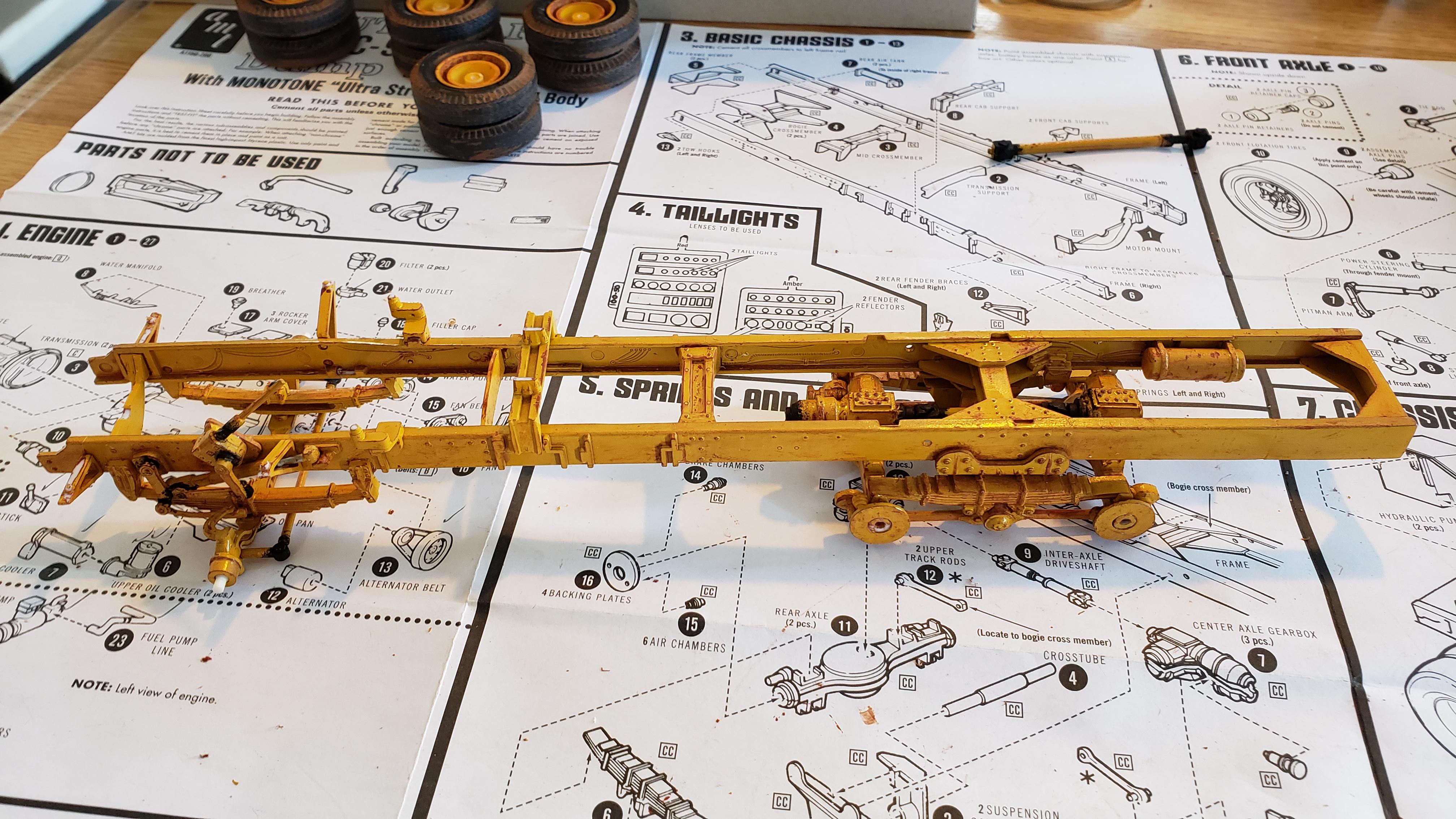

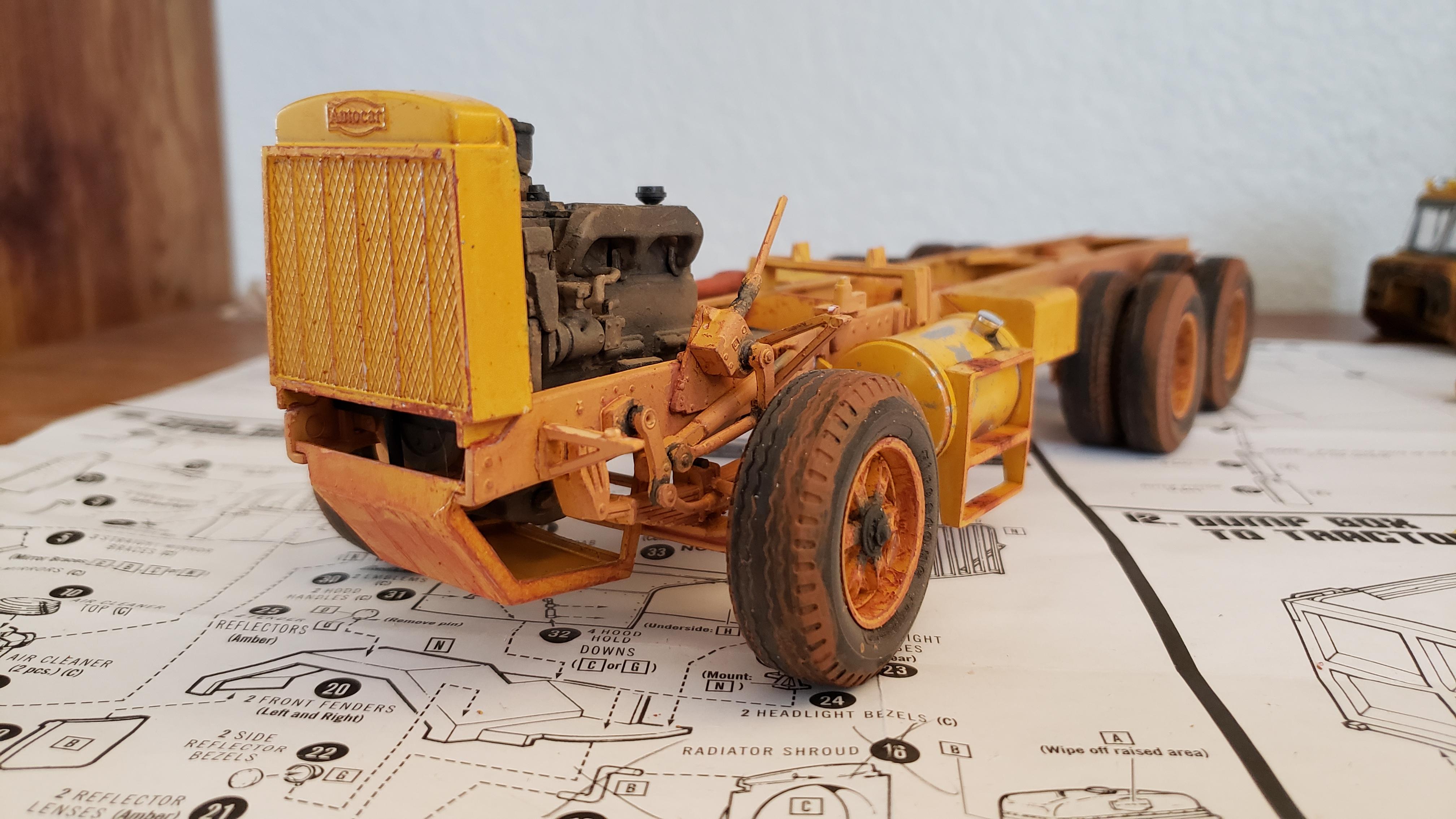

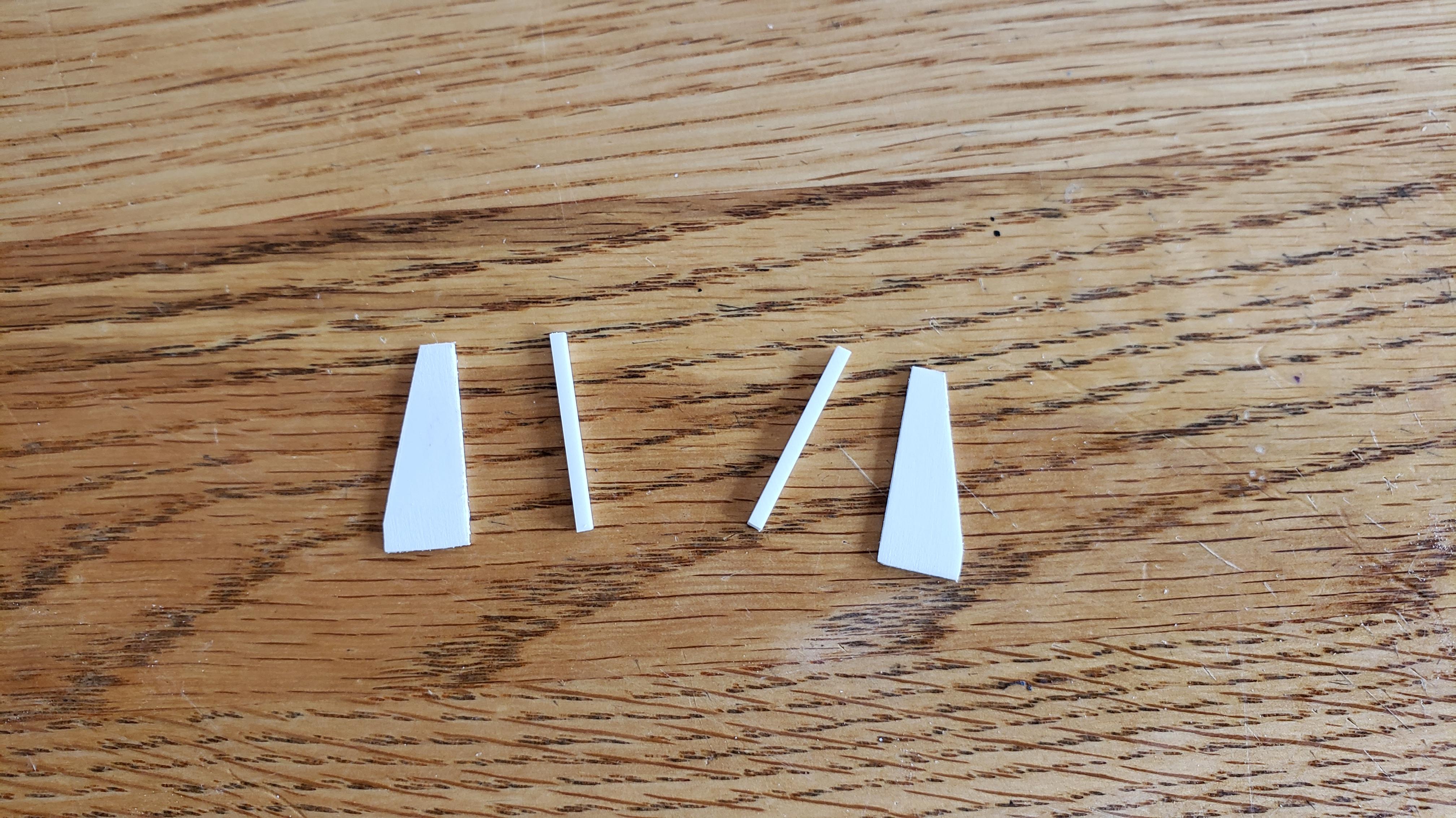

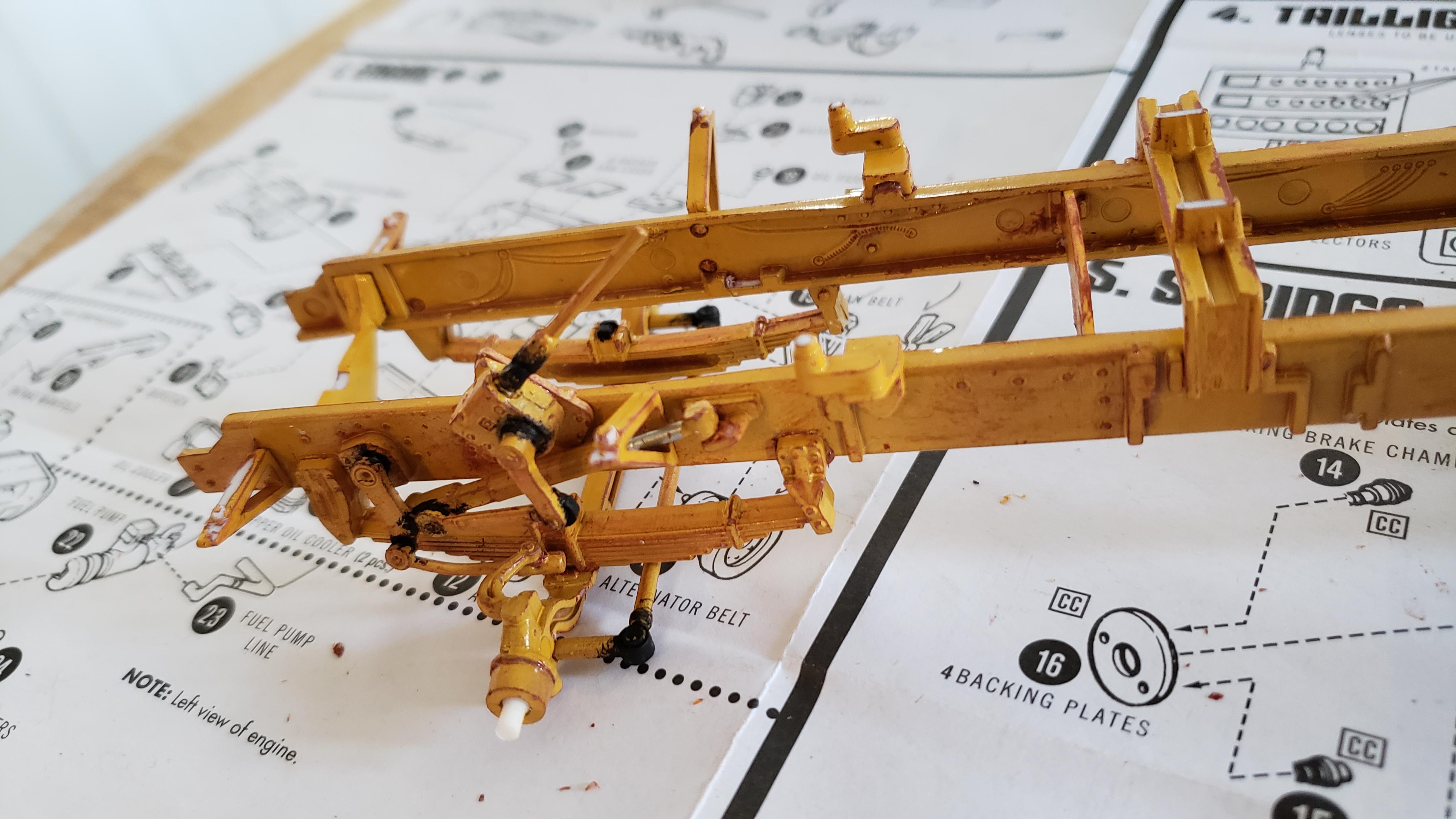

Got some more work done today. I'm on call at work tomorrow, so probably won't make any progress. I started out making some frame extensions for the rear stinger. I cut the sides from sheet, and attached strips for the top and bottom. I also filled in the weird vertical slots that didn't seem to correspond to anything. I put together the frame, and realized that I had lost a cross member. Spent a long time looking for it. Wound up building a new one from scratch. Once I was done for the day and cleaning up, I found the missing piece under the instruction sheet. Oh well (shrug) The instructions were pretty vague for the rear suspension, so I spent a while test fitting stuff. Finally figured it out Then I got busy on the front suspension. The steering linkage was a bit of a challenge, but I got it all together. Then I got the engine mounted Then I got the wheels on Then I air brushed a light coat of dust. I will finish to dust coat up once the rest of the build is complete. It doesn't really look great at this point, but I don't want to over do it And for some reason, everytime I make a post, it always adds extra pictures at the end. So any pictures that appear after this are ghosted?? -

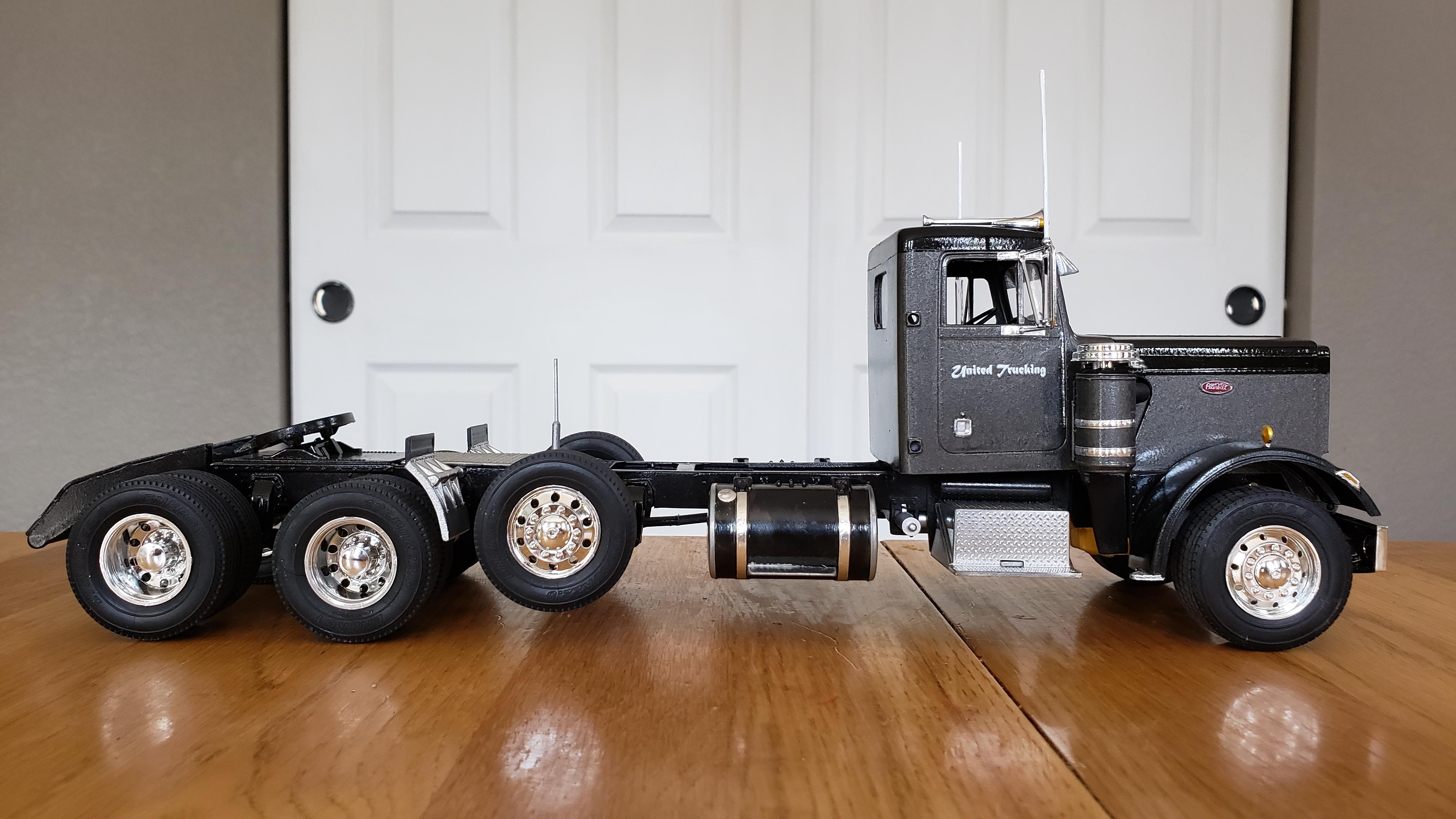

I got the steps mounted on the frame, and added some mudflaps under the battery box And a shot of the grille and head lights -

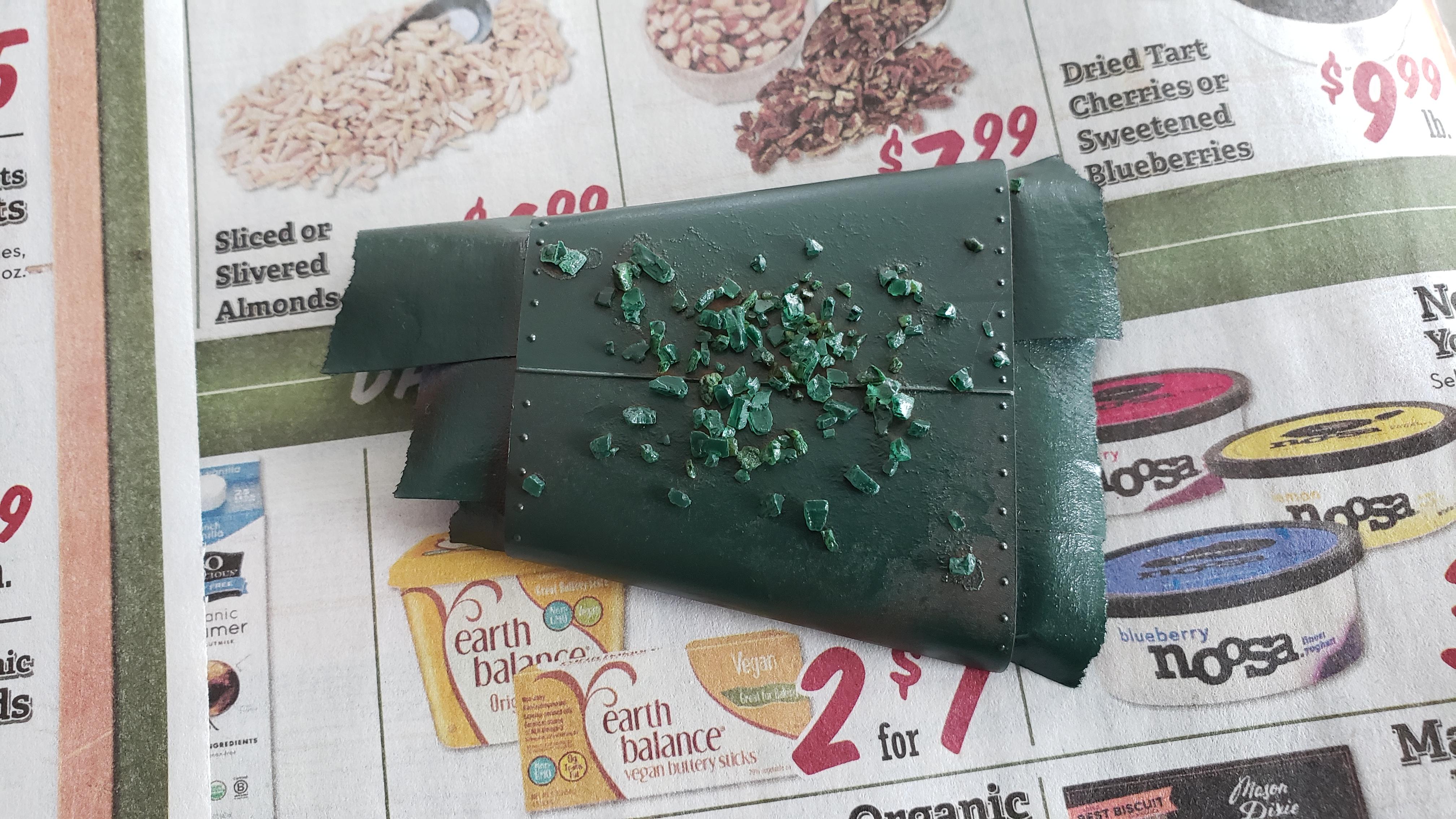

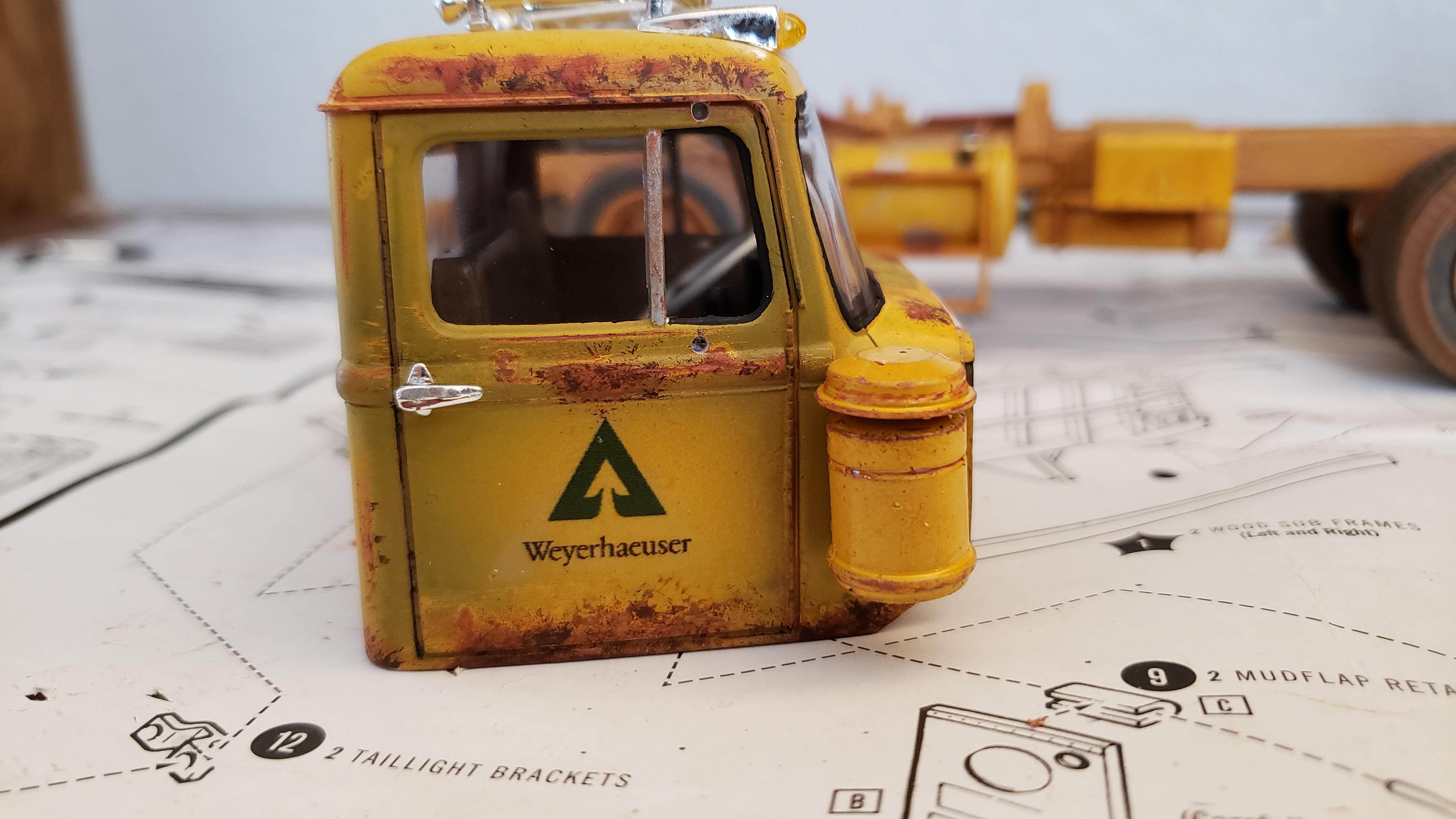

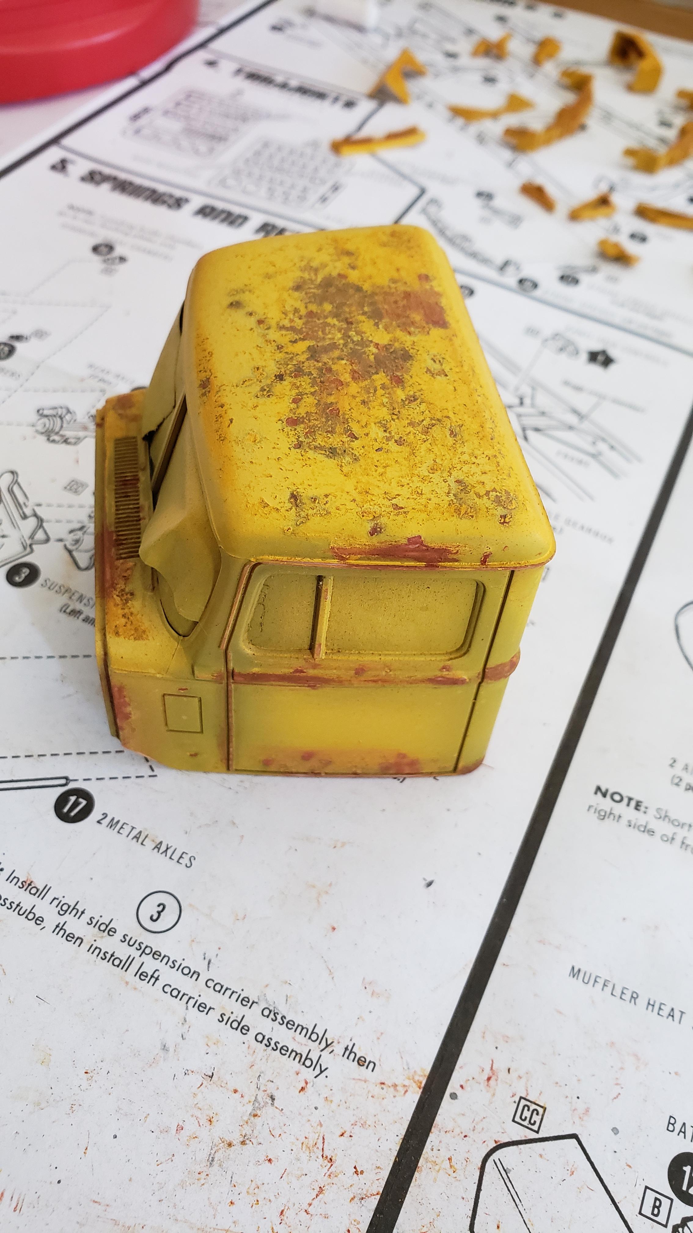

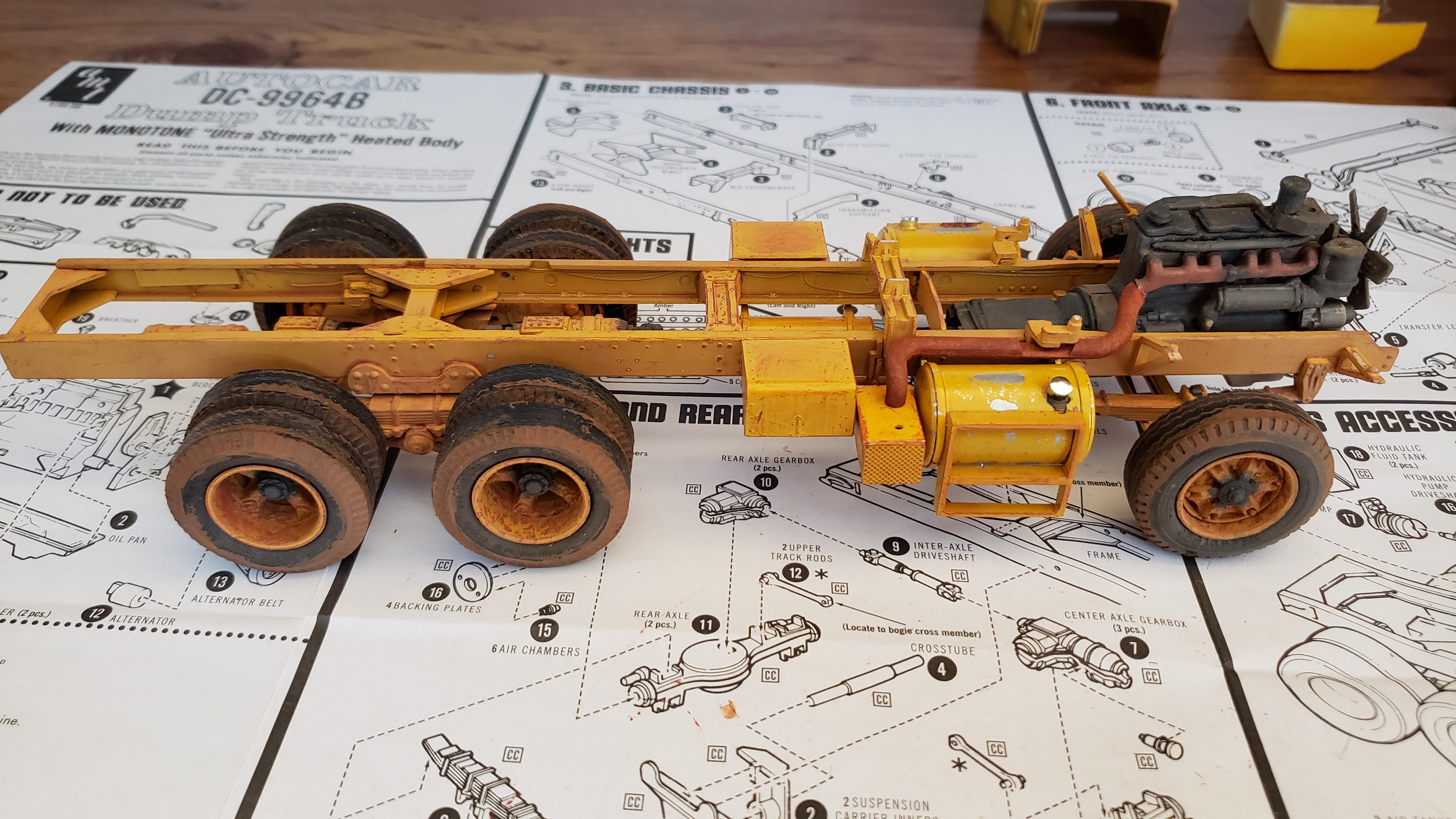

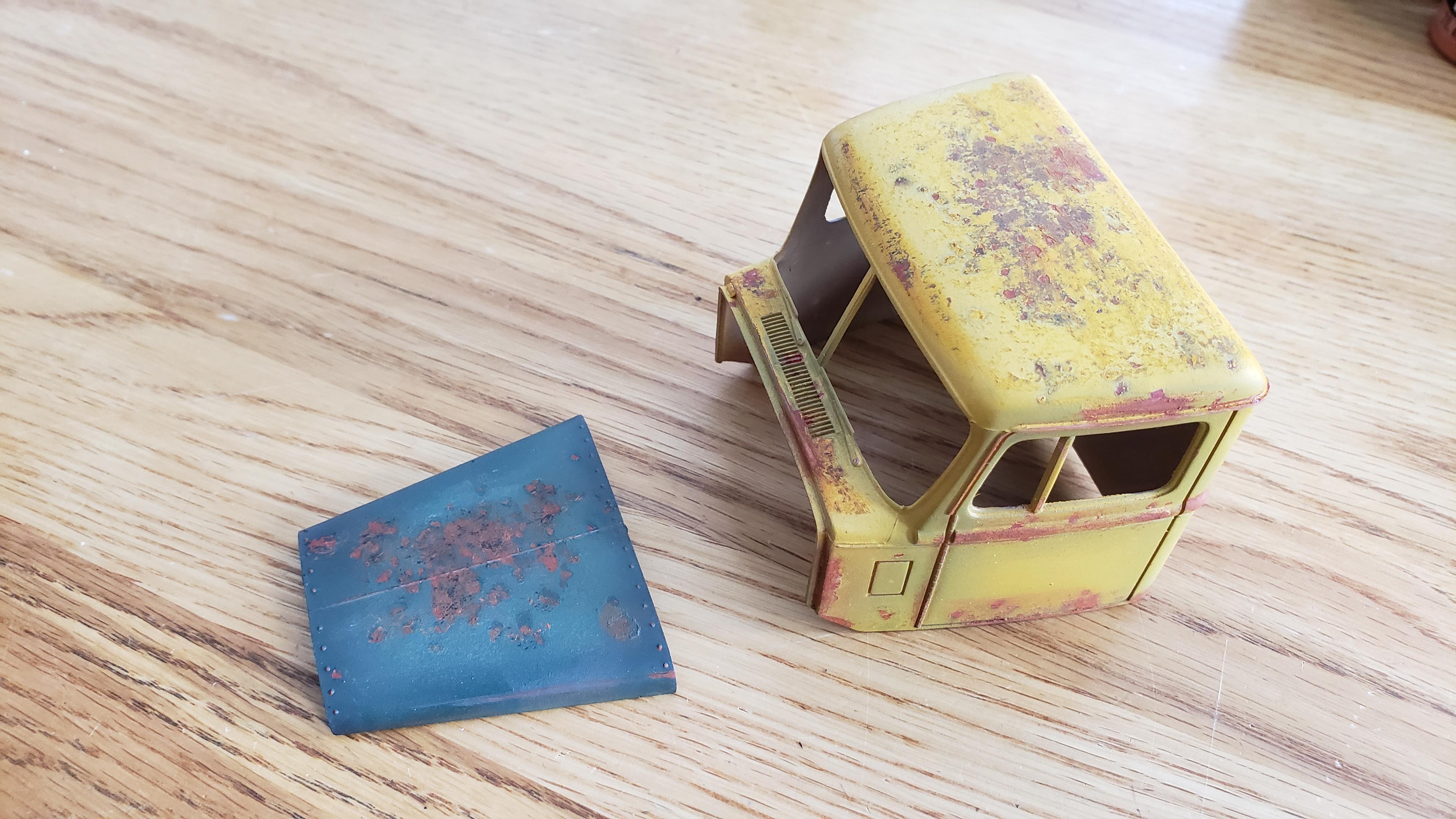

I need to add a "stinger" at the back of the frame. I ordered some channel from plastuct, so I'm waiting on that. But I worked on some chassis pieces, and the cab, First I sprayed the cab in red primer Then I dry brushed on some rusty color Then I did the salt masking technique. I applied some rock salt. All I had in salt that big was garlic salt, so there is some garlic in there as well, lol. It worked though Then I shot some yellow Then I air brushed in a bit darker detail Then I sanded a little bit more rust in Then I worked on the hood Some rusty dry brushing A little salt masking and shot some green A little bit of air brushing some lighter green The hood and some touch up work on the cab And I got some chassis pieces weathered Here's how she sits now, thanks for looking -

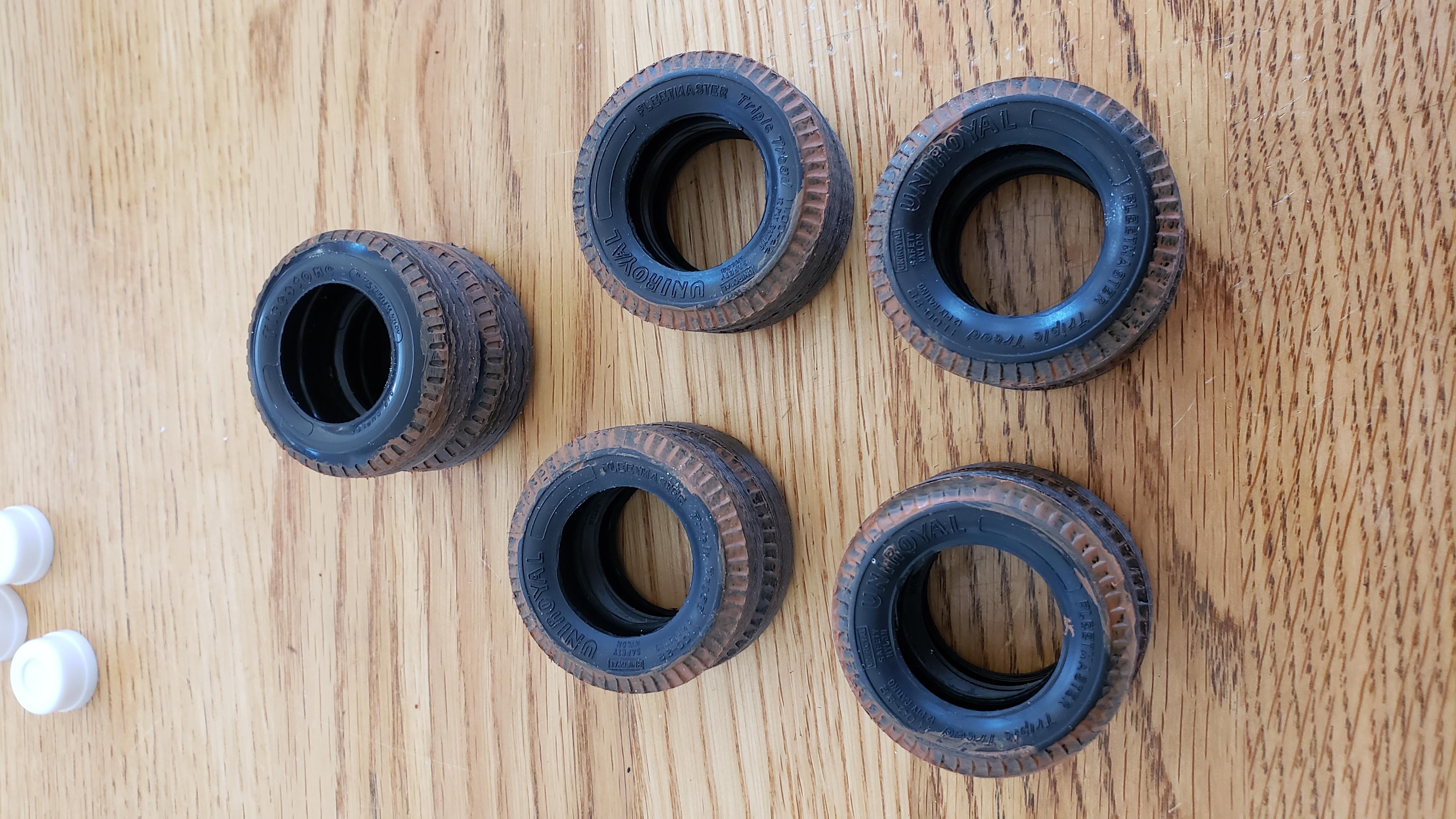

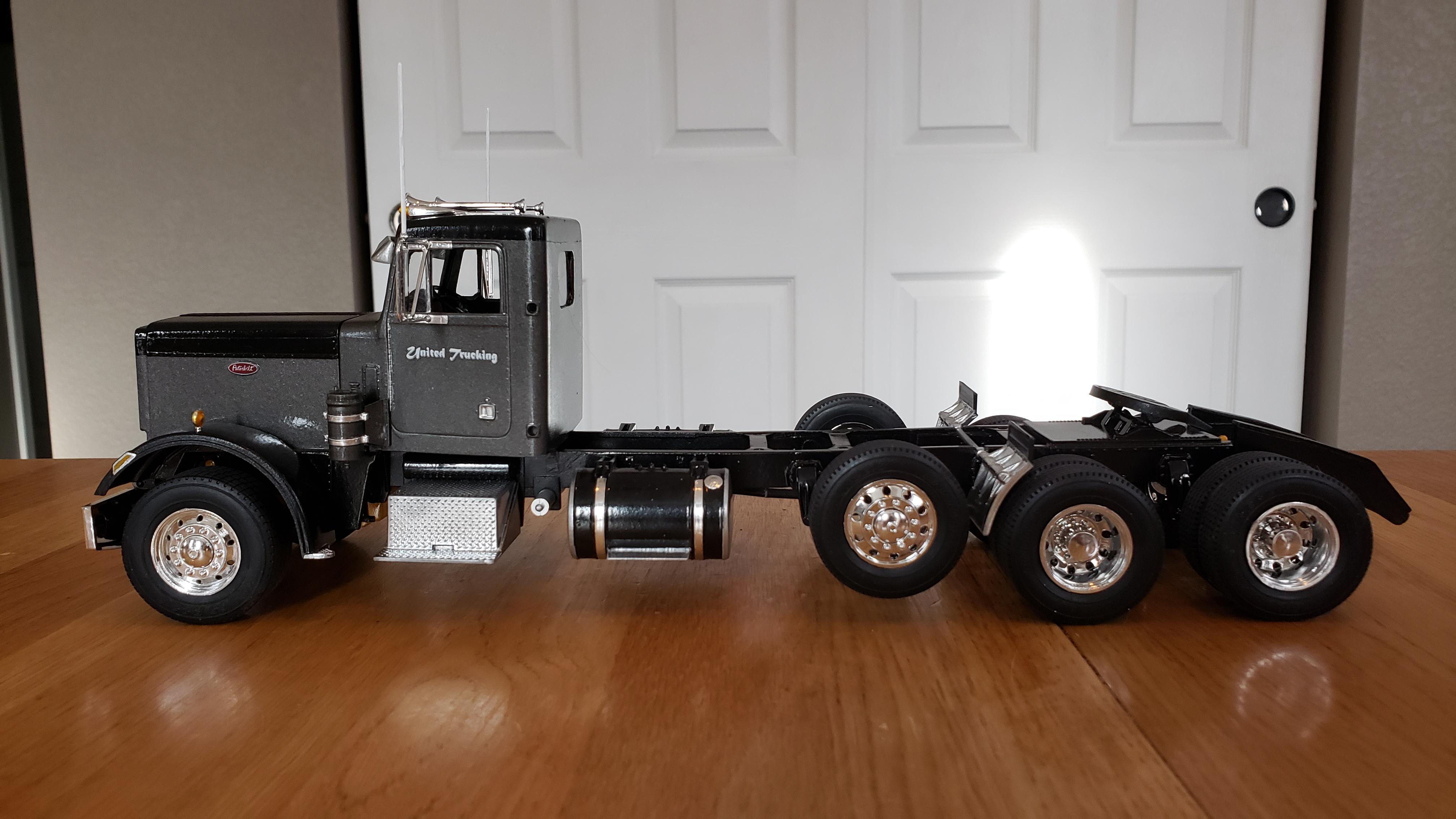

I decided to curb the kit tires, and go with the Moebius ones. The front floats are a bit small, and I was a little bit disappointed about that. They aren't that bad though. I decided to make some steps for the driver's side frame between the fuel tank and axle I worked on scratch building a headache rack, but I'm not happy with how it turned out. I wound up ordering one from AITM. I am going with the AMT round headlights. I had a mishap, and long story short, I lost a couple of the lenses. I have been filling in the housings with testors window maker glue. I just need to get the headlights done, mount them on the grille, get the grille on, headache rack, mount the steps and mud flaps. I'm closing in on the finish! -
