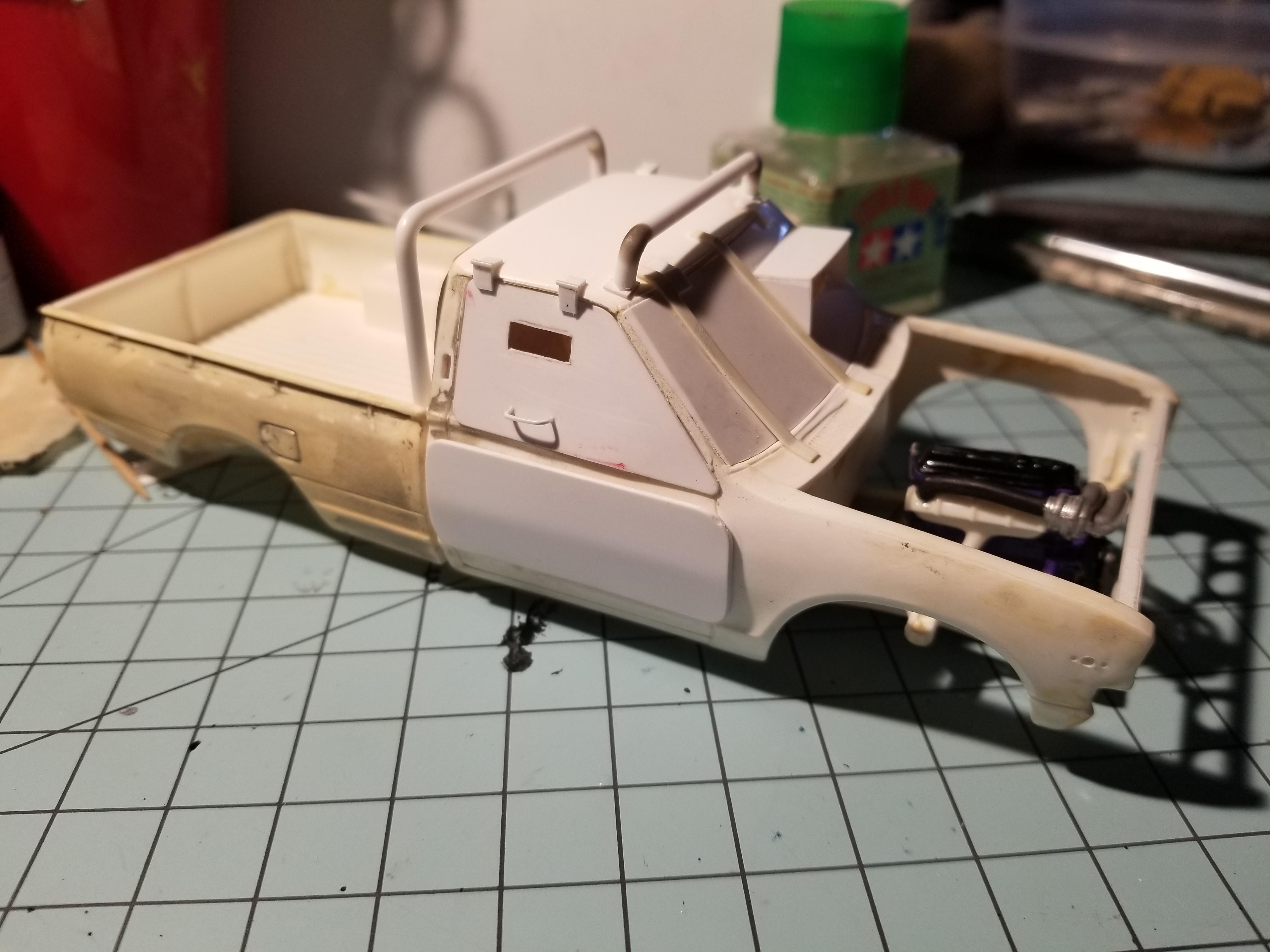

I was really excited to get my hands on this kit, as I owned a 76 for years. I actually liked it, despite its tendency to rust as a hobby. But, after receiving it, and messing with it for a bit, I'm a little disappointed. Whatever plastic it is molded in, is horrible. It tends to rip and tear even with a fresh, sharp blade. Using nippers to remove parts from the trees makes an even worse mess. Also, Tamiya cement and even superglue doesn't stick too well. The first pic shows where I had to reinforce the cab wall. It would just pop loose. Sanding the joints with a coarse grit helps, but not all joints are conducive to doing so. As supplied, the kit comes with 8 lug rims. They're nice, but not accurate. The second pic shows what I chose to use. They're the extra 6 lug wheels from the MPC Deserter kit. I originally intended to rebuild the wheel openings to depict the truck a little closer to stock, along with moving the taillights from under the tailgate to either side, to depict a slightly newer model year. However, that plan went out the window as I'm afraid I'll destroy the body trying to work with this horrible plastic. Third pic shows a preliminary mockup.

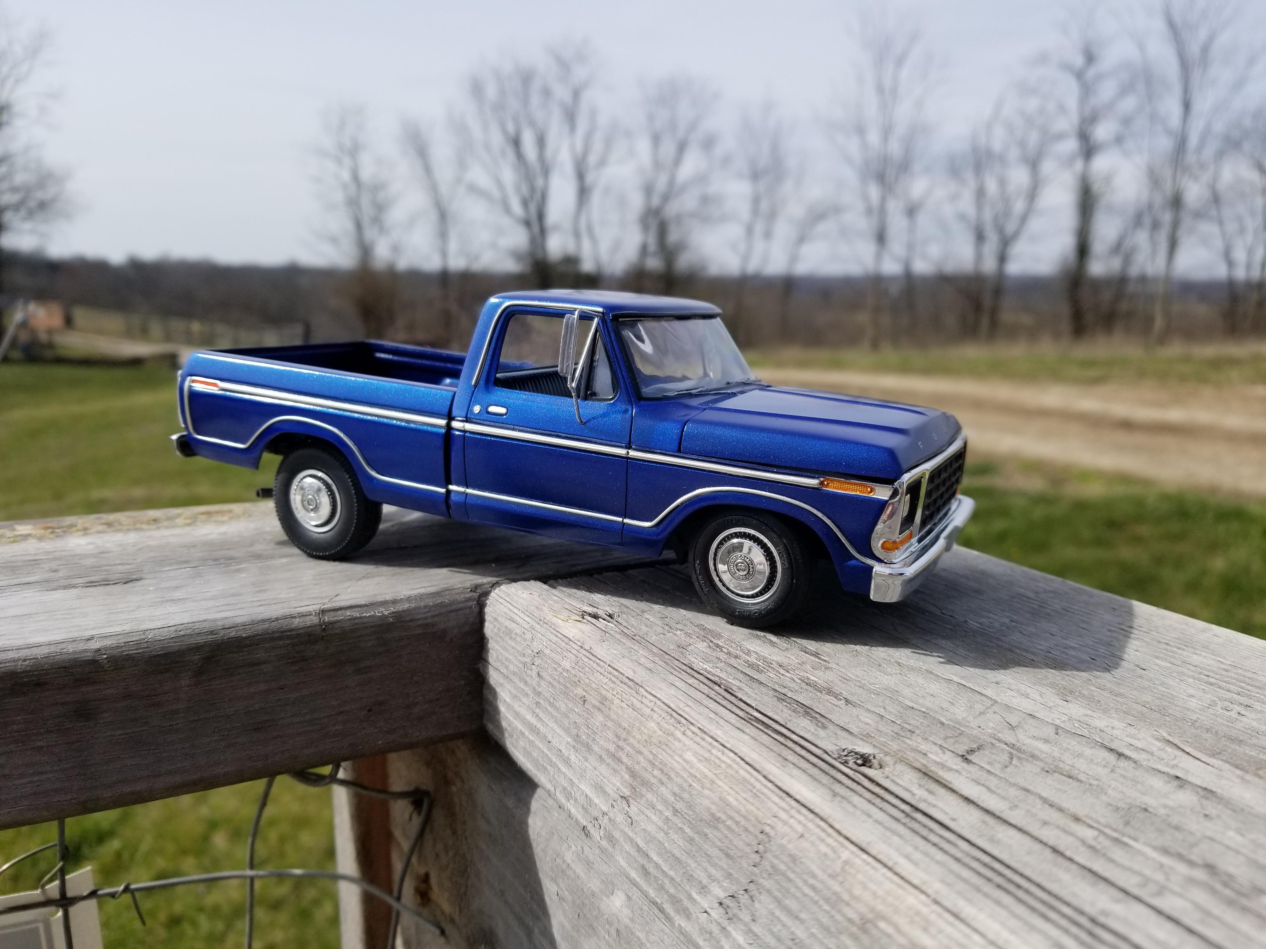

Thanks for all of the compliments. Yes, I was going for late 50s early 60s. I used to really be into that style of rods and customs. Now though, I tend to build more 70s and 80s style (jacked up rears and wide rims)

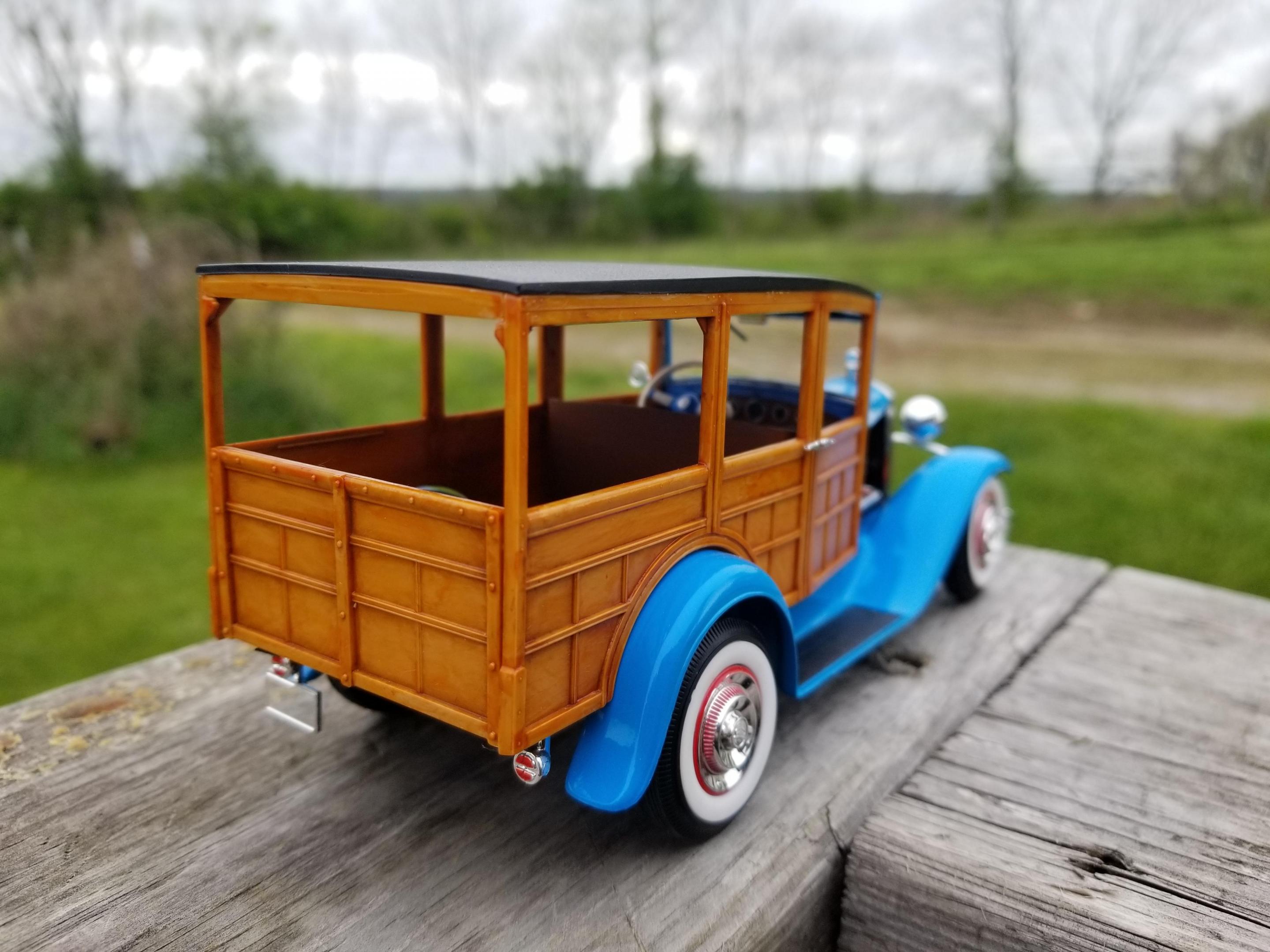

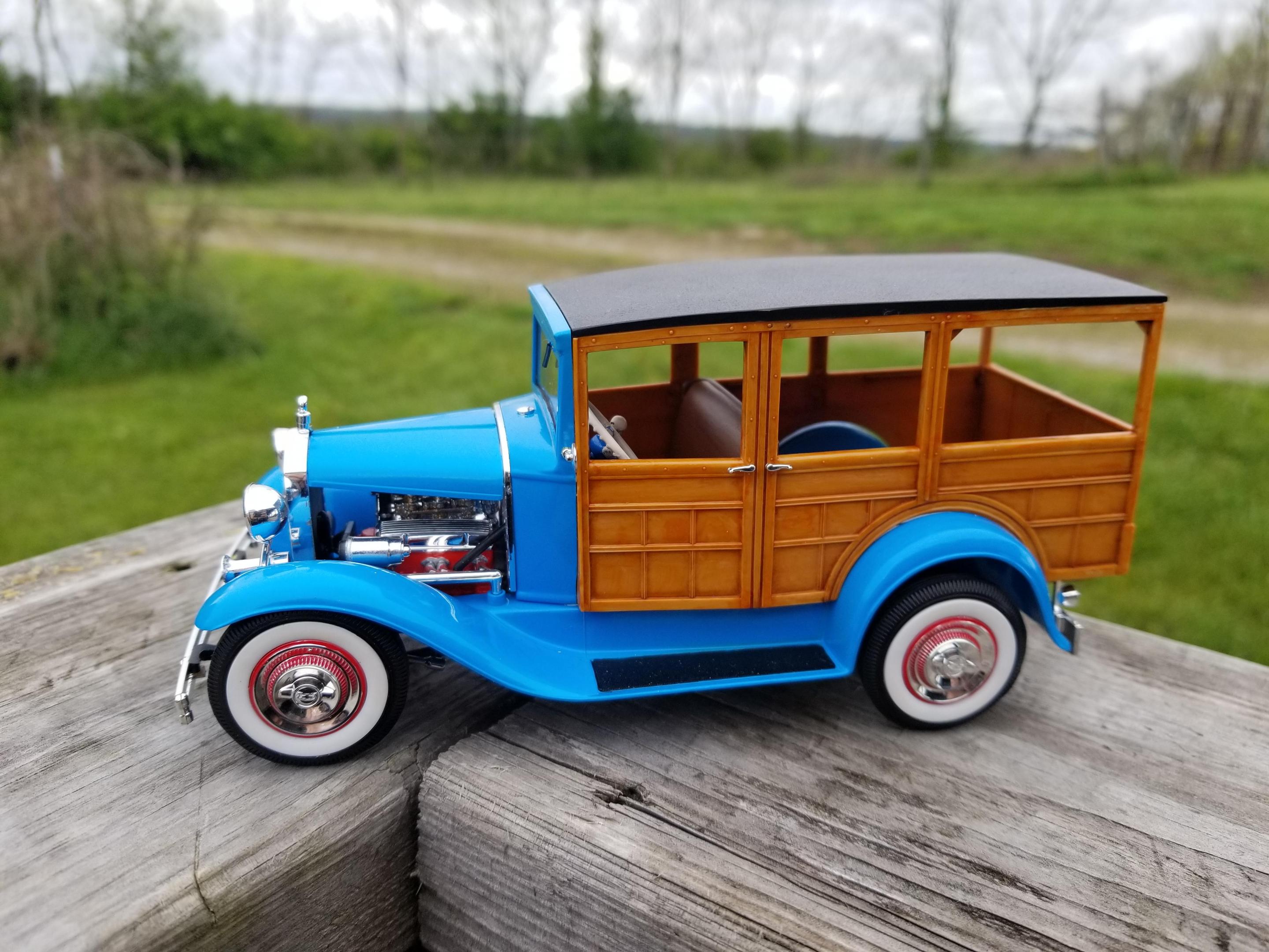

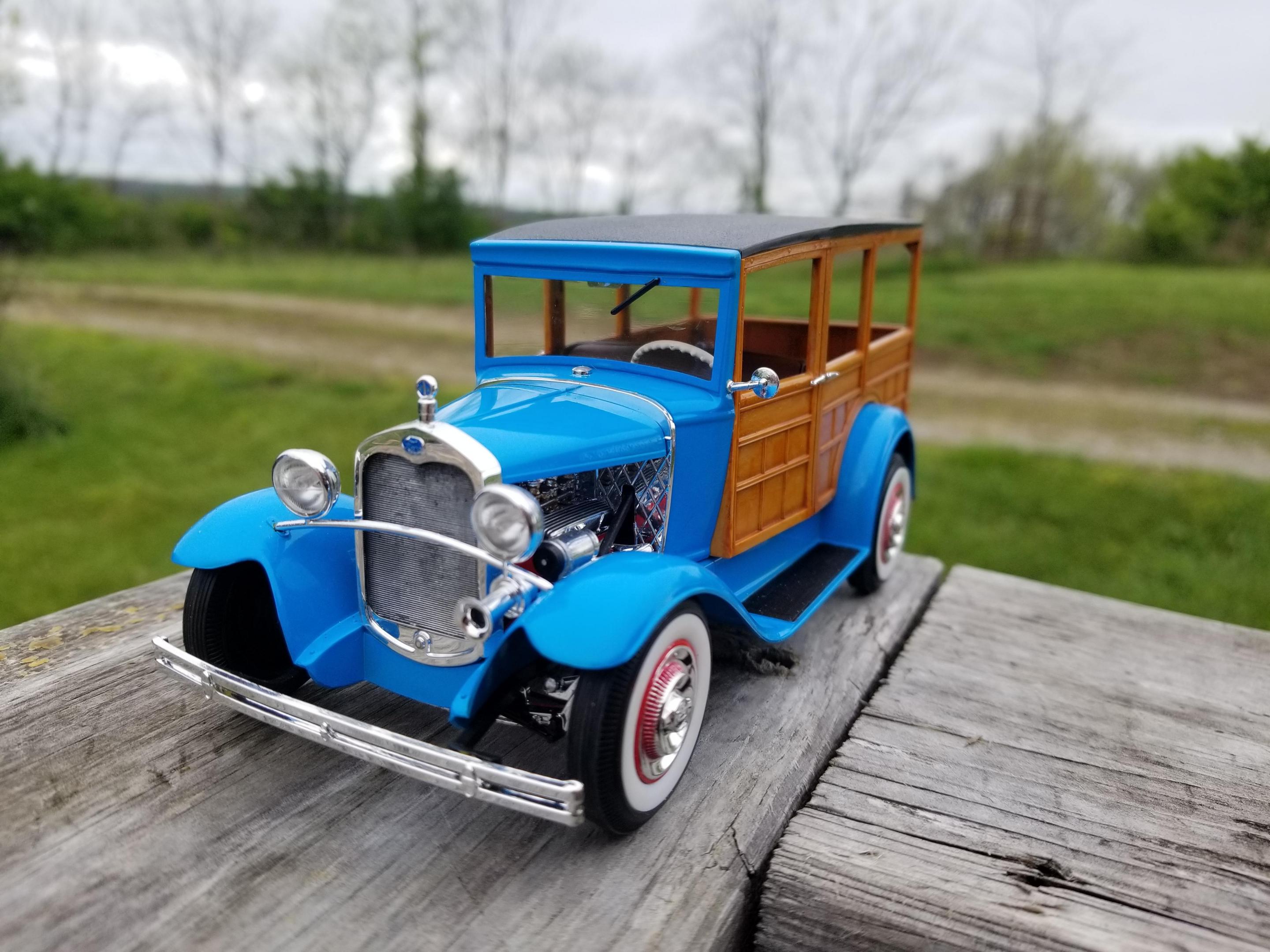

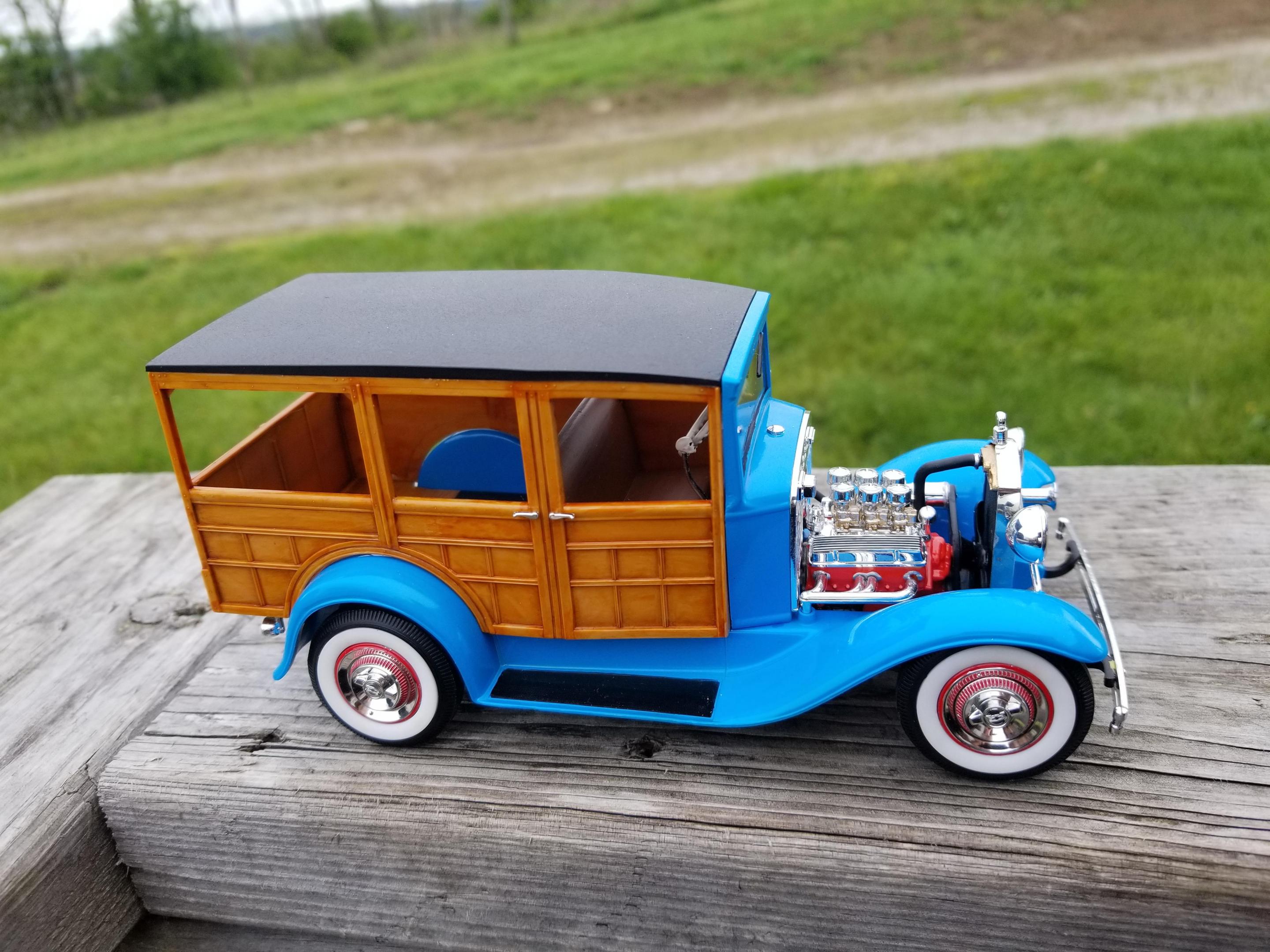

Not sure if this is considered a car or truck...I'm sure the mods will take care of it if I'm wrong. This is an old build given to me in pieces by my older brother. He built it in the late 80s. Being in the Navy, he moved a lot. It got broken somewhere along the way. He gave it to me around 00 or 01 and I tossed it in the closet and forgot about it. Then, a year or so later I won an ebay auction for a lot of kits that had either been started or parted out. One of the incomplete kits happened to be an older issue of my brother's build. I stripped off the Testors light blue paint and repainted it with the closest Tamiya shade I could find. The wood was molded in tan, so I just brushed tamiya clear orange over it which turned out pretty well. I had to replace his wire wheels because I broke one trying to clean them up. I ended with 53 Corvette hubcaps and tires. All of the chrome and the engine came from the donor kit. It's been 10 years since finishing, so I cant recall everything that I replaced, but for the most part I used his kit.

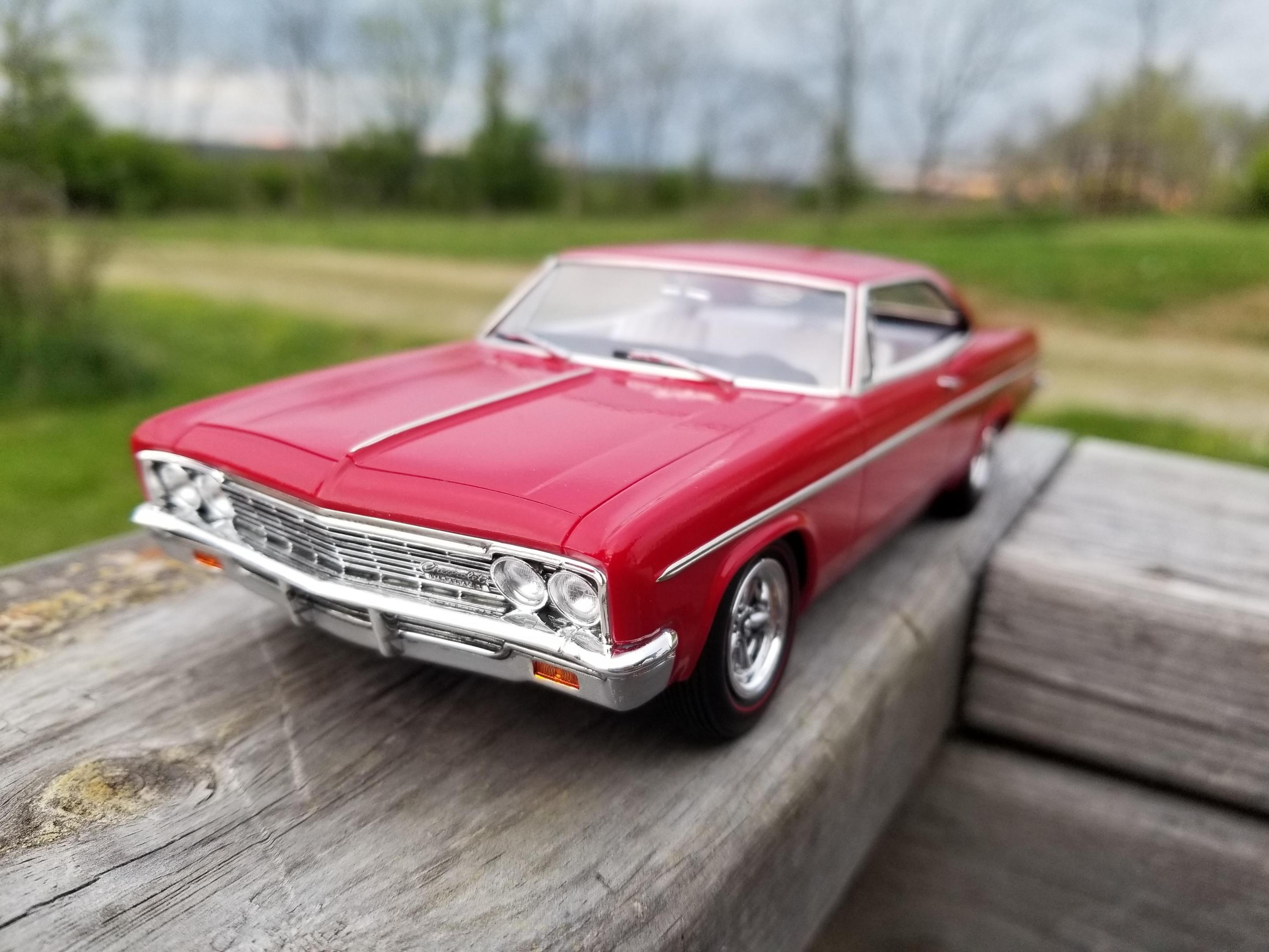

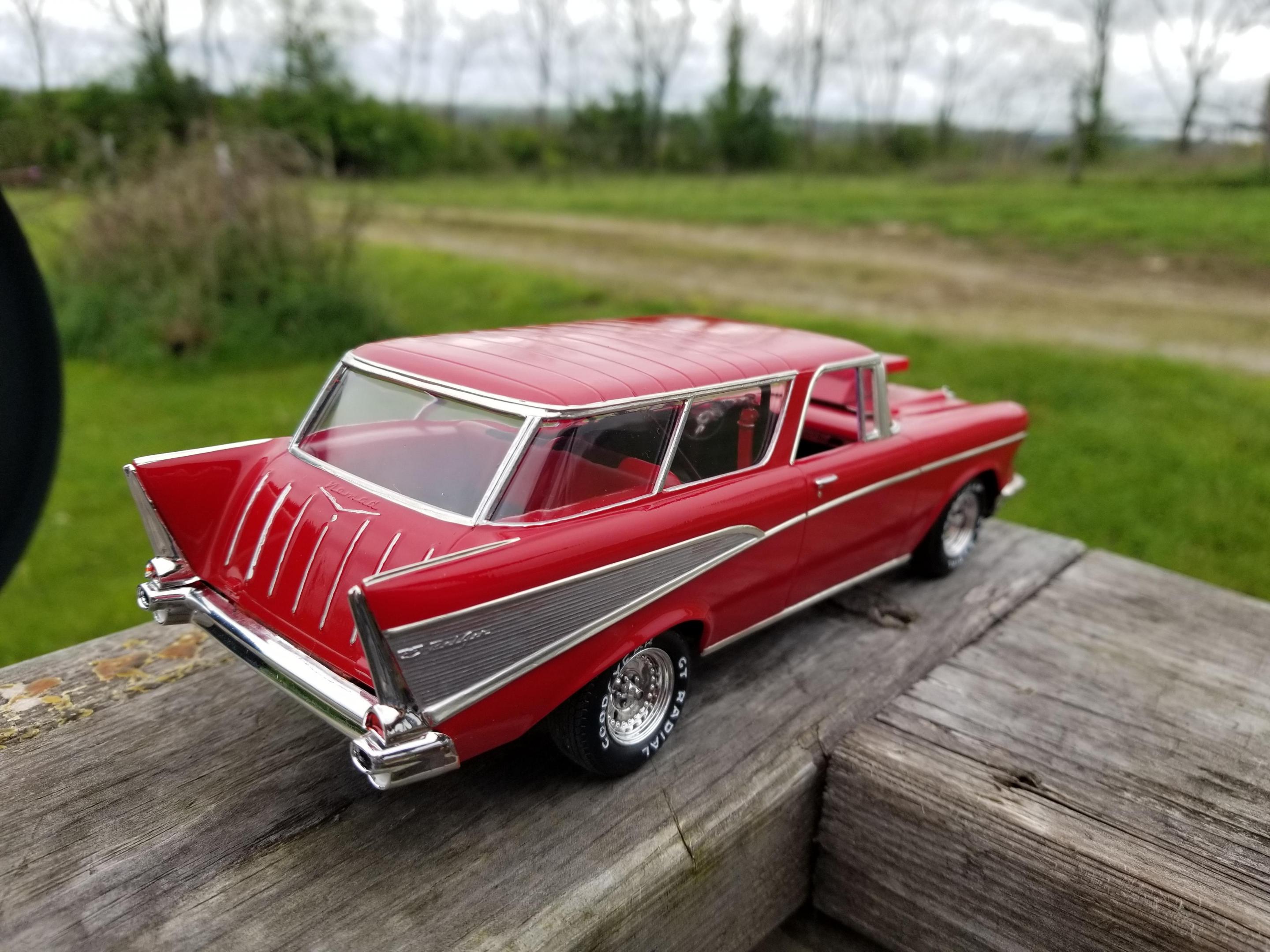

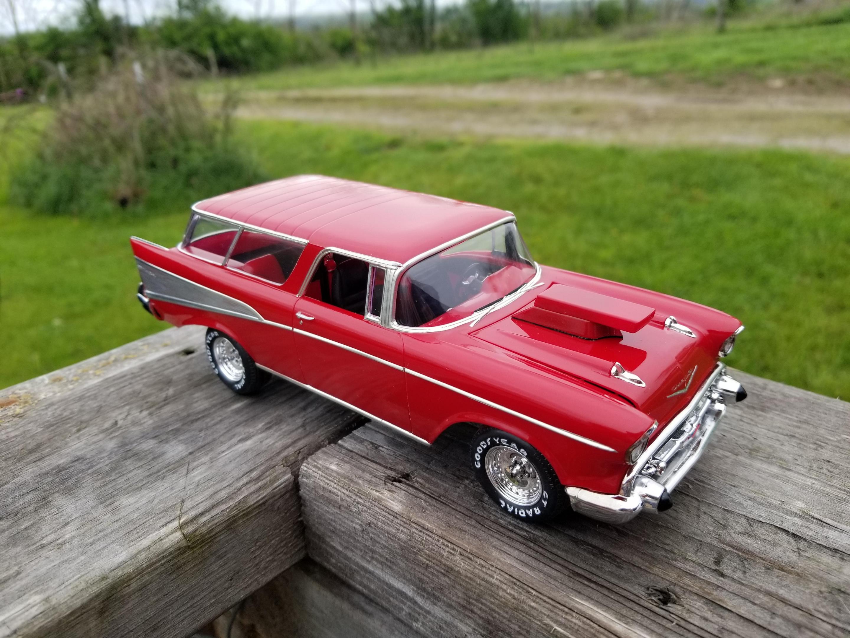

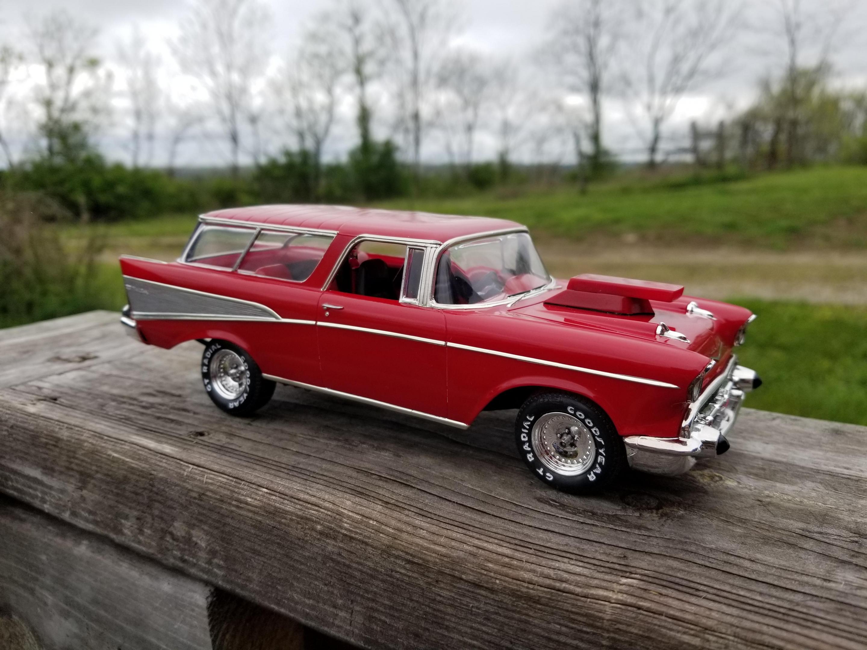

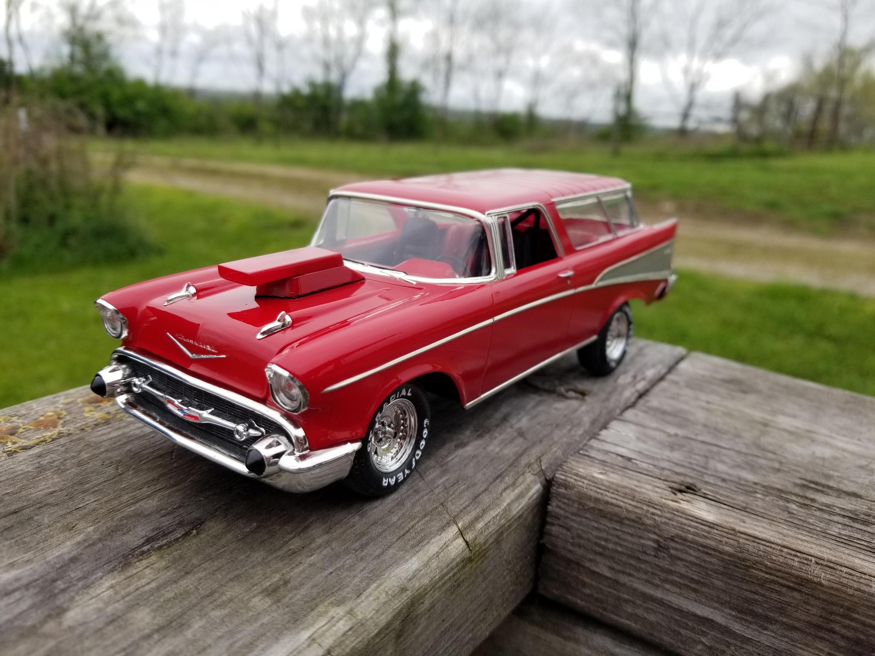

Another build sped up by the quarantine. Kit arrived in the mail on Thursday, I finished it this morning. Built entirely out-of-box. Paint is Testors Flame Red over the bare plastic. The foiling got tedious so I gave up and finished with a Molotow pen. It came with that hood scoop, but I dont think it was meant to be used. I had clearance issues with the tunnel ram and carbs. I had to grind out the inside of the scoop, as well as add a gasket to get the hood to close. Eh, not bad for a 70s engineered kit.

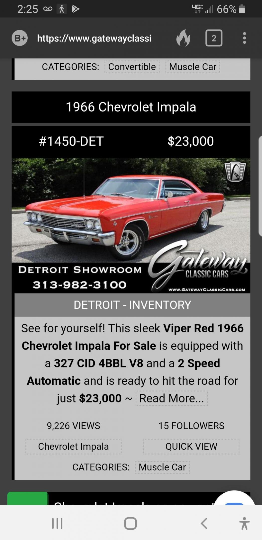

Thanks for all of the compliments! After I uploaded the pics, I realized that the door handle was falling off lol Good thing I found it! Below is a screenshot of the inspiration.

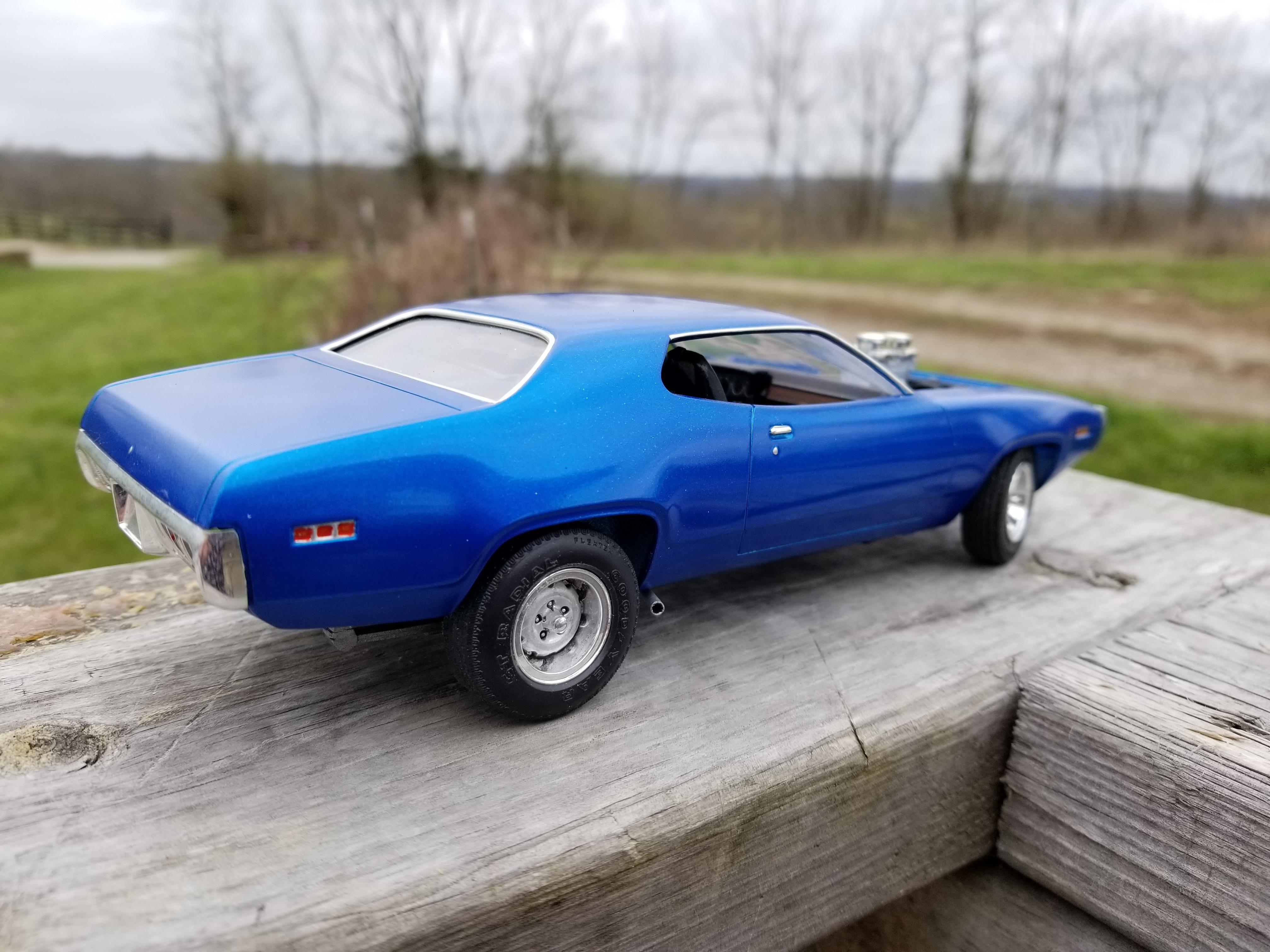

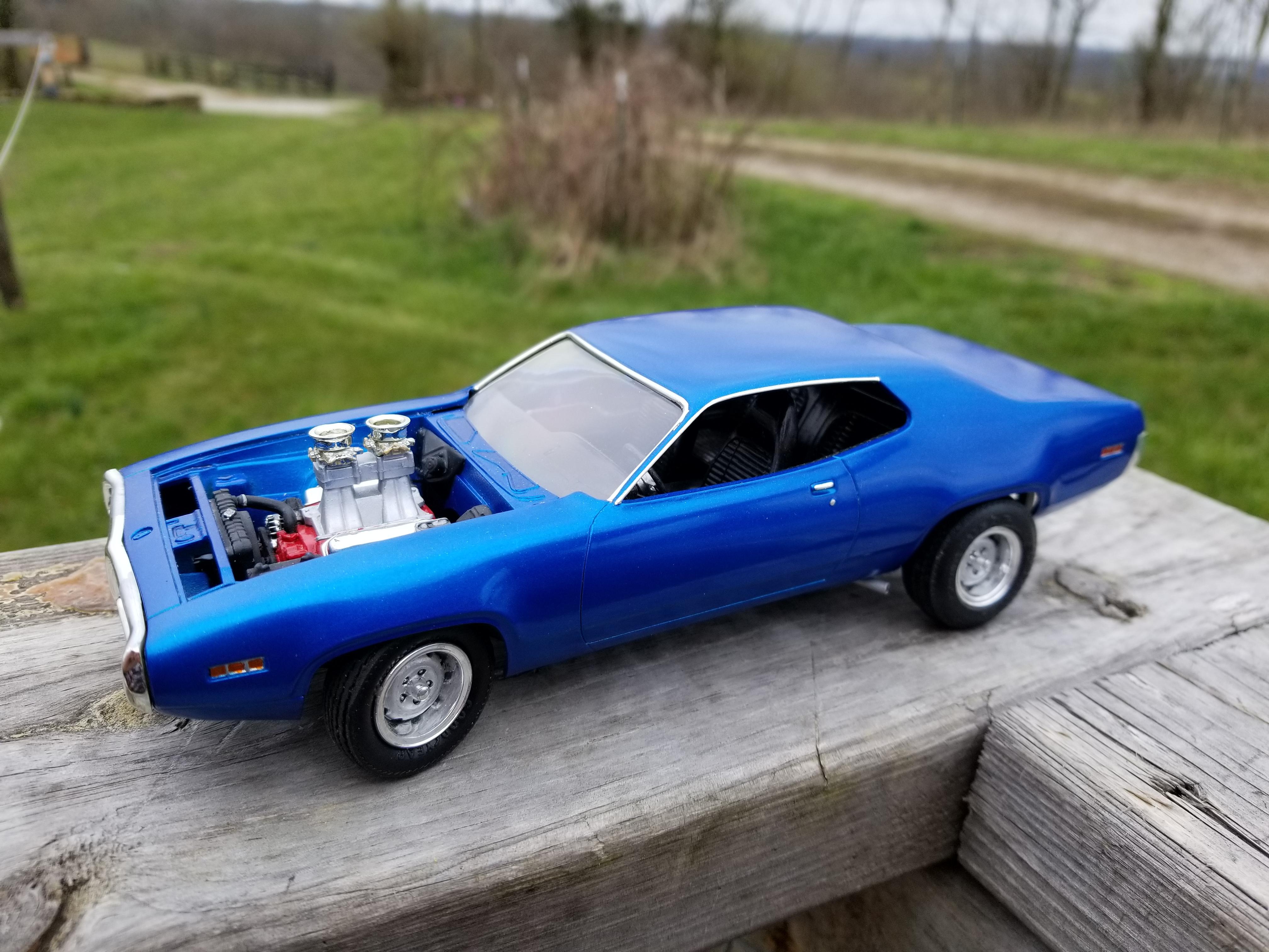

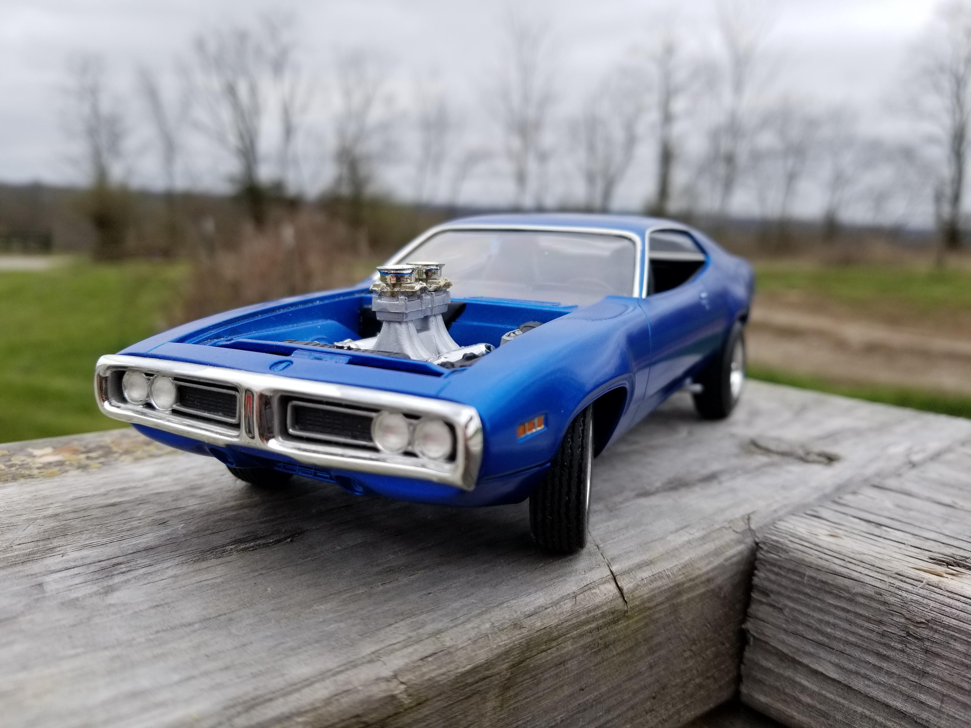

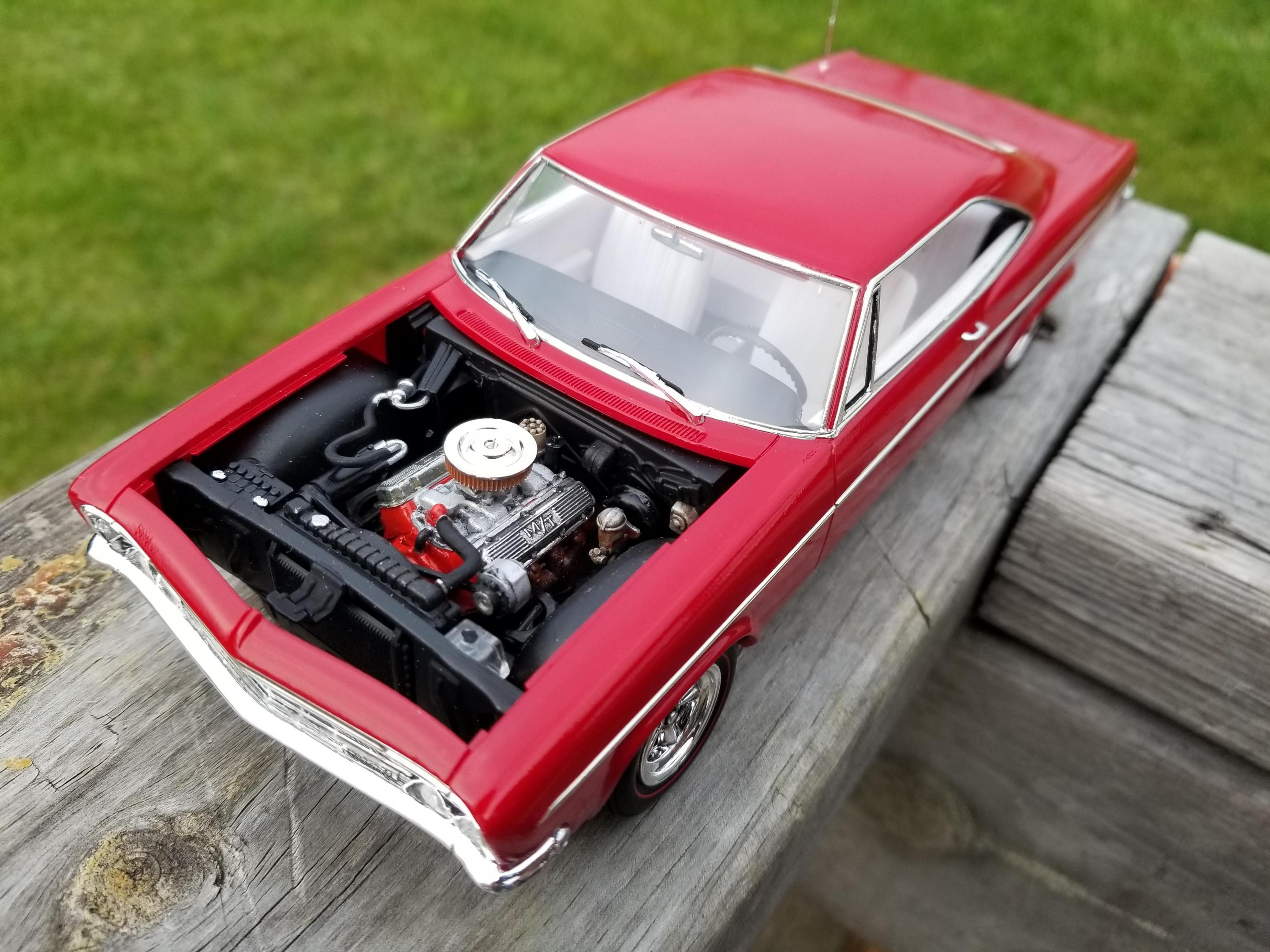

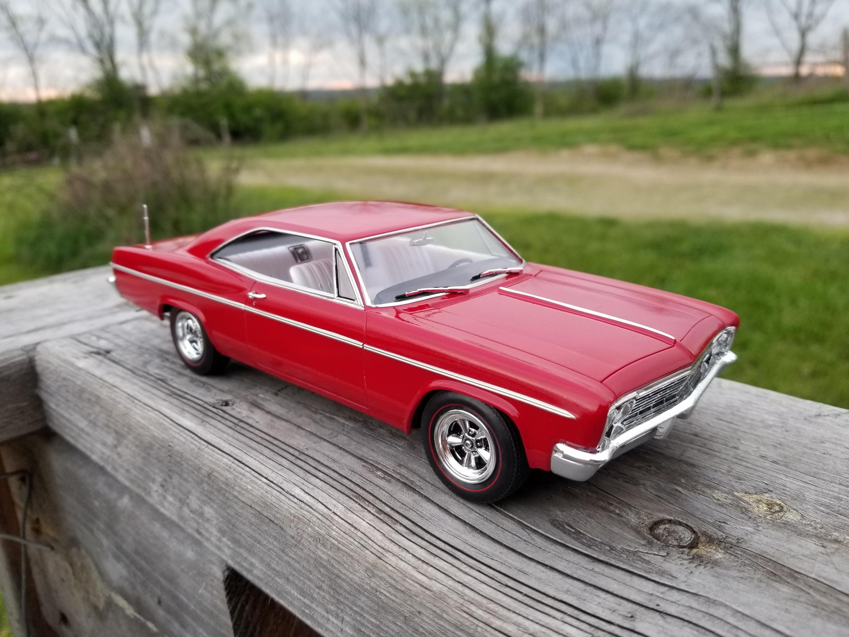

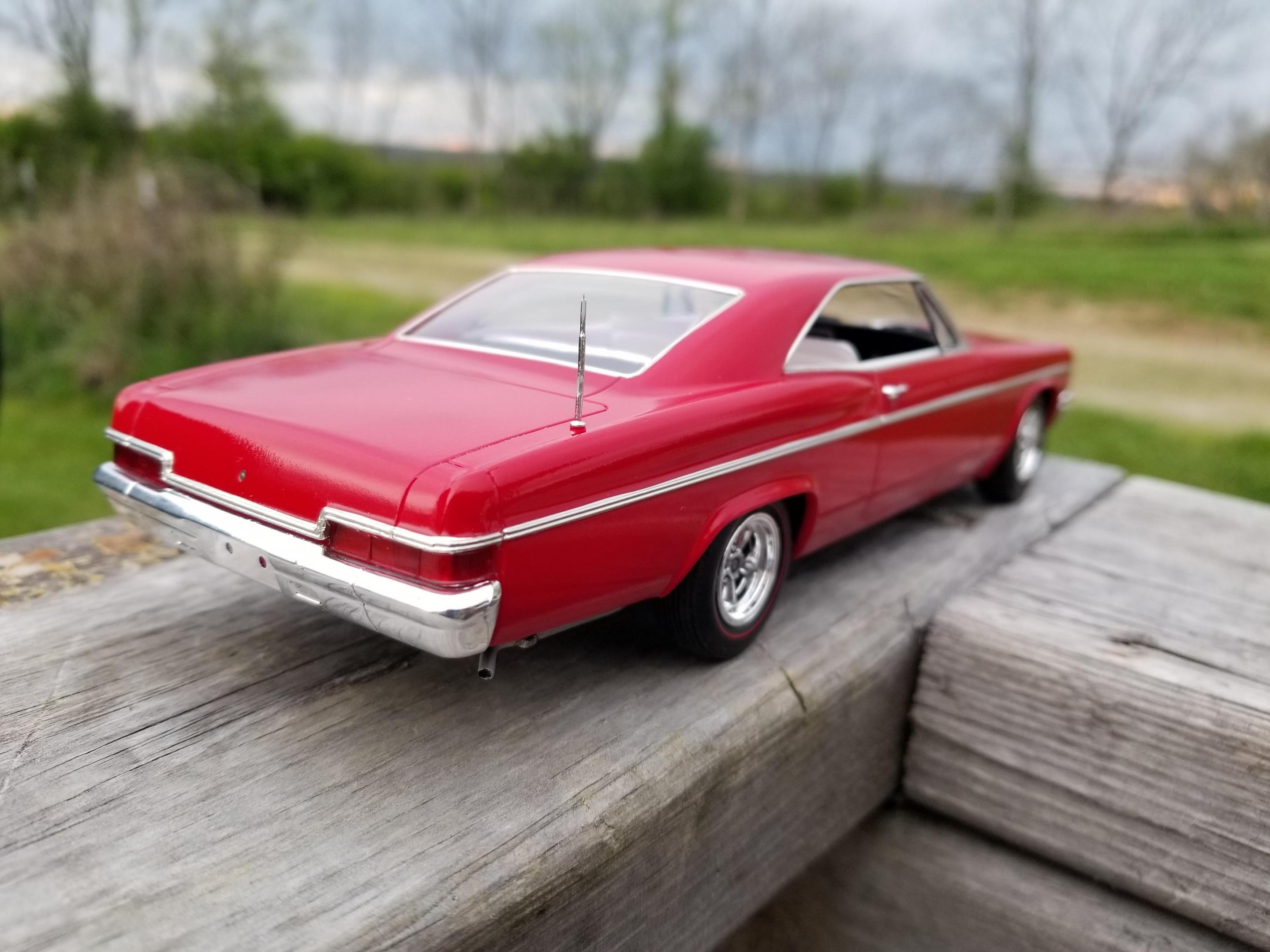

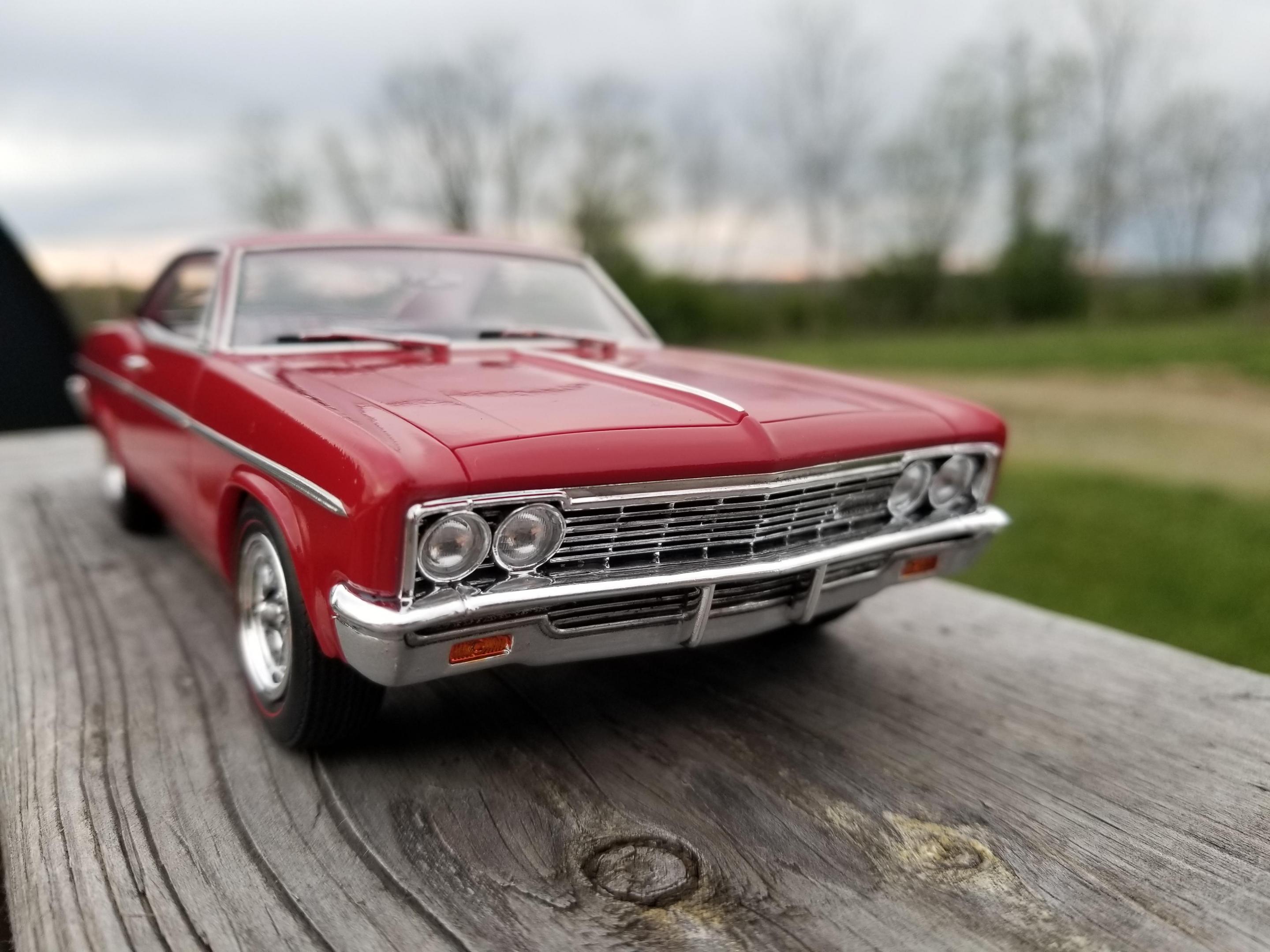

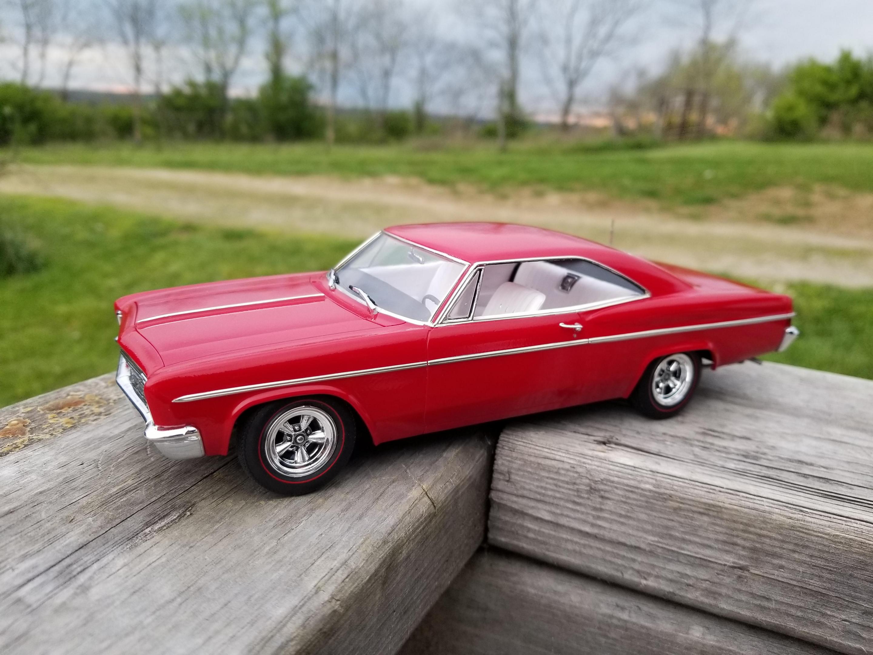

Just finished today. This quarantine really speeds up the build process! I started on it less than two weeks ago. Paint is Testor's Flame Red with their wet-look clear. Rims came from an Amt/Lindberg Dodge 330 with the redline tires from the Dirty Donny GTX. The air cleaner and valve covers are from my junk box. I didnt put the mirrors on (I'll just knock them off by accident) and there's still some Turtlewax in the panel lines. I also shaved the emblems, as they're getting harder to paint as I age lol
