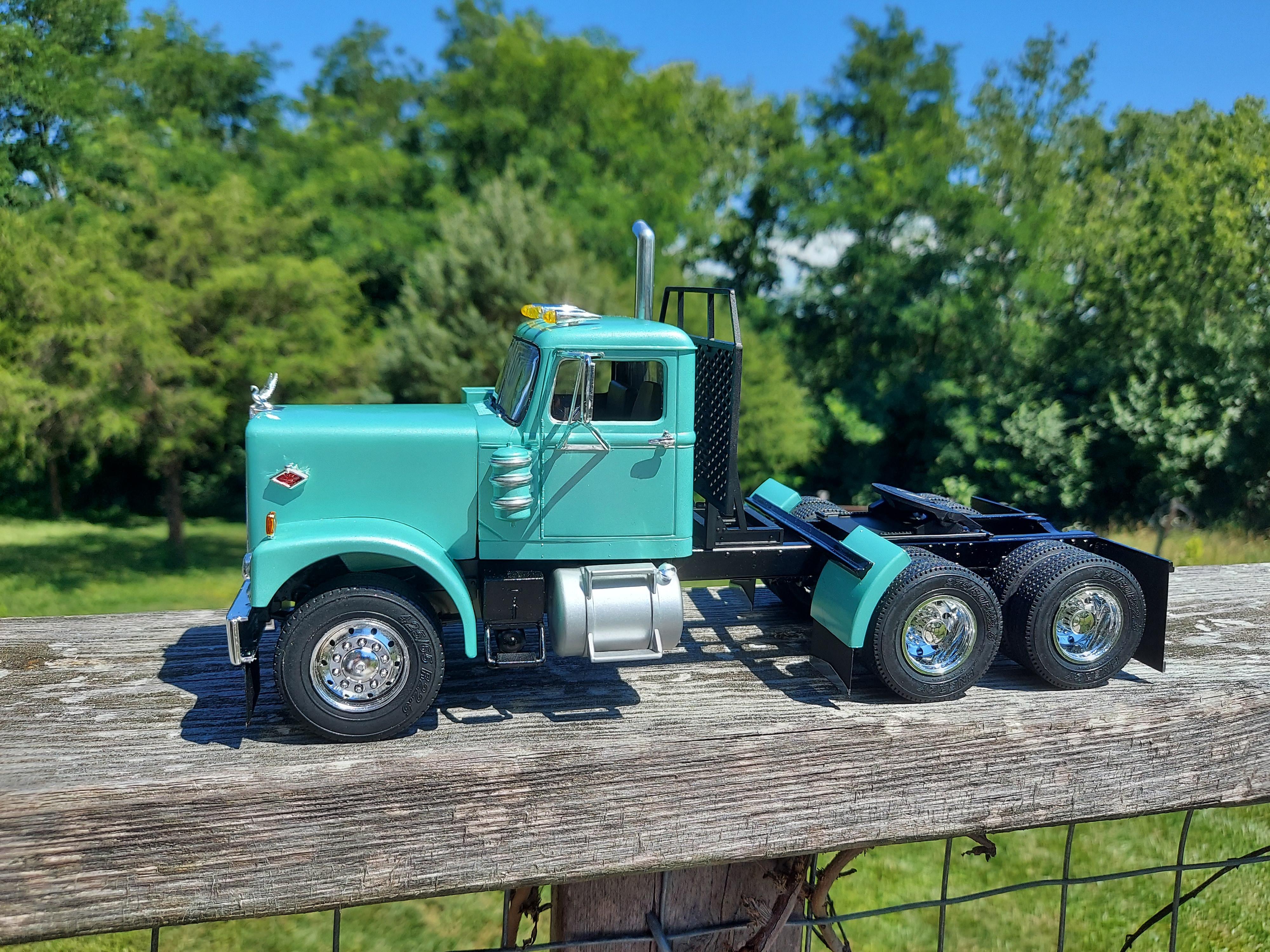

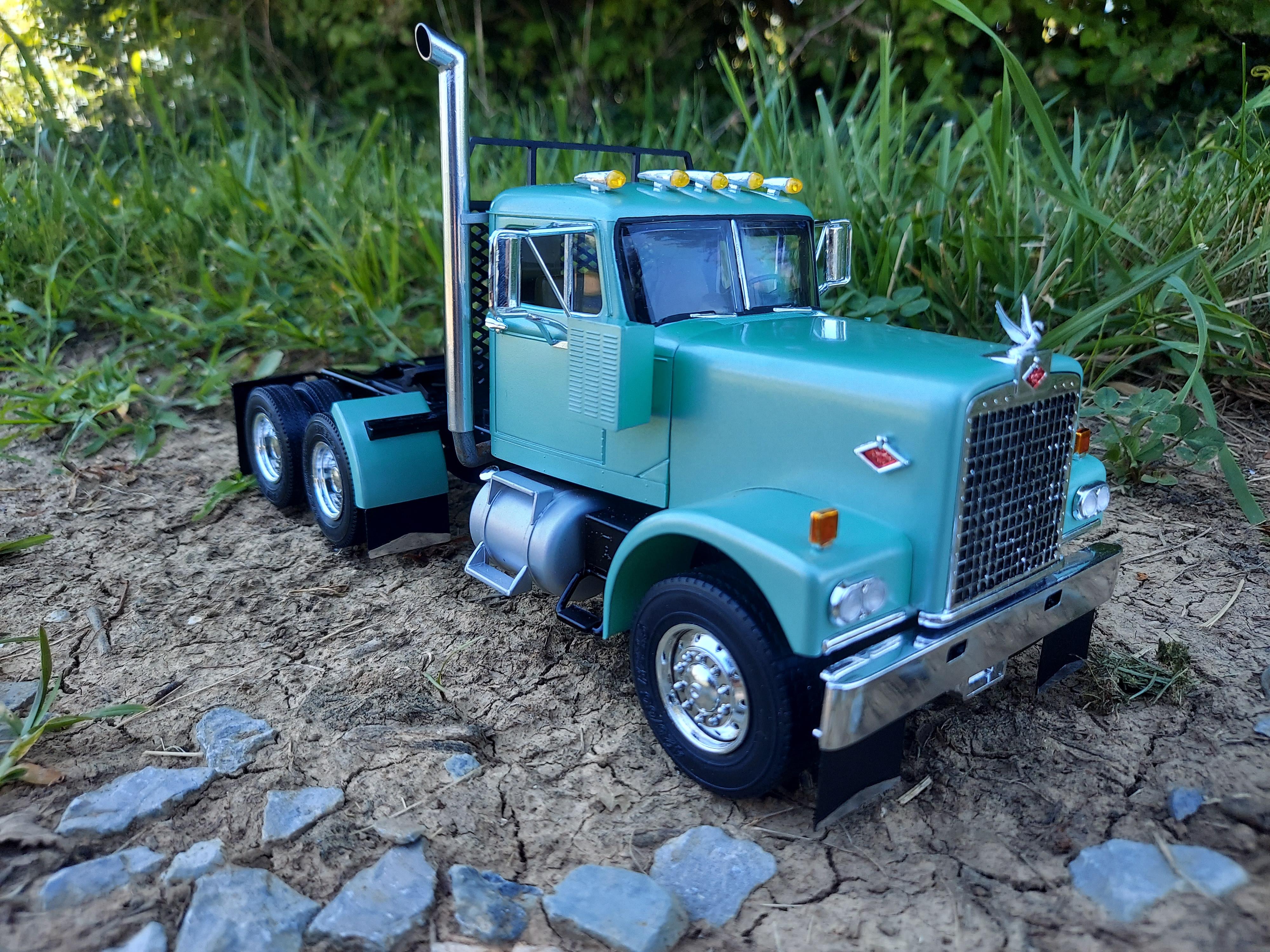

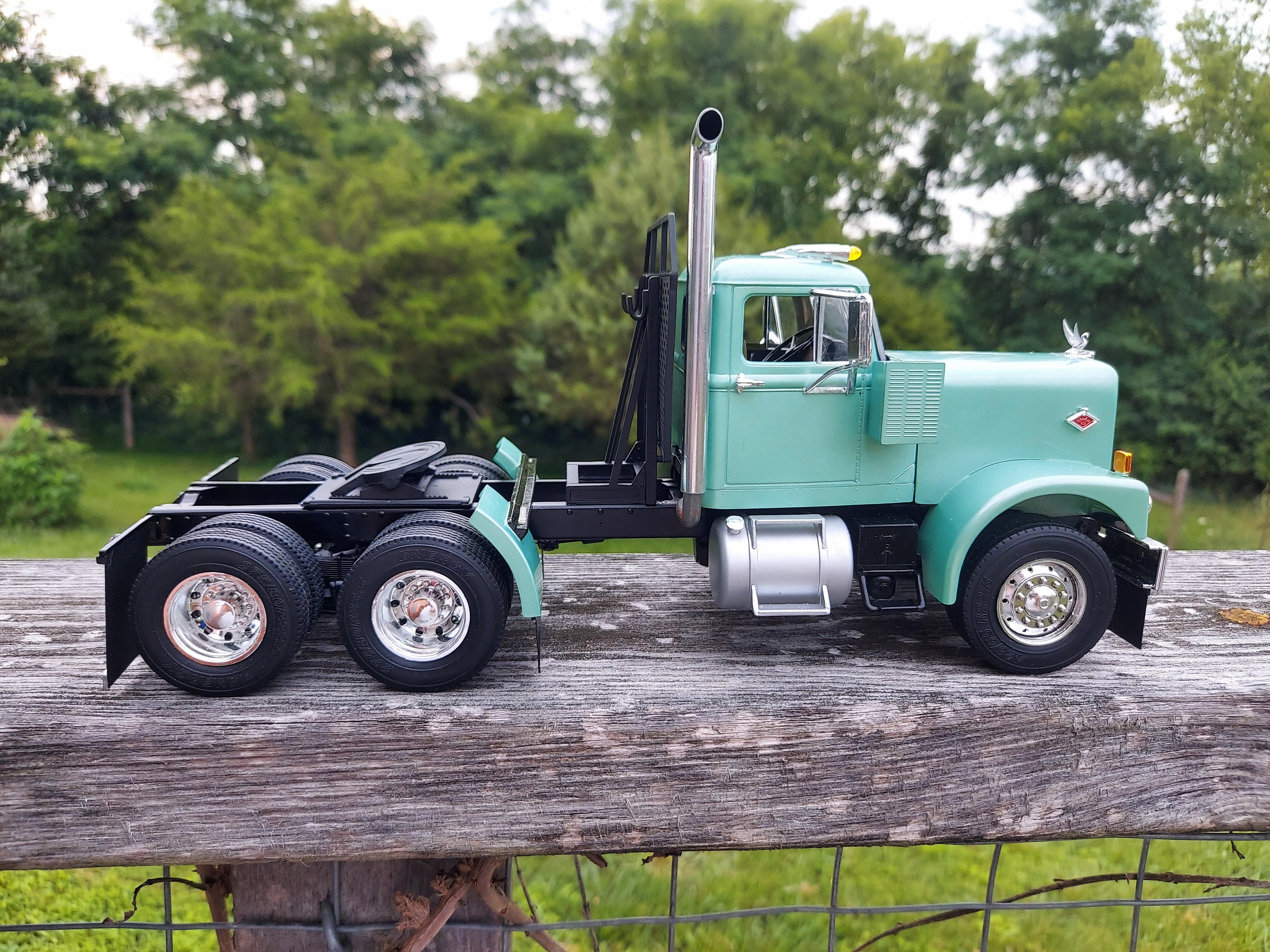

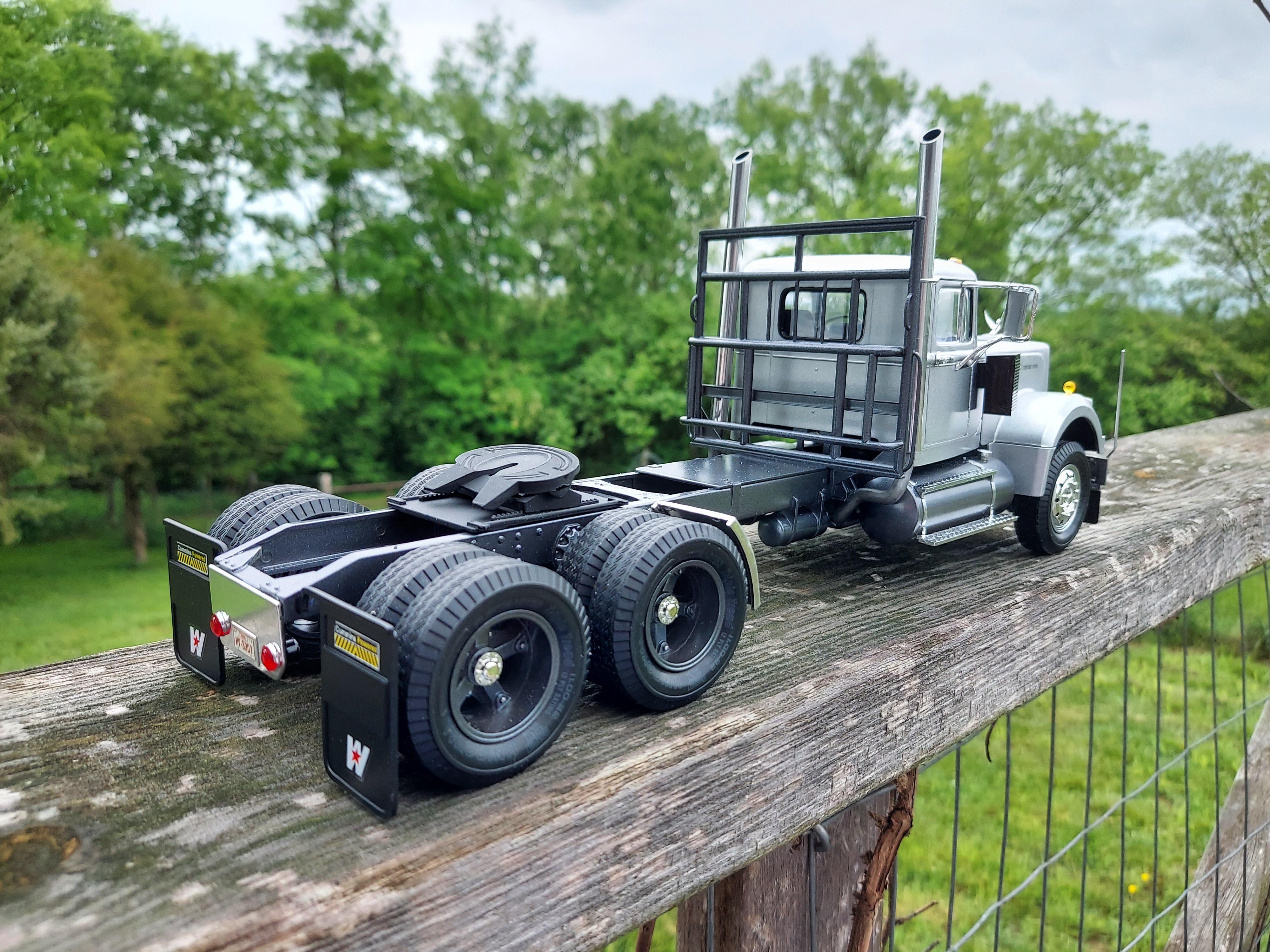

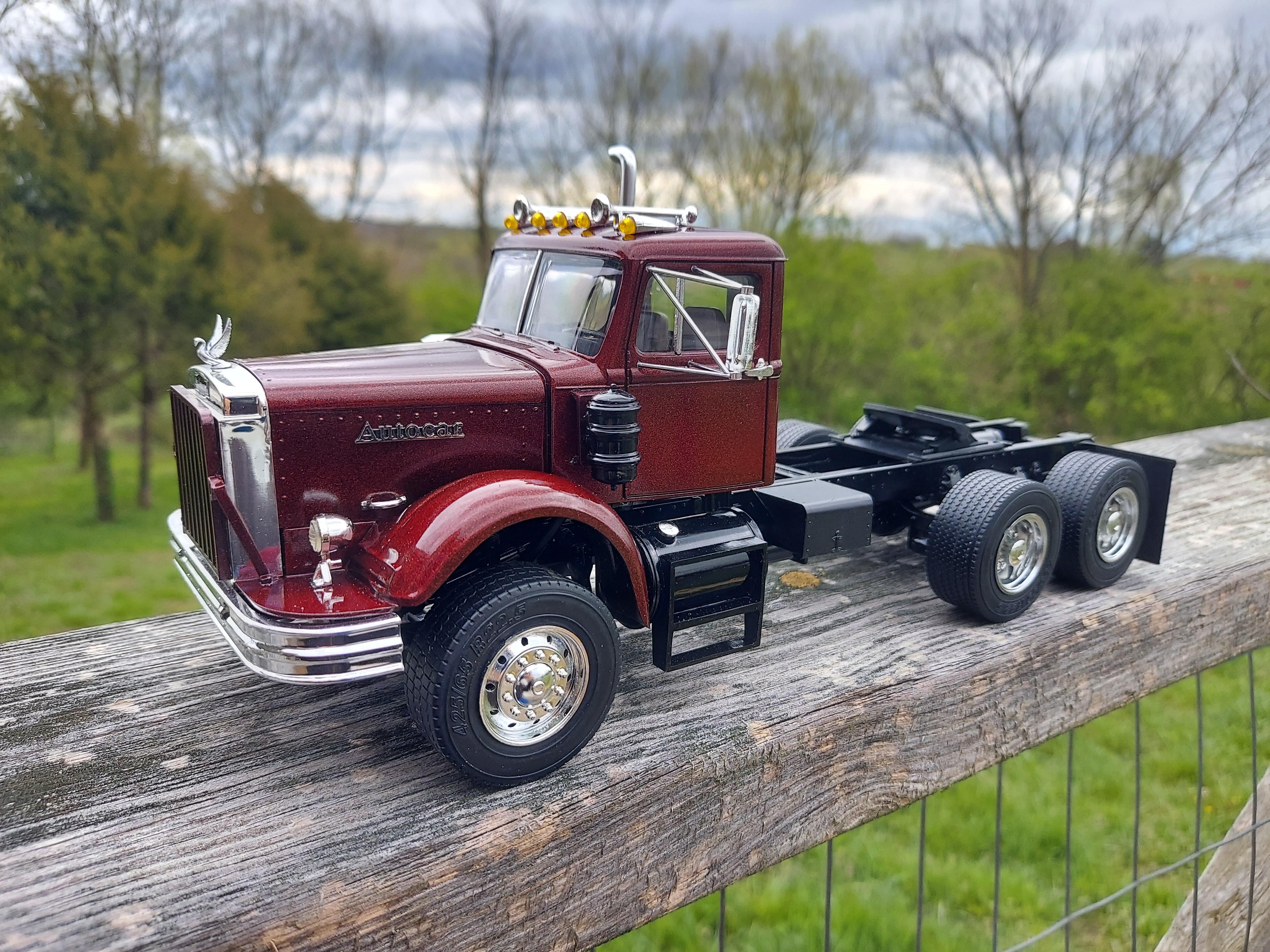

Latest build. I don't have enough company trucks, so I added this one to the shelf. The frame was shortened, and Astro tanks and a parts box battery box were used. I bought the Budds on ebay. They're not as good as those I usually get from ST Supply, but they'll work. Air electric, and engine bay hoses were added. Decals are from the Cruiseliner kit.

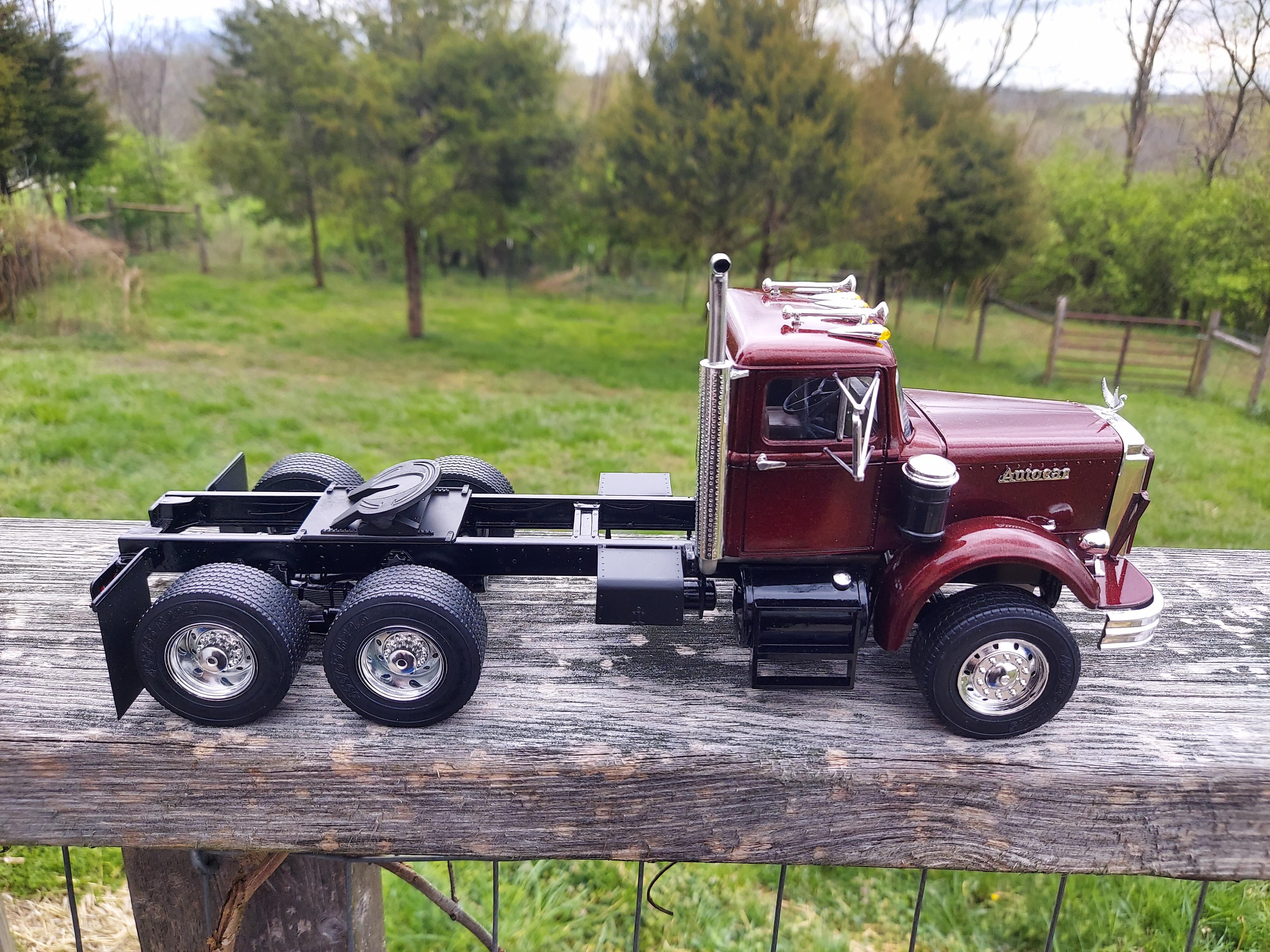

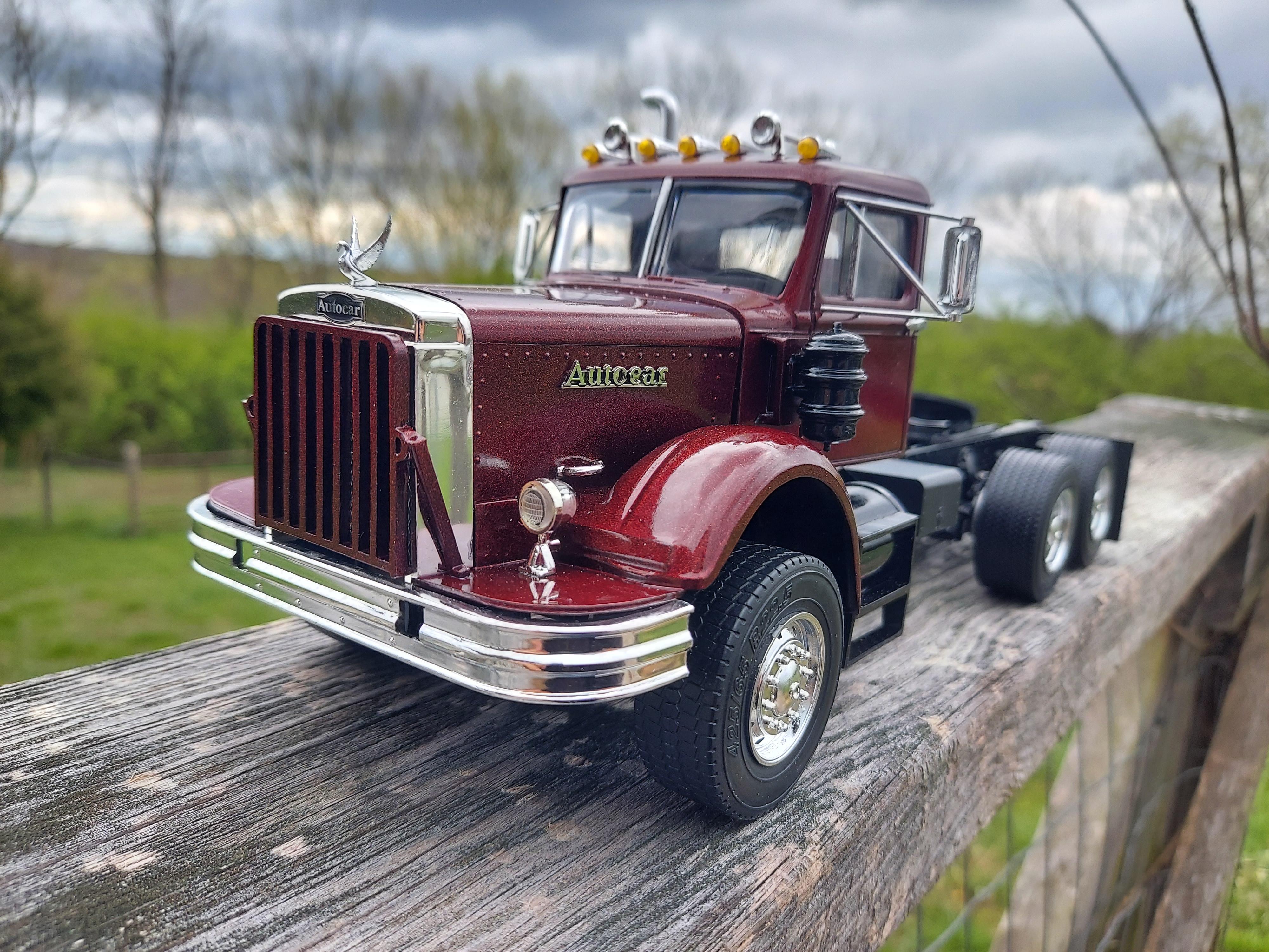

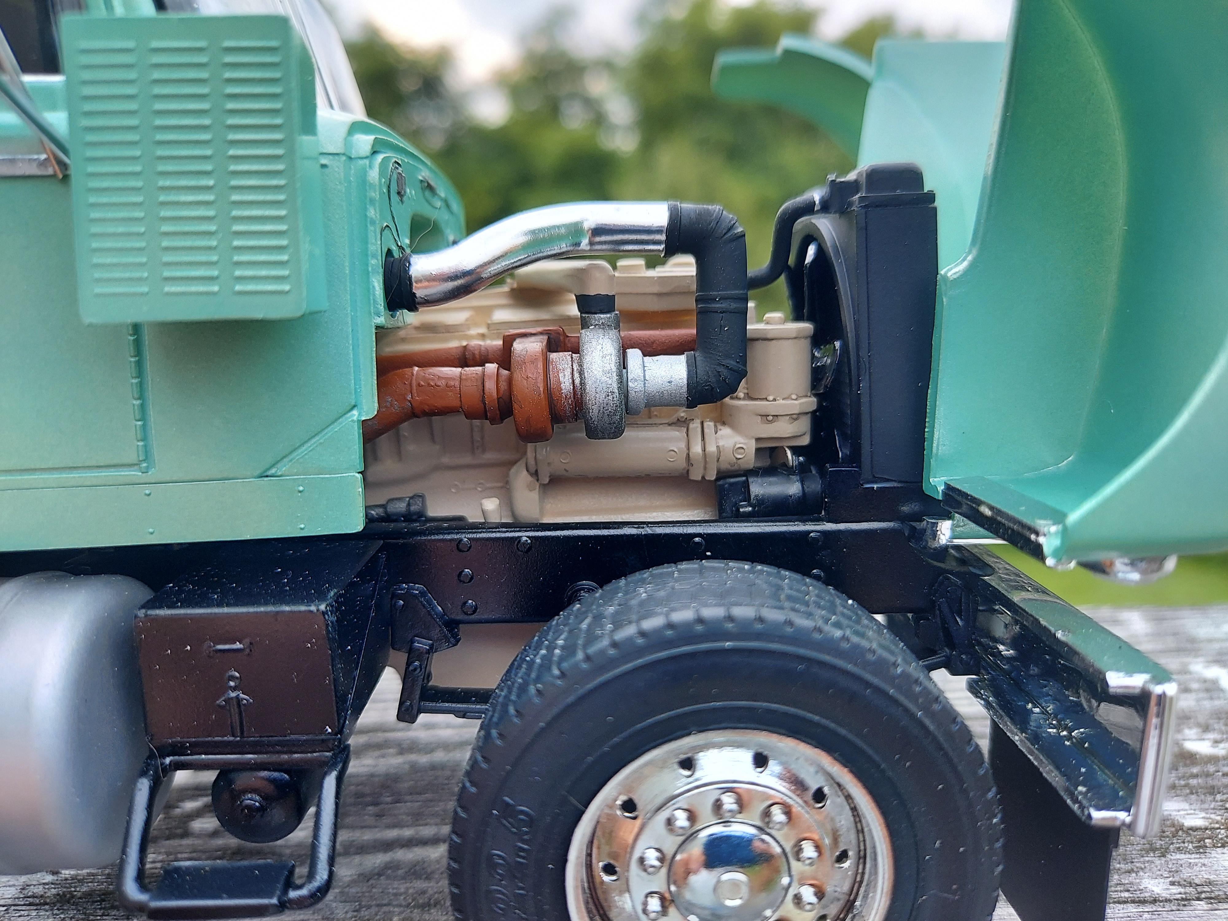

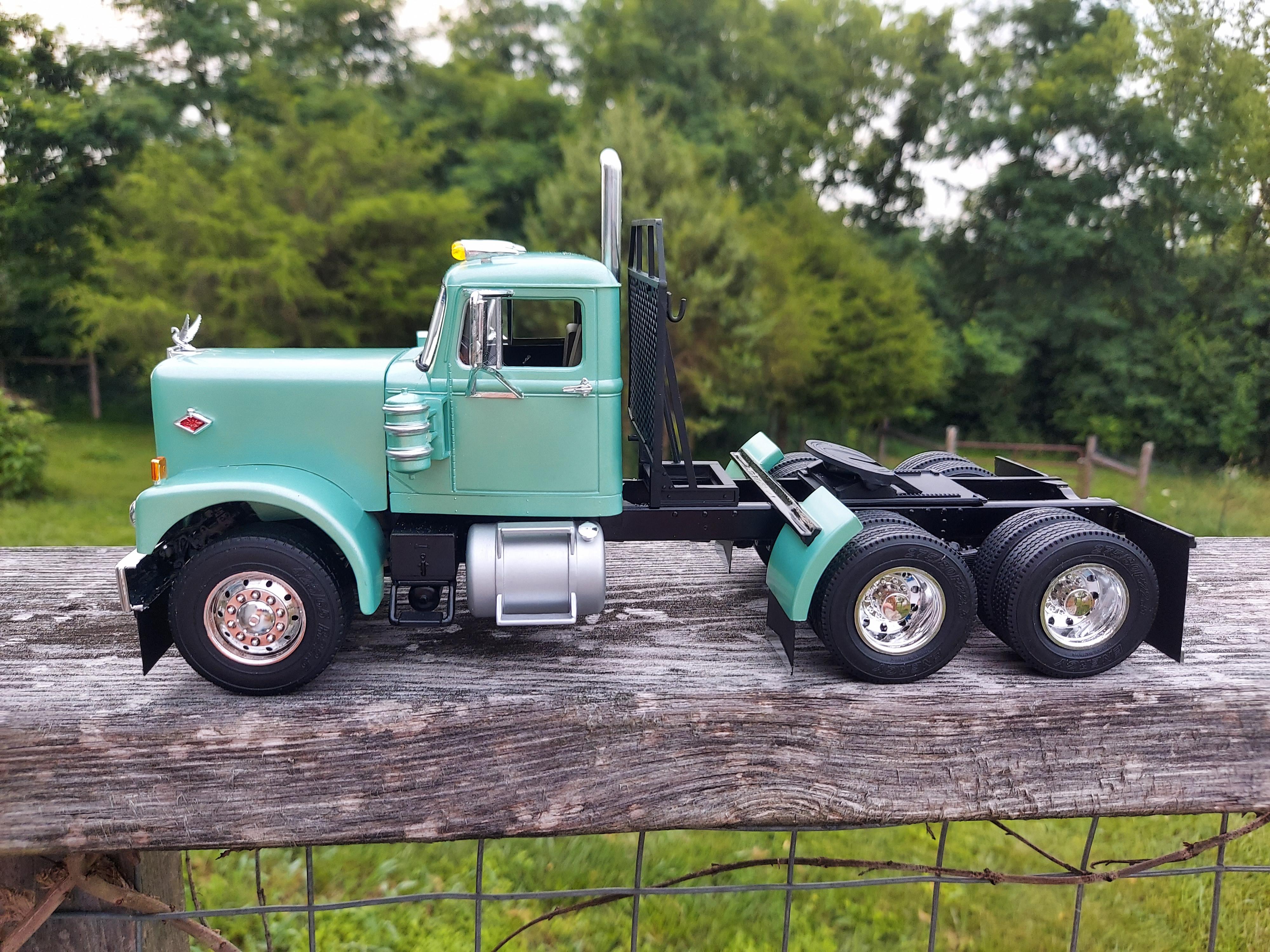

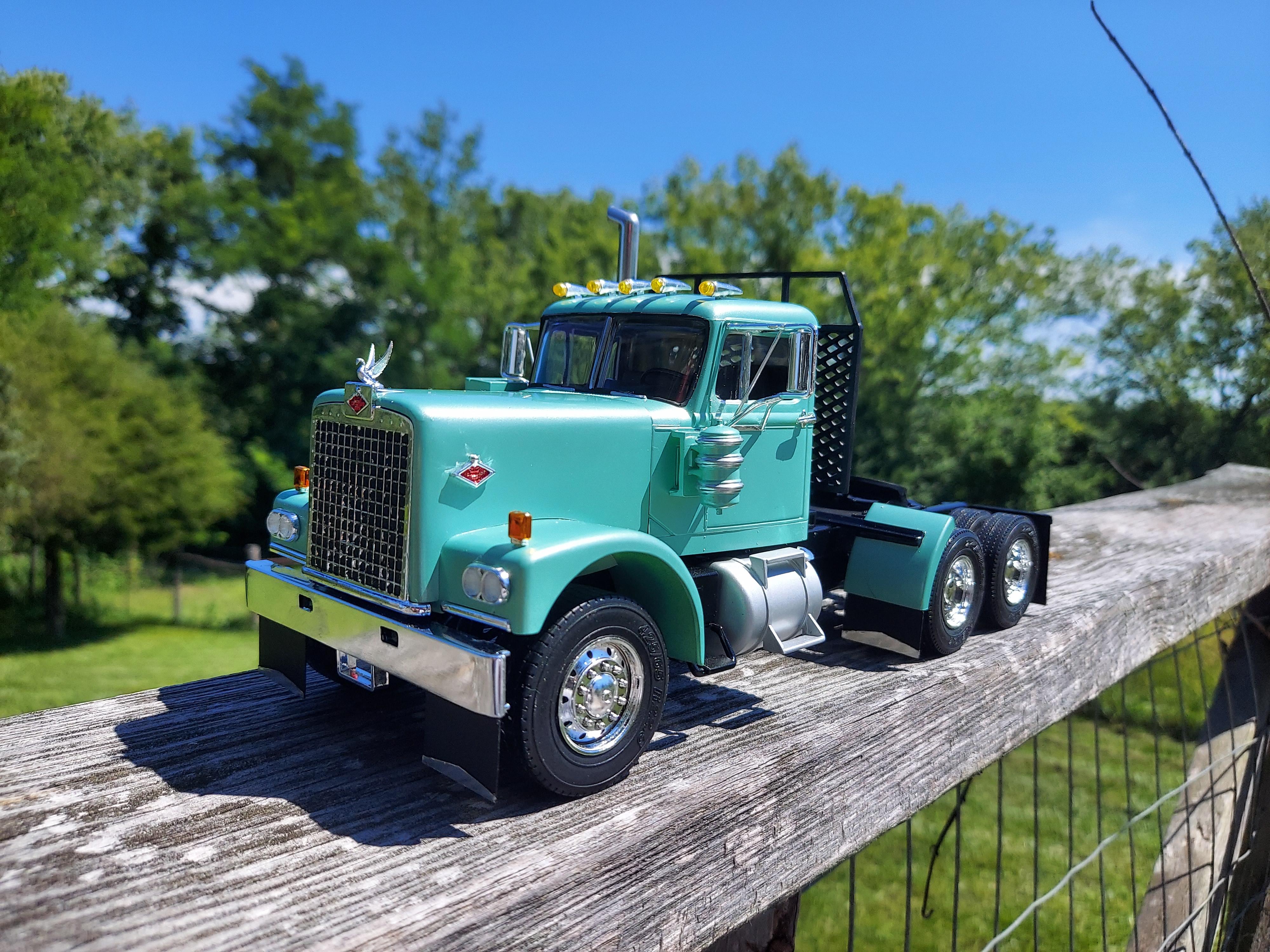

Built from the recently reissued Amt kit. Although, as a daycab, I doubt it's suitable for crossing the country. Paint is all Tamiya. Lots of scratchbuilt parts, including the mirror brackets (I hate Amt's mirrors) pogo stick, some engine parts, and a couple of relays. Converted to single tank using a chrome Kenworth item with the Peterbilt step, which fits pretty good. Stuffed in as much chassis electrical and air lines as I had the patience for. To be different, it got a single straight pipe.

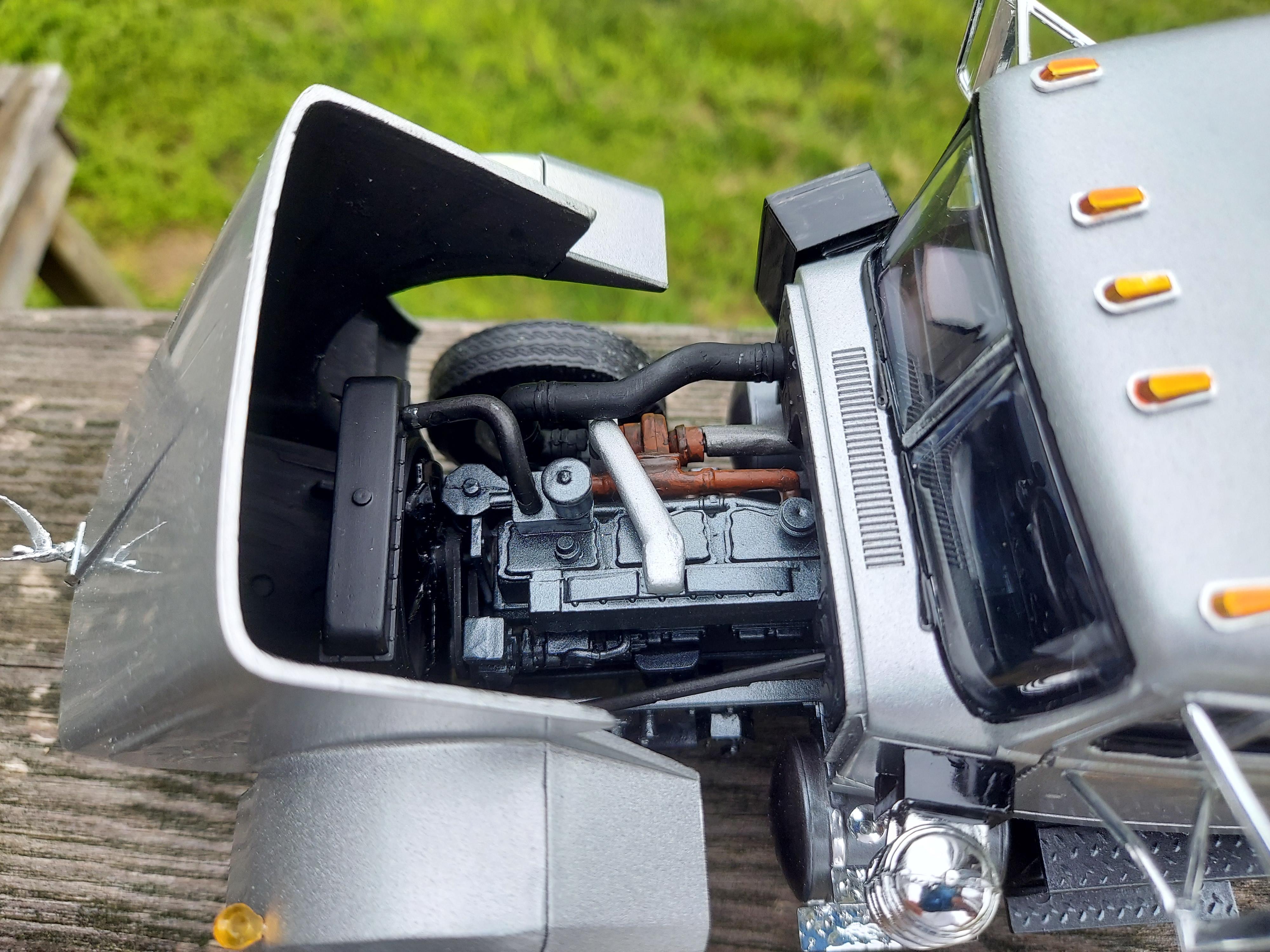

The intercooler and intake pipe are kit supplied, but heavily modified with strip styrene and lots of filing and sanding.

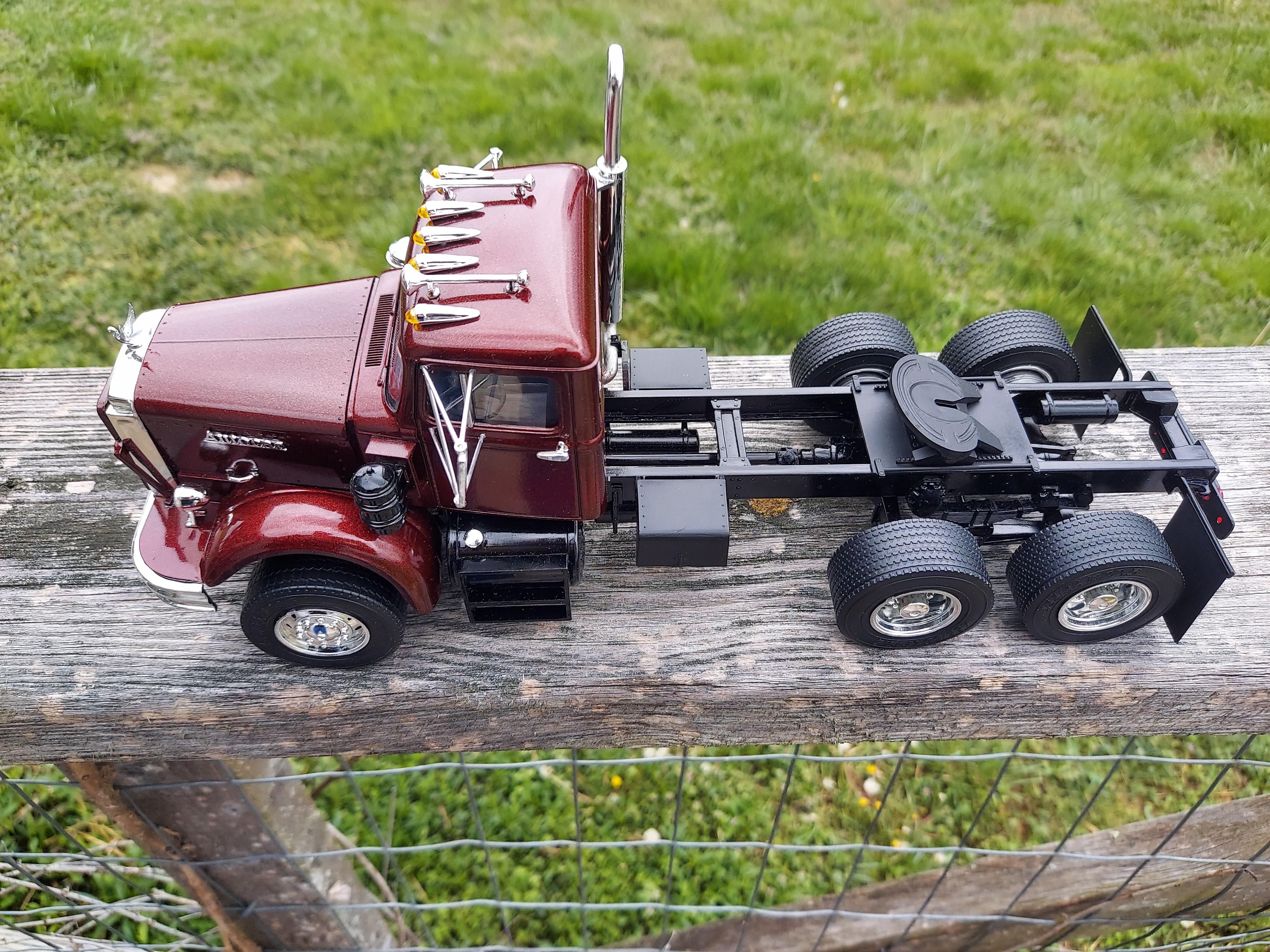

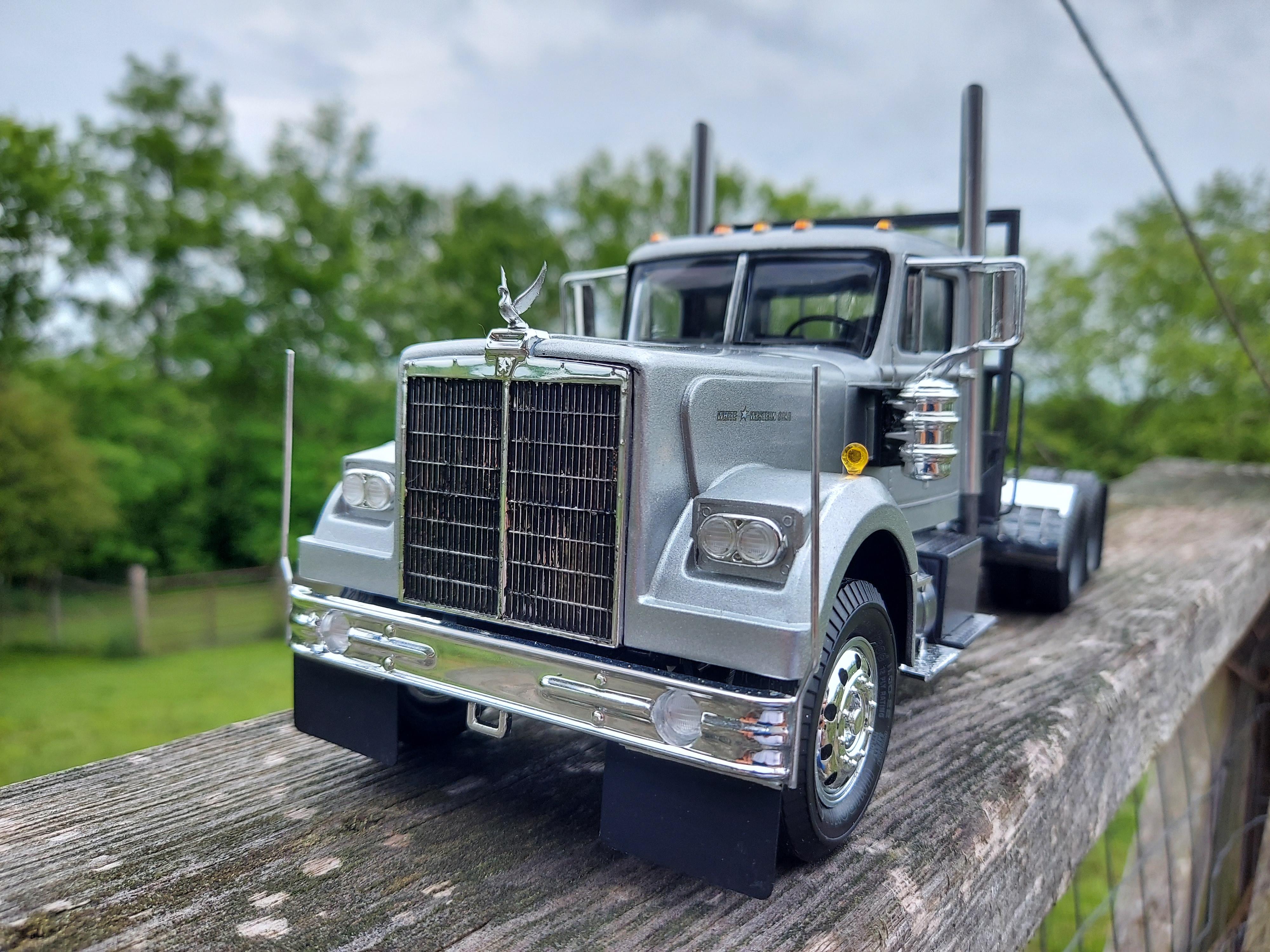

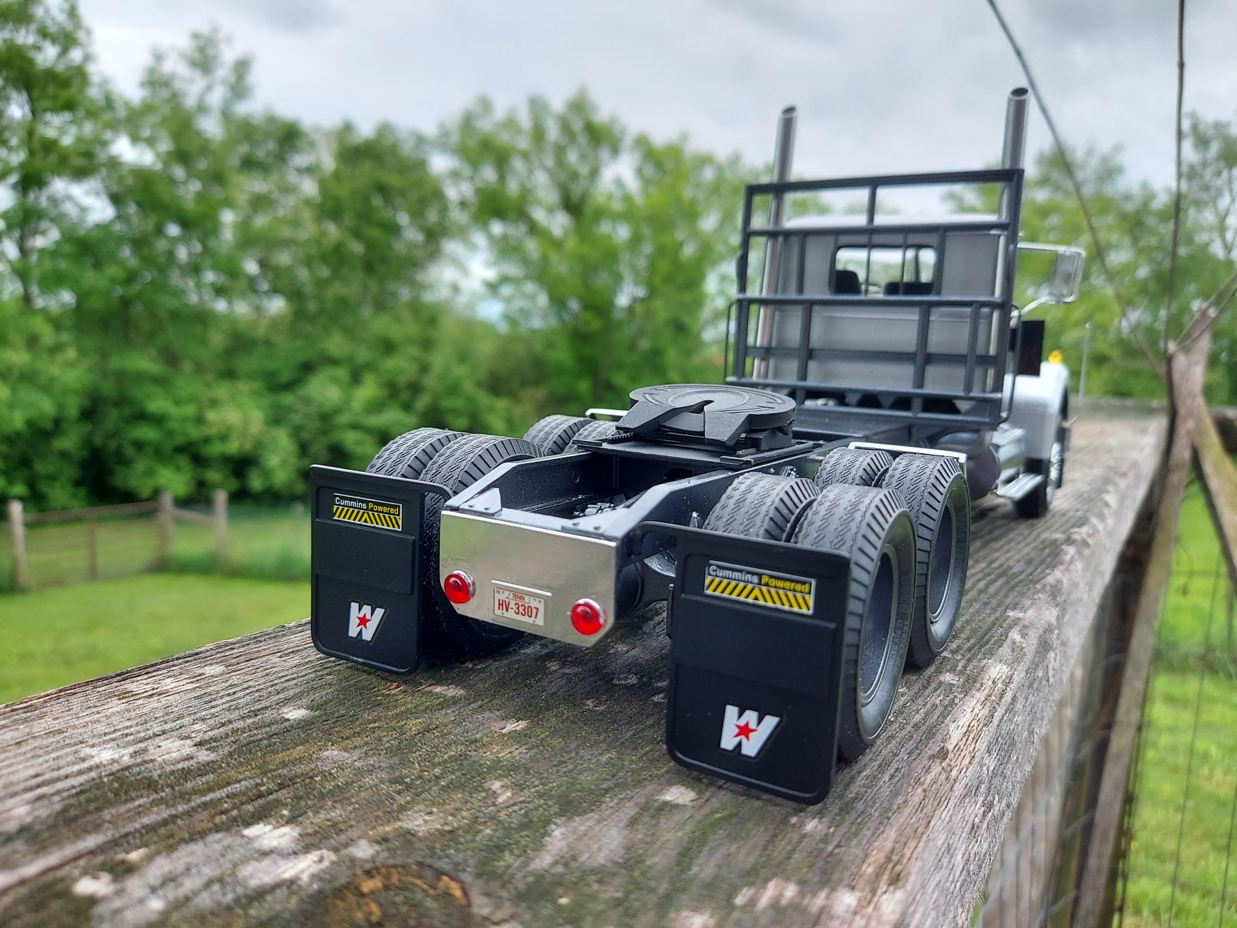

It's starting to look like I have a thing for single axles lol This is the 2nd 921 I've built. This one started as the mixer kit from Ollie's. The rear axle and springs came from the White Freightliner, as well as the wheels. Unknown battery box was put behind the cab so it could have two under cab fuel tanks. As with all of these Amt Kenworths, the glass had ejector marks, so I cut new windows from clear plastic blister packaging. I went a little overboard with air electric lines, especially since all of them are sprayed black and partially hidden. I also converted it to single air cleaner, single headlights using amt 51 Chevy bezels, scratchbuilt the mud flaps and luberfiner.
