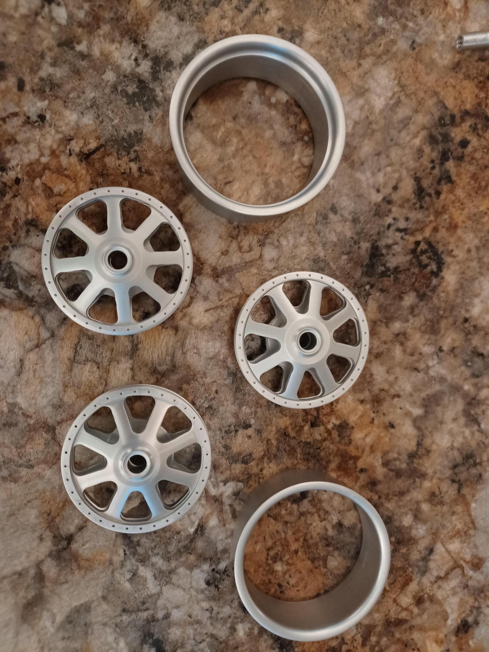

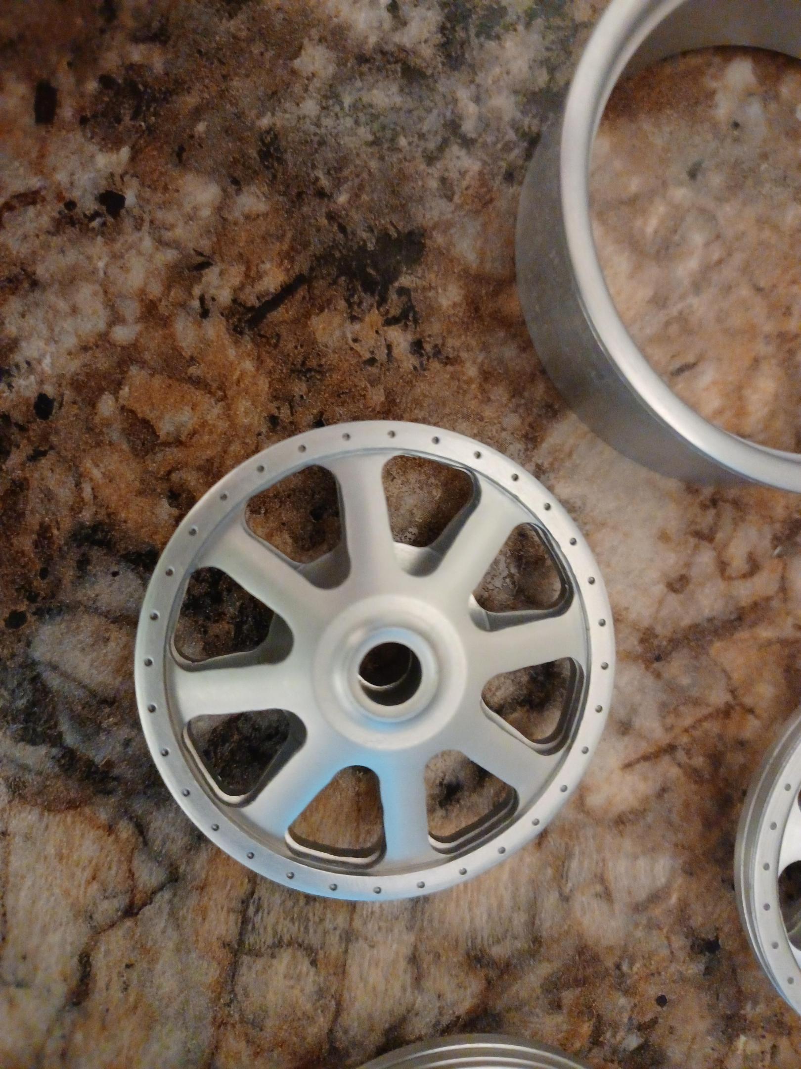

  1. every time i check your progress it makes me smile , your work is just so nice.the doorhandle and the grille emblem are outstanding. have a great holiday.charlie

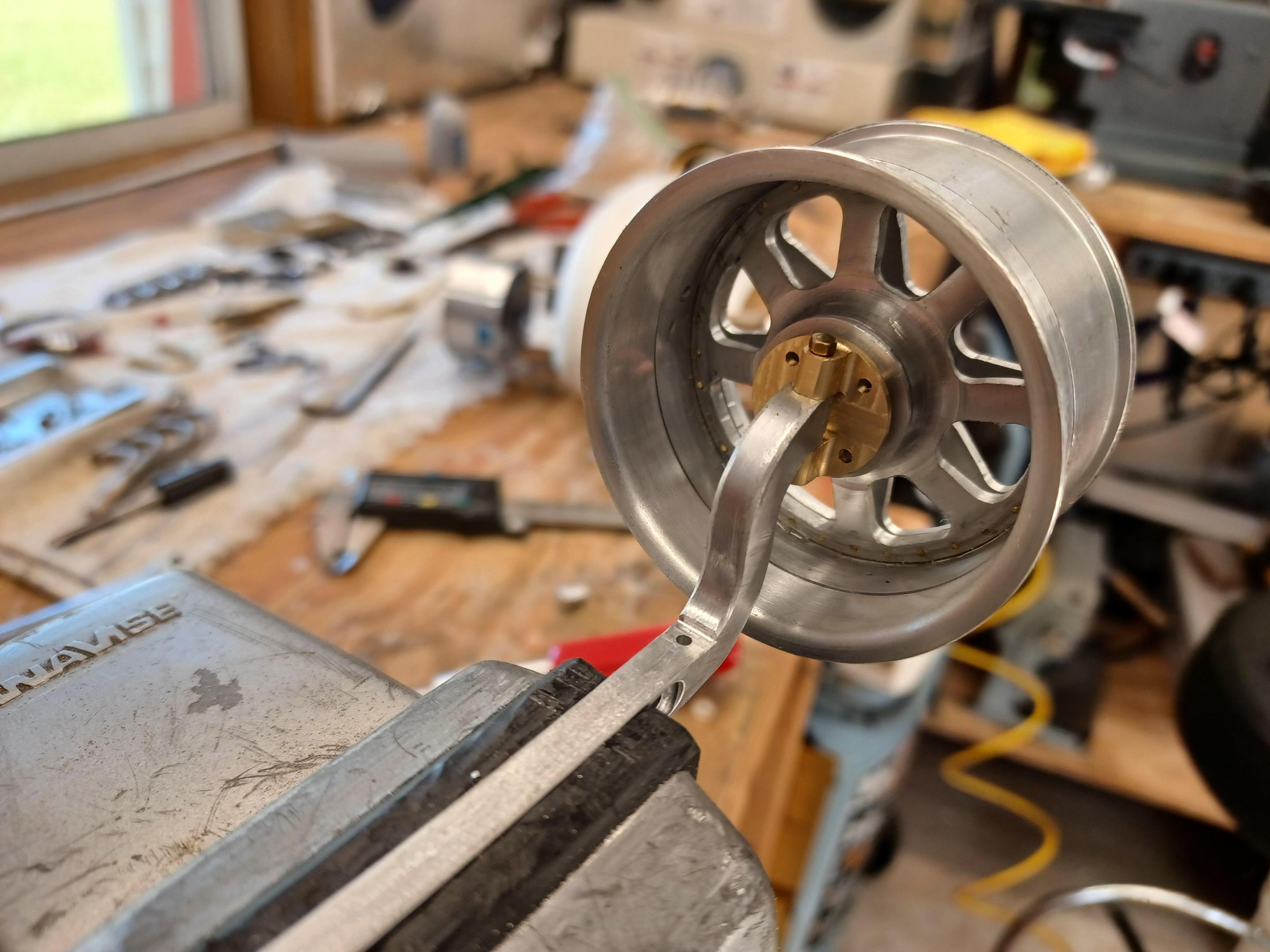

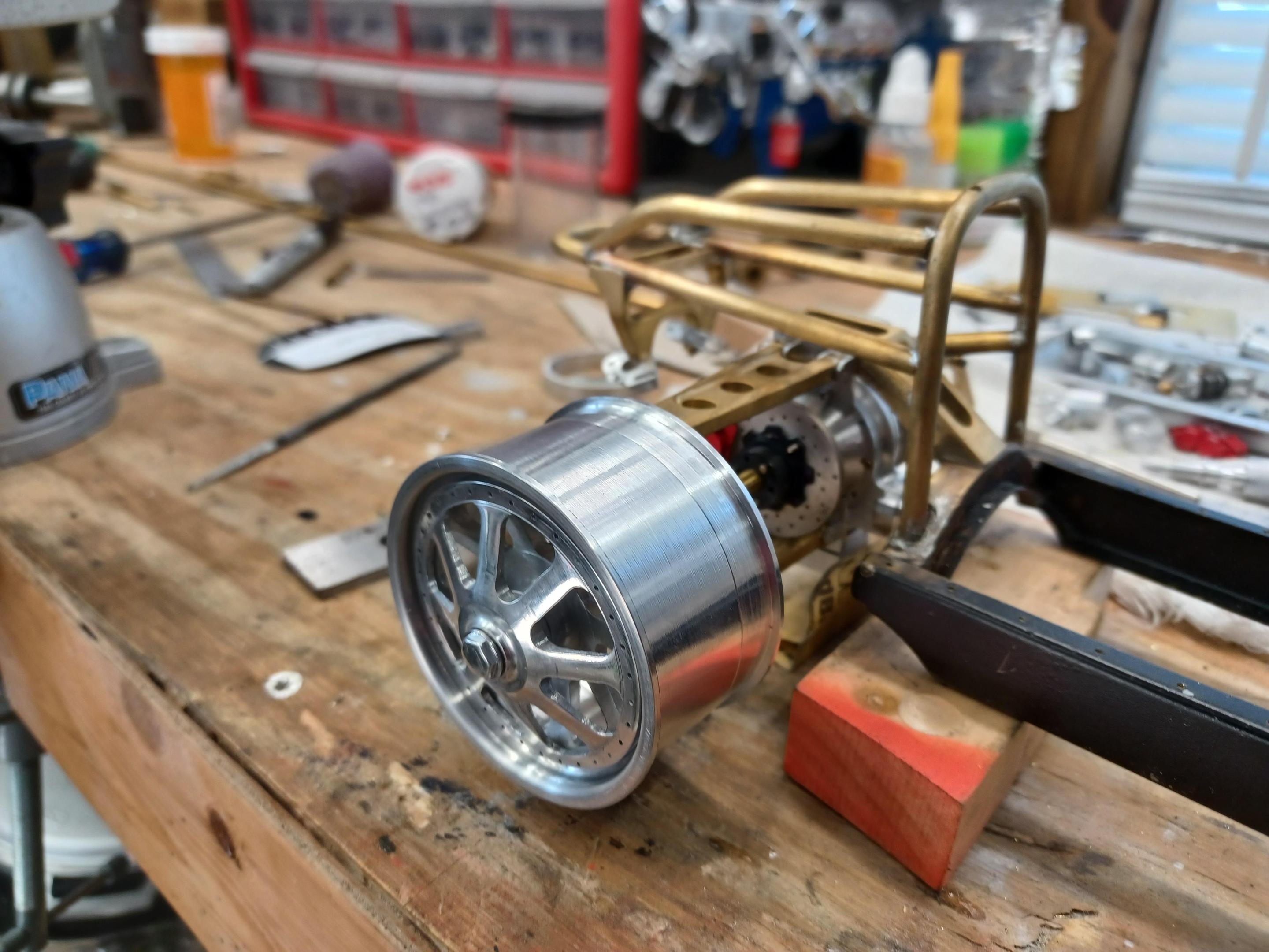

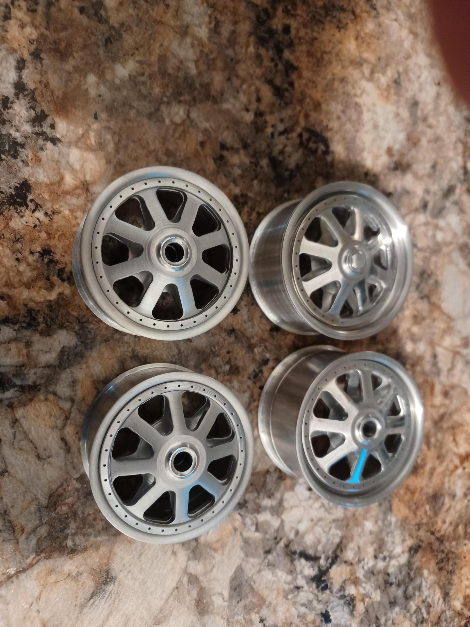

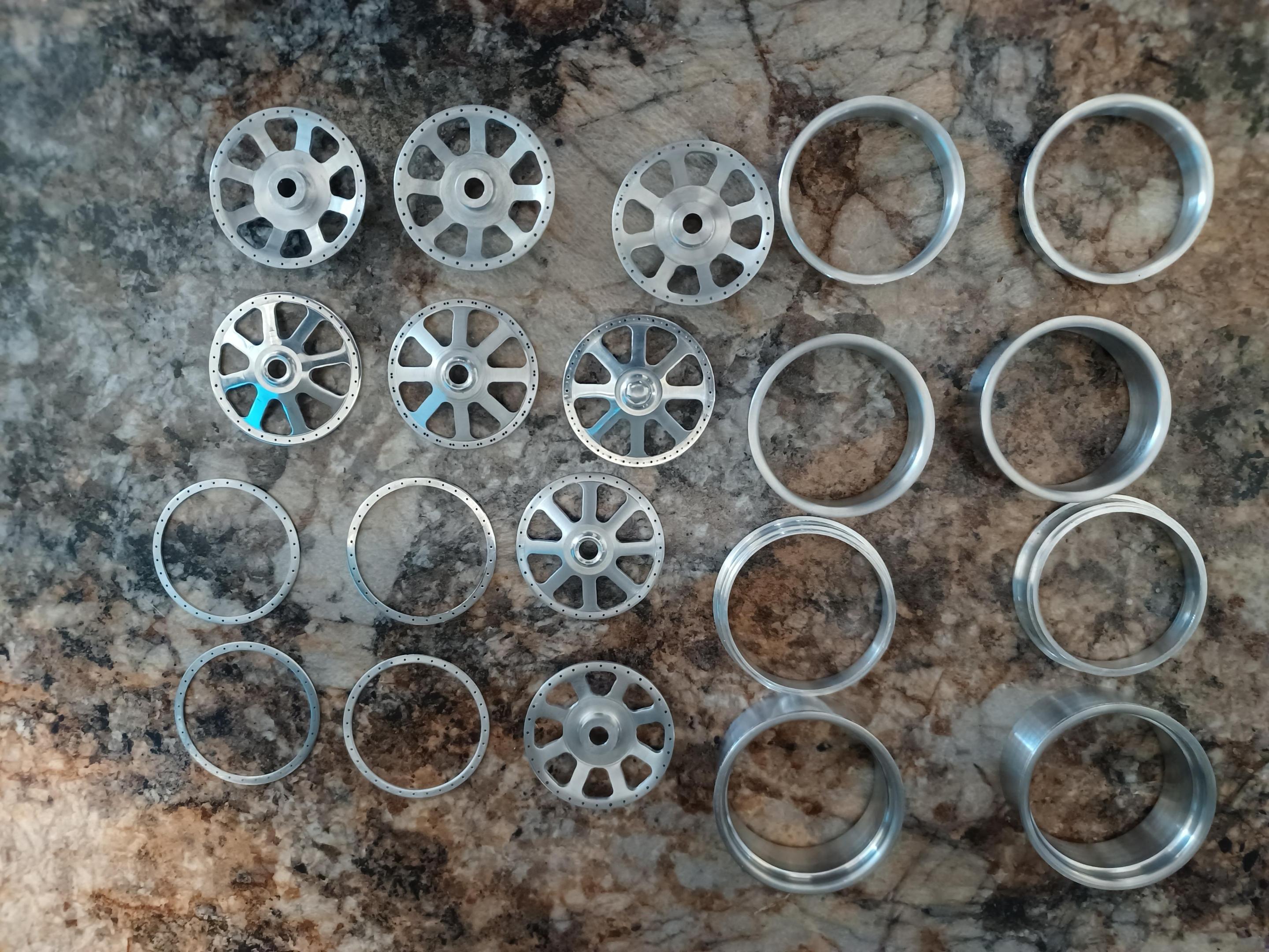

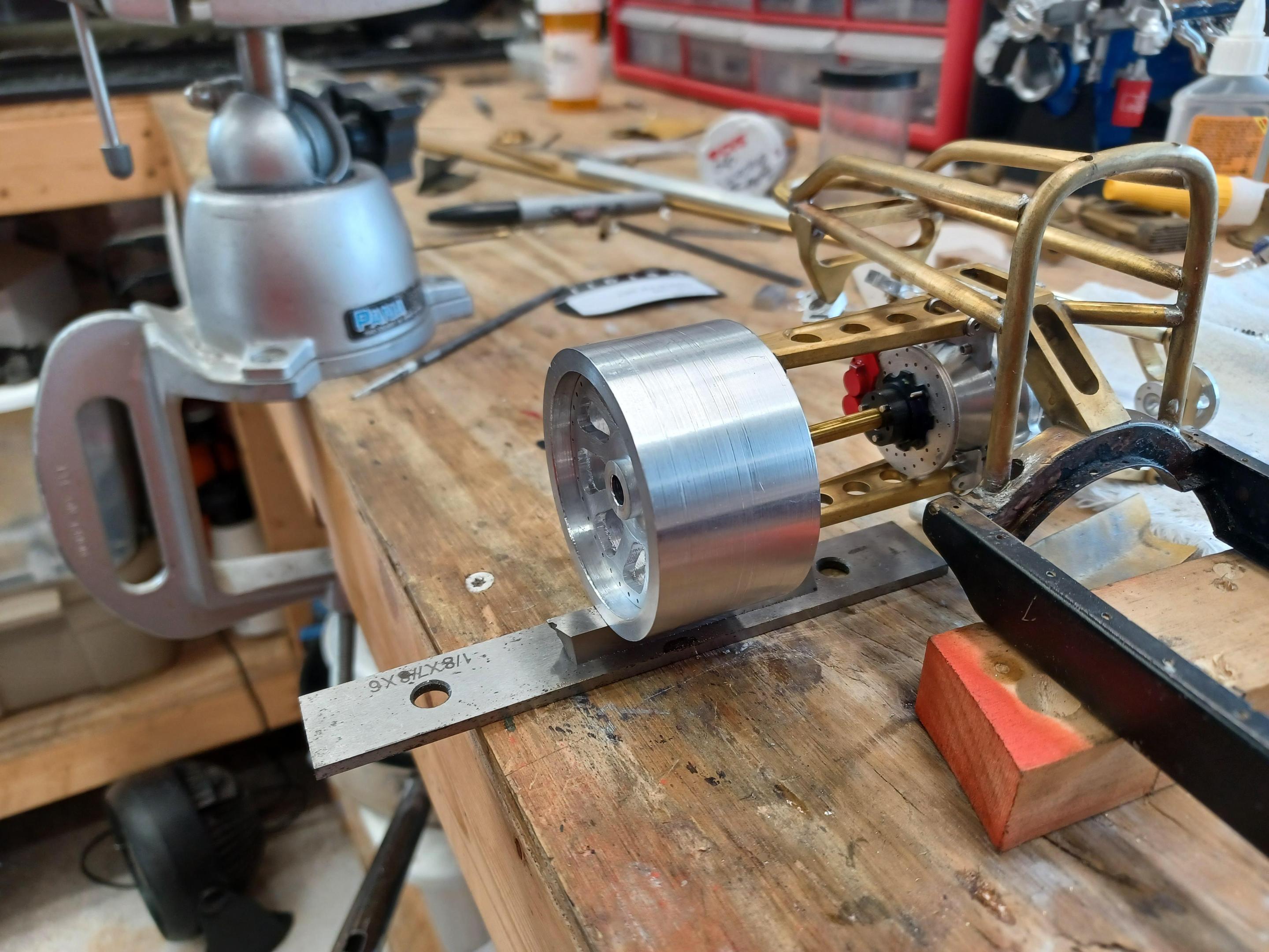

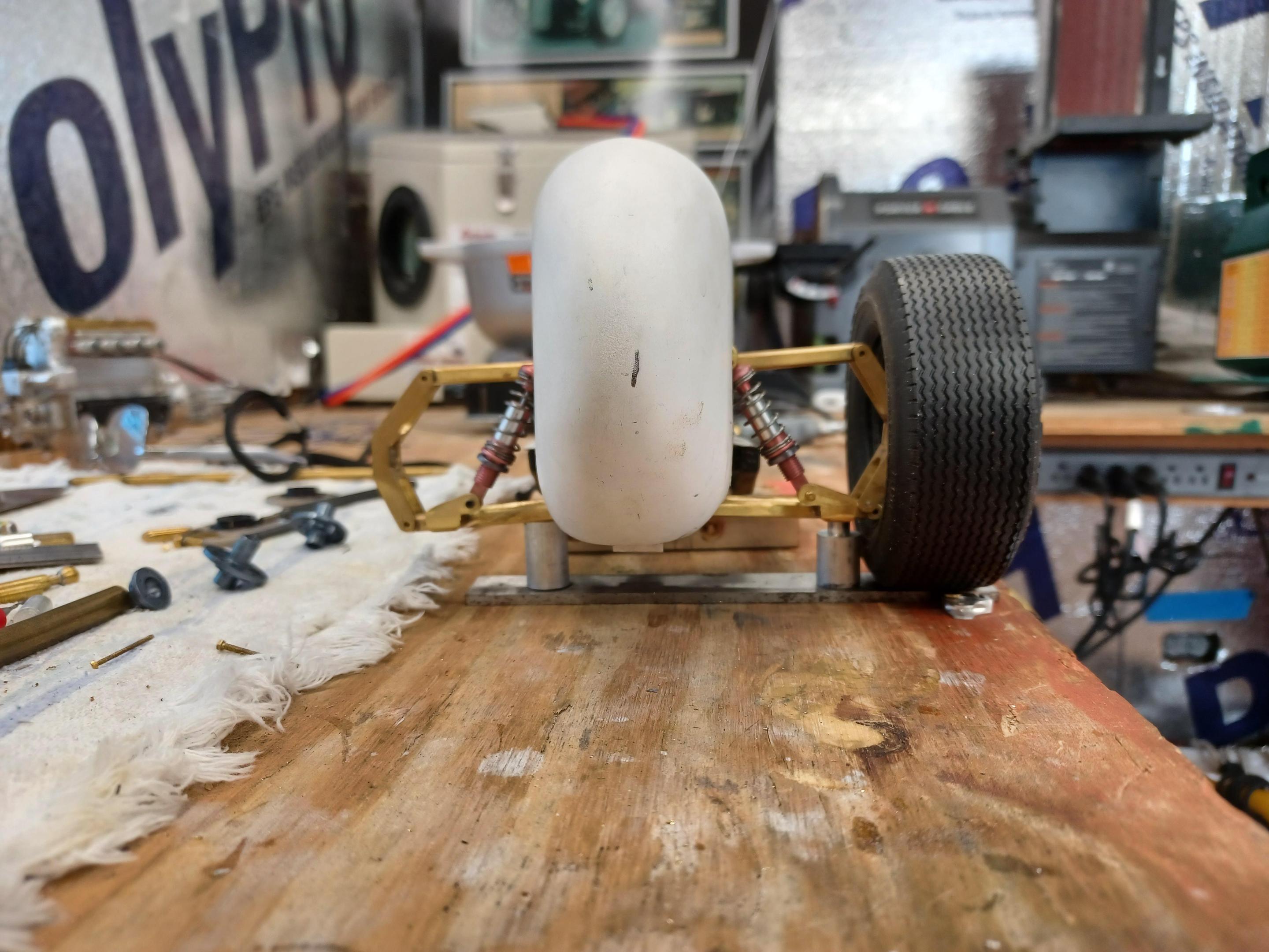

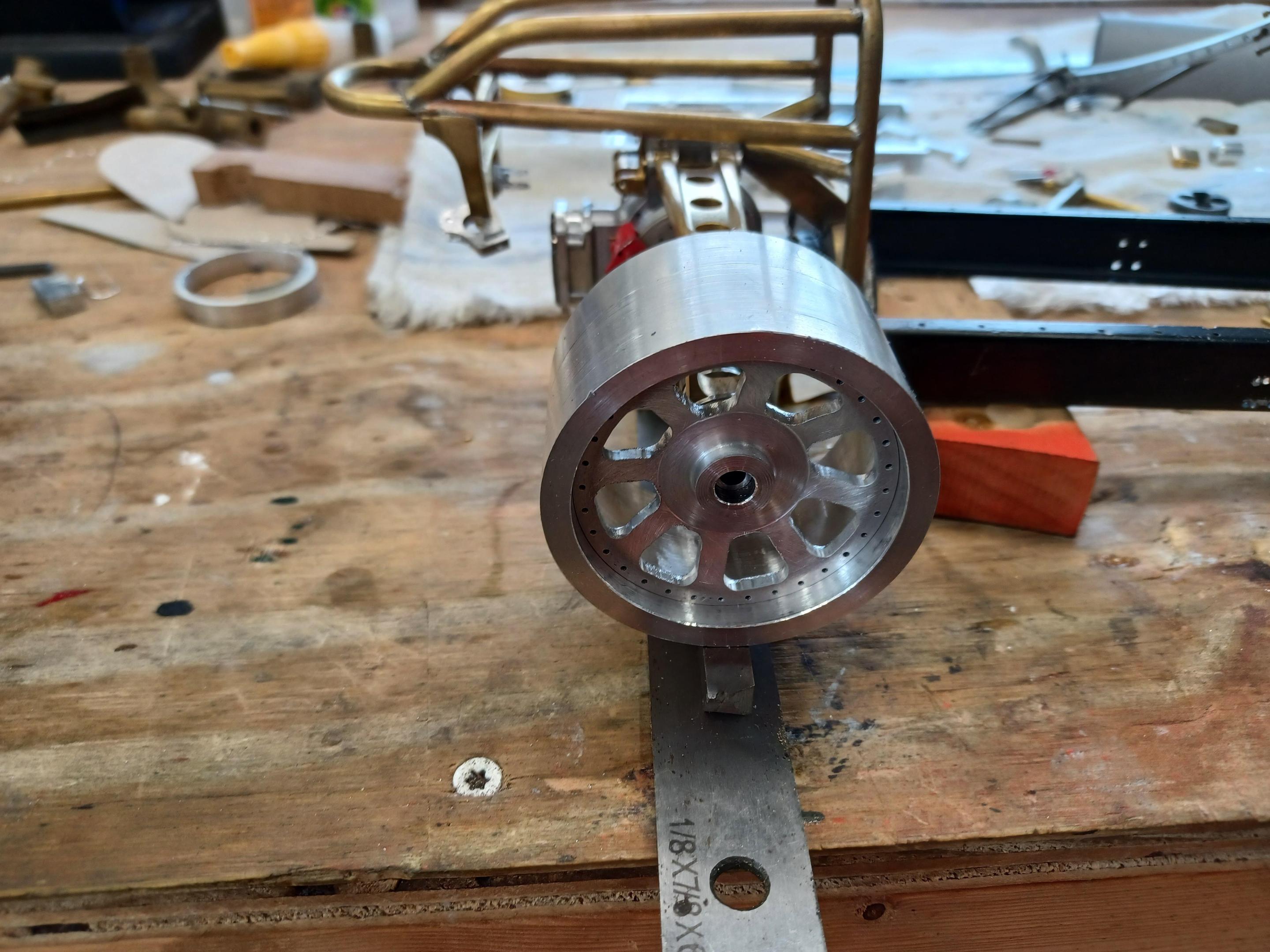

  2. i have finished the tires and wheels. i think they look pretty good. i am working on the steering and i have to finish the front rotors. i cast the tires over size and machined them to size. i used ziploc disposable bowls to make the rough casting.i got a good start on the front end . got the 4 bars end mounts made and now the coilovers and steering. i have to remove the crossmember in the front. hope you all have a nice holiday.

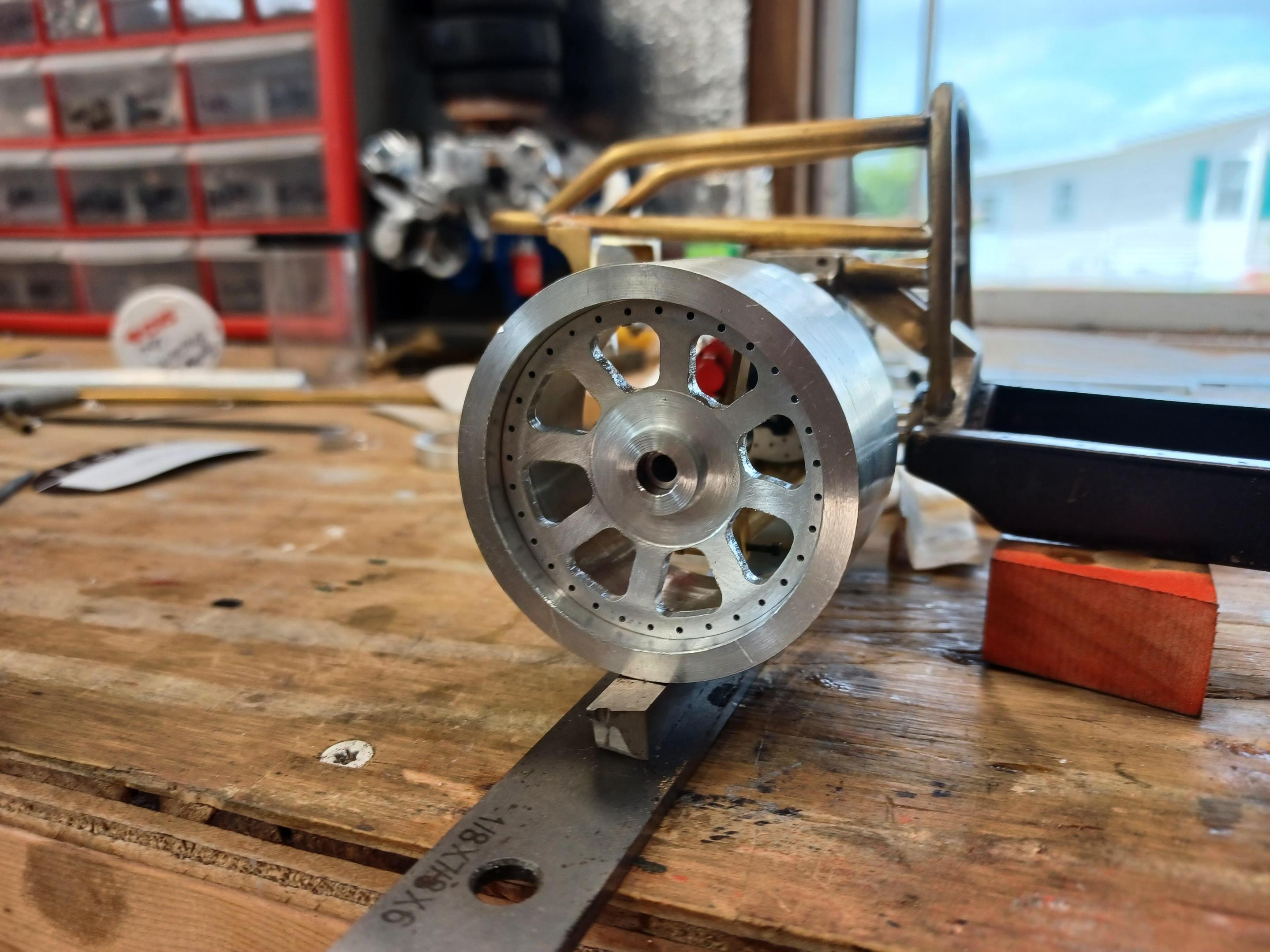

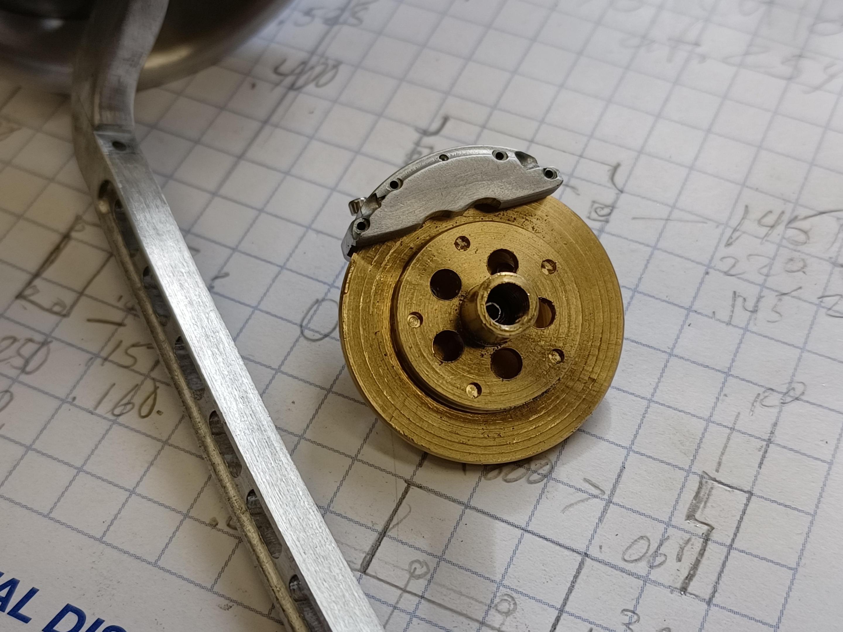

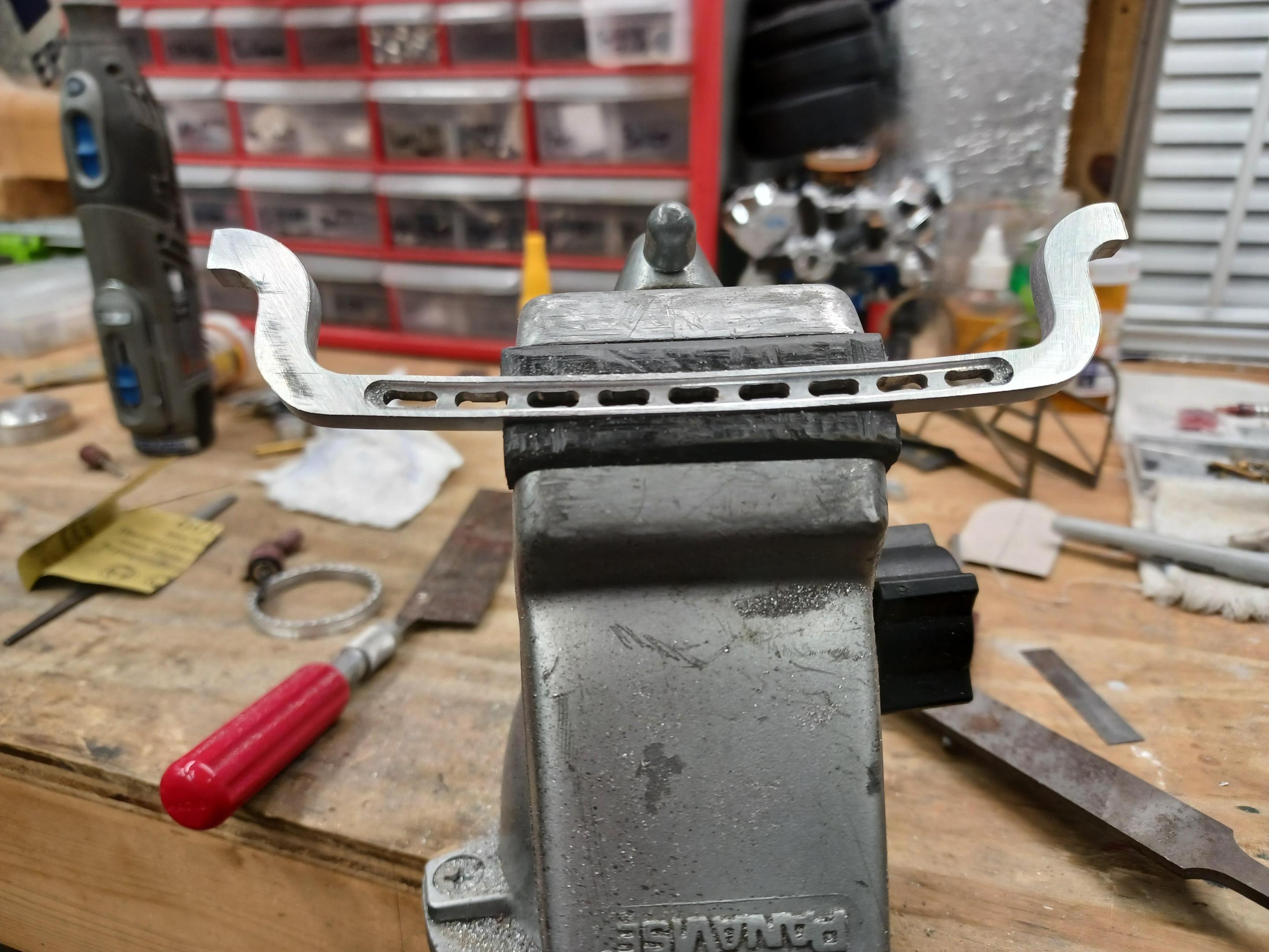

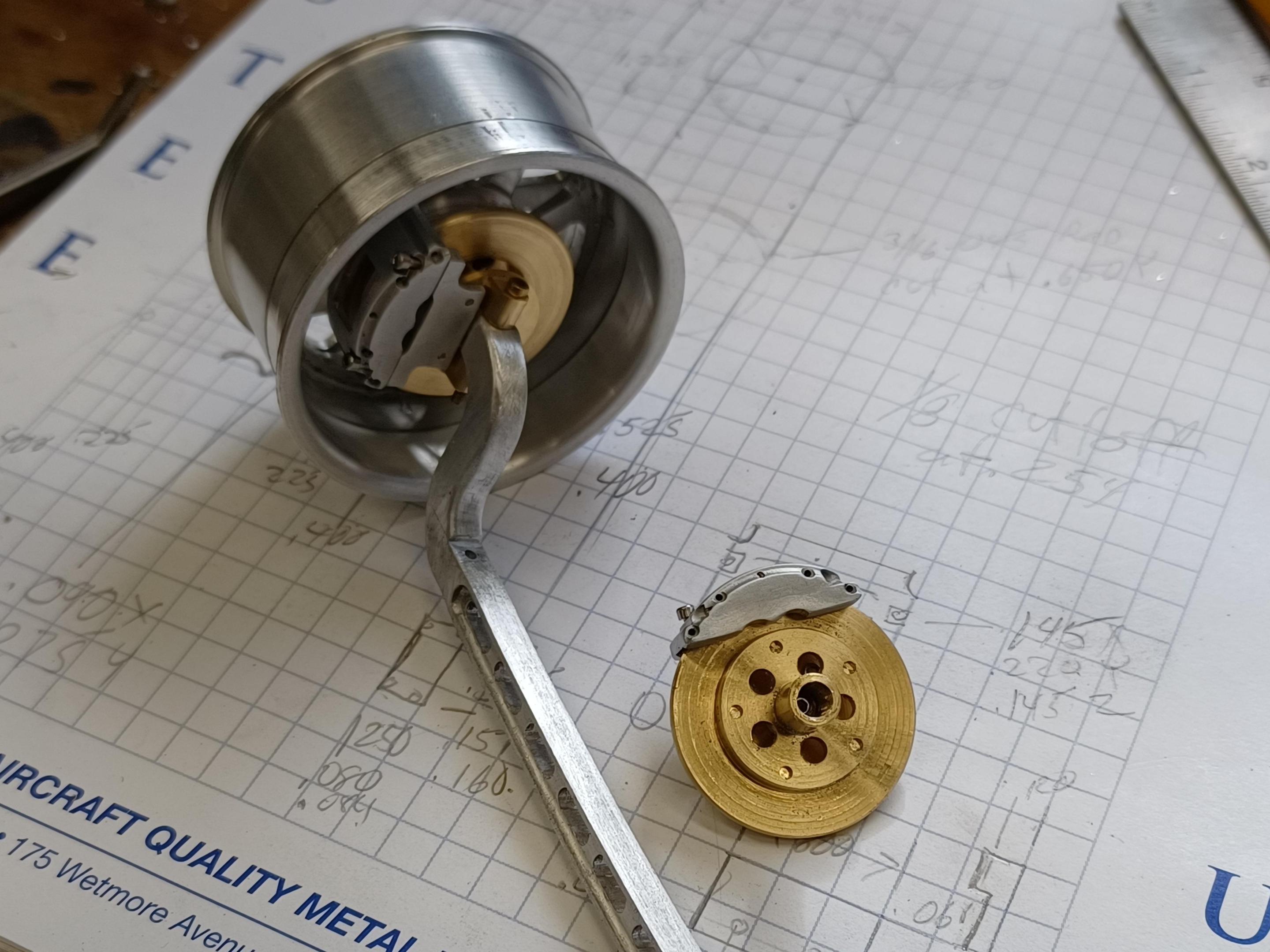

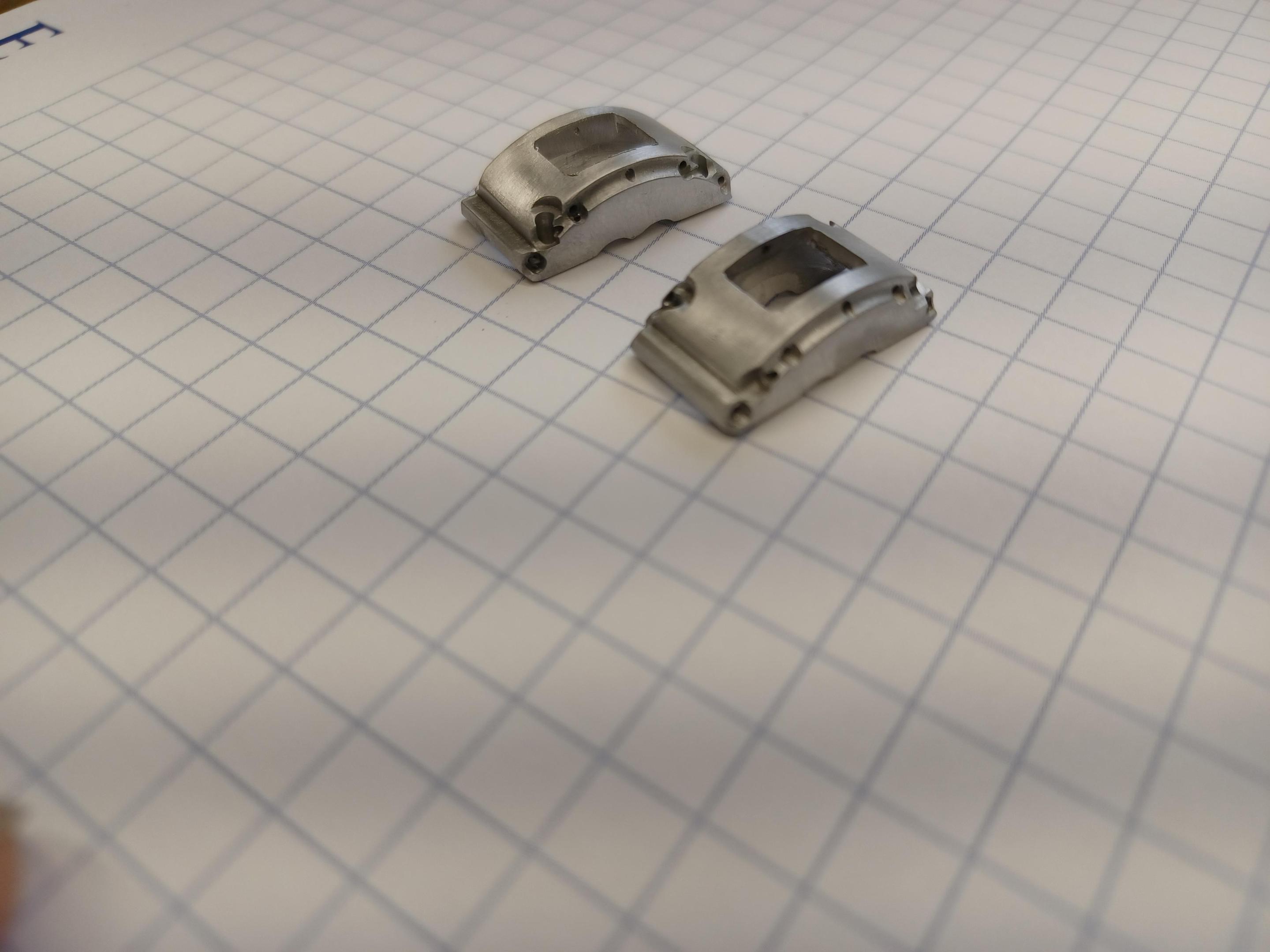

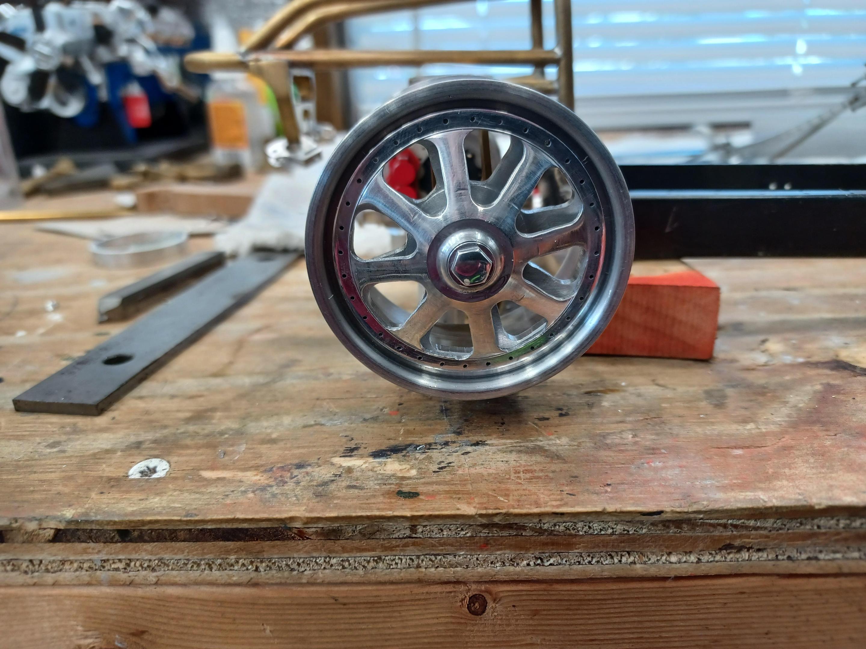

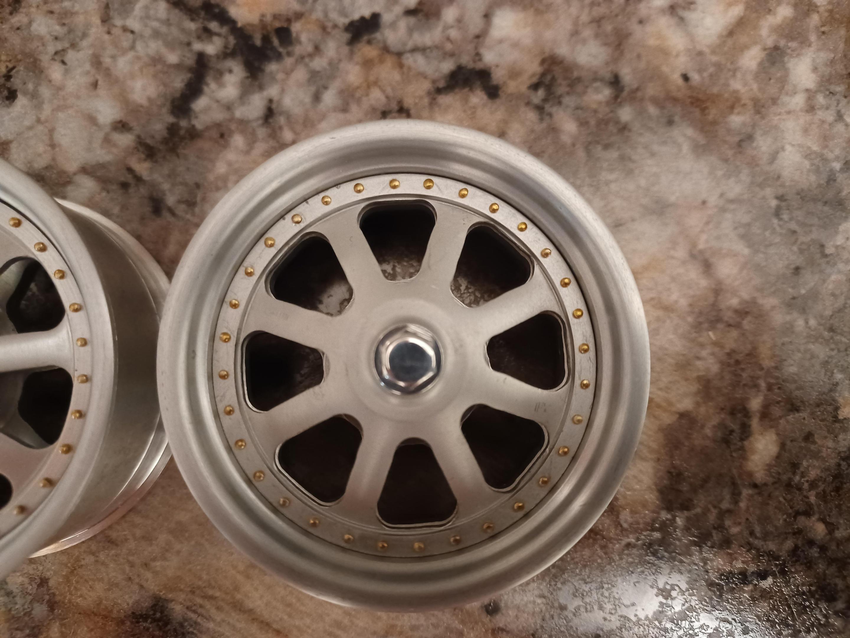

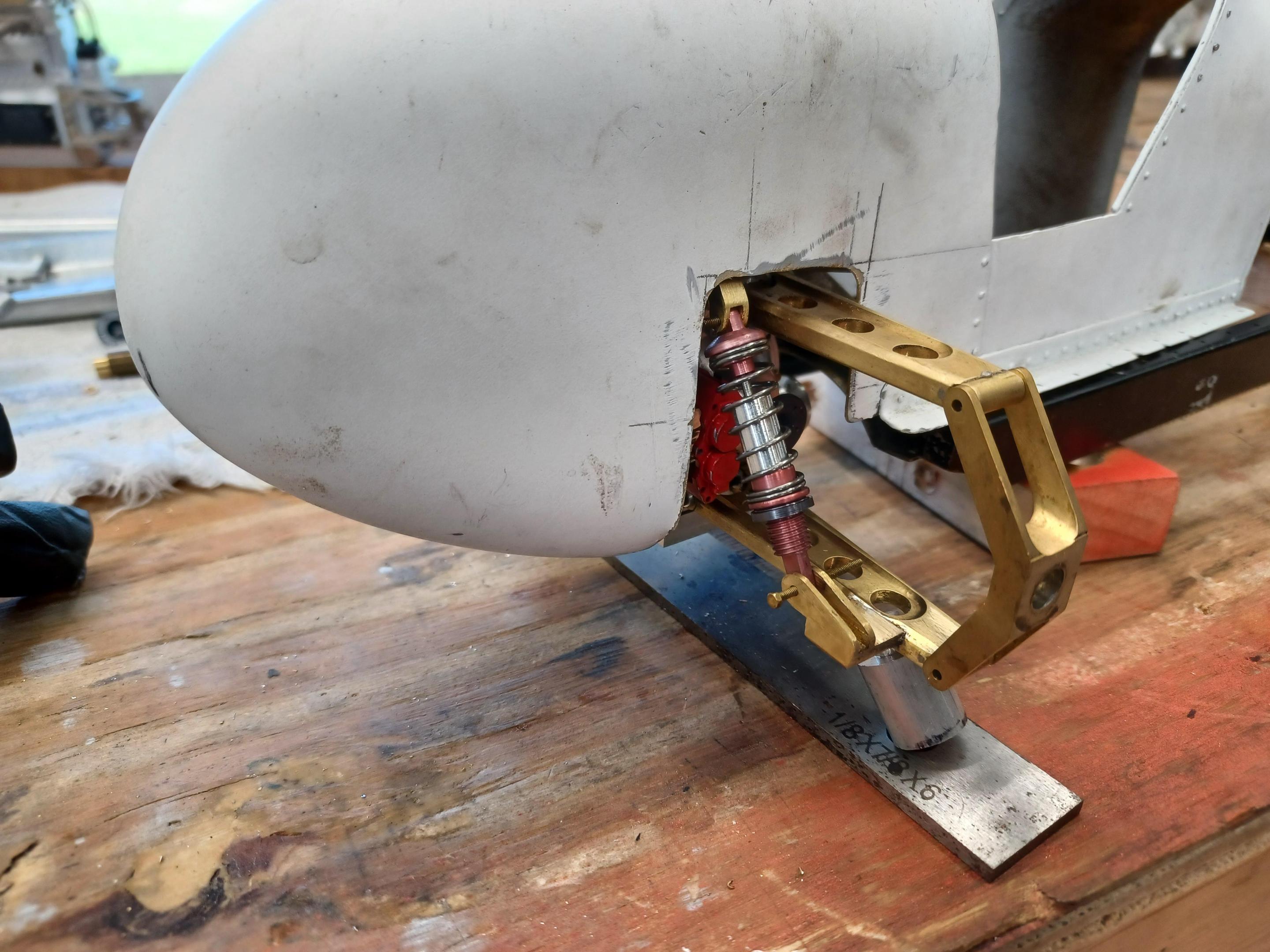

  3. got alot of the frontend parts made. the rivets arrived so i put the last wheel together. large 6 piston wilwood calipers. got to try to find some wilwood decals. does anyone know where i might be able to purchase some really thin leather?

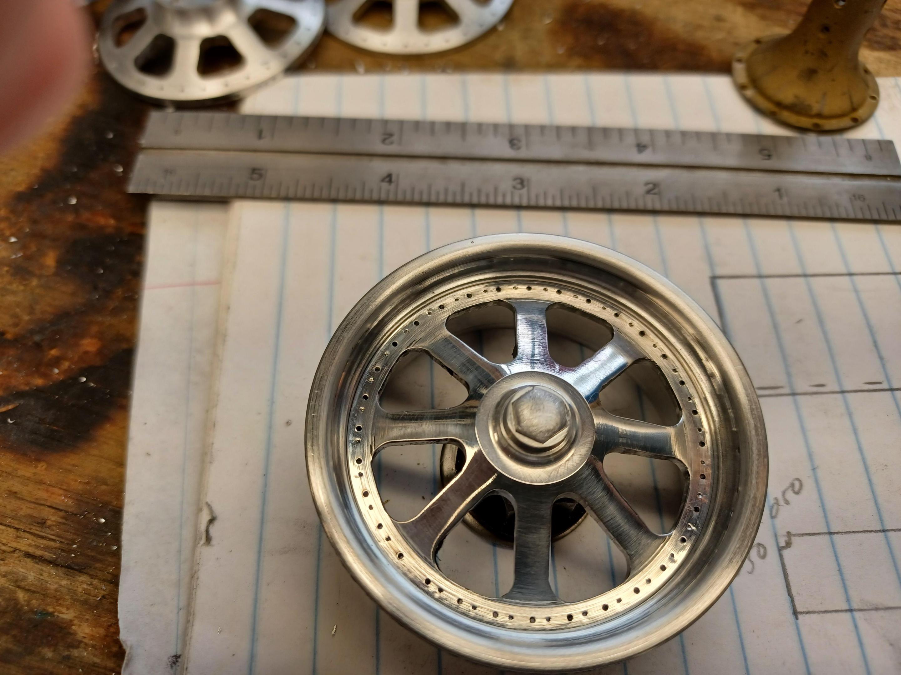

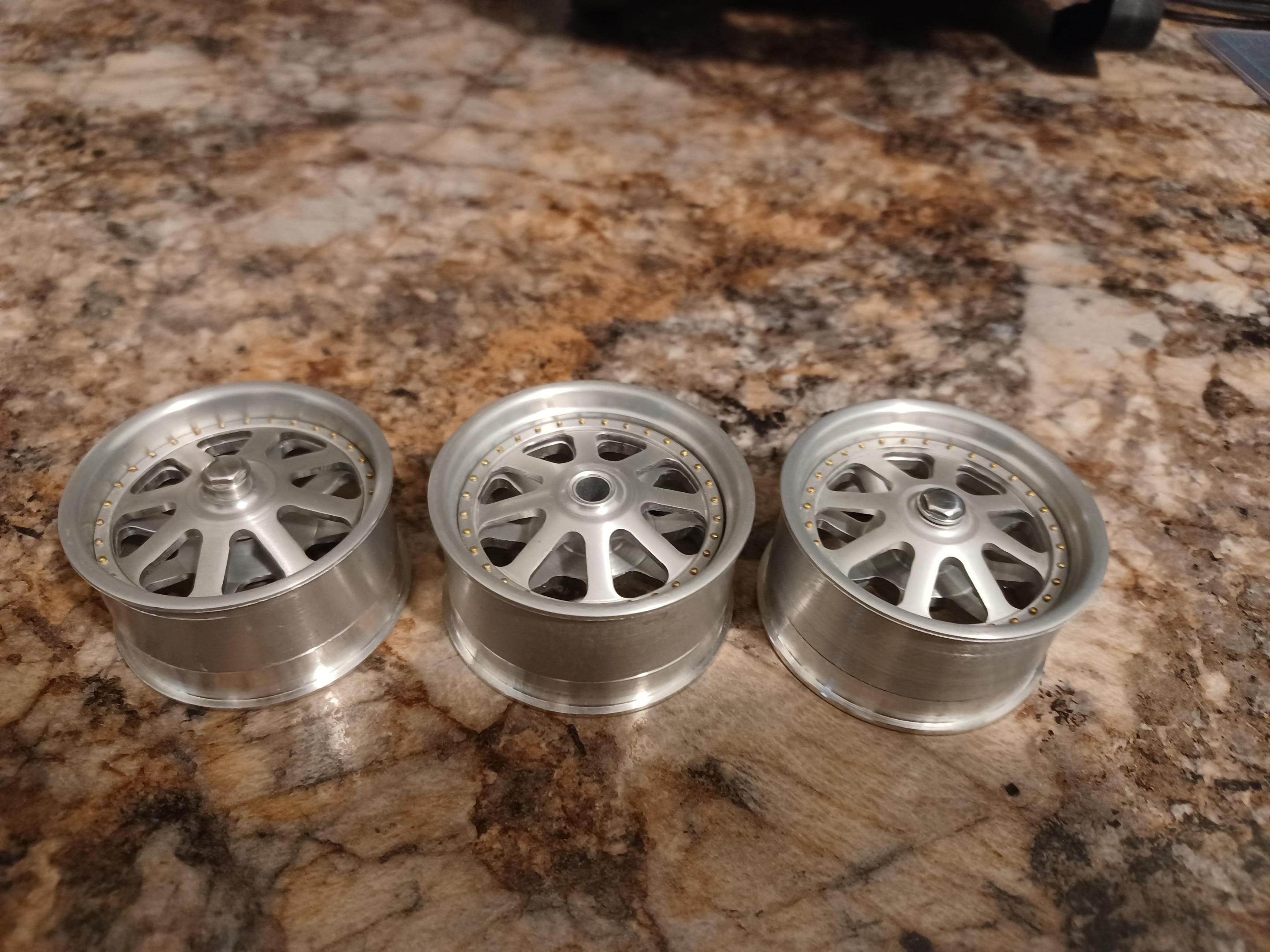

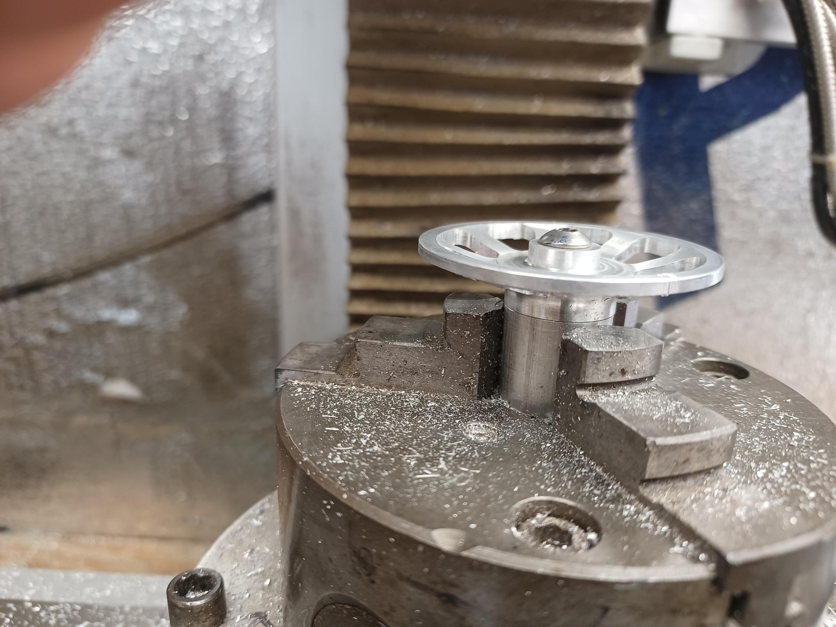

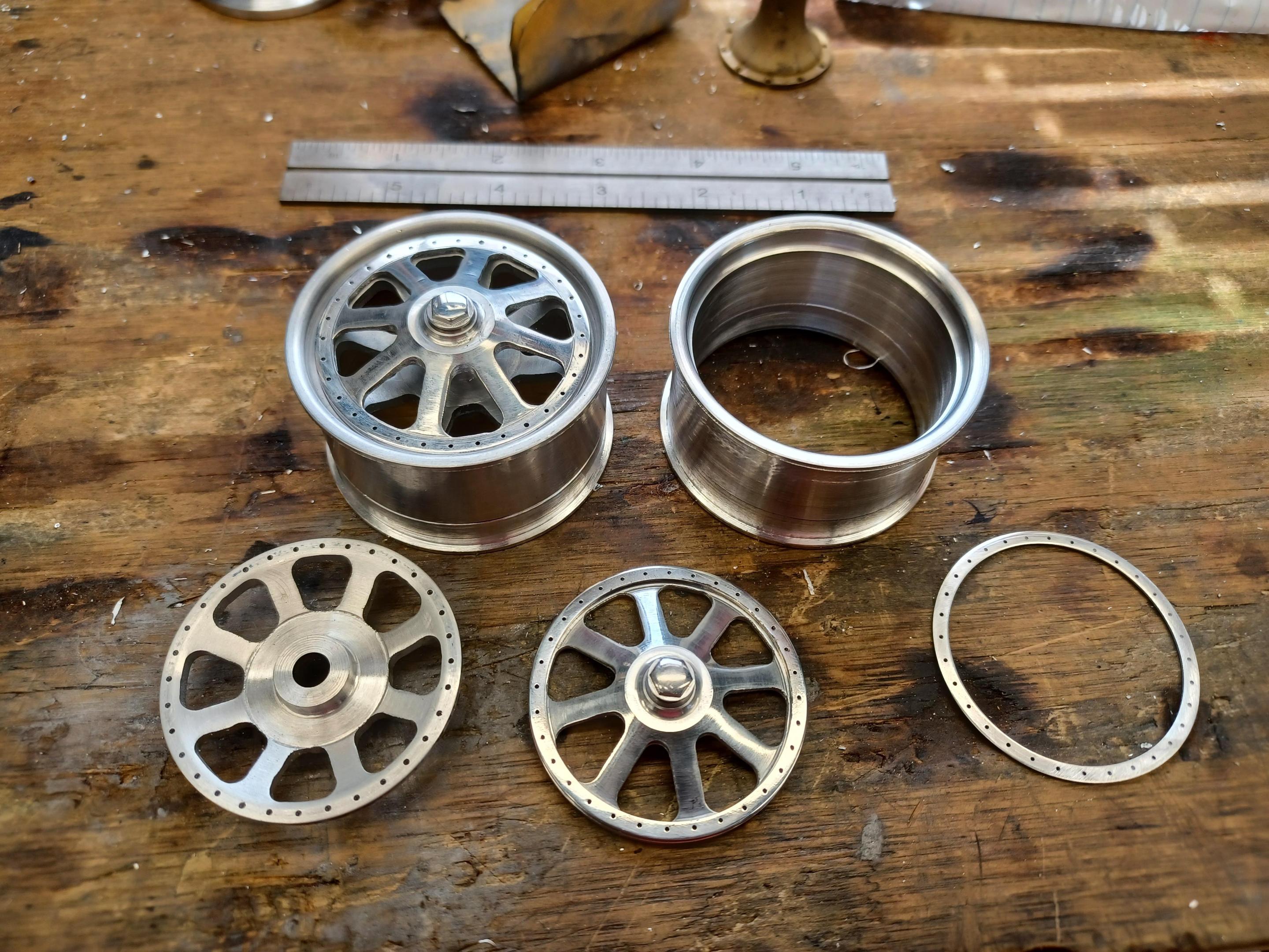

  4. yes andrew,just anodized with no dye for color . just keeps them from corroding. i think it leaves a nice finish.hi daniel, thanks for looking. hope you enjoy.128 rivets. 3 pieces in the center of the wheels. 3 times 128 holes ,thats alot of holes. i havent counted how many allen head bolts i need from rb motion just for the engine side plates.i am going to get a part time job so i can afford this project.
  5. so many awesome parts to look at.fuel tank,battery and radiator tank. very nice ! i am glad you are finding more time.is it winter way up there yet?

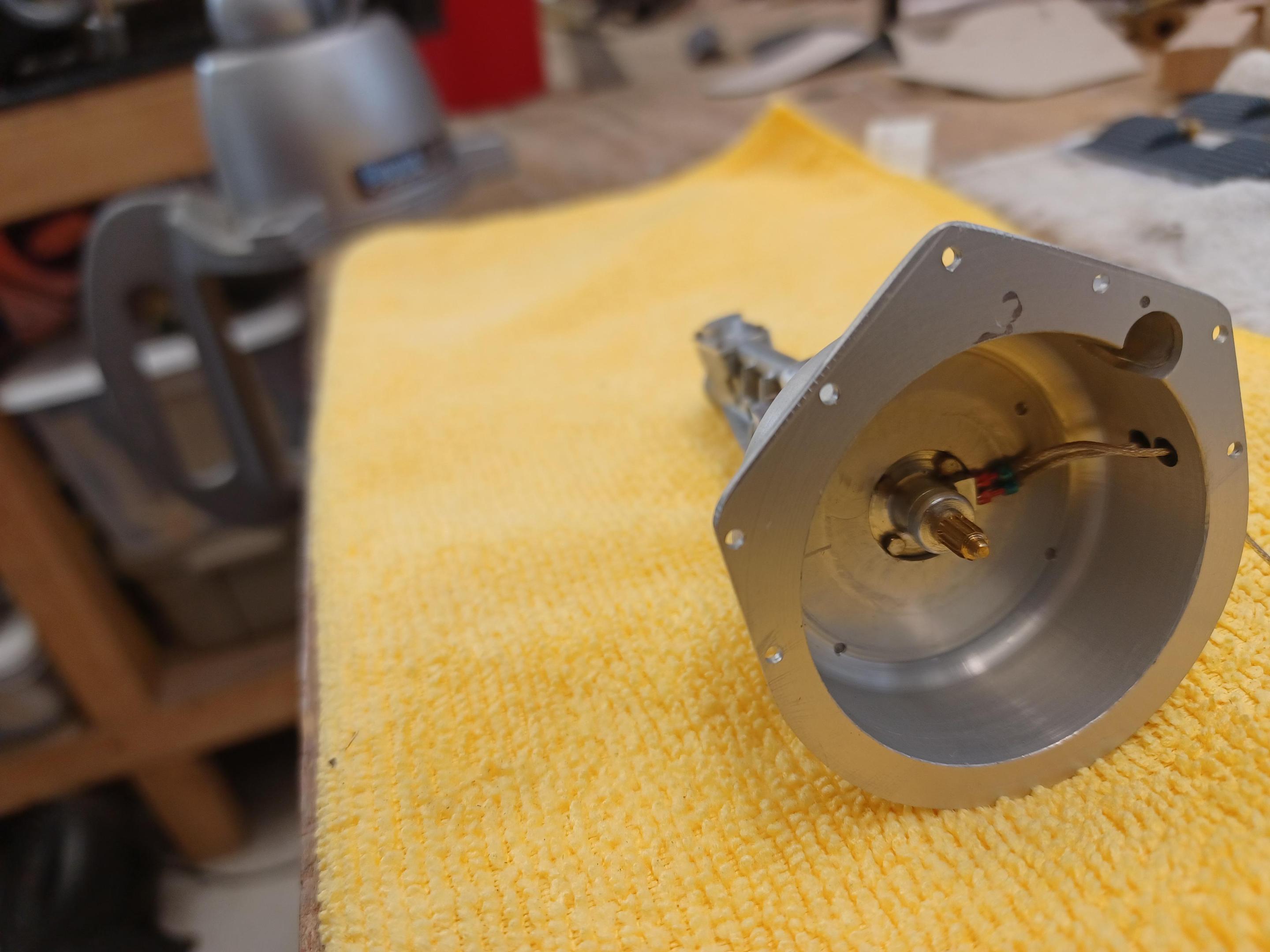

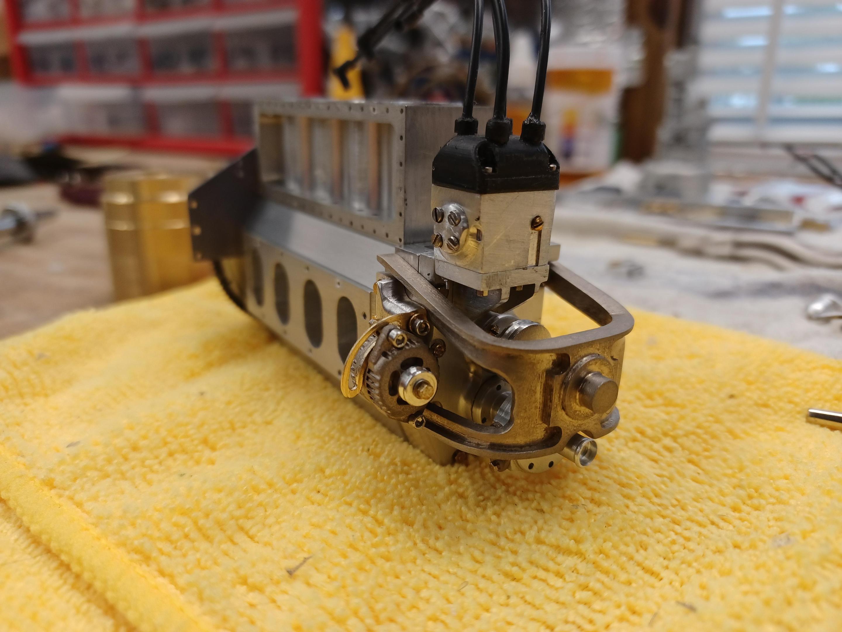

  6. i andrew ,the pictures are pretty cool. hi francis. put the wheels together, ran out of rivets after the third wheel. i had ordered more but they are not here yet. i think they look good they came out the way i planed. started on the front axle. should be finished soon. then i will polish it and anodize clear.got the alt. mounted . and started final assembly of the engine.

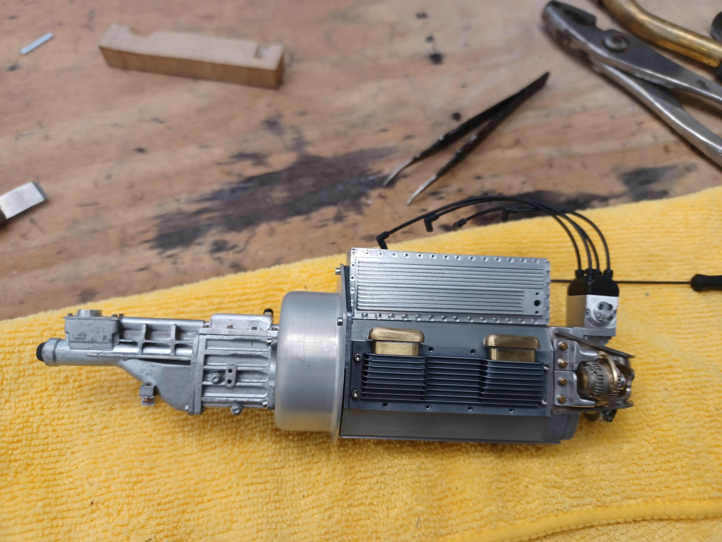

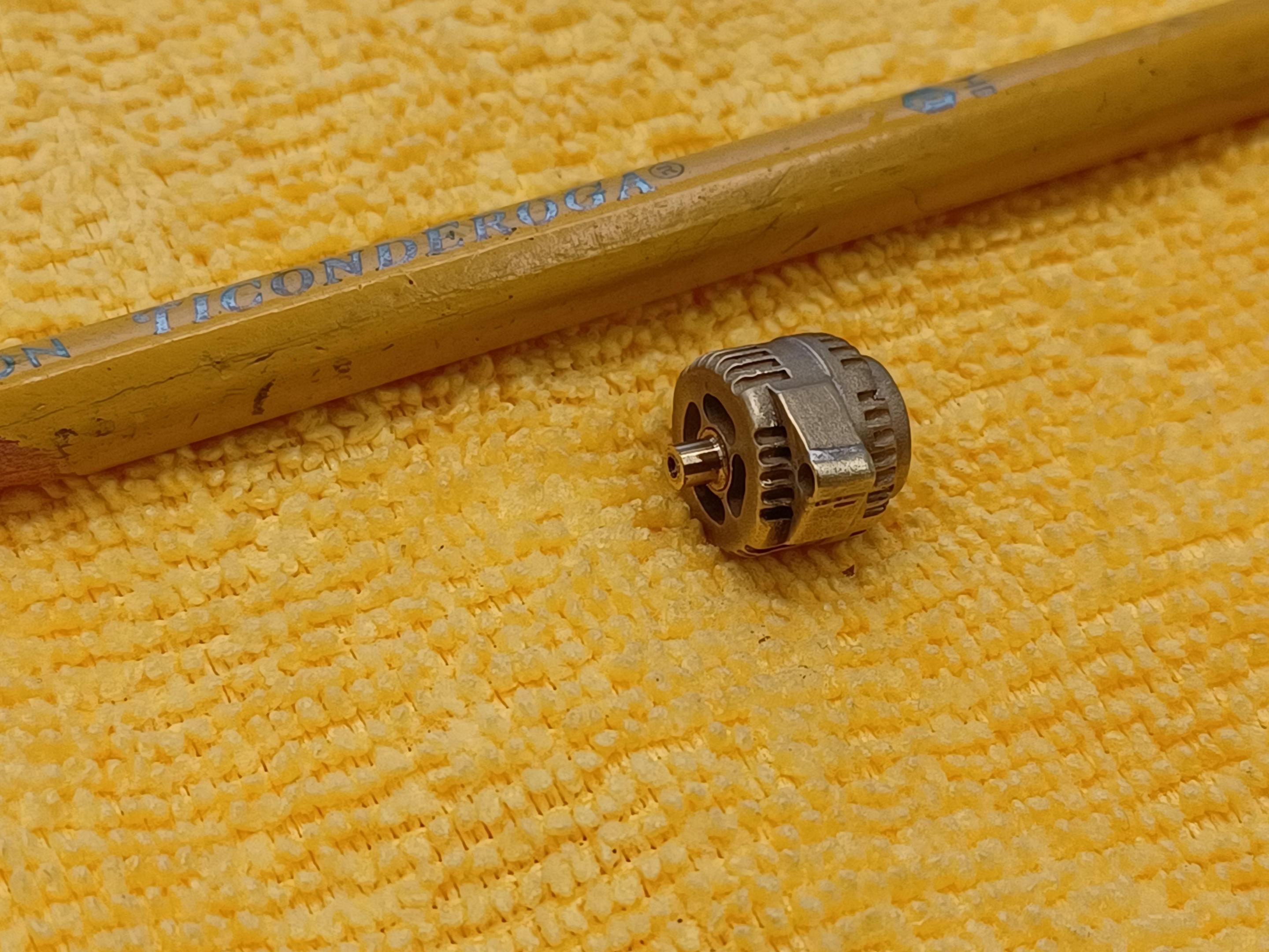

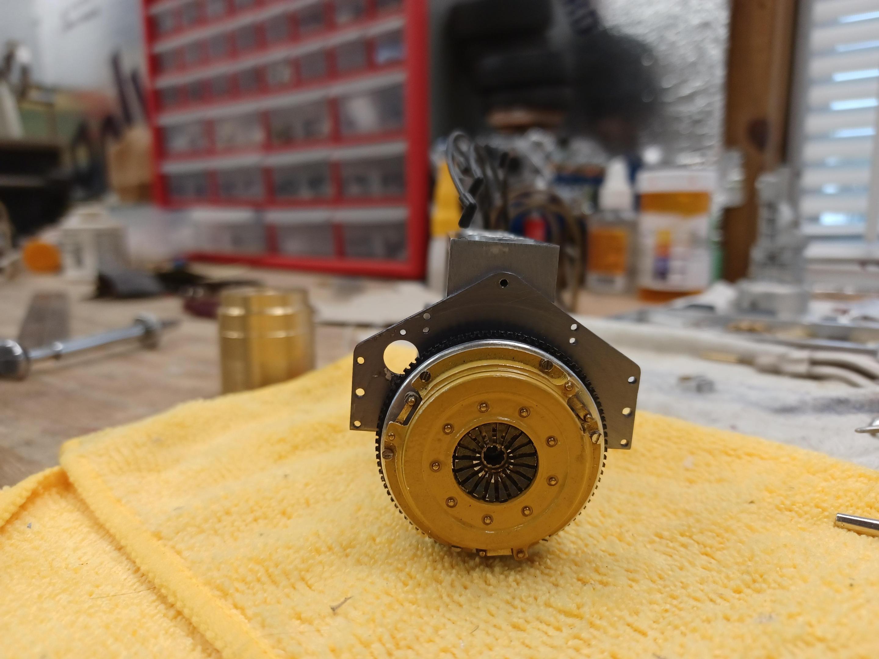

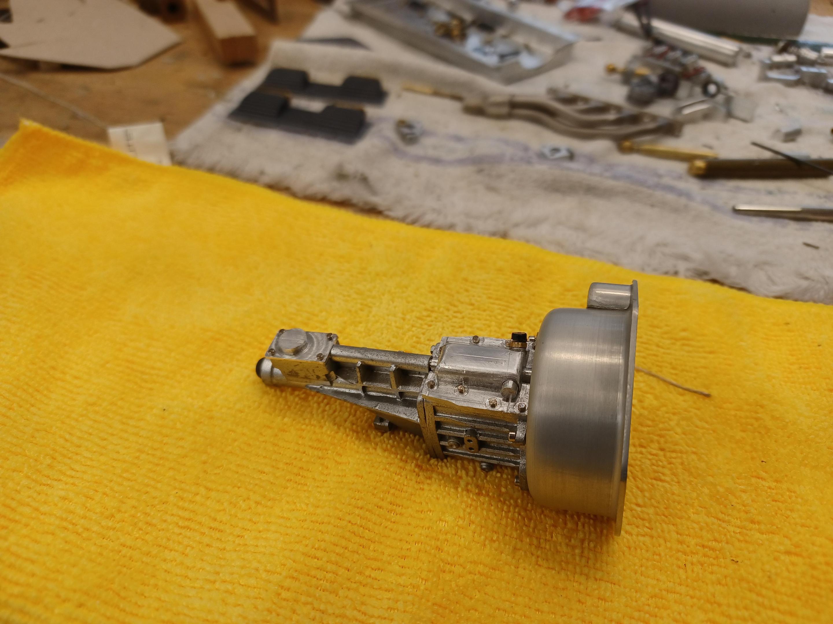

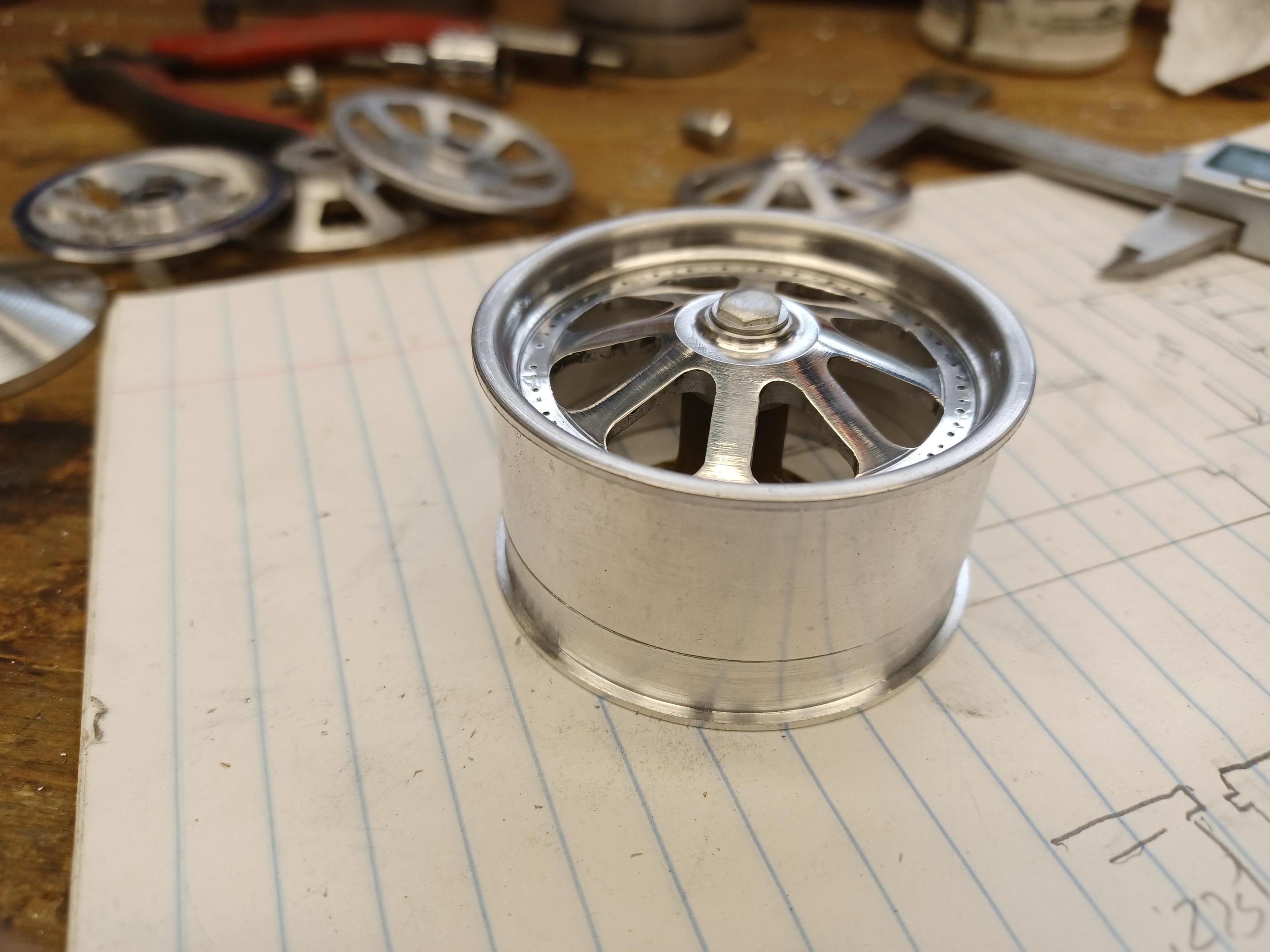

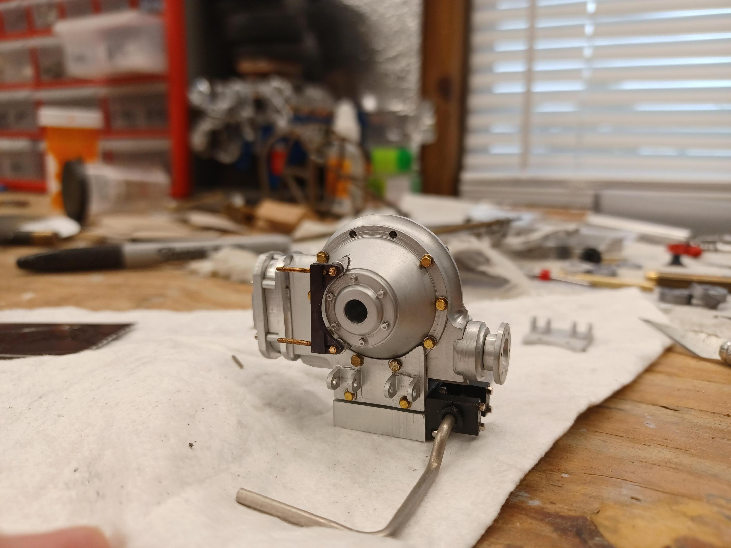

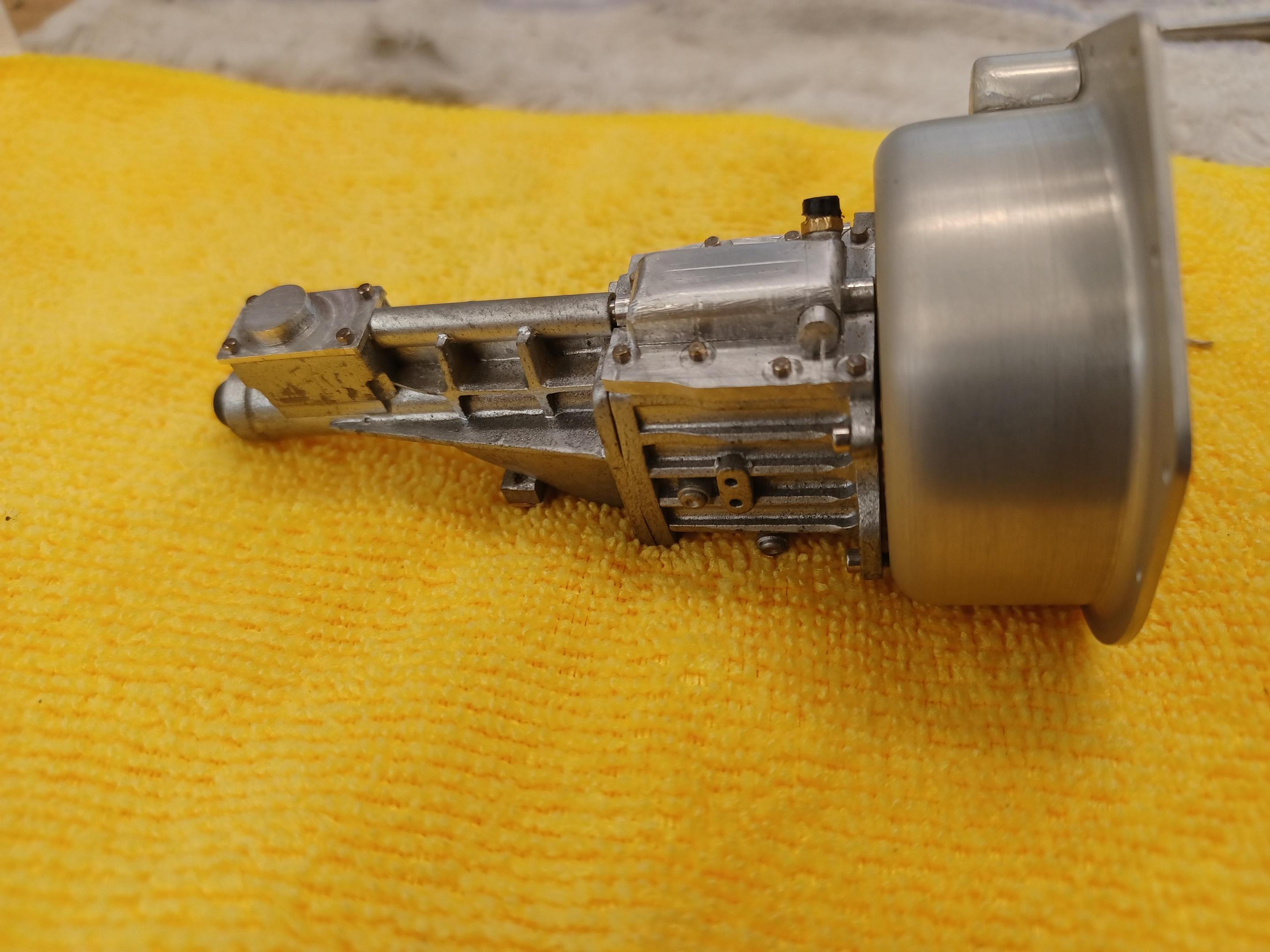

  7. doing some plating and anodizing to try and put together a few larger assemblies, the rear is went together well . just finished plating some parts. anodized alot of engine parts this week, mostly clear. the transmission and bell housing is assembled including the hydraulic throwout bearing. still have to do a shifter. started taking the old paint off the chassis. almost finished with the alternator and mounts.hi Tim thanks for your comments, your brakes are awesome. hi Pat thanks for looking. nice to hear from you Scott. Francis tied a couple of new things in my anodizing and nickel. some were better some i found know difference.

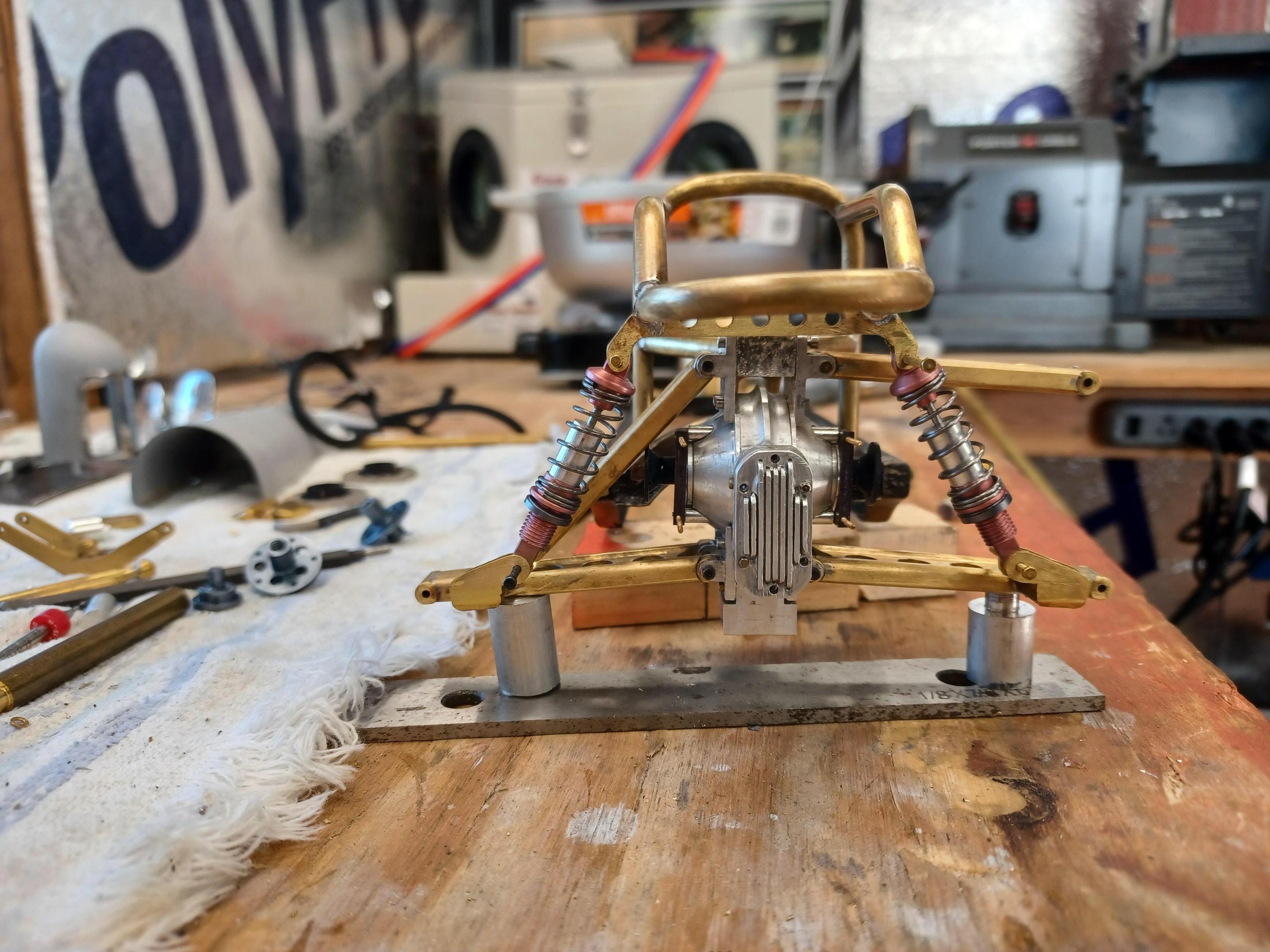

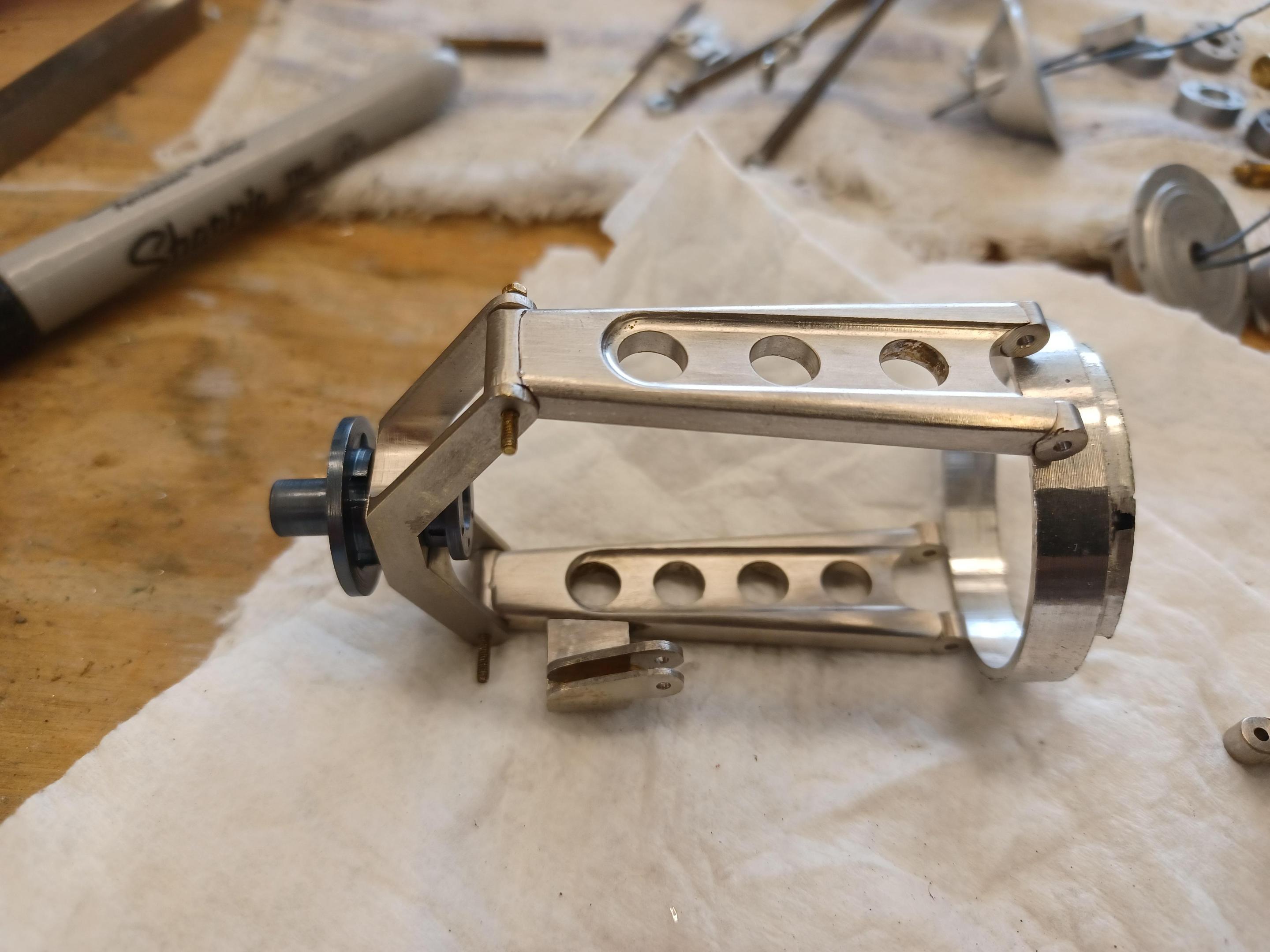

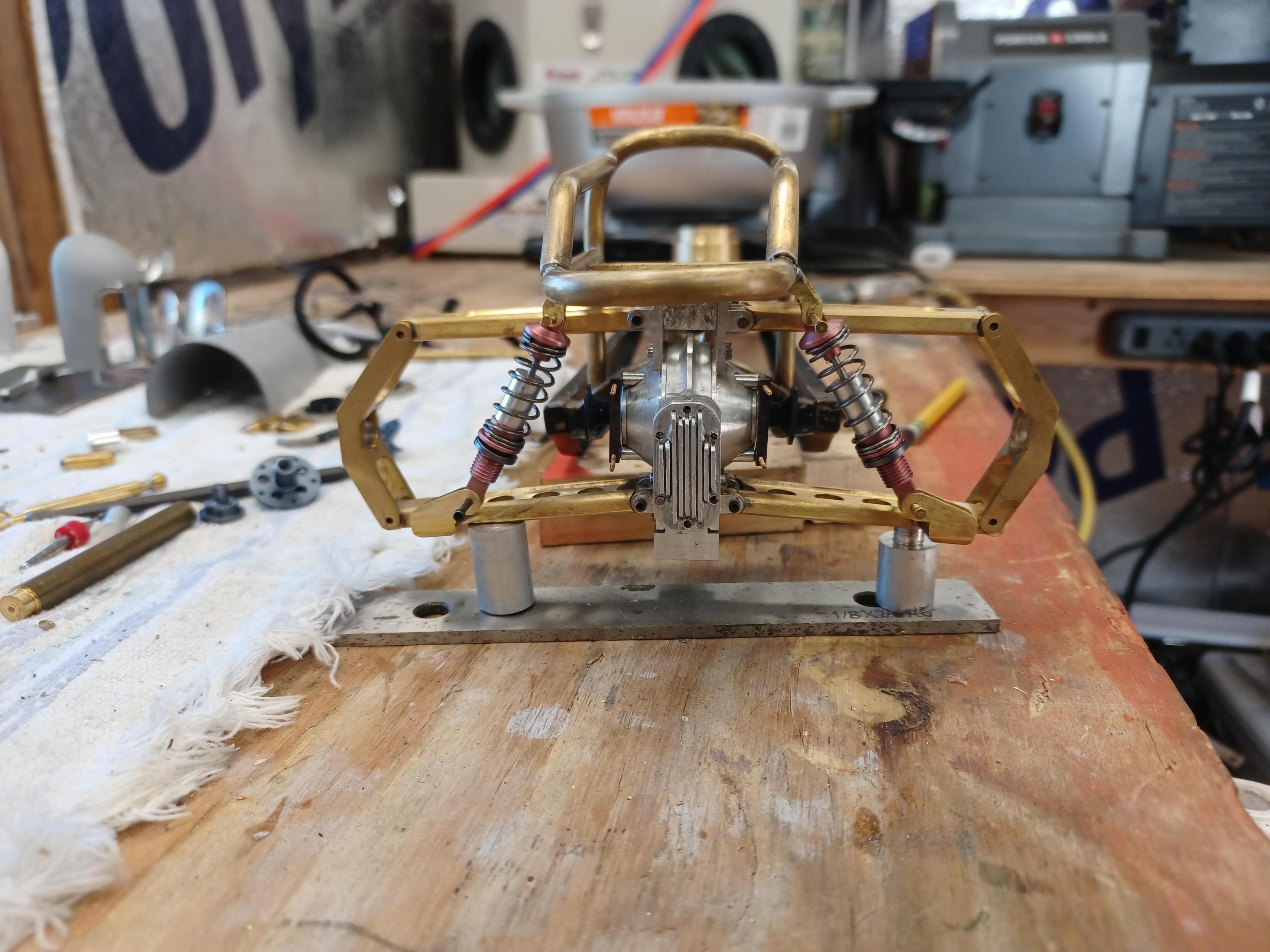

  8. hello claude. nice to hear from you ,thank very much. i hope you continue to enjoy. i think i have all the wheel parts made. had to strip and reanodize some.i will try to assemble them this week.i left them just aluminum but clear anodized for protection. got the shocks made and could not work out a proper way to do them in a laydown position so i mounted them vertical.i think they look alright. rear sway bar next.
  9. easyoff seem to work fine. i watched a video using rust and stain remover for laundry,looked like it worked well also. i fill a small container enough to submerge the part completely,let it soak about 10 minutes.

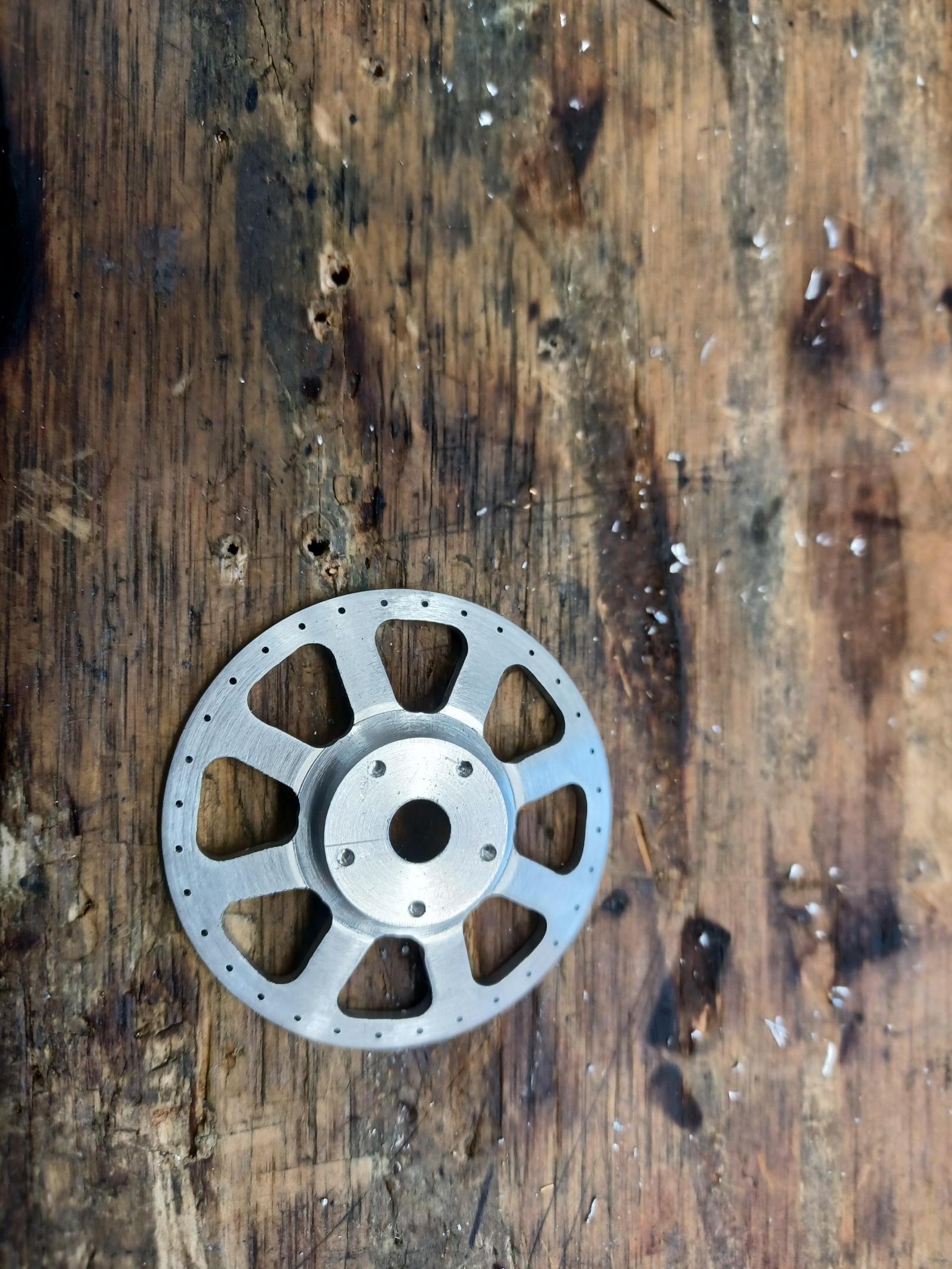

  10. thanks francis,nice to hear from you. hi andrew glad you are still looking. i haven't made up my mind because i have modernized the engine ,the 5 speed transmission and the rearend, so the car is more suppose to be a modern version of an old car. the wheels are also modern just made in to somewhat look like the t35 wheel and they sure are wider. the rear is 18by 10 and the fronts will be 17 by 9. when i make the tires they will be fairly tall , not supper low profile. i have polished one and it looks pretty nice. the centers are a press fit so i haven't and can't press them together until i decide . i am making the fronts now and i have plenty to do so they can be set aside for a while. i can anodize one to see what it looks like and very easily strip it. something to think about ,no hurry. any comments on fenders or not?

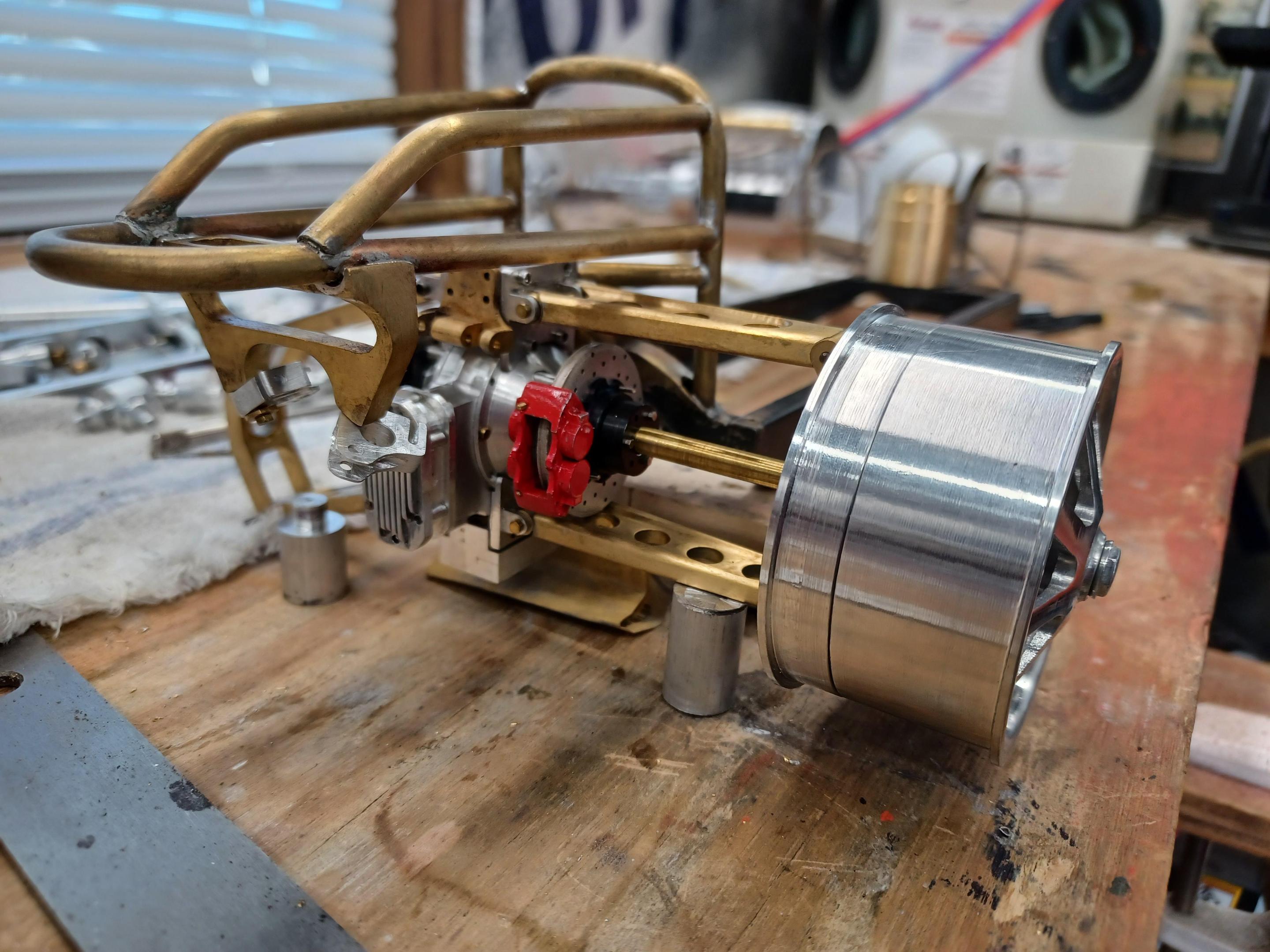

  11. looking good andrew. the distributor boots look great. i think we all worry to much about the small stuff. in are world its all small stuff. in your case 1/24 very small

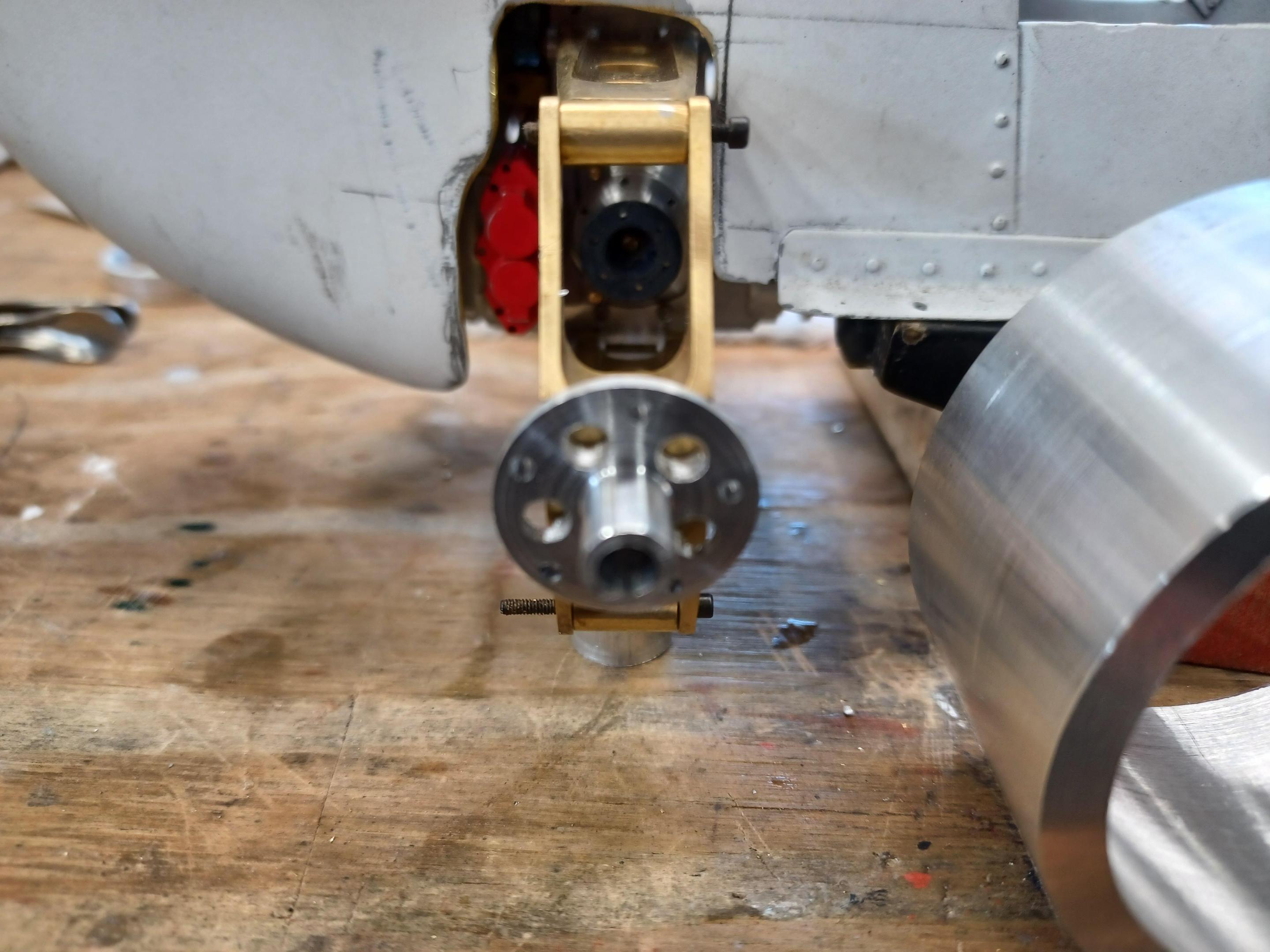

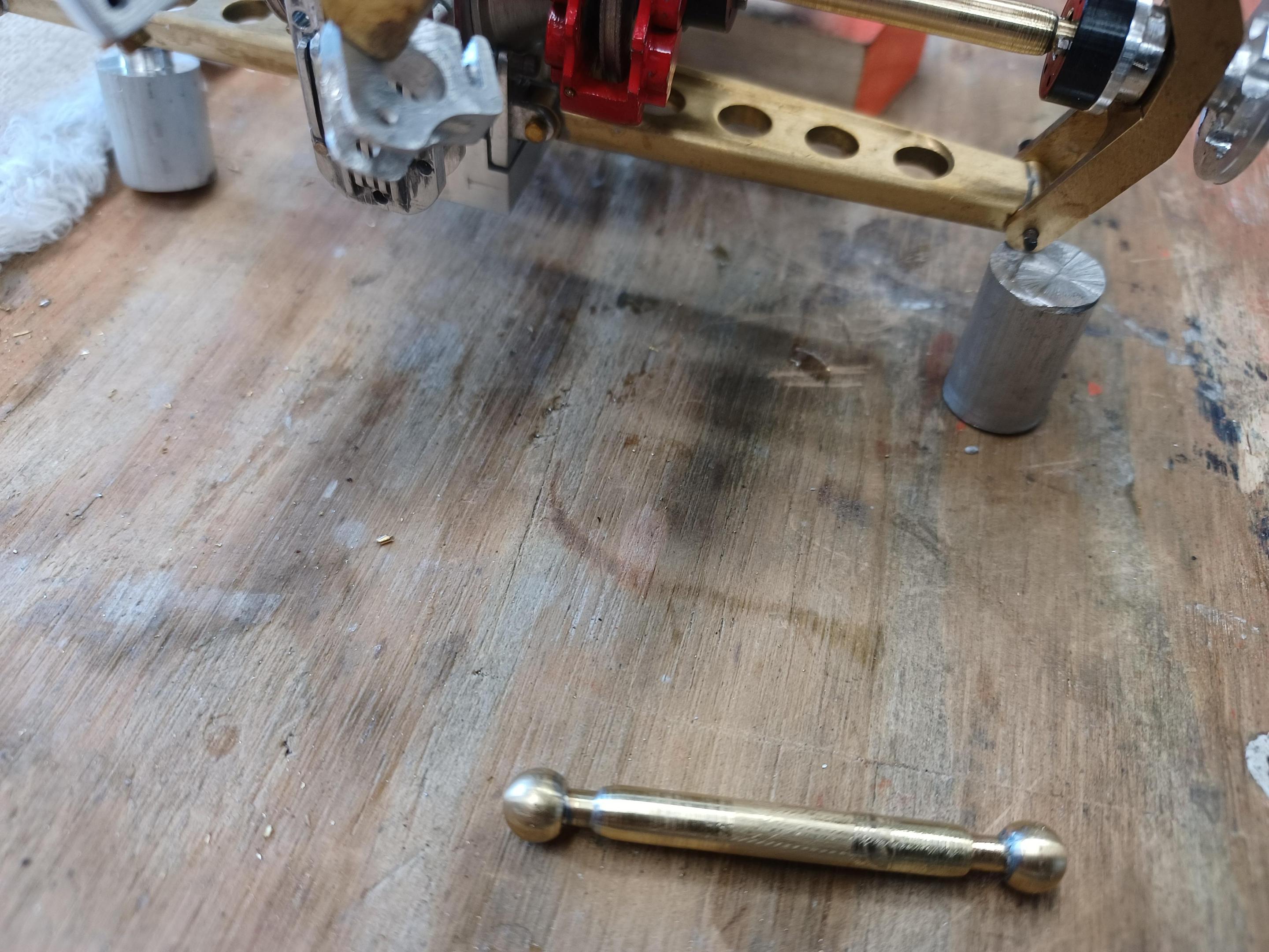

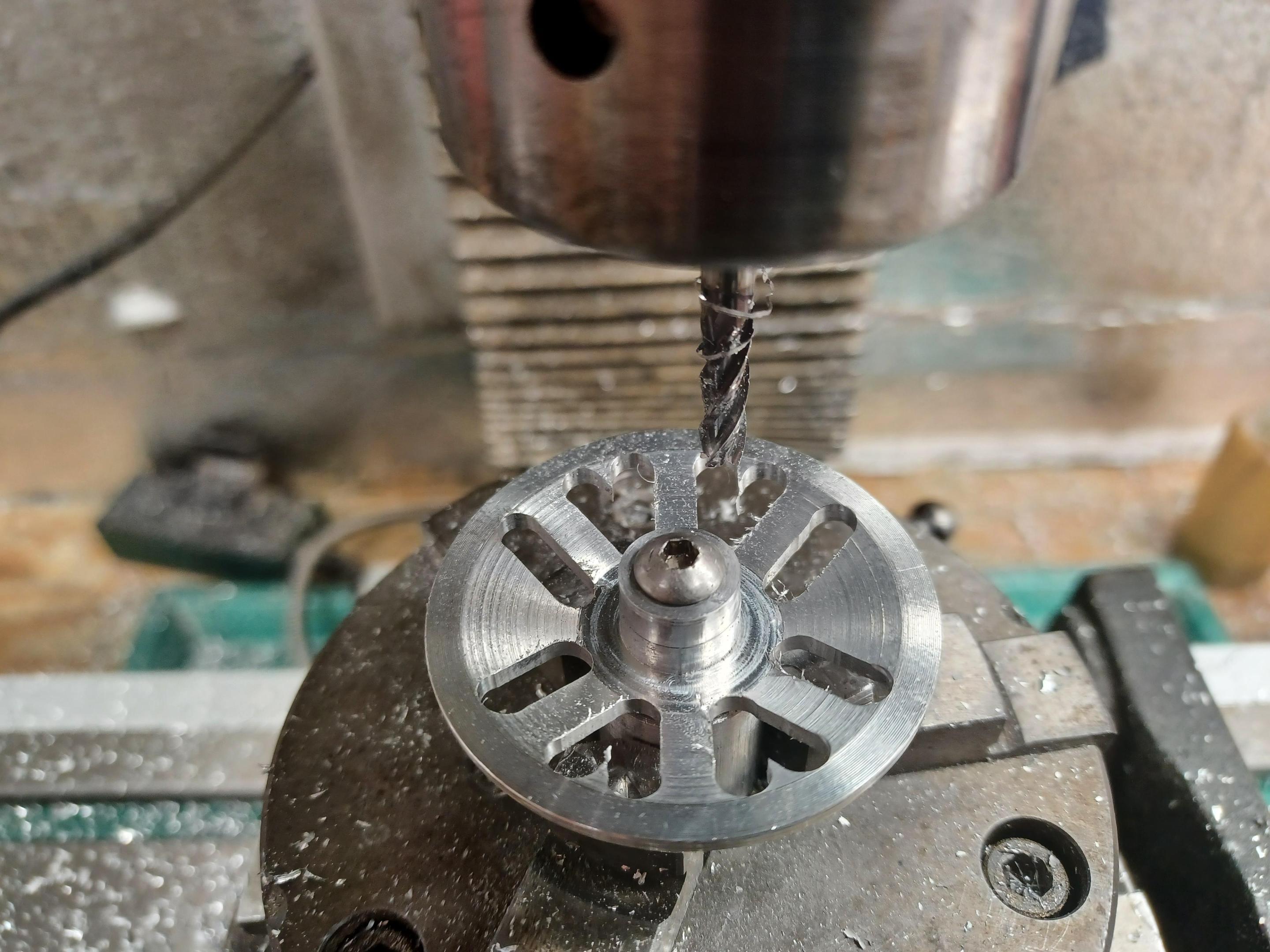

  12. nice to here from you art. i have been figuring out how to machine the inner wheel parts and i have made the inside half that butts to the hub on the axle. pin drive with center nut. the outer half is going to be almost the same with as the inner half with a smaller center. i am trying to decide if i should polish the rim and anodize the centers black or try to polish the whole wheel . opinions welcome,please. i dont know what color the car will be yet.that could make a differents.i took the idea for these wheels from the bugatti t-35 ,one of my favorite cars of all time. i am also trying to decide on makin fenders or having side mounted fuel tanks like the lancia d-50 another favorite. all that is a little further down the road. here is a few pictures. the axles and the cv joints have a 1/4 inch ball on each end and the 2 half of the cv half half of the 1/4 ball cut into them so they can rotate and travel up and down.

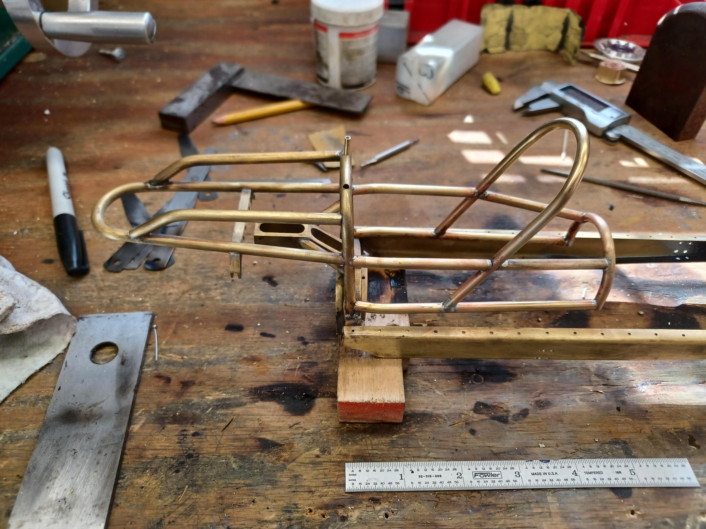

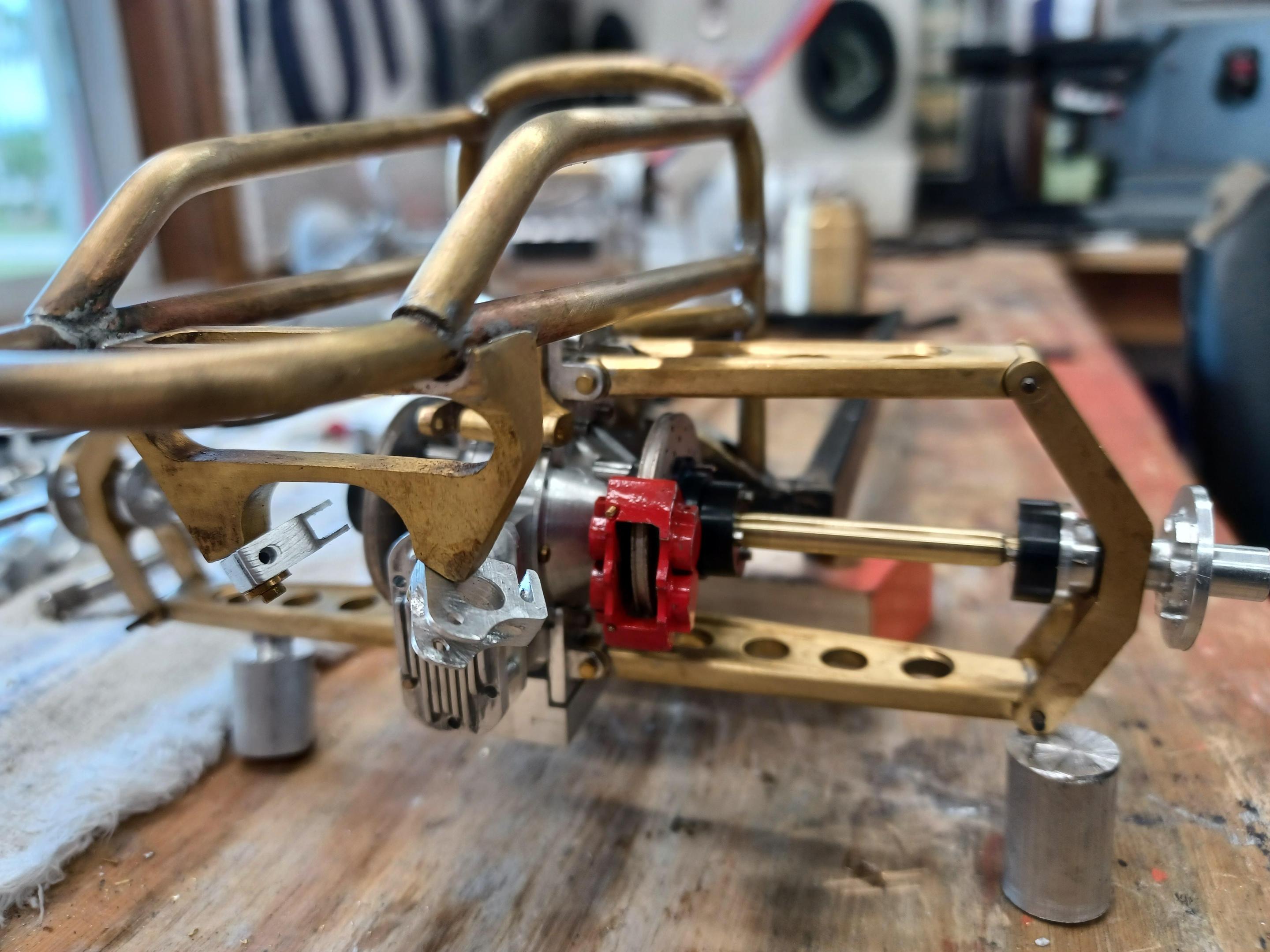

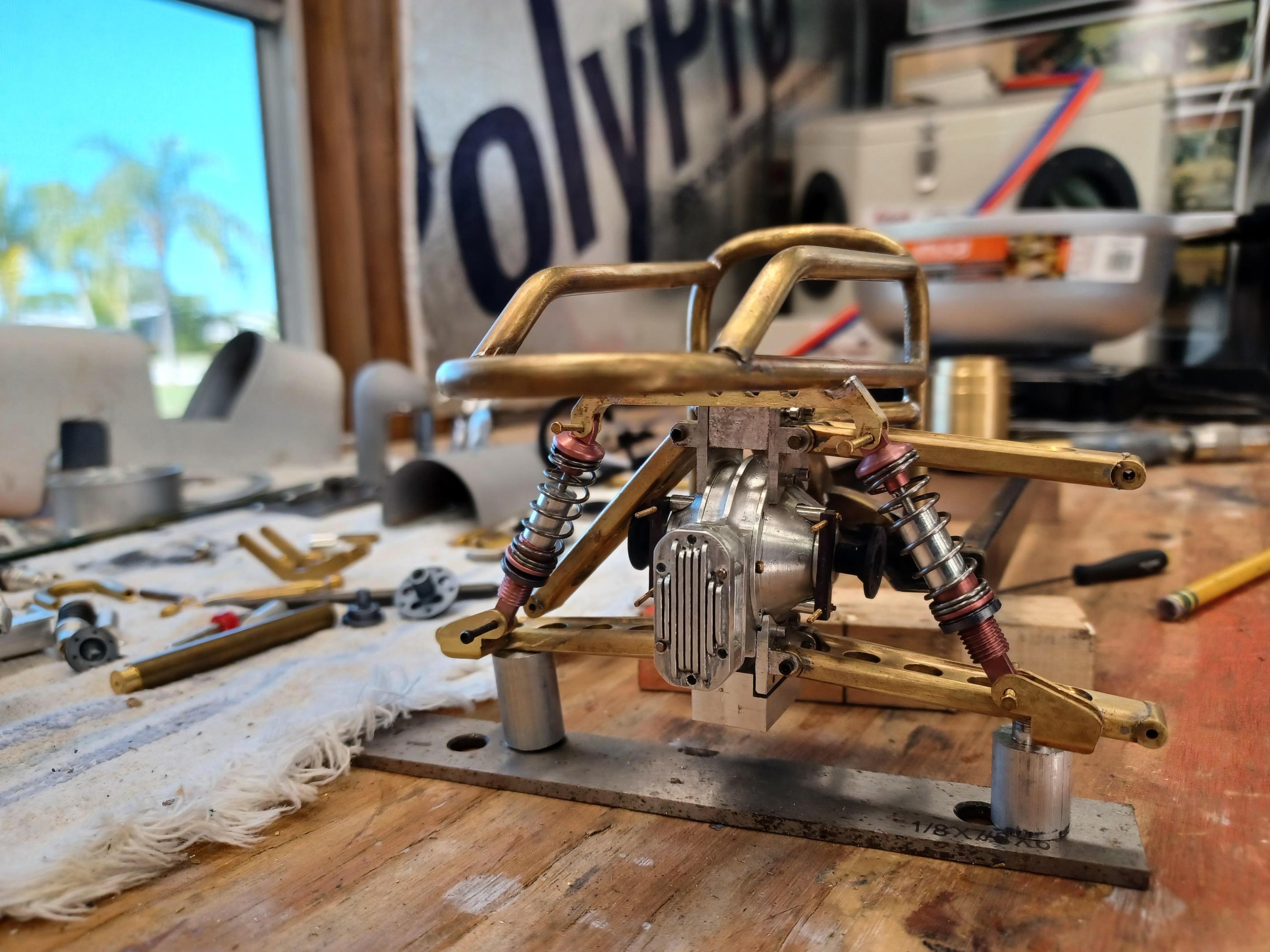

  14. i am using horizontal laydown shocks sort of like formula 1 on the backi started on the shocks today. the mounts for the shocks are soldered on. part of the roll cage is in. the small hoop threw the body has pins from the big hoop so it removable .soon as the rear suspension and the 3 drive shafts are done finished i am going to start on the wheels and the molds for the tires. i dont know what the wheels will look like yet but i several ideas.still looking at picture on line.thanks ira and scott.glad to hear from you francis.

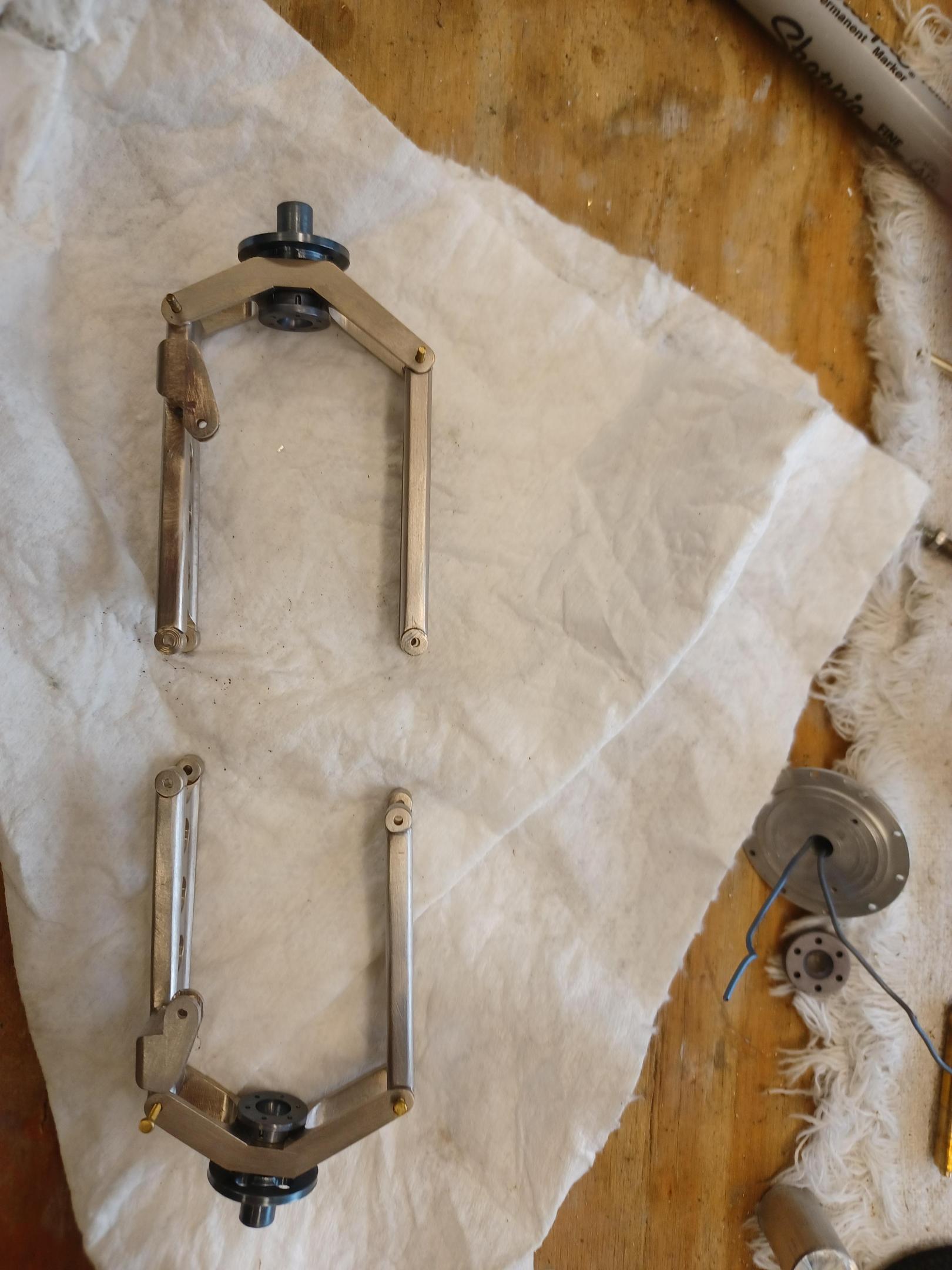

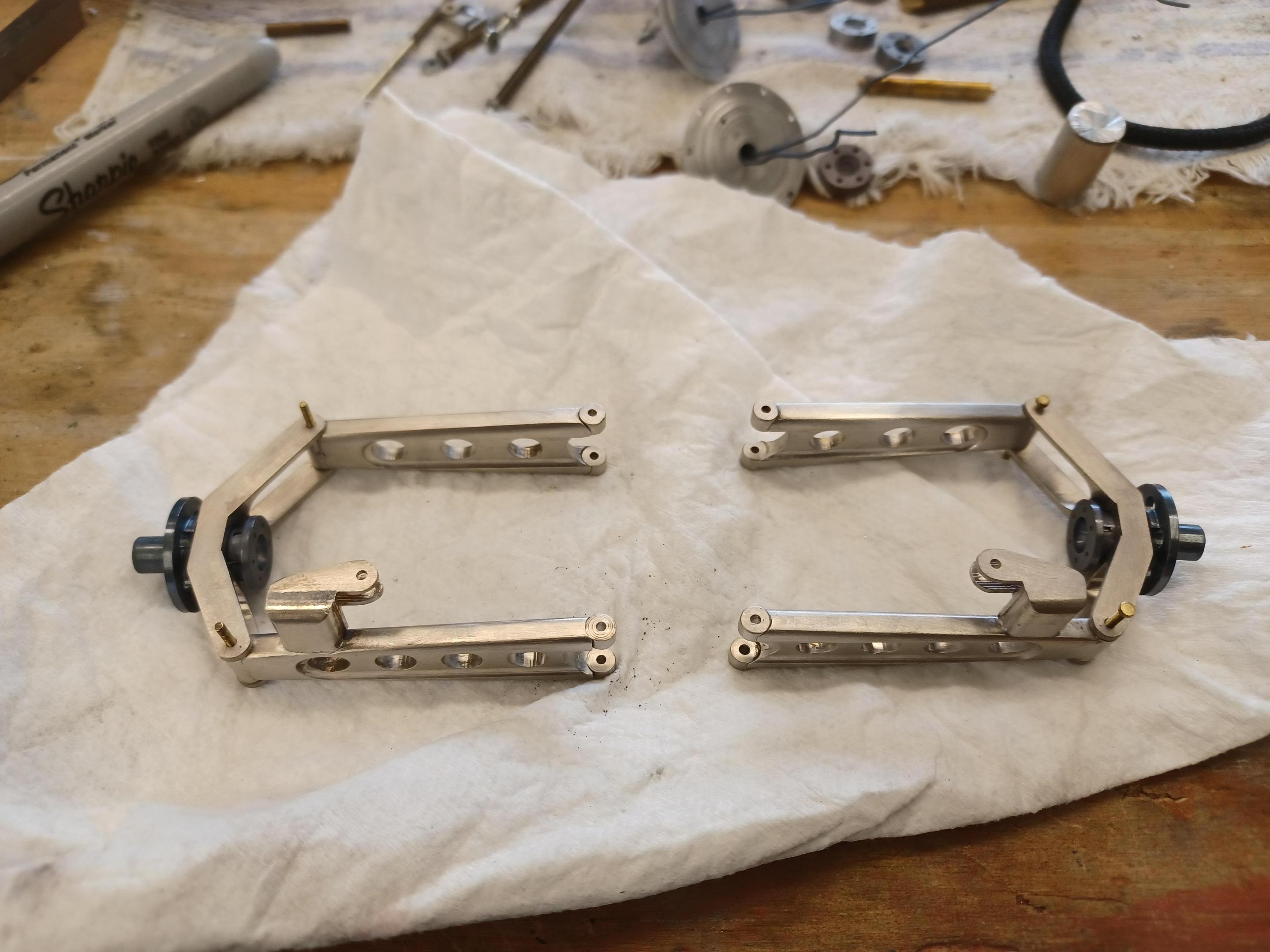

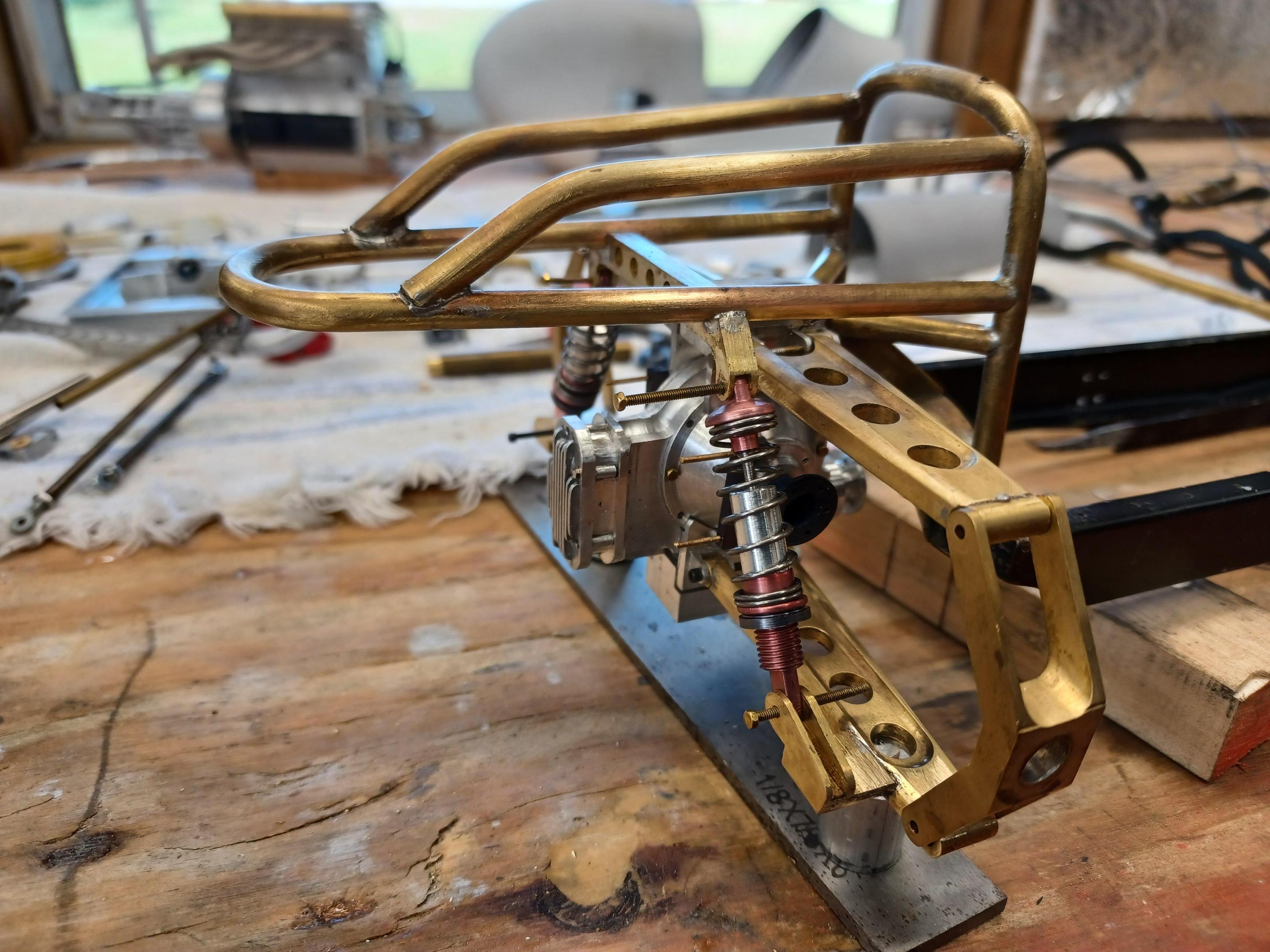

  17. falling behind in my work and my updates. working on the quickchange indepedent rear with inboard brakes. i am going to nickel plate the a-arms. my anodizing is working pretty well. i have only done black so far. the uprights for the wheels is next. i have made cv joints instead of u-joints for the rear and the driveshaft. thank you all for looking your comments mean alot.

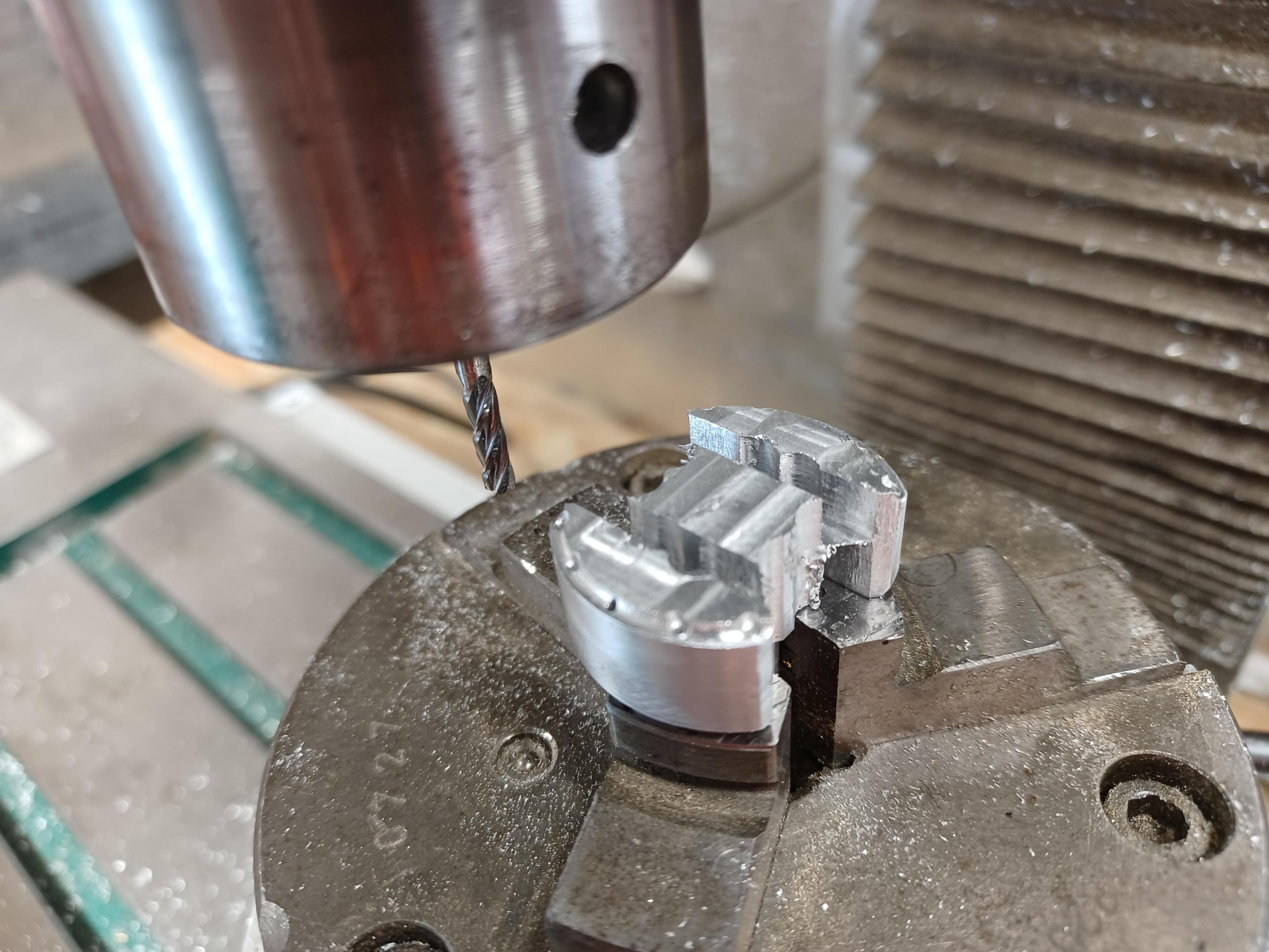

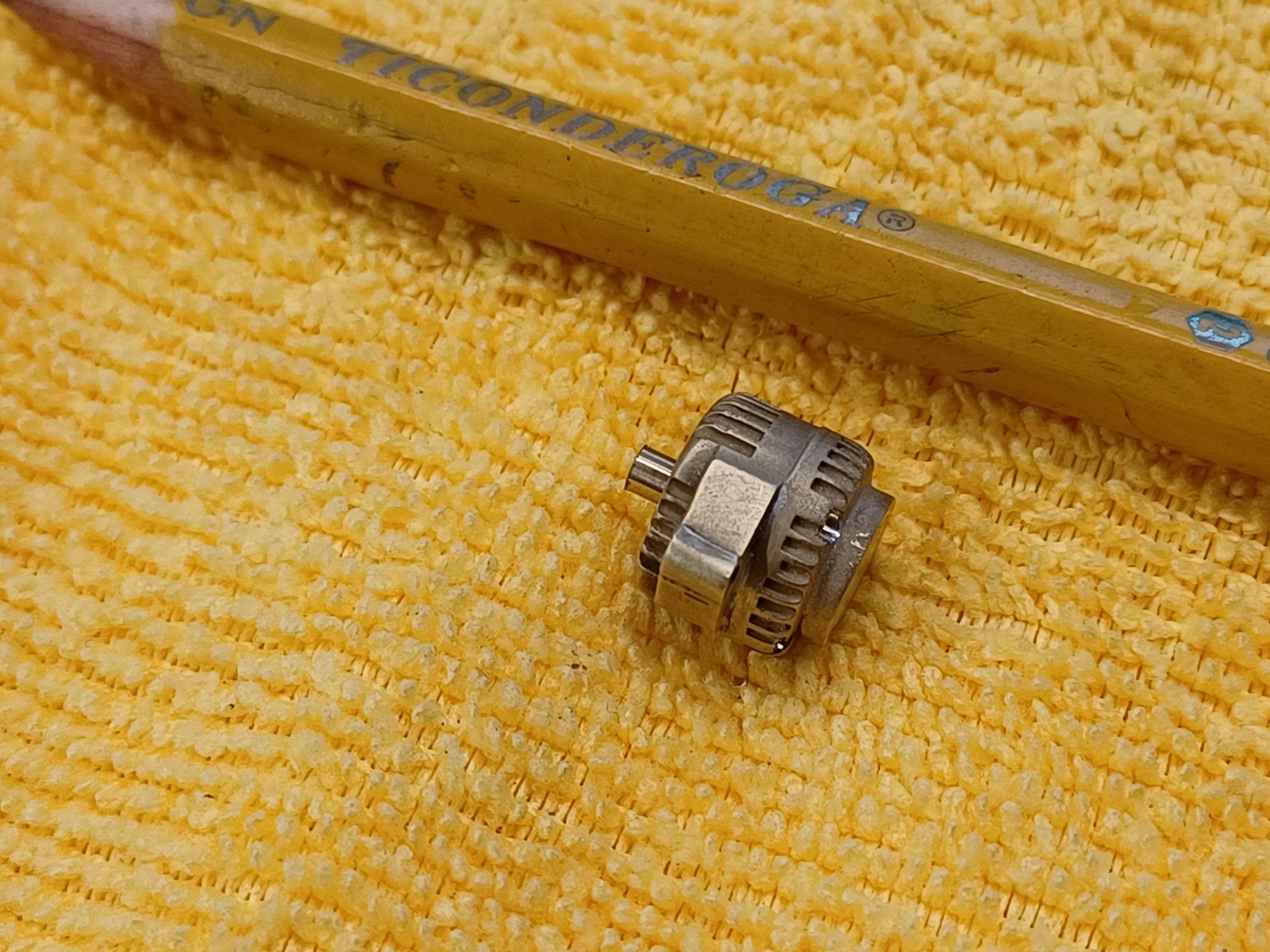

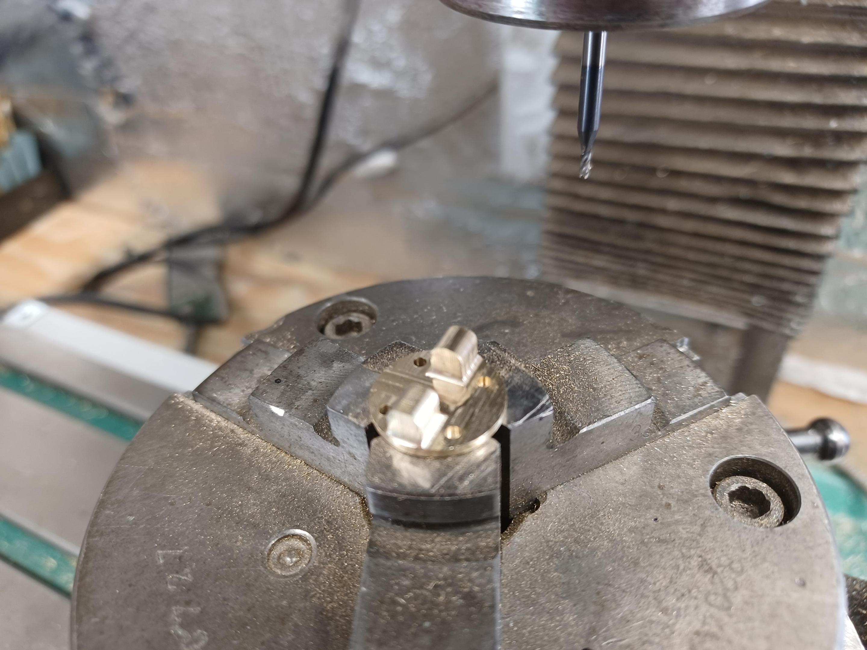

  19. very nice piece.that is an amazing brake caliper. never tried a 010 endmill ,i dont think my mill has enough rpms. i am looking for away to speed it up.

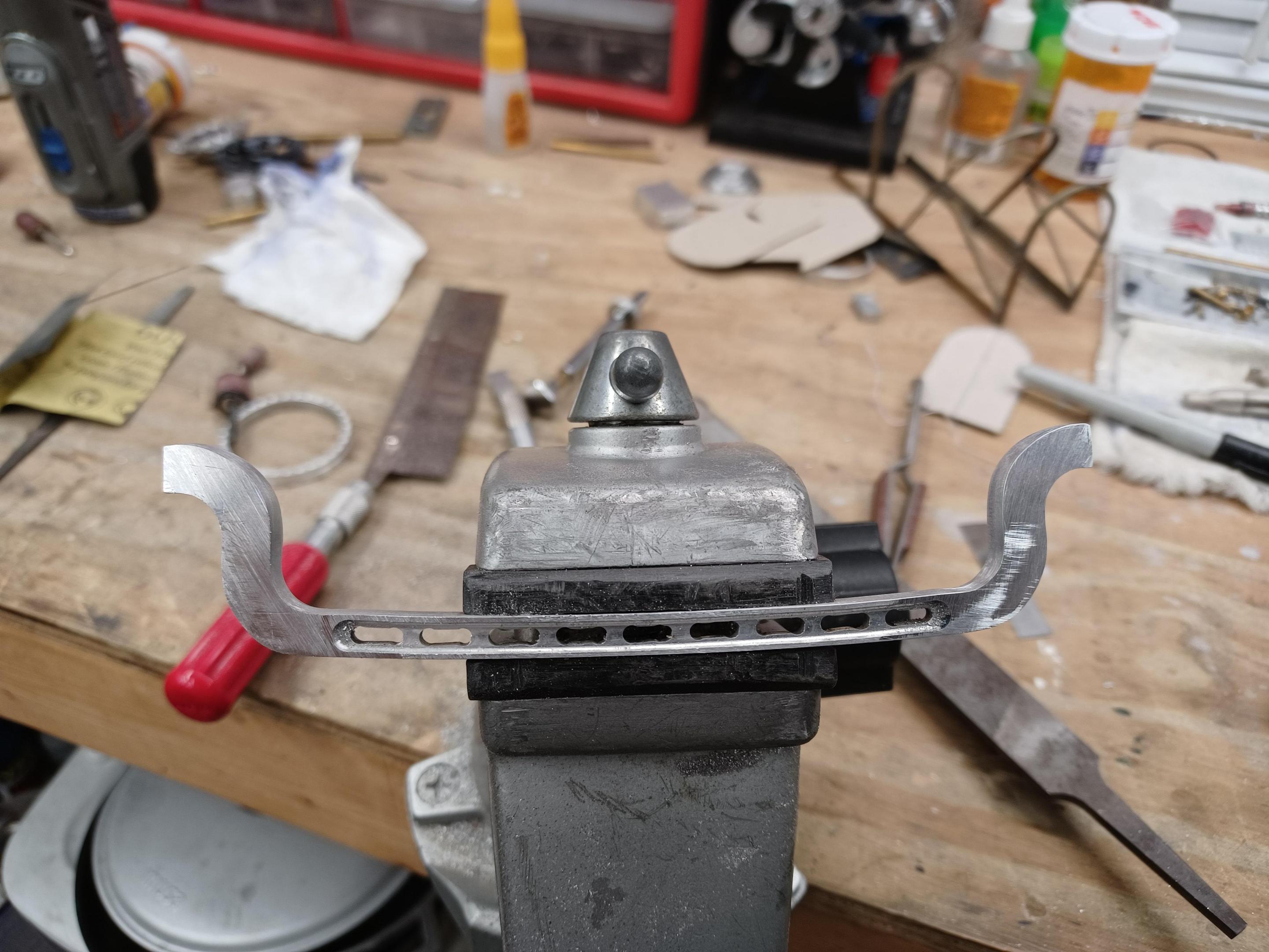

  20. hi andrew,thanks for the great pictures.that is a beautiful car. my mill was down ,waiting for parts for about 5 days. worked on the header and polished and plated my old grill for this car. after polishing the plating there are some small flaws but i think i have a cure. will see next time. got started on the rear section of the quick change

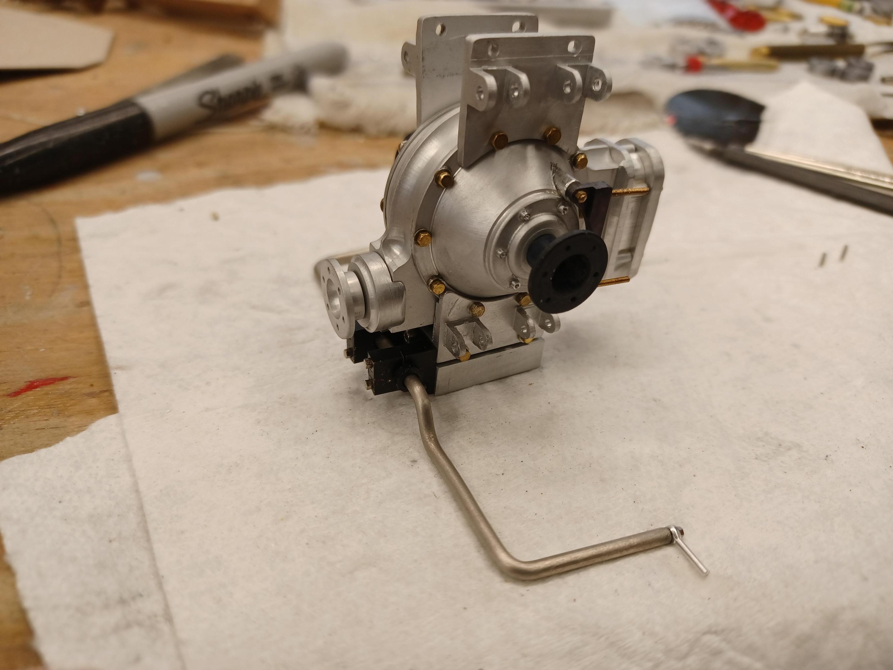

  22. thank you ira nice to hear from you. here is the latest progress. the beginning of a independent quickchange rear. aluminum cover on he hood side to cover the distributer drive that would be outside of the hood. the belly pan for your feet. its the floor more or less. i put fins in it to match the engine. it will be drilled and screwed to the frame rails. the plastic drive gear no my mill just gave up its job. ordered 2 new ones to have a spare. should be here by friday , i hope. all for now,thanks
  23. thank you all nice to here from you.trying to get all the stuff together to anodize. i have everything except a way to heat and boil water. . i think i have come to a decision that. thats the waterpump on the bottom front cover. the radiator hose goes straight in to th frontthese never had pullies on front to drive accessories so i have a drive pully on the front of the crankshaft just above the water pump. i am working on finishing the motor and transmission mounts.
