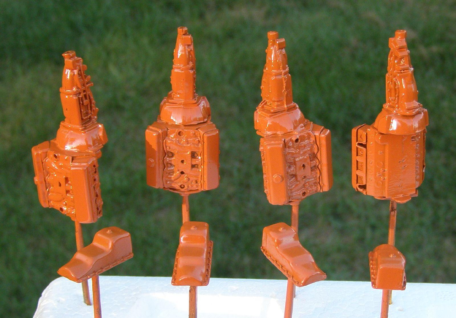

  1. As promised, there is new paint this update. A hot sewing pin made the pilot hole for the spark plug wires and the famous water pump bypass hose to the intake manifold. The engines look glossy but it's about 80% gloss, Am now committed to fabbing the bypass hose, hopefully from solid-core insulated wire. The transmission tops were left scabby because they do not show. The customized oil fill caps were filled with the superglue and microballoons then the surplus shaved off with the single-edge razor blade and finessed with a file and 400-grit wet paper. It's too much to make the engine compartment look completely right but the goal is to make the details noticeable enough that you can overlook the things that are lacking. Am thinking about trying the Revell distributor shielding and if it works, the Revell brake booster and master cylinder. Ya, $25 is a lot to pay for 2 small parts but it might be worth it.

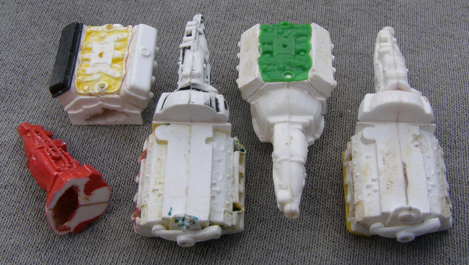

  3. Okay, more baby steps. Found another transmission to catch up 454-4 with the other three. This one came from Belgium and whatever they're using for model paint, it ain't Testors. After looking at it with the magnifier, the red paint is smooth enough to paint over without removing it with the EXPENSIVE paint stripper. So the mating flanges on the rear of the blocks and the bellhousing faces were dressed on a 12" double cut file and seemed to be square according to the trained eye. But after they were stuck on, it was apparent that the transmission tailhousings were off center a mil or less in one or both directions. That's .040" or less and the boss said "That's close enough!" The small engine parts except the starters have all been debugged of flash and mold parting lines and are ready for a bath and paint. Not worthy of a pic. After this pic was taken the 4th set of valve covers went on and the hole in the water pump was drilled (1/16th drill) through the blocks to accept a toothpick for painting. Since Chevrolet painted the engines and bellhousings together without the dust cover in place, the oil pans have to be painted separately to facilitate the hand painting of the black dust covers. We'll see some paint next round. The oil pan flanges on the blocks dressed to about 80% flat around the perimeter. Again: 'Close enough!" Time now to go back outside with the Superglue and Microballoons to fill the dimple in the OIL fill caps and touch up a few other questionable spots. Those Microballoons - tiny glass spheres - when you inhale some of them you know right away to not do it again. Bye for now!

  11. Baby steps: today's mission was to find some transmissions. That took probably a couple hours of sorting through boxes of glued and painted parts to find 3 engines to butcher. For whatever reason, the engines are always gluey but the transmissions not so much. The one with the black paint gets another 24 hours in the soup. Am scraping the bottom of the barrel now for these gearboxs. Next step is to scrounge the MPC 1966 Corvette boxes for one more. Picking thru the silver-gray 1966 Corvette stuff is almost like going to church. ? Trying to keep them all MPC, maybe as some kinda tribute. Gonna be a sad day when i have to start buying midyear MPC Corvettes again because they got kinda pricey in the past few years.

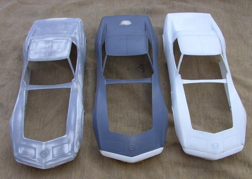

  15. We're gonna attempt a batch build of MPC 1973 & 1974 Corvette Coupes. These are the ones with a clutch pedal and a 4-speed stick working a poorly done 400 Turbohydramatic. That won't do so the transmissions have been carved off. Now where is the cup of those excellent MPC midyear Corvette transmissions? Nearly all of this is used except for the green and yellow pieces which came from one of those spectacular eBay lots which yielded about half a cubic foot of just vintage engine pieces. So the incorrect left side oil cap has been shaved off and the other side modded to mimic the rubber oil fill cap. Maybe the dimple in the center of the cap will get filled. Who knows? The underhood detail is charming but woefully lacking. There's just too much needed to make it look right so we'll stick pretty close to the way they were designed. The oil filters separated from the oil pans for ease of painting. 1974 was the last year for the mighty 454 in a Corvette and it was also the last year for the working control arms with steel coil springs in the MPC Corvette kit. You gotta be pretty choosy when buying prebuilts because some of the kids poured the glue onto those delicate front suspension pieces.
