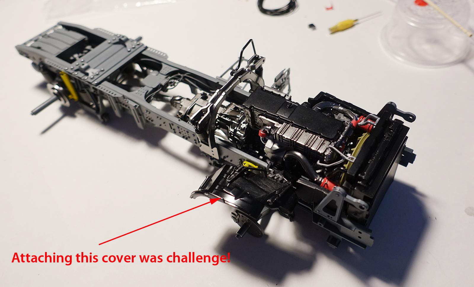

Happy New Year Håkan! Thanks for the feedback on this and keeping this build with me. For the problem, maybe I wasn't clear when explaining the issue. I wish it is the top grille that interferes, but unfortunately it isn't. The problem is with these two pieces (two red boxes) having no clearance and preventing the cab movement: To be exact, these four corners (red arrows) get locked in. Tightly! After studying the mechanism from my mock build, in order to display the truck in tilted forward position so engine bay is revealed, you must tilt the cab and assemble first, then attach this bottom piece. The cab will rest on the top of this bottom piece and it keeps the cab in tilt position. Wow. I am going to modify the hinge (green arrows) so the cab can be pulled upward when tilting is required. That can provide some extra clearance to tilting and it shouldn't increase the existing height of the cab. Hopefully, it is a quick fix. Haha, you are correct, all of the clean diesel components including DPF, EGR, and DEF related stuff always give trouble especially as soon as the vehicle warranty expires! And I heard they are expensive to fix! What about that!

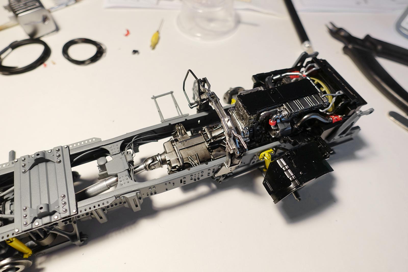

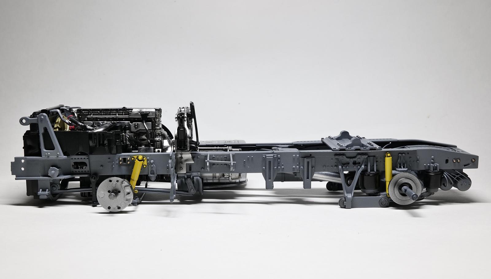

The GigaSpace is the configuration that you could order and it provides spacious cabin where you can comfortably drive, live, and sleep. Looking at the specification sheet, the head room is roughly 2.13 meters (84 inches)! You can stand and walk around inside the cabin. Not bad at all! I am slowly attaching each component one by one, and the truck is taking its shape nicely. Except a couple of "what to look out for" areas in this build diary, so far my build experience was quite pleasant. Yes, the rectangle looking silver box is the exhaust! I decided not to further detail the brakes. Once the wheels are mounted, no disc rotors/calibers will show up. After all, I am building this to finish quickly. I checked the fitment of various components including the air intake system. The lower body panels position well also and I verified their attachment locations. No unexpected finding so far and I started to "mock" build the cab. Using some masking tape to hold parts, I was able to complete this mock build. I examined things as to how I would need to build and paint the cab. I was basically planning my next move. I really like the look of this truck. Mercedes Benz did a fantastic job styling and designing this truck. I cannot believe this design is already 10+ years old though. Still the truck looks fresh and very modern to my eyes. By the way, this is when I also realized that I need to build this truck in one of the following configurations: Open hood configuration (means the cab in tilted position) Closed hood configuration (means the cab in driving position) The truck does not allow you to open and close the hood (cabin) once you make your choice and build that configuration. Strangely, the kit does have a functioning mechanism so you can tilt the cab! See below (red arrows): BUT the front bumper piece blocks the operation! I confirmed it with the instructions also, if you are building the truck in opened hood configuration, this is how the truck would look: I can't believe that my only option of displaying/revealing the engine is to make the truck in "Opened Hood Configuration". I wanted a quick build, but looks like this build may drag longer.

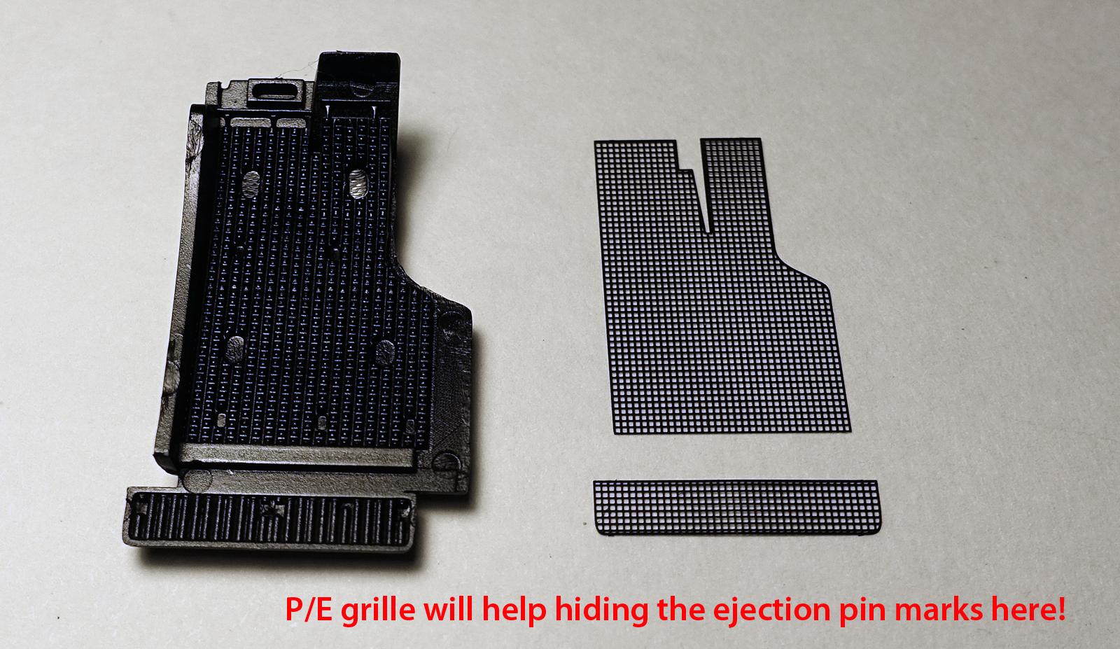

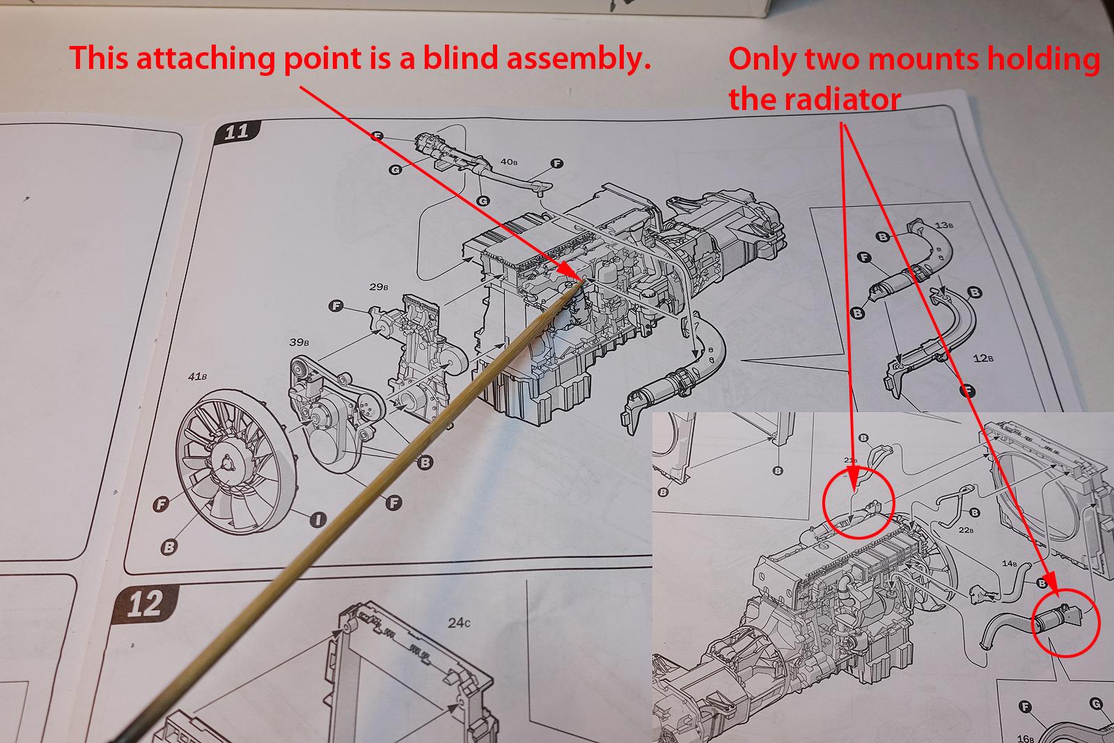

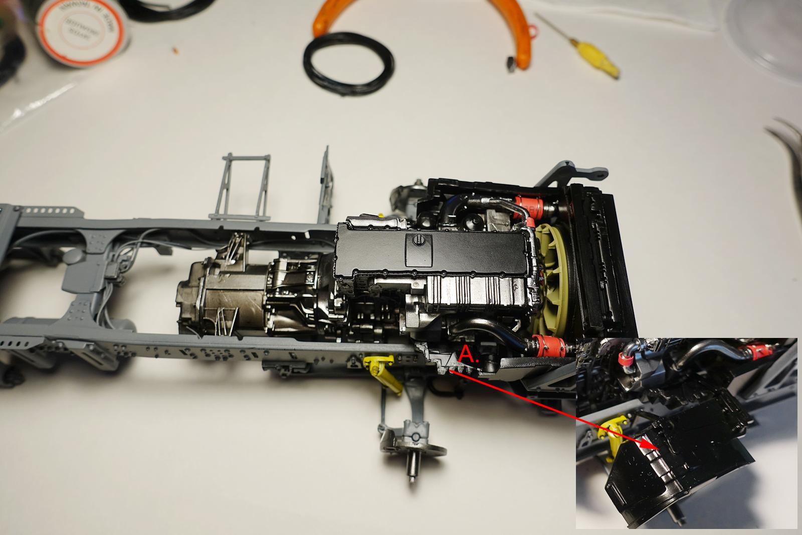

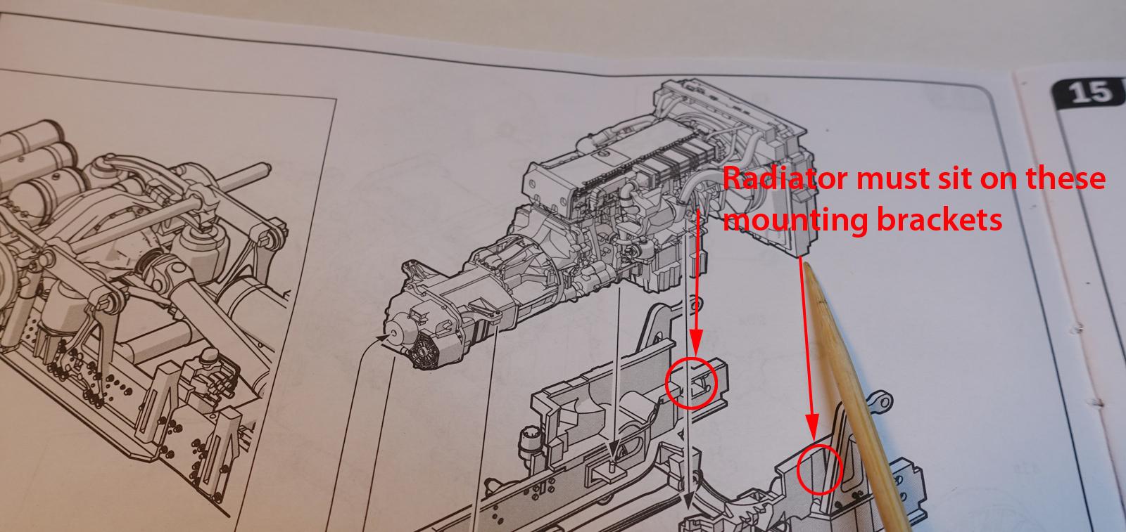

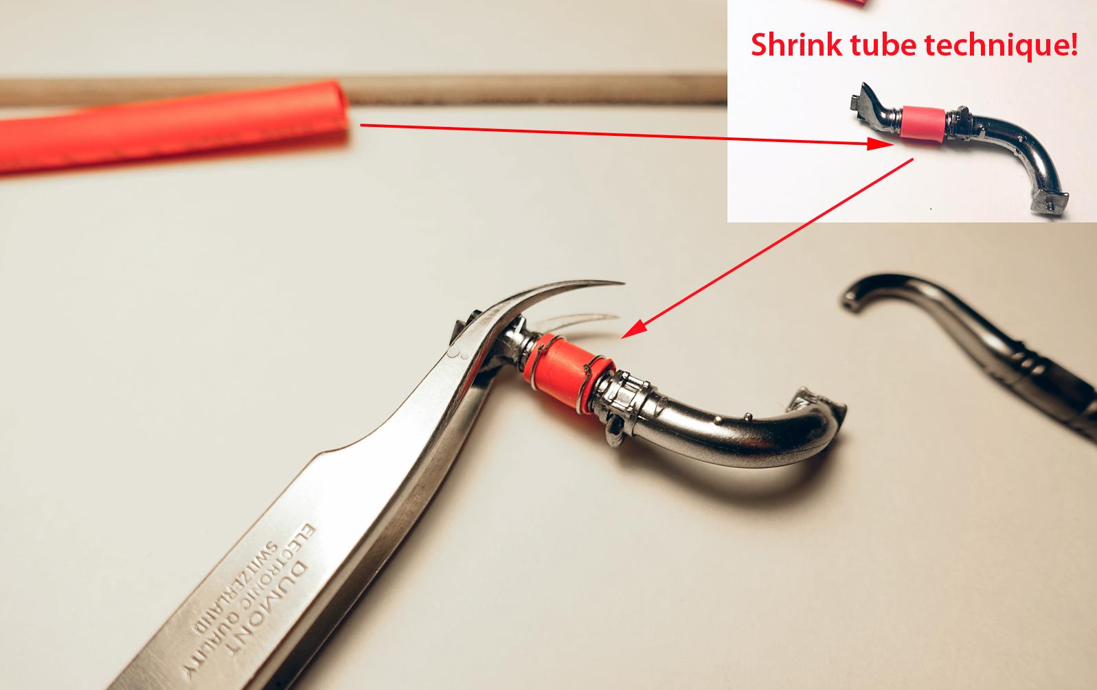

Interesting and informative discussions, I thank you gentlemen! The cabin assembly is something I will think about later, but for now, I am moving forward. The Hobby Design detail parts help improving the look of existing parts; it helped the mud guards assembly hiding pin marks. Moving onto the engine piping now. The instructions call for "red" gloss paint here, I used some red shrink tube instead. Then wrapped a thin wire to simulate the hose straps. These two coolant pipes on the radiator sides gave some problems attaching. They attached to the radiator suspended in the air. This is another challenge I faced. As you can see, these two coolant pipes struggled to hold the weight of the radiator. And I just can't attach the radiator without checking its position which is required in the next step. You may say, no problem, just super glue it! I can simply use CA glue to mount it securely, but then the radiator position has to be correct so it can sit on the radiator support on the frame. It really is a blind assembly. I had to repeat the assembly a couple of times till I made everything fit correctly. With the radiator mounted with coolant pipes on the side, it is a tight fit. So the correct positioning on everything is vital here. This is another challenge with an intake (not exhaust) mounting assembly. This is another blind assembly where the previously mounted location matters. AMT does this throughout their builds too. A. is where the intake mount arms are mounted to. My frame work is almost done, next I should be able to tackle the cabin interior work.

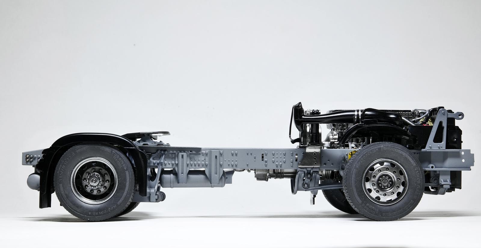

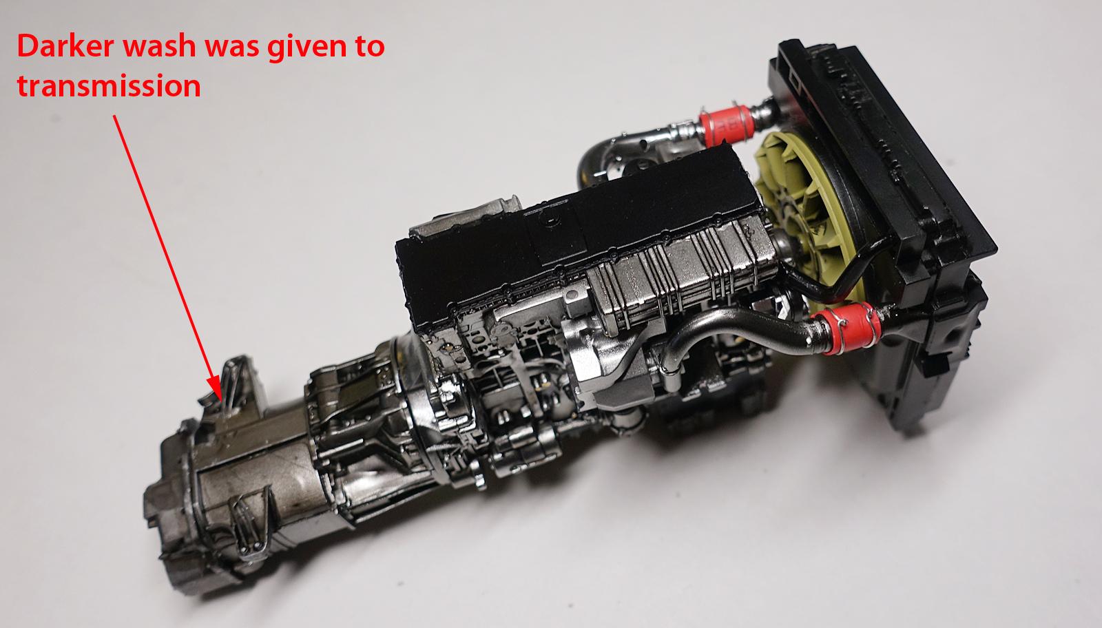

I must say the engine details in this kit is some of the best I have seen. That does mean much, but I really enjoy looking at the details on the engine blocks. It is shame the most of the details will be covered once the cabin sits on the top. After a couple of wash applications, the overall metallic tone became calmer. It can be fun playing around with this type of effect in scale modeling! The engine fits tight, but the problem I can see is the mounting of radiator. I will discuss more on this later. I am only adding minor details when they are exposed externally. One of those areas can be the compressor tanks mounted in rear. The air hoses do not connect anywhere, I made them to disappear into the frame. I simply wanted to make it look busy with several air hoses. This is an easy work, quick progress! I picked up this cable set from Tamiya Model Factory located in Shimbashi, Japan while visiting not too long ago. I am using them everywhere in this kit. They actually call this a "pipe" set and it really is meant to be used for Tamiya's 1/12 Ferrari 312T kit. ¥451 is roughly $3.10 at that time and I thought it was a big bargain. Also some of the fine wiring work, I used lead wires from UMM-USA. They flex and stay flexed which is a big plus. Some of the mistakes I made so far aren't big, but they are annoying for sure. I missed sanding these molding lines. I suppose I am trying to build things quick and taking some risk! The lines showing up under the suspension arms do not bother me much, but I decided to redo the ones located on the side. After sanding out the surface clean, I drilled some holes so I can insert my own bolts. Tuner Model Manufactory made some of the best and economical tuned parts. I will use these on the side. Hopefully they bring some quality impact to the build. I think these are better. I am glad I decided to fix it. But these will be hidden too once panels are attached! Another mistake I made was when I tried to expose metal surface after covering it with black paint. Need to repaint this again. I found out the front of the radiator isn't visible once the front bumper/grille is mounted. Silly how things happened for no reason. I used Aluminum tubes from K&S #3403 to replace the existing drive shaft. Not 100% accurate, but I think the result is worth it. Another painting session started. The build has been fun so far and I really like building this kit. My shocks are in yellow and hopefully they can provide some eye catching look!
