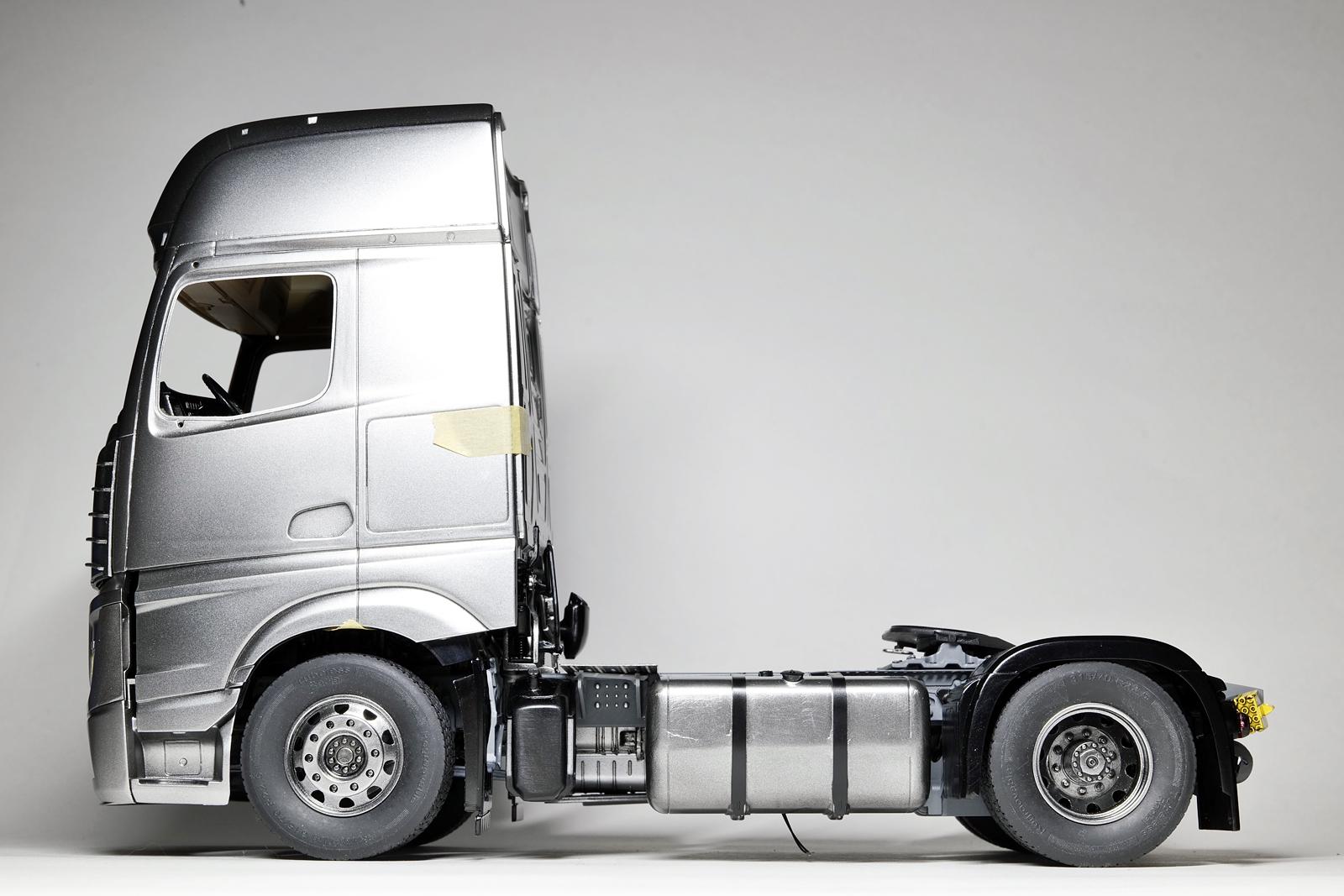

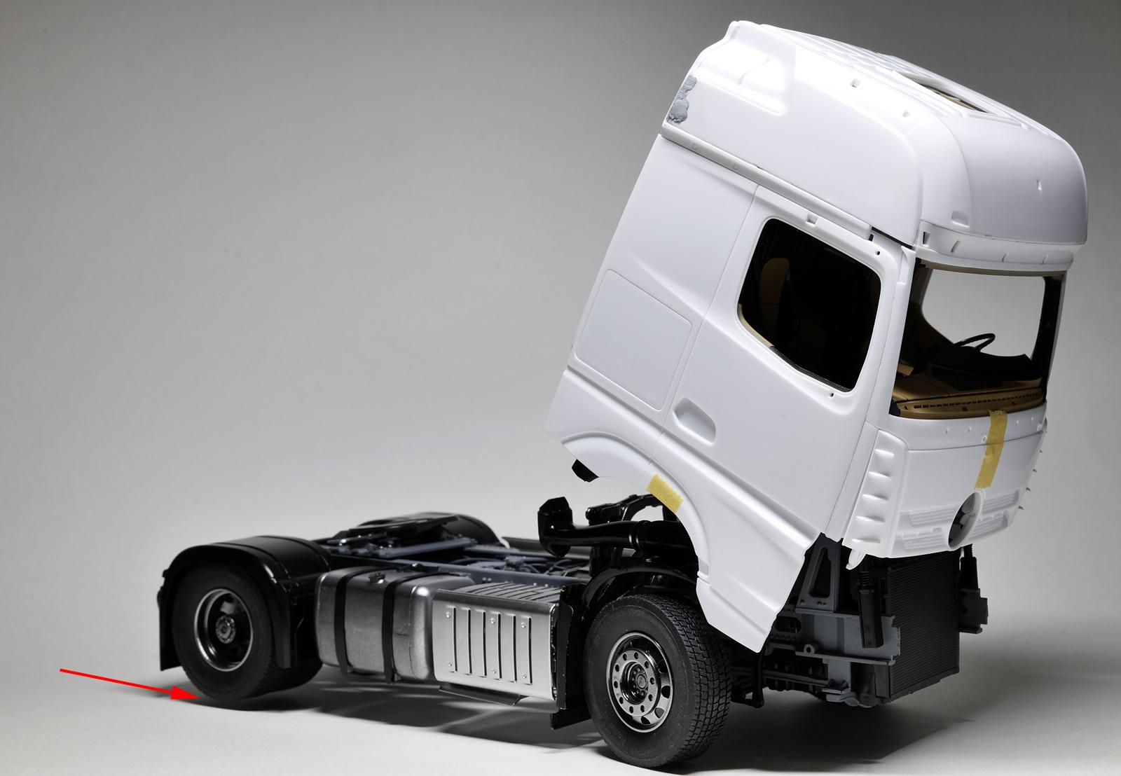

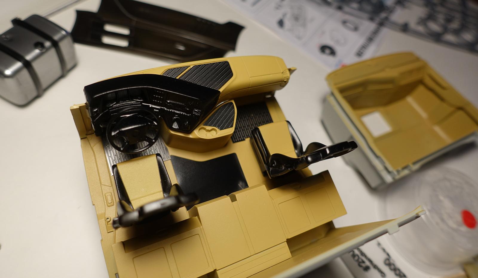

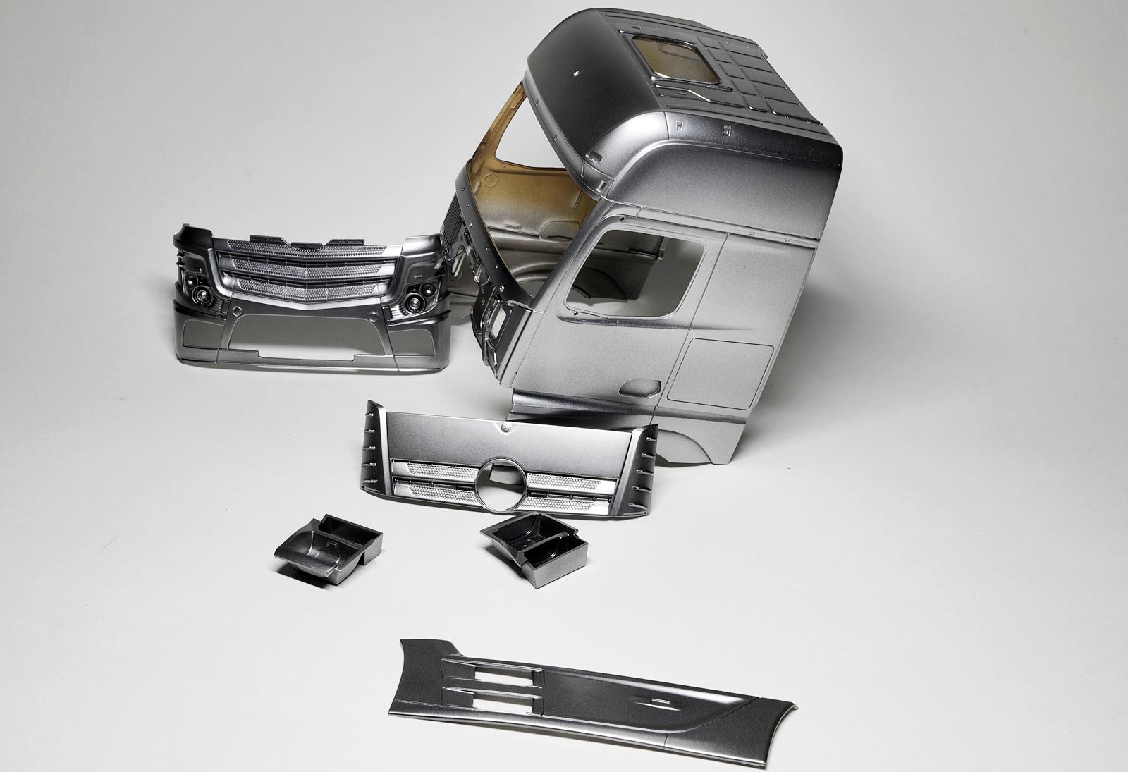

I am going through multiple painting sessions and things are not moving fast. I may not have much update today, but thought I should still share some contents. I really do want to build a black truck someday, but not with this one. I want this to be a cold silver truck. I did start out with a black truck and in my opinion, Actros in black looks quite good with this beige interior. Once I finished with prepping the surface, I began mixing my own silver paint. I used Finisher's CLK Silver (this is indeed German color) and Super Duralumin to enhance metallic feel to the finish. I mixed in the ratio of 3:1 using above two paints. This how I store\use the paint during my painting session. This is pre-mixed and pre-thinned, it really is ready to paint. No mistake, no fuss, and gives you minimum color discrepancy between painting sessions. There are many advantages of making own paint dispenser bottle and I really recommend to do this (unless you guys are painting from spray cans). I mentioned how to do this in my previous WIP: The link is also here if you are interested in details: https://www.modelcarsmag.com/forums/topic/181872-125-revell-peterbilt-359/page/1 My first coat is done. The color is quite bright, my camera is having hard time capturing the color correctly. If I am not careful when taking a photo of it, the color will come out as dark gray! A close up pic on the silver finish here. Based on how the light hits, the silver shade can come out much darker as you can see here. At any rate, I am quite happy with my initial painting session. I also pre-drilled a hole on each headlight. I will drill them out completely and insert my own headlights to enhance the look later. Italeri provided license plates from entire Europe for this truck here. I started to wonder what would have been their motivation for doing this... Instead of this kind of effort, please provide one piece cab. French plates caught my eyes and I decided to make this a French truck till I screw up. I applied a couple of clear coats on plates thinking shiny plates would look much better (like those GB license plates), but it caused all kinds of trouble here. The license plate backing pieces were ever-so-slightly smaller then decals, the license plate decal edges curled back up essentially ruining them. "No problem", I said. I still have 38 other countries to choose from! It is quite ironic though, Italeri went all out and gave us all these license plate decals to apply. And yet the supplied license plate holders are small to use correctly. I can't believe I went from black to silver in one day. Next, I will start applying clear coat to the truck.

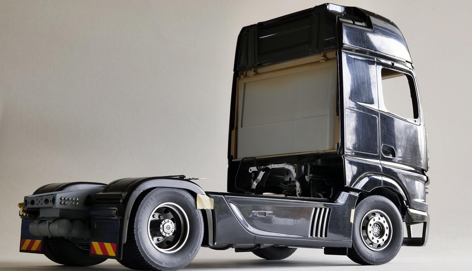

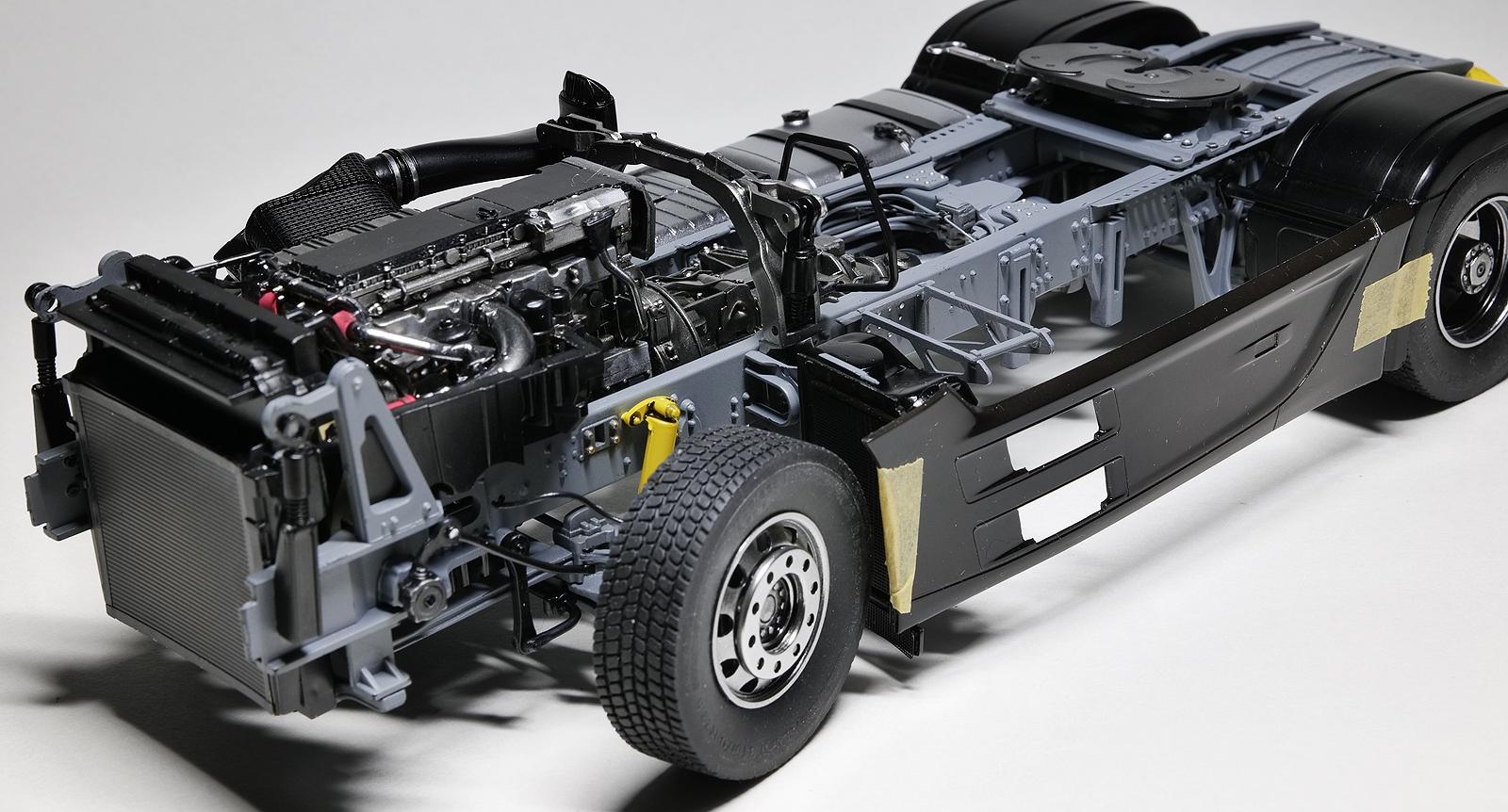

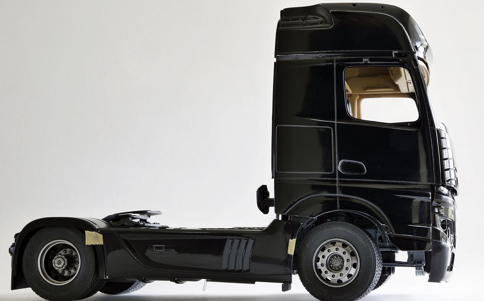

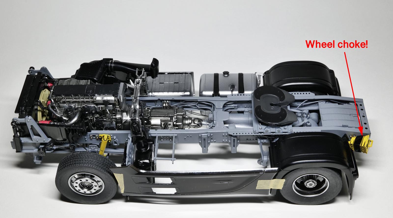

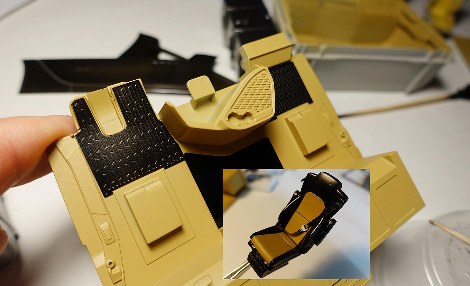

My body painting session is currently on-going and I used the following paint as my base: For the gloss black finish, I skipped applying the surface primer here because I wanted smoother paint finish with minimum thickness and also this is supposed to be a "quicker" build. The paint job came out with some minor paint defects, but I am going to polish using various polishing pads and polishing compounds on the entire body surface. I have my dedicated polishing box which has all kinds of polish pads and polishing rags. Whenever I open this box, I know I am in for a long boring session... Black is not my final color, it is going to be a base for silver. My surface must be smooth though, hence my polishing work is needed. I blamed myself for not being too careful, I rubbed away the top coat at too many places. I will need to address these later. As I was working to prep the painted body panels, I also added small details around the frame. It took some time to figure out what it really was, but it is a wheel choke! My other guesses were "mini parachute" and some kind of "liquid dispenser". I am thinking it must be an European regulation similar to the carrying a safety vest or warning triangles? Nonetheless, the mount position is interesting here, it almost blocks a view of a rear license plate too. Italeri kit has a great amount of details out of box. I only added a few P/E parts from Hobby Design detail kit and yet the truck is full of details. If I add a big turret and some body armor around, I can almost pass this Actros as M577 APC from the Aliens movie! Don't you agree!? Also added P/E frame floor parts and they really enhanced the "metal" finish to the truck. I intentionally painted those two fuel tanks (one on each side) with different aluminum shade to make things more interesting. I also re-attached the real wheels as wide as possible without hitting the wheel guards on the top. The wider they are, the better looking I feel~ Getting closer, but still many items left to take care of...

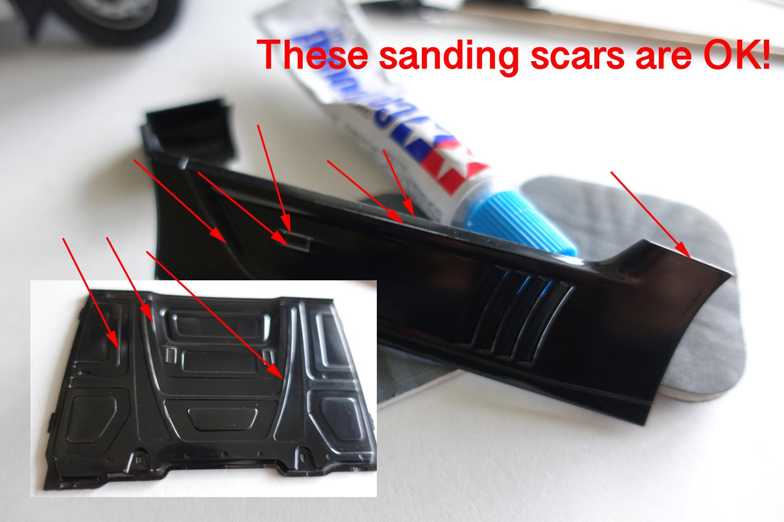

Instead of using typical sand paper, I have been using sanding sticks. I think they are better and easier to handle. My routine is usually starts away from 400# and go up to 600# to 800# for normal sanding work. I usually end up around 2000# grits, but not always. For cleaning out a detached part, I usually stop at 800#. I bought these generic brand sanding sticks from online (not expensive) and while they perform as expected, I think the sticks wear out quick and still require some work to sand things smooth. I search of something better, I tried something more expensive and made in USA. These are from a company called DuraSand and they have different colors for different grits: Again, I think these work slightly better and easily last longer, but I still feel like I am still spending efforts to sand simple parts. At the end, it could be my method that needs to improve, but I would like to know if you guys have your "golden" sanding method or tool, I would like to know!

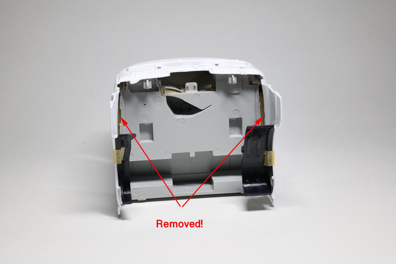

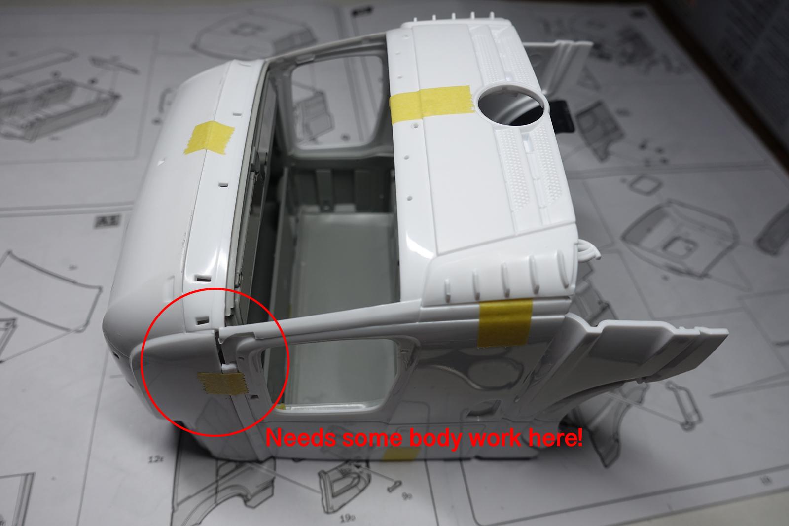

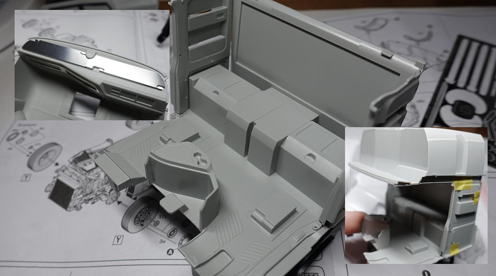

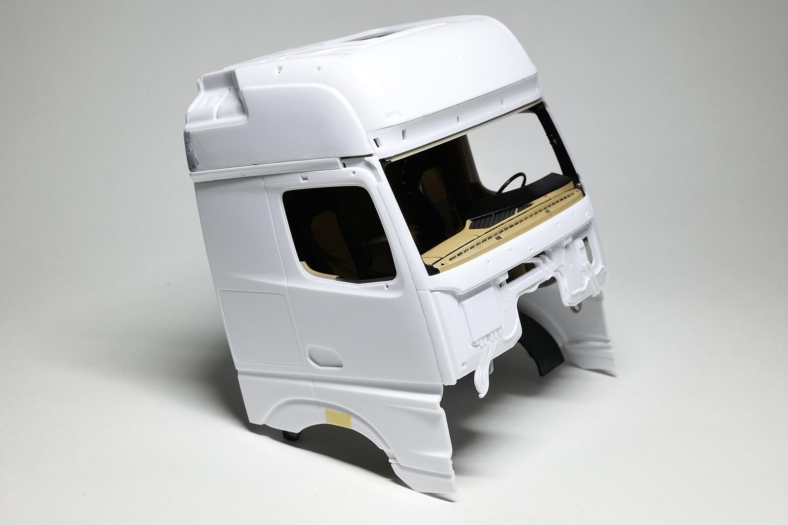

Hi Dan, Thanks for the positive words and your feedback on this! As I was building the cab assembly, I was kept asking myself multiple times in disbelief- "is this right? Am I doing something wrong here??" Right, your second method makes sense to me. I suppose I could have done this way also, but my small concern would have been “masking” things. The required technique is to mask things perfectly and I will definitely consider this option in the future though. I do respect Italeri for producing their truck kits this way when obviously it is so painful to build the cab for us builders. I guess it is true what they say, no pain, no gain!
