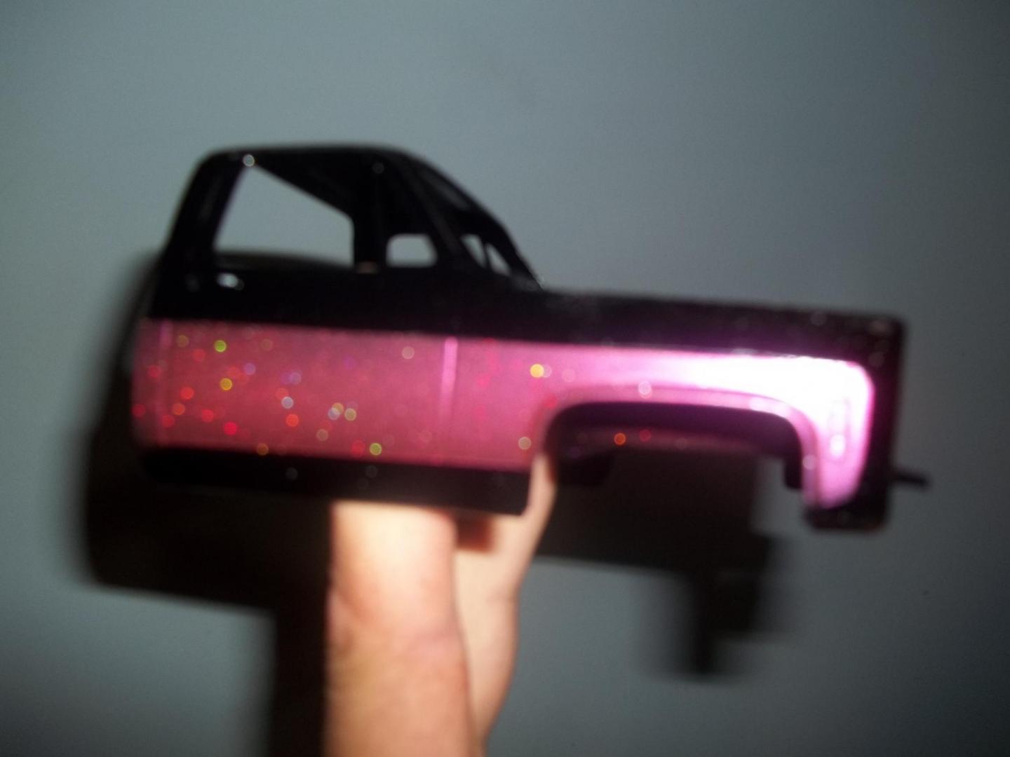

This one is done using Pearl-X Interference Red mixed into Paint Shop clear. It also has some Cherry Red Recollections flake added in, and is shot right over the black, no different base coat under it. Not really the effect I was after, but it turned out ok.
