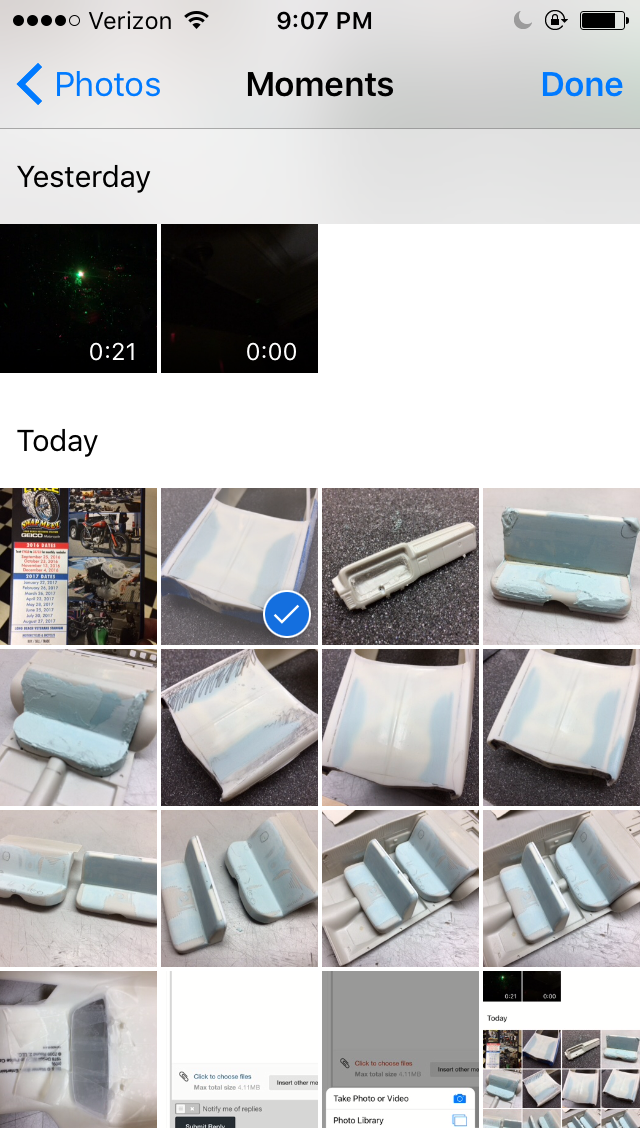

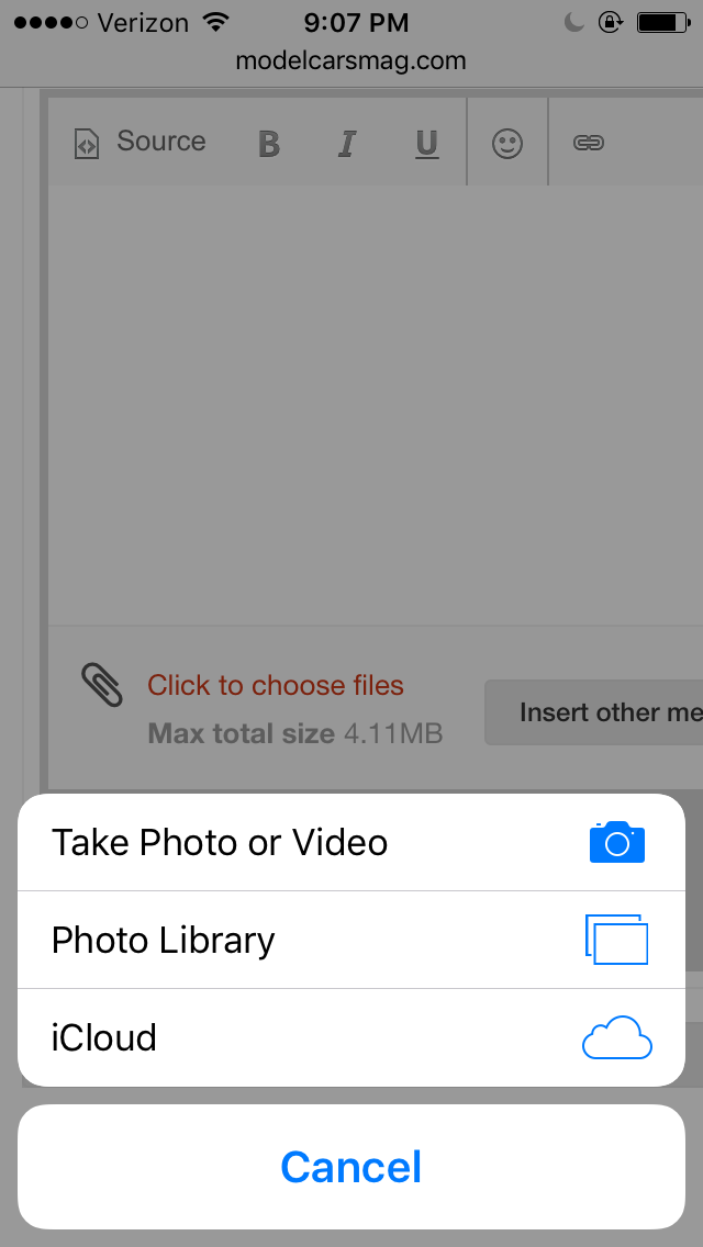

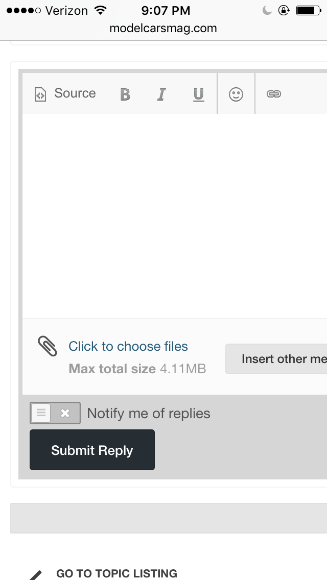

Your computer or device might look a little different but the concept should be similar Reply Click to choose files (on your computer) Submit Reply that's one way. You can also add attachments or add a link or imbed a photo -
