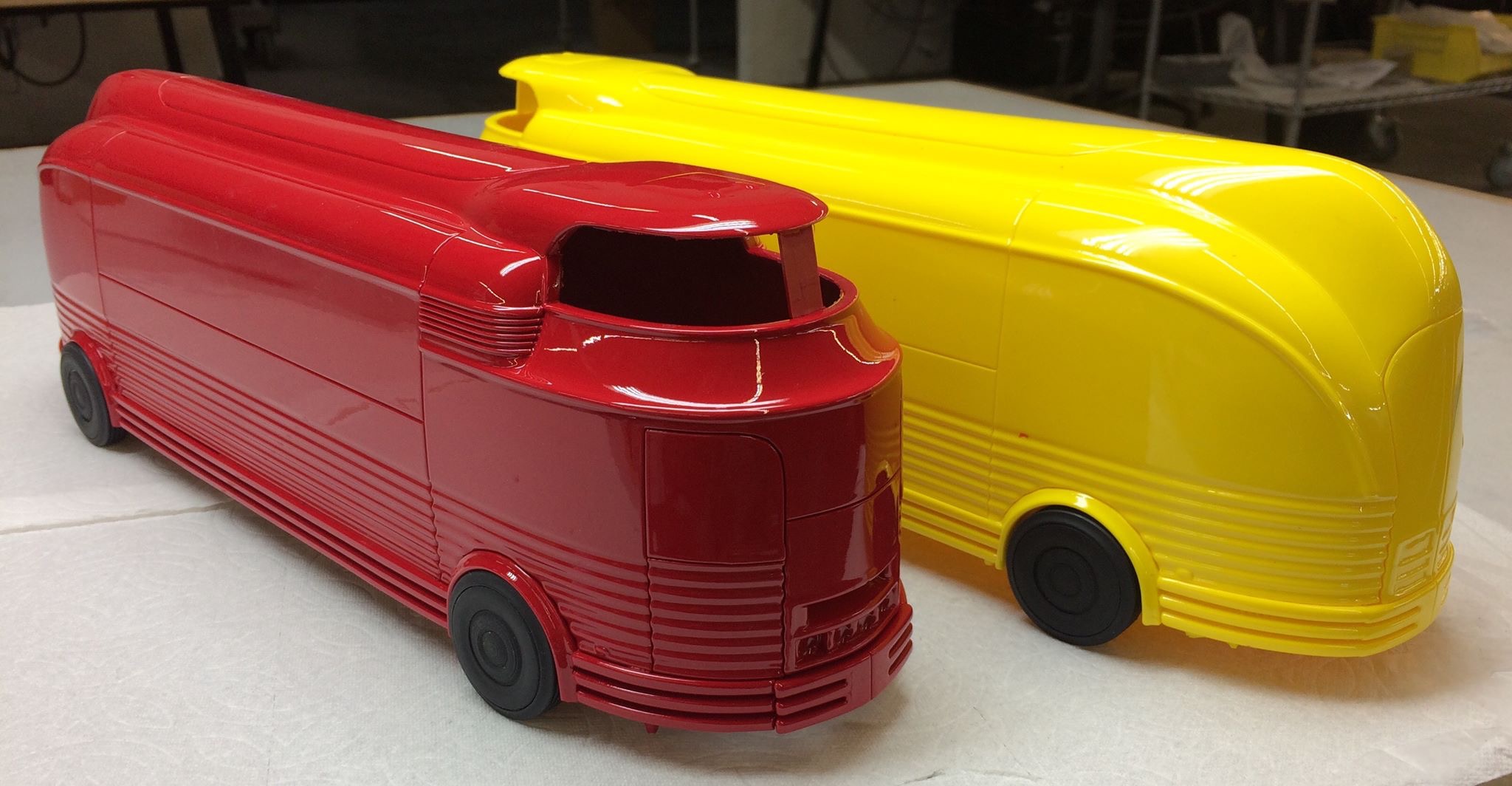

  4. Silicone: This kit has 3 molds and 6 parts. Body, black glass, and 4 wheel tires. As stated above, the body is one piece and is 17.5" long x 5" tall x 4.25" wide. I choose to make the glass black to make it a slammer because adding an interior would have made the kit more expensive and out of reach for most builders. Shooting clear glass is a hassle for me because the clear I use takes longer to degas, longer to cure, and requires an oven. The buyer has a choice to make their own interior and glass if they wish. There are 4 wheels in the kit, while the original had 8. I reduced it to 4 so it could mount to the sides and be displayed without a chassis. Costs: Material Body - $228.90 each mold can make one body and generally lasts for 25 good shots. Keep in mind, this mold is large. Divide $228.90 by 25 gives us $9.16 per kit Tire/wheels - $77.67 Each mold can make 4 sets and generally lasts for 25 good shots. Divide $77.67 by 100 gives us $0.77 per kit. Glass - $61.00 Each mold can make 3 good casting (2 rejects) and can last for 25 shots. Divide $61.00 by 75 is $0.81 per kit Silicone total is $367.57 Per kit cost is $10.74

  6. Case study number 1: 1/25th scale Futurliner $165 including shipping Master pattern cost: N/A for this project. Masters were paid for with the proceeds from the first run of the kit. The expenses included CAD costs, 3D printing costs, masters prep time, etc. Master prep cost: I took the previous masters and glued the separate body panels together. This way the model body was a single unit and is poured as a single casting as opposed to 8 castings. This save me labor and reduced the cost of the kit. Master prep. 8 hours of work X $15 per hour = $120. Paid a helper $140 for an additional 8 hours of work (finishing and paint inside and out). Total $260. Divided by 100 castings (assuming it will survive being molded 4 times and that I wish to cast that many) the cost per kit is $2.60
