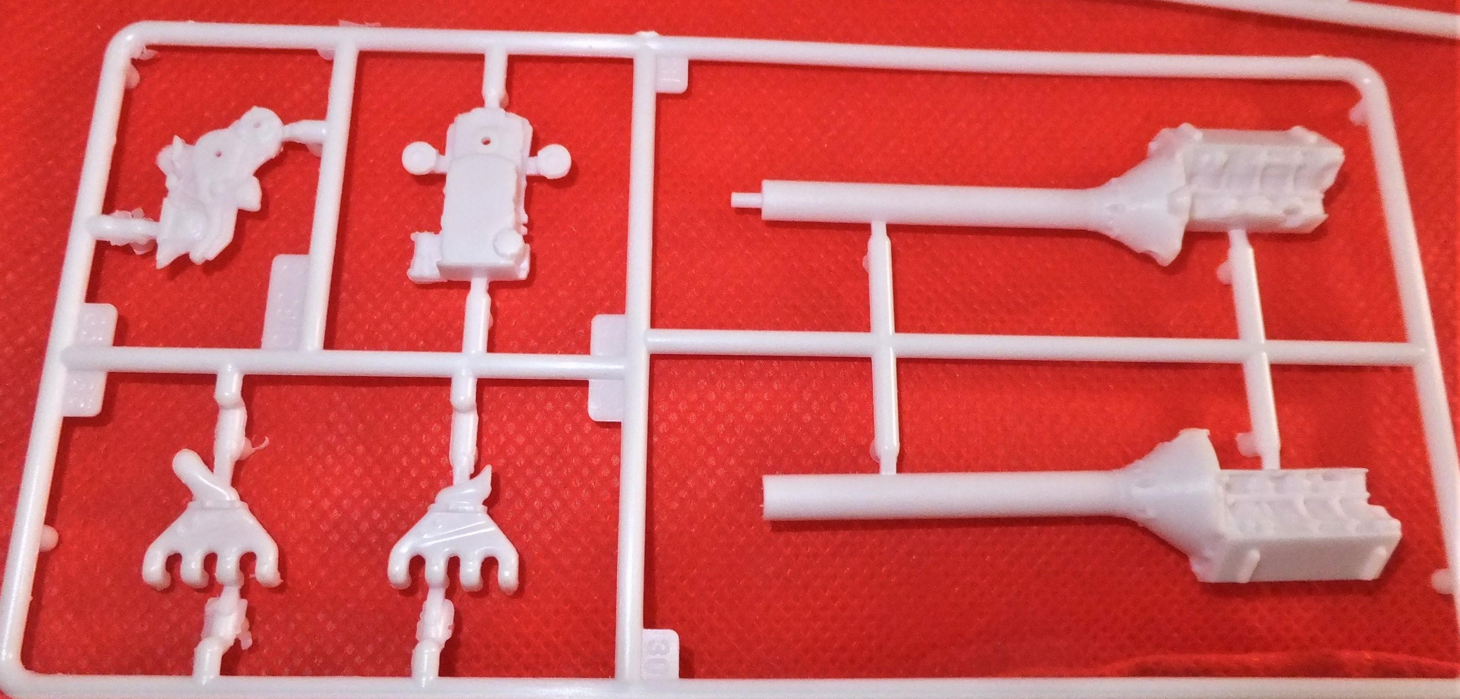

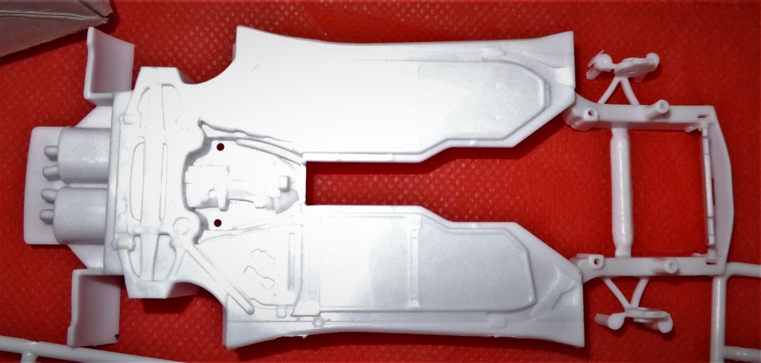

Generally, when someone mentions LS engines they mean the modern era LS/LT engines. The AMT 70 1/2 B-M Camaro has a very nice Big Block engine that would certainly fit the 66 Suburban, but is a totally different vibe than the modern LS. For that, one needs to look at Revell Gen5 Camaros for attached transmission versions, the above mentioned Chevy pickup or SSR (their Vortec engines are iron block LS), or C5 and C6 Revell Corvettes if you want to cut off the torque tube and add a transmission (or go all out with a transaxle and IRS). That is why I asked above what engine family the OP was referencing
Are you asking about modern LS engines (or LT engines in the Gen6 Camaro)? Or older LS engines which are big block. Chevrolet has reused the engine designations more than once on different families of engines.
