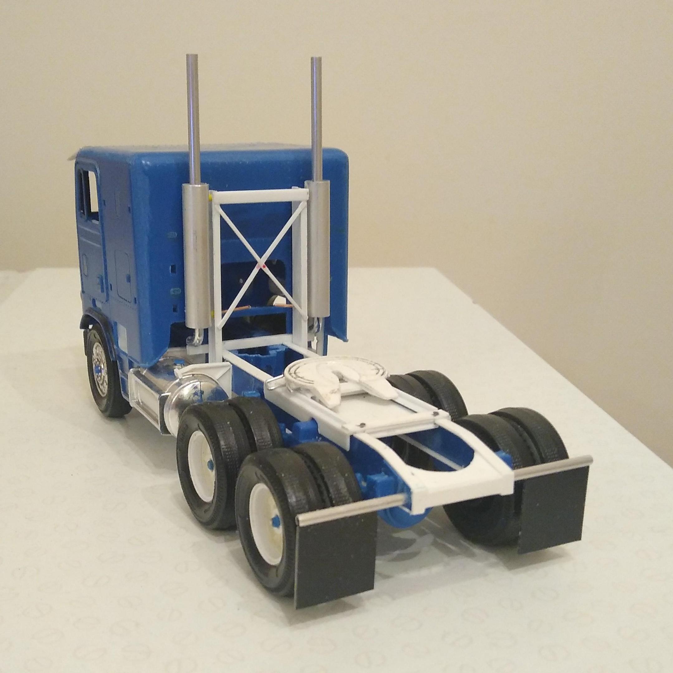

Pete68 avert your eyes! Made my exhaust stacks and mounted them provisionally. Made some tank brackets that look more like the real thing. Got one done, I'll show more when I do the other side. I'm well aware that the cab doesn't look right. One reason is that the windshield top rail is too low. I added new top "rubbers" and then filed away the original. It does look much better, needs tidying. Started a visor from aluminium sheet but needs trimming. Before... After... -

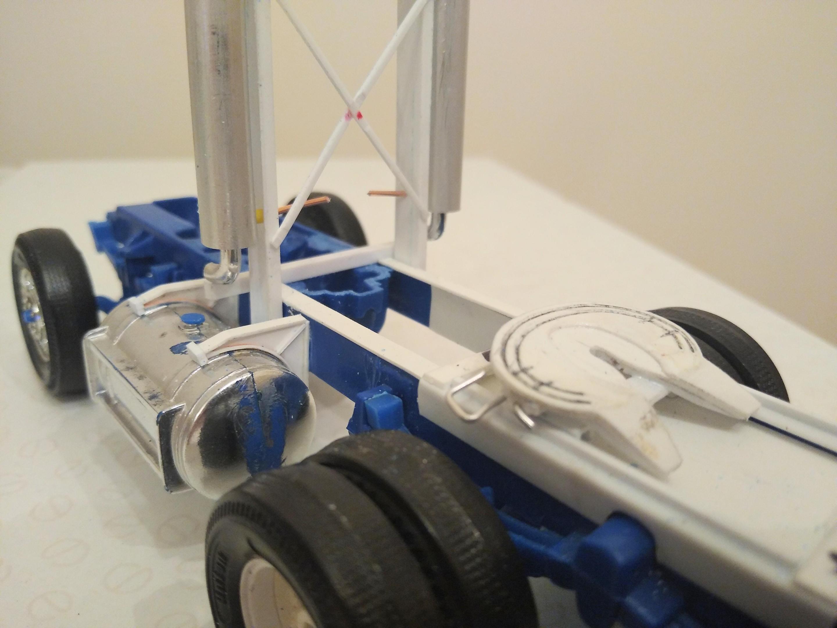

Cut the back wall of the cab open, I'll use real aluminium screen in the hole. Fabbed some brackets for the stacks in a similar setup to the AMT 1/25 kit. Relocated the battery boxes to the inside of the exhaust frame. Things are beginning to take shape. -

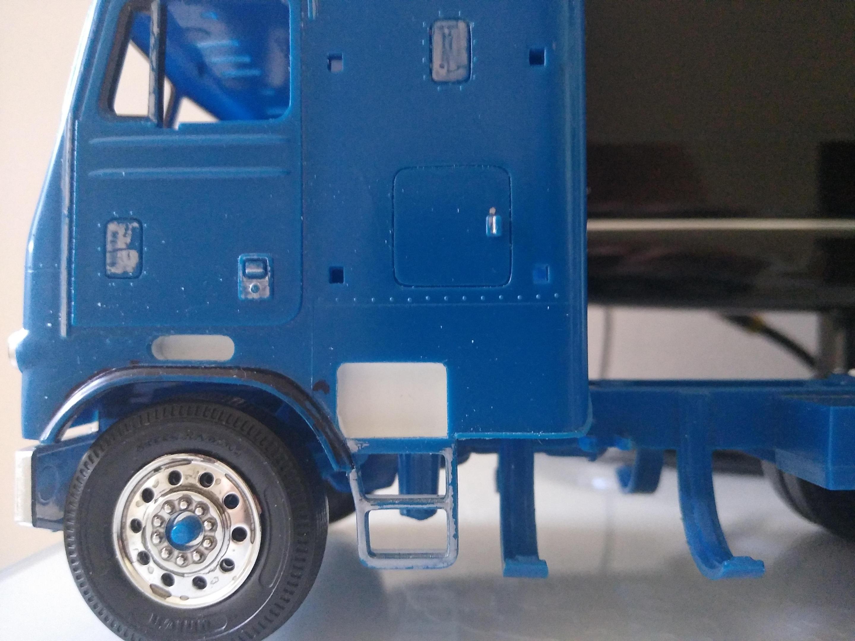

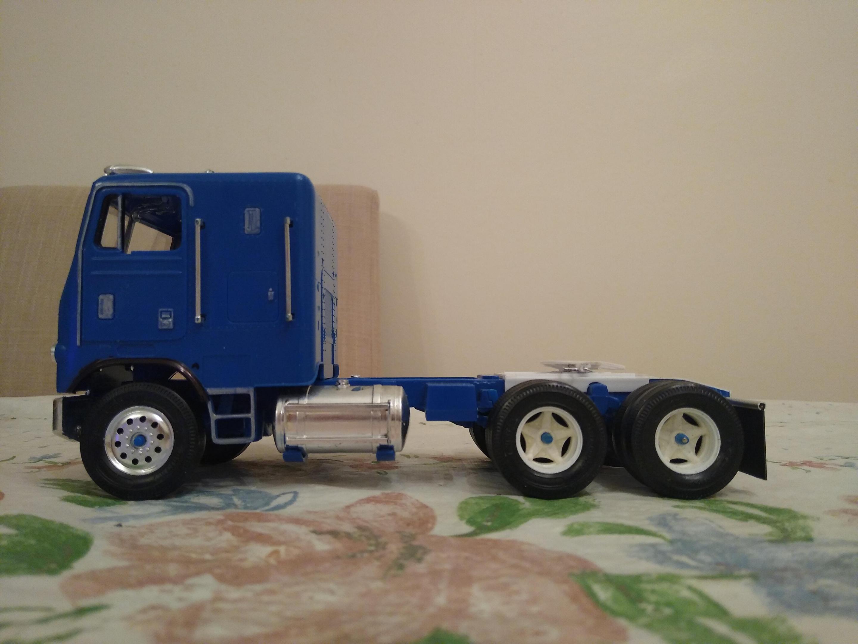

Shortened the chassis by cutting out the battery boxes. I'll remount them between the stacks on top of the chassis. Cut the tank mounts off too, I'll make something more in keeping with a Freightliner. One of these days I'll make a long framed cabover, but not this time. -

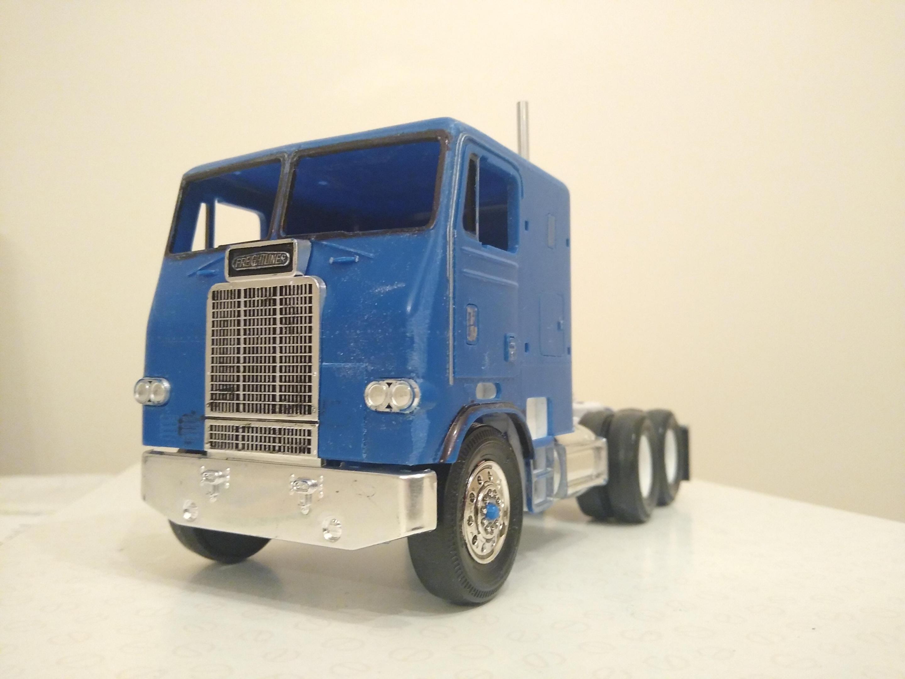

Just put it next to a K100 and you're right, it is narrower by the same width as the rubber arch-trims, so maybe that's what caused the problem with mould limits. I've considered sectioning the cab and adding a strip each side but I'd only destroy it in the process and that would probably reveal other dimensional issues that the shrinking has caused. I'll just have try and maintain the illusion and keep it away from the other cabovers, like Smokey Yunick with his 7/8 Chevelle. You may have to avert your eyes for a while...? -

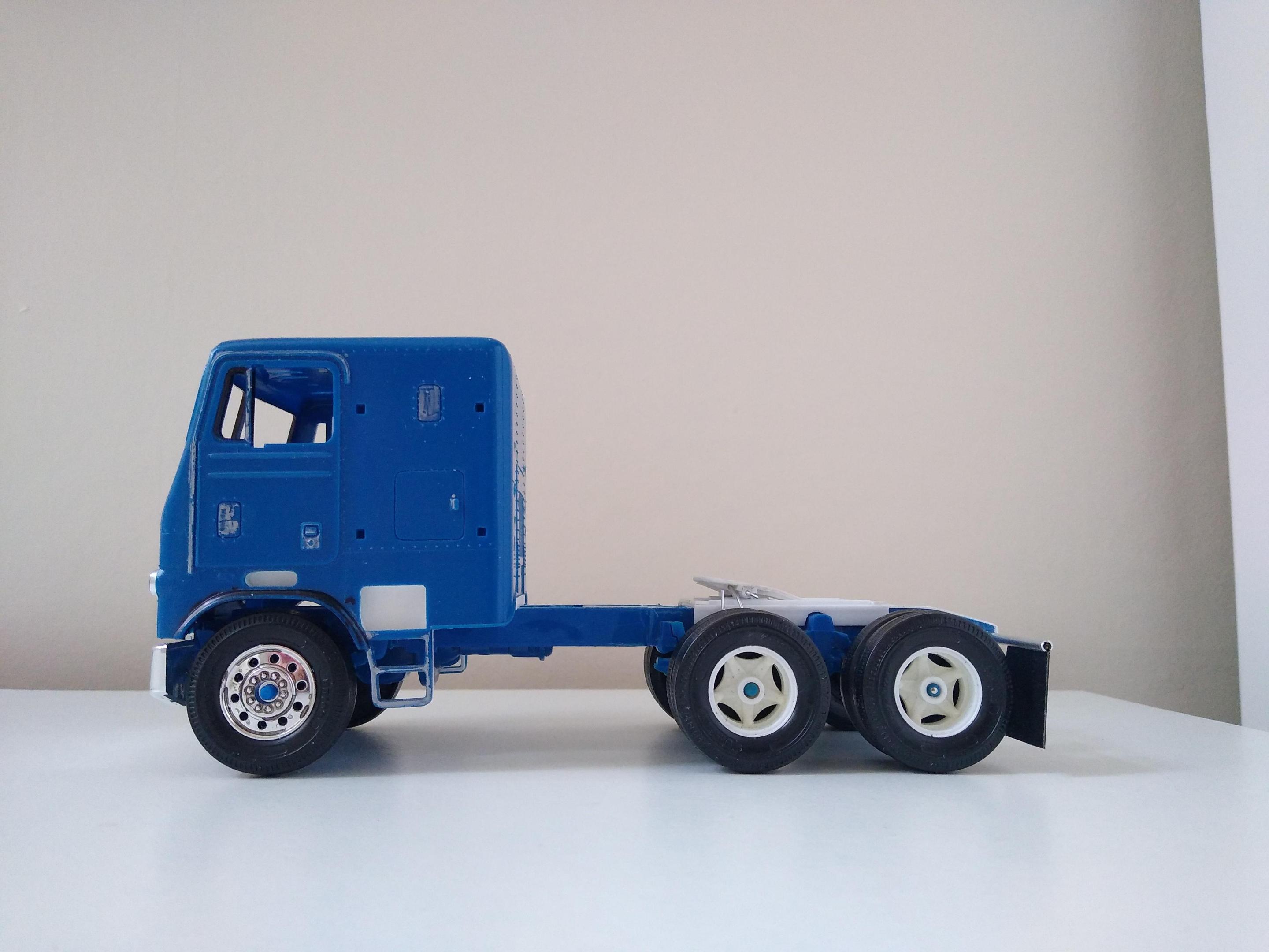

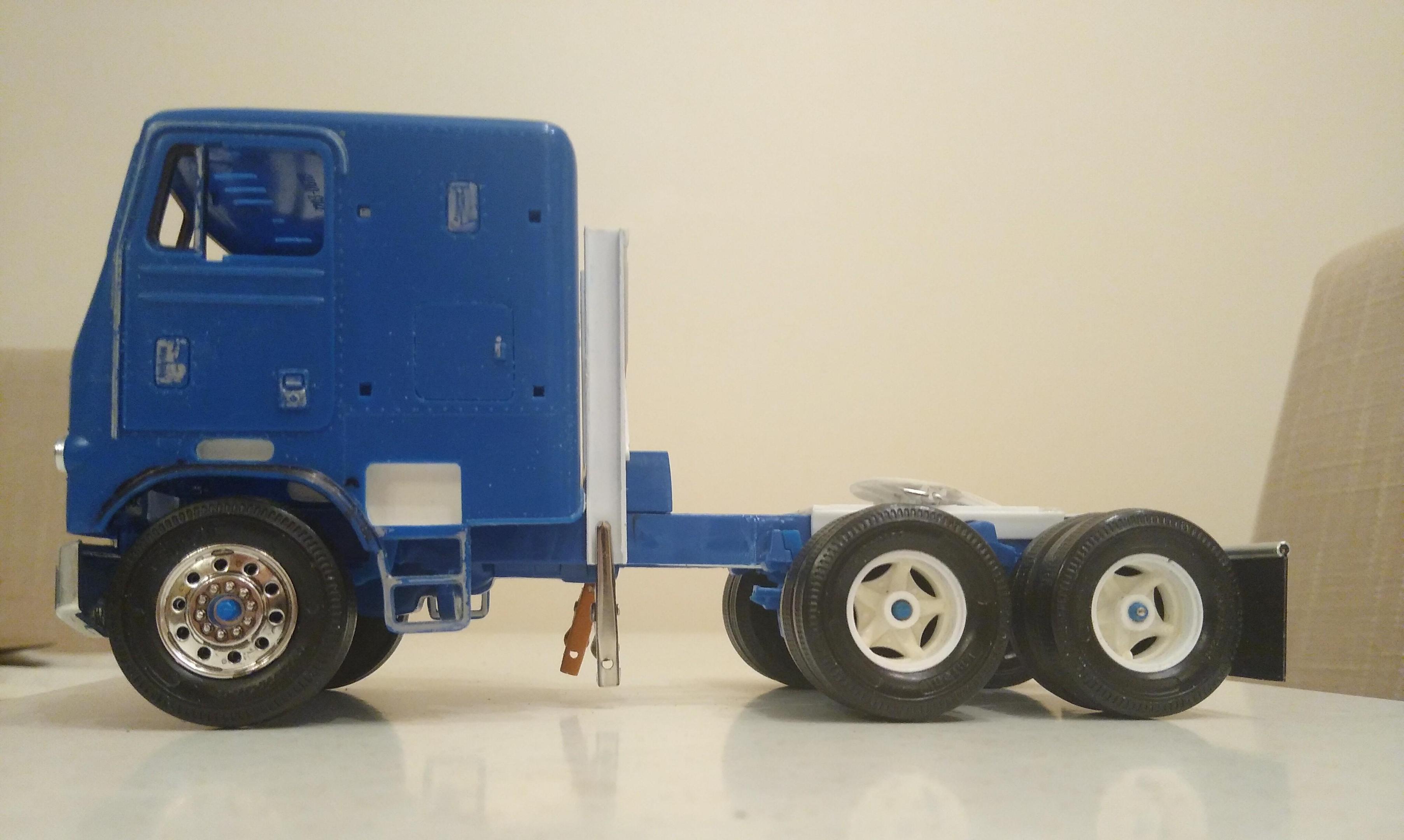

I've dropped the cab slightly and it definitely looks more like a Freightliner, moved it back a fraction too. Narrowed the track on the front axle a little and added the newer style front wheels. Used the bosses that I cut off the rear wheels to make hubs on the Daytons. Opened up the cab steps and boxed them in, then added 2.5mm strip behind the kit moulding as in the real thing. Looks ok. -

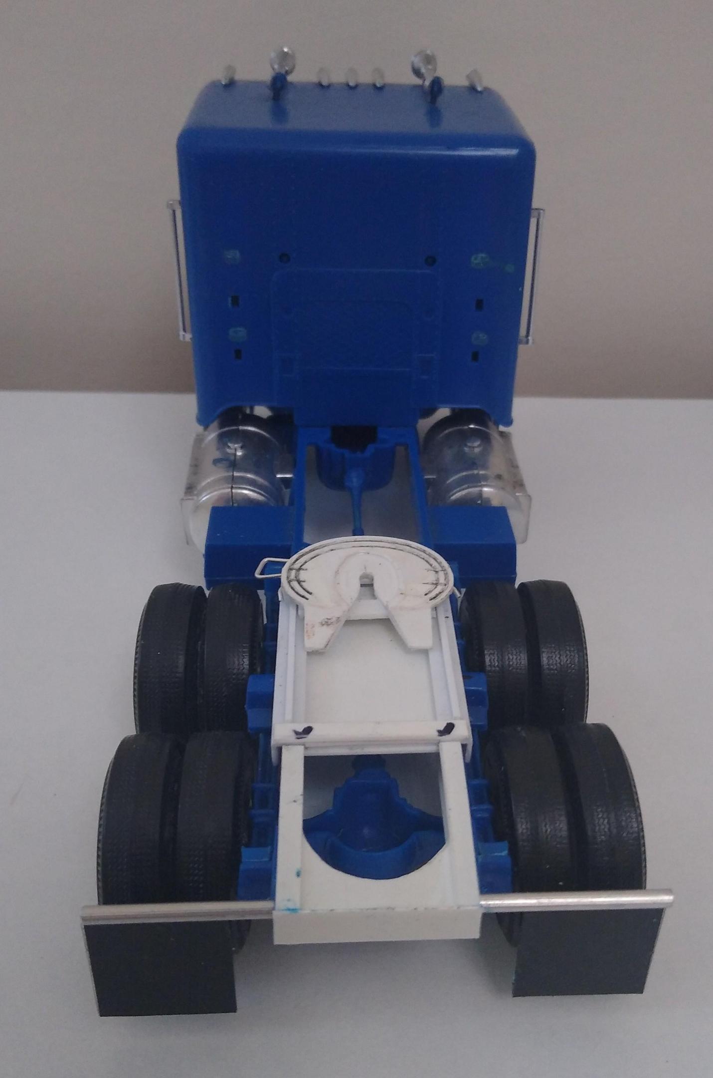

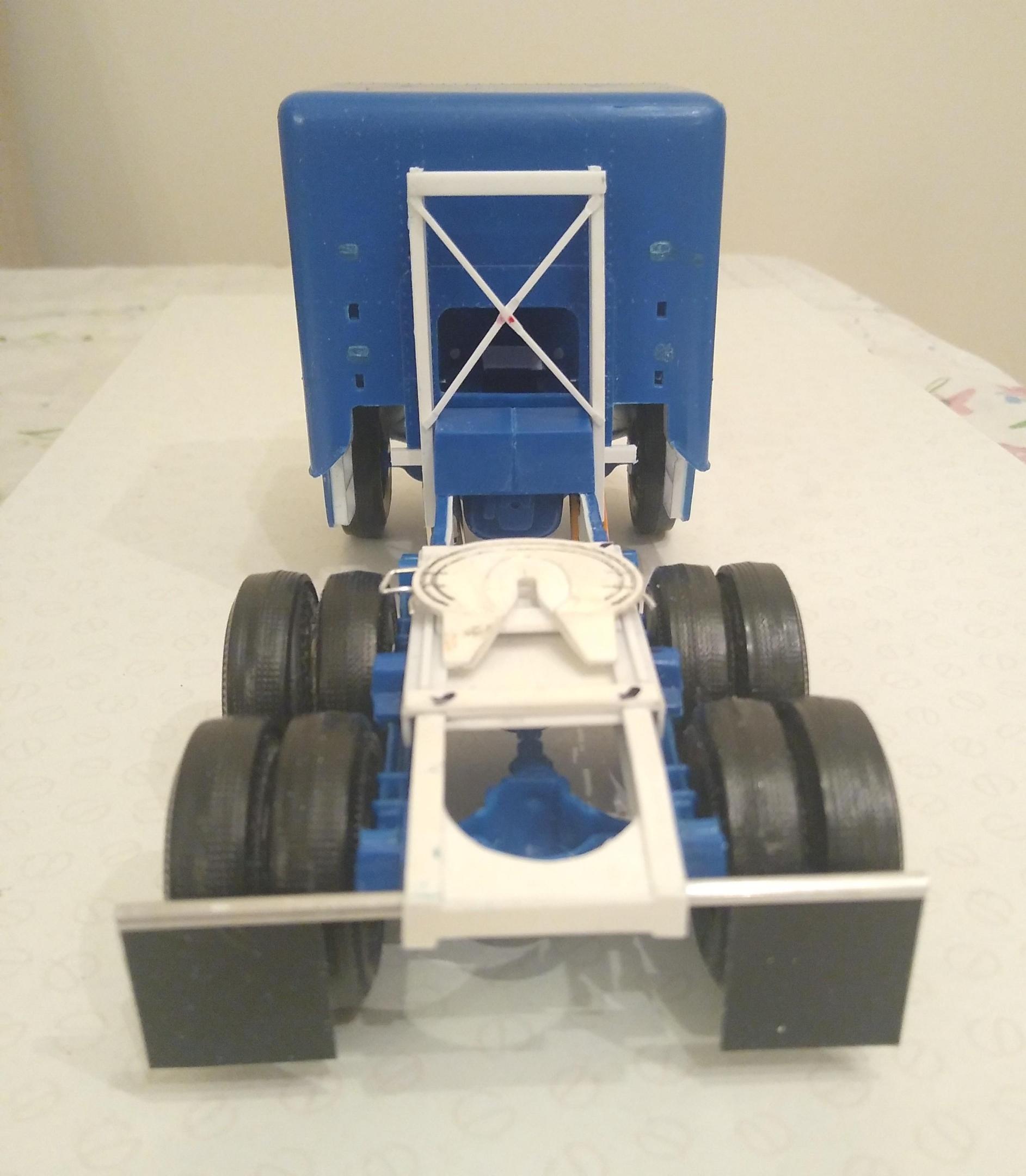

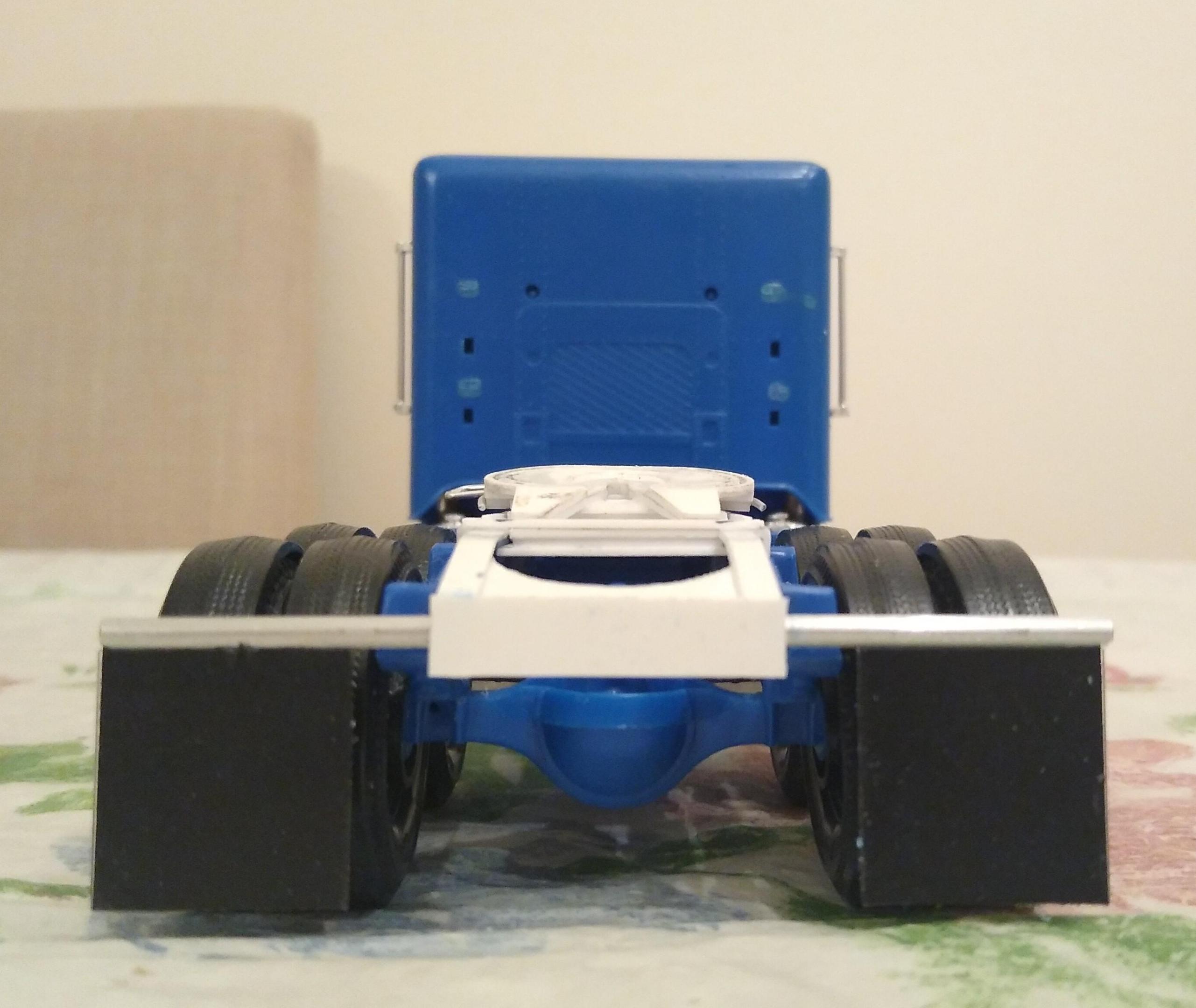

Built a Holland fifth wheel from two layers of plastic sheet and a load of 1mm square rod. Used a set of dividers to scribe the grease grooves into the plate, all looks period correct. Also assembled a slide frame. Trimmed the rear of the chassis frame, installed a rear crossmember and added top and bottom flanges to the chassis. It's definitely too long in the chassis, I'm going to have to lose about 15-20mm. I'm not sure if I'm fitting quarter fenders. -

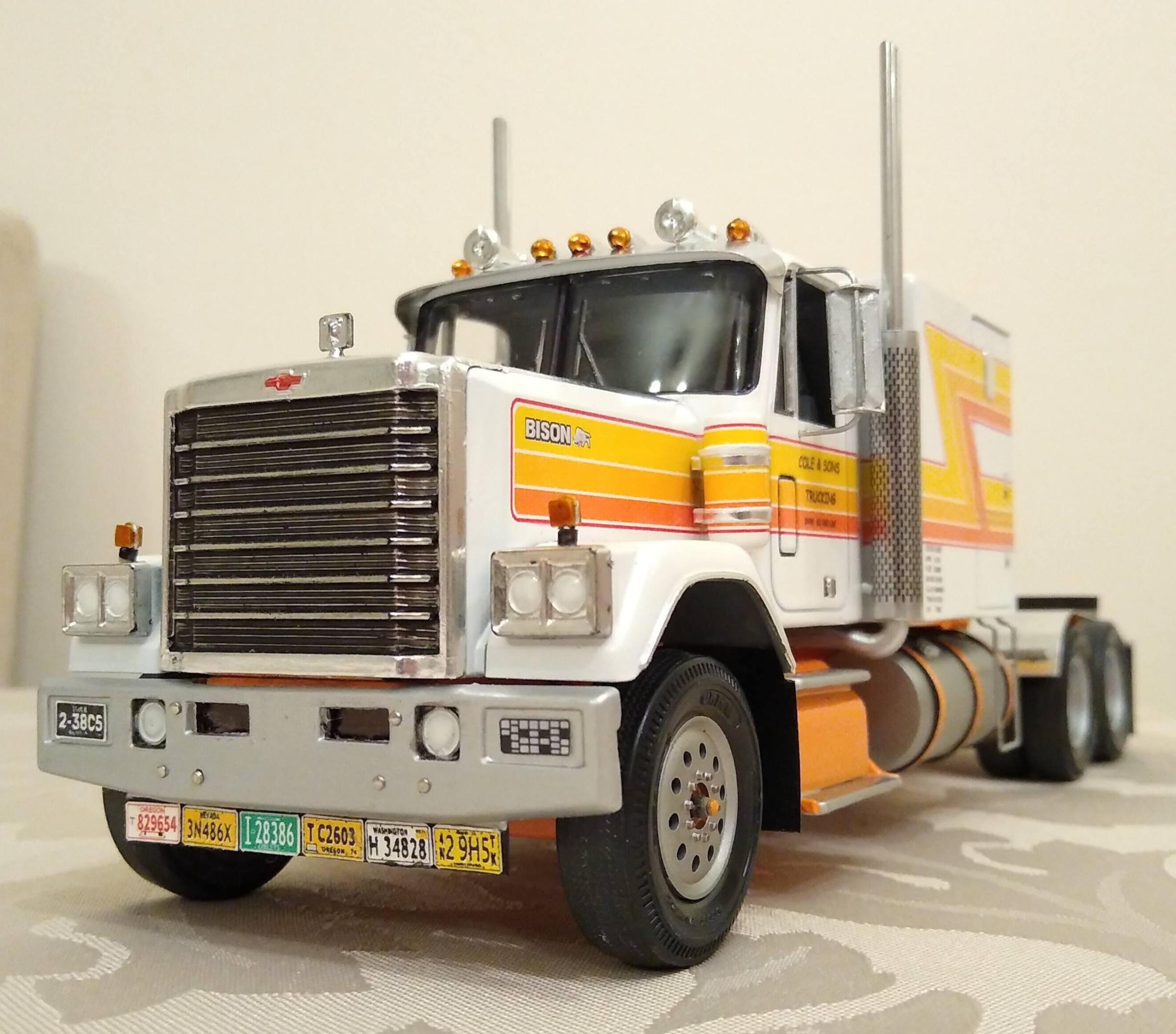

Finally finished my second of the two Bisons. The other was the daycab that donated its sleeper to this one. As usual, lots of scratch building involved in making the basic 1/32 Snap Tite kit look presentable but then stretched the chassis, added scratchbuilt fuel tanks, air tanks, half fenders, visor, stacks, pogo stick, sleeper steps, sliding fifth wheel, marker lights on the fenders, drew a stripe package on Paint®. I'm happy with it, considering it was a sad, grotty little build I bought off eBay for a few quid. I've saved it from the bin. I could scream at the stripes across the back wall of the sleeper. I carried the side stripes on too far across the rear wall so that I ended up with a slight misalignment. I did one side and left it to dry so that I could turn it over to do the other side, so too late by the time I'd realised. In future, I'd trim the side so that it just wrapped around the corner, then any misalignment wouldn't have the chance to build up across the back. We live and learn.

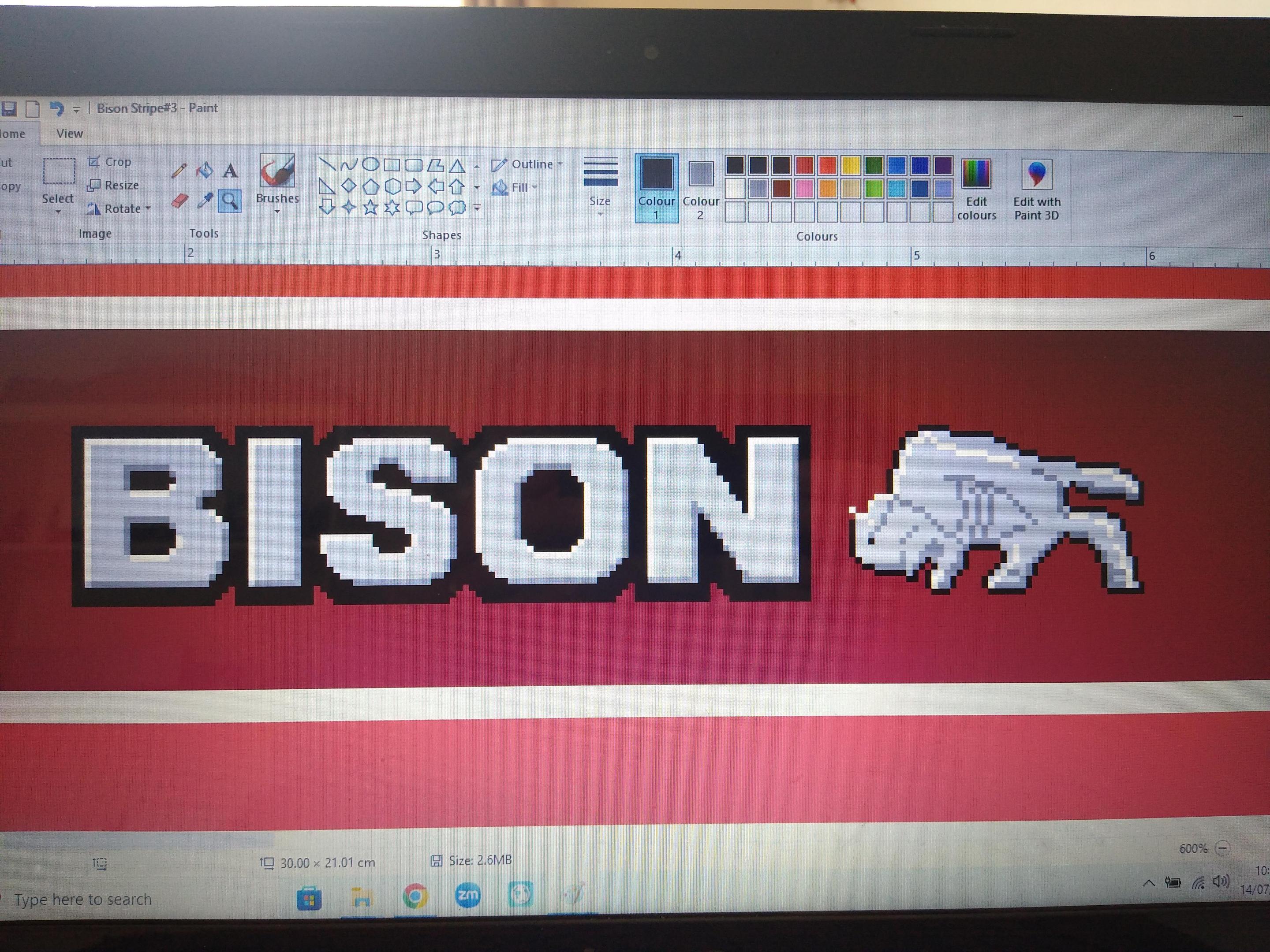

On the final stretch with this I think. Decals I printed went on so smoothly I couldn't believe it, the struggles I have had with my own decals sets. I think the clear I use to seal them makes a difference. I used Humbrol Acrylic Varnish this time, no bleed through, sat down nicely etc... Just need to trim around some features once they're fully set. Very happy with the BISON script and the little critter I drew freehand next to it. My old art teacher told us to draw what the eye sees, not what you know is there. -
