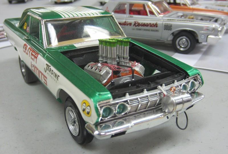

The headlights were relatively were relatively easy to make. This idea of mine was featured as a tip in Scale Modeler magazine a few years ago. You'll need a few matching headlamp lenses and some aluminum tubing. I used KD 9/32 x .014". A mini tubing cutter is also needed as it makes the "lip" that acts as the trim ring and also holds the lens in place. In the second pic you can see the trim ring. This is caused by the tubing cutter. You won't get an even result if you roll the tube with a hobby knife. Drill out the existing "bug eye" headlamp to a size that will accommodate the assy. that you just made and glue in place. I would spend some extra time and fabricate a foiled bucket to fit behind the lens to make the lamp more reflective.

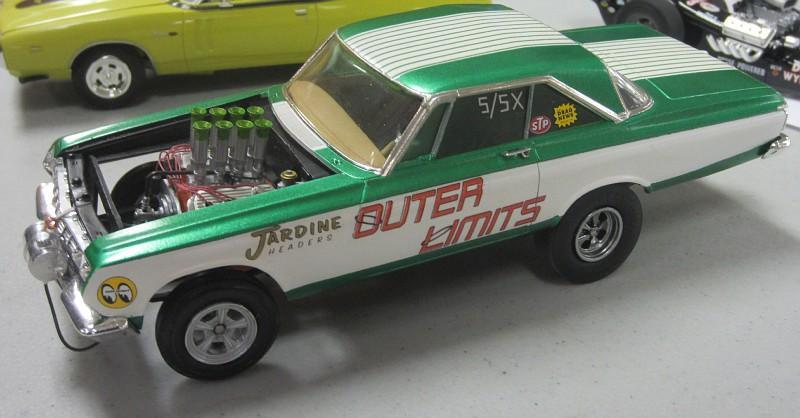

Two more of the "Outer Limits". There is an actual "Outer Limits" a.w.b. car. I believe that is in CA.

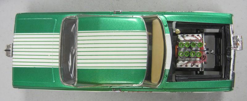

The Hemi is ready: The Hemi is ready! Wiring 2 distributors in the correct firing order is an exercise in patience! Headers are from Johan Sox & Martin kit. Sprayed with Alclad ll.
Another (better) pic of the distributor drive: I tried to make engine mounts from aluminum box tubing but they would not cooperate so I went with the motor plate.

My post for today. The angled dual distributor drive was relatively easy. I used a "t" section of sprue and whittled it in to shape, painted it aluminum, and topped it off with pre-wired distributor caps.

Valley cover is made from Evergreen sheet and painted aluminum. Easy, but will it be seen with the intake on? Who cares, it looks cool now.
