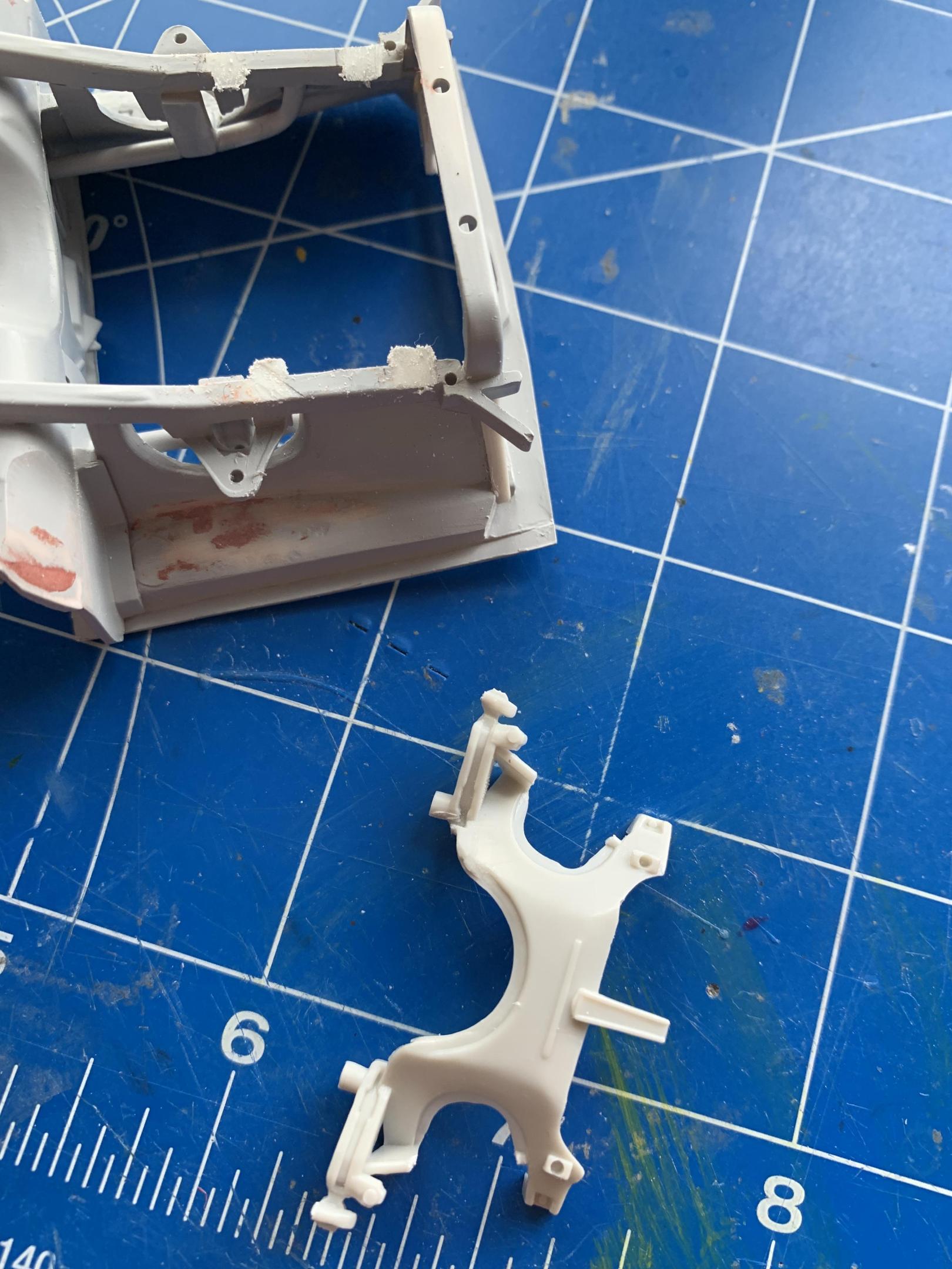

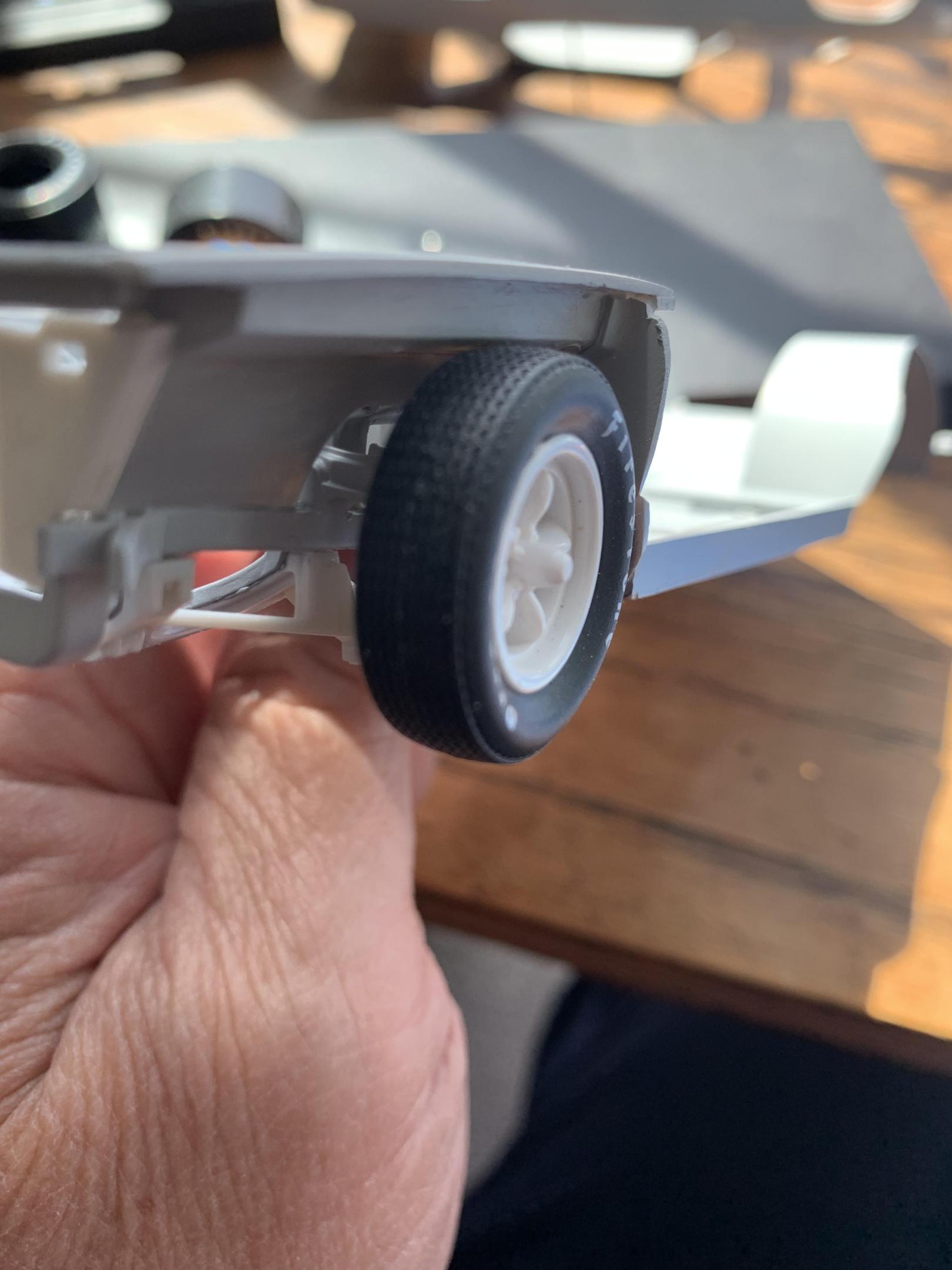

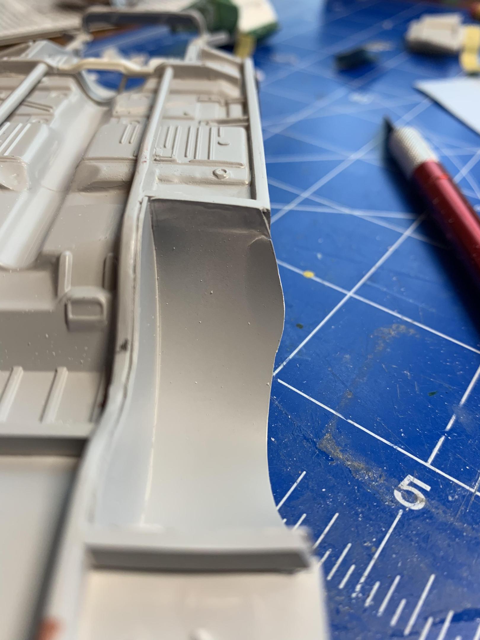

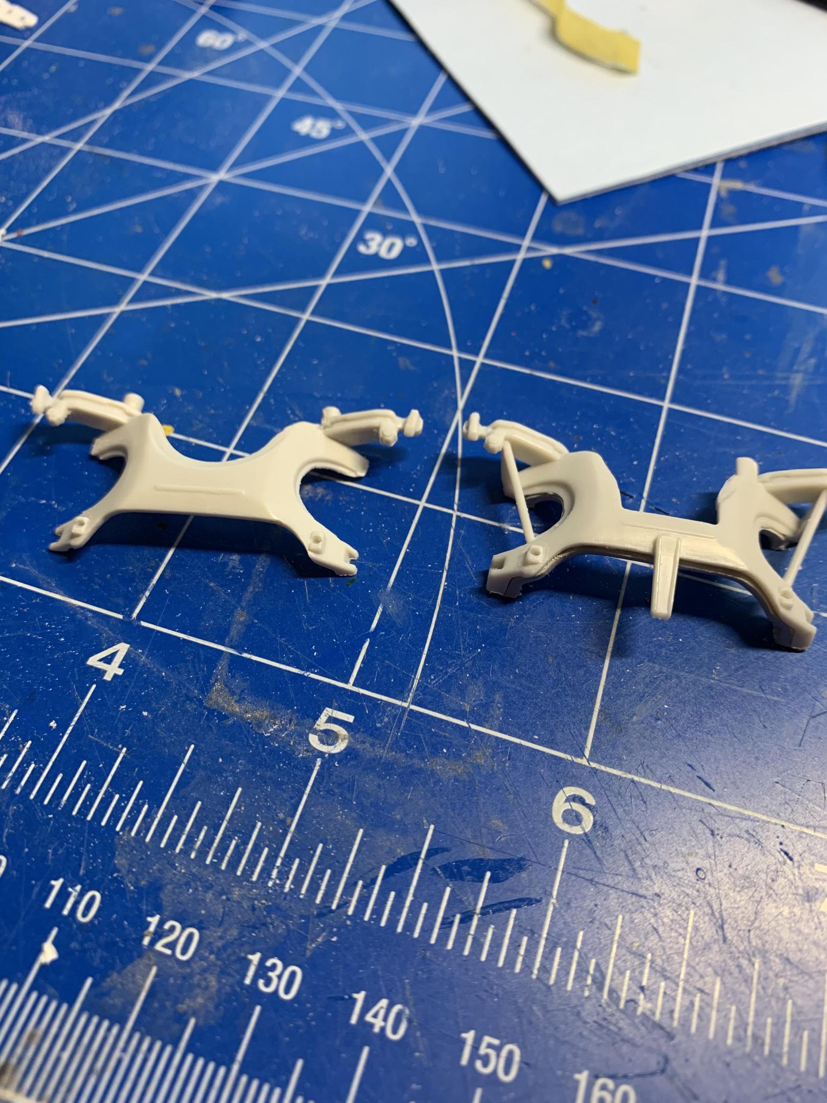

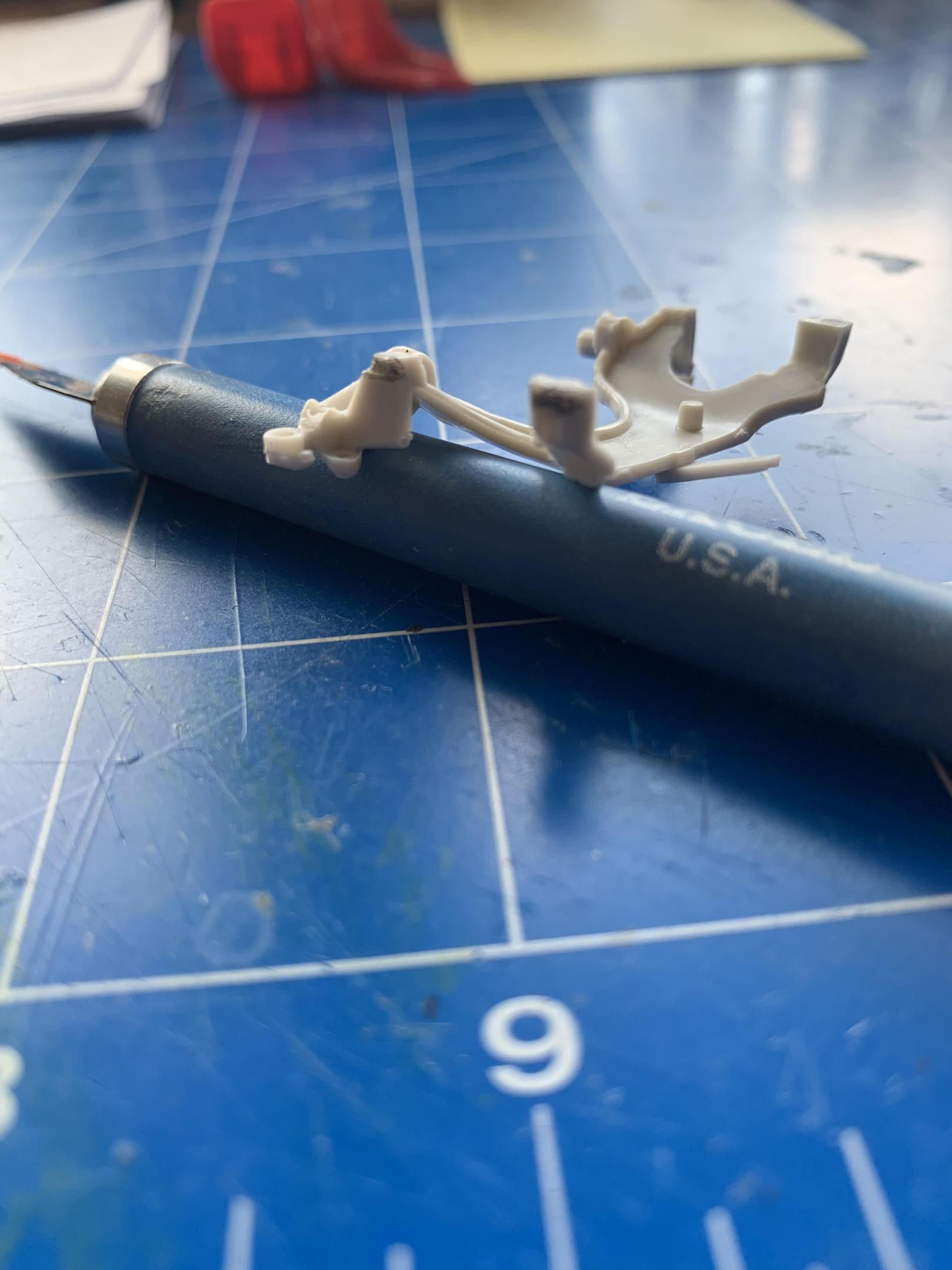

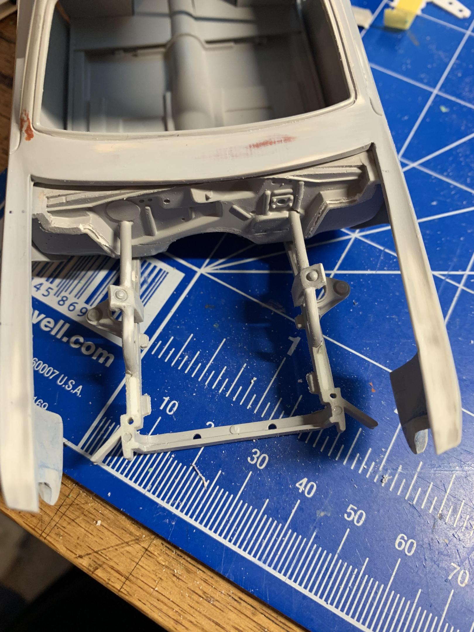

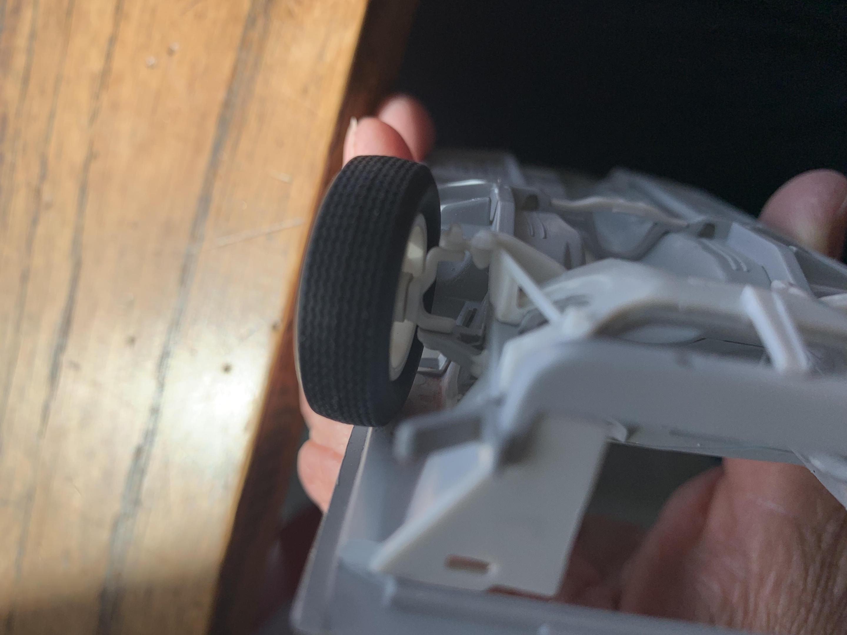

Where do I start? To get the front end low enough the K member sits on the ground and the front tires hit the fender aprons. So the spindles need to be raised, the K member needs to be trimmed to fit closer to the frame rails, and the aprons need to be replaced, so I disassembled most of the work I’ve already done. I trimmed the aprons off and re-sanded the attachment points. I grabbed another K member from my parts kit and trimmed the mounting points to raise closer up. The kits design has the K member doubled up so it’s rather thick, I’m only using the lower K member now. The space between control arms is now too narrow and I’ll probably have to scratch build the spindles. I’m a little concerned about the radiator support being to low now, but I will have to test fit everything to see where it’s at. During all the test fits I have now tore the rear wheel tub. I seriously think Einstein’s theory of relativity was easier than re-engineering this kit.

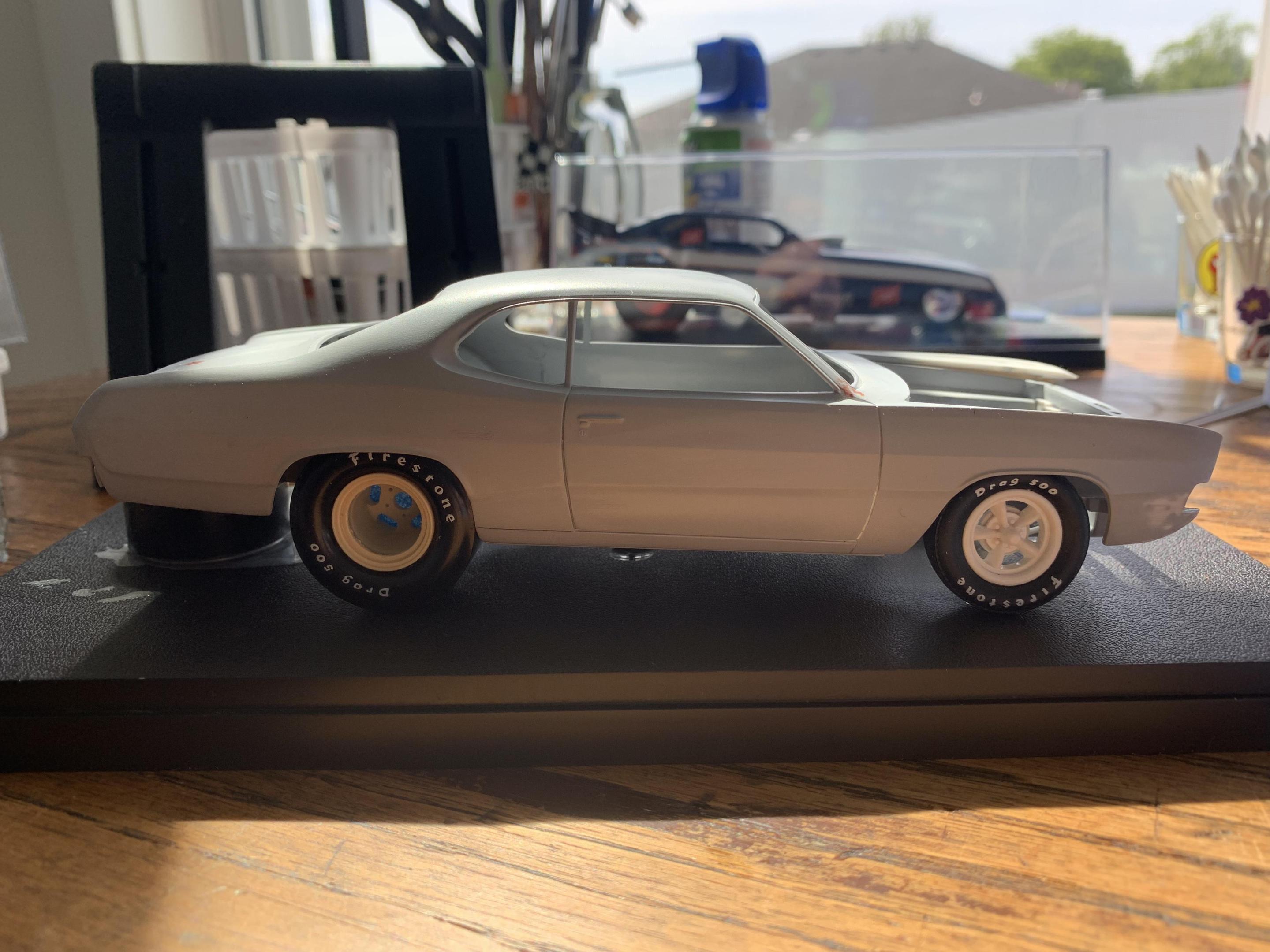

Life can get real interesting at times, it’s been over a month since I’ve had a chance to work on my BTK Demon. My mother in law has been Very sick for some time, and she passed away on my birthday March 22. Needless to say, my wife and I have been preoccupied with life and all that goes with it. I was finally able to get a little bench time in this weekend, and I’m surely having to reacquaint myself with the build. I felt like I needed to establish the wheelbase starting at the front suspension. I had reversed the kits spindles and though it lowered the front it’s not enough to achieve the ride height I’m looking for. So I’m having to rethink things. The tires are almost touching the fender aprons, so however I lower, or raise the front suspension I will need to address the aprons. Any thoughts would be appreciated.

I installed the lower K-member and reversed the front spindles to lower the ride height. A body Mopar’s were rear steer, but most racers converted them to front rack and pinion steering for engine and header room. I’m also collecting the rear suspension pieces.
