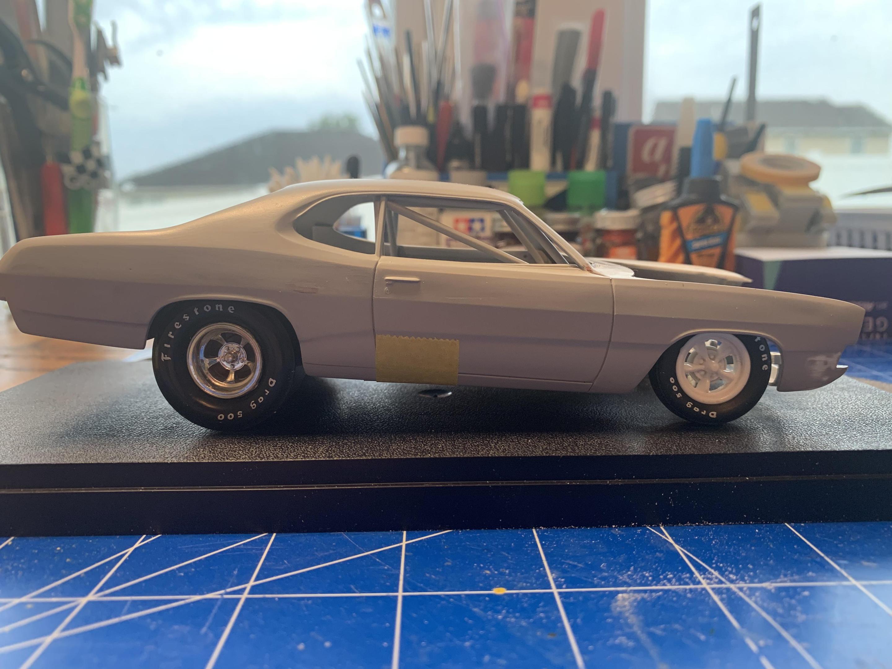

  16. Thanks Terry, I still undecided on the chassis, but I’ve got some Classic White, Model Master I’ll use on the body.
  17. Looks great Scott!
  18. Man Scott, I didn’t even think about solder…… Your DOL Plymouth is beautiful! I don’t have a dehydrator what does that calculate into real time?
  19. I’m really not impressed with the Tamiya spray paints. I originally tried their TS 26, Pure white on my Drag on Lady Hornet build, I had trouble and ended up stripping the paint and redoing it. I don’t know why but I thought I would try the Tamiya paint again as it’s much easier than air brushing my tried and true Testors. I shook that can of paint for a half hour, the temp and humidity were good last night, so I shot one light coat, let it flash off and then a heavier coat, the color insisted on pulling away from the edges. I waited an hour and applied the last coat, it’s kinda covered, appears way too thin. The gray primer shows through and the fuel tank was not primered still appears yellowed plastic. I have bubbles on the cowl, this is usually a sigh of too heavy paint application. I’m on the fence with where to go on this, leave it and work with it, sand it and try another coat, or “purple pond “

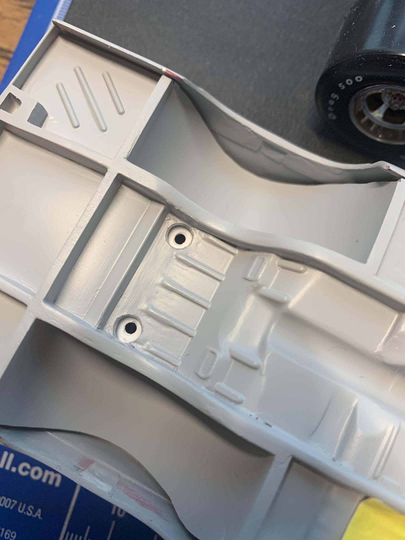

  20. LOL….That looked easier than it was. I have a lot of scrap plastic left over from many failed attempts, I tried left over exhaust pipes, tried heating and bending.080 evergreen rod numerous times, I finally gave up and got one close and pieced it together and puttied the seams. Now I just hope it’s in the right place. ??
  21. Thanks Bob, gonna try and get paint on the chassis today.

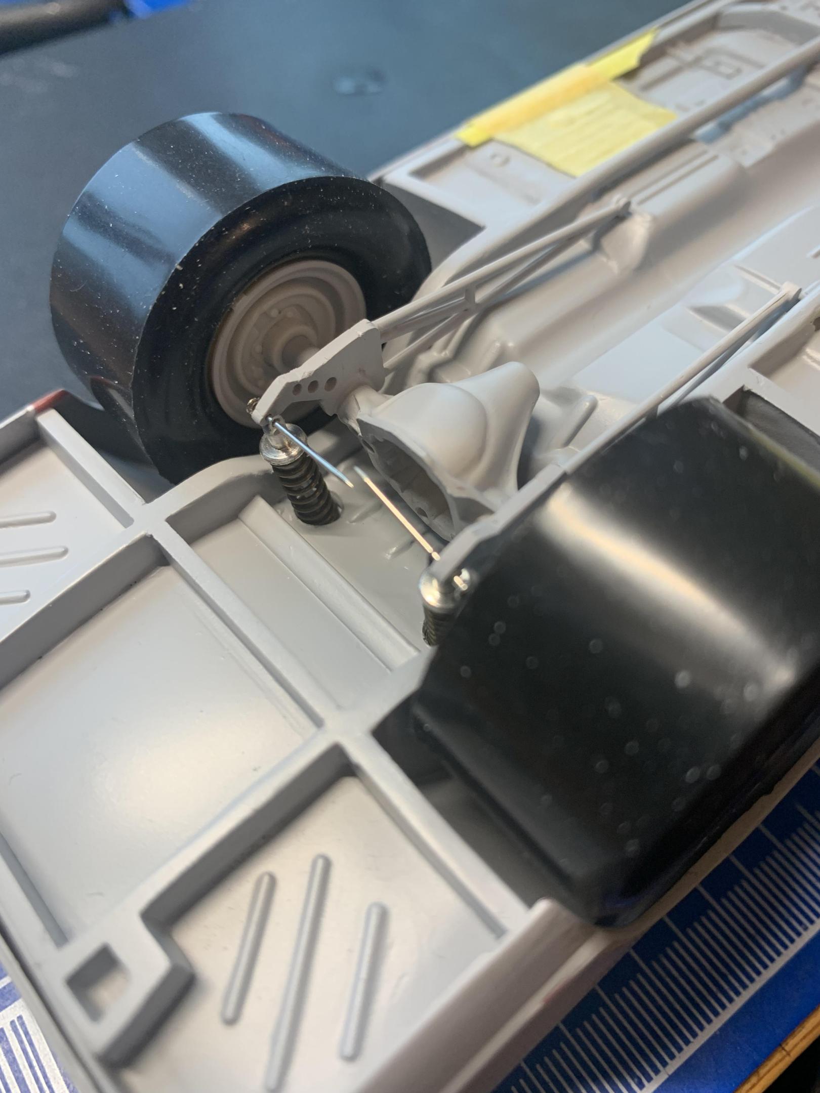

  22. I finally got some bench time. After several tries I finally have the traction bar mount made, I sectioned the fuel tank from the Johan Maverick.
