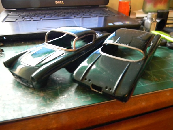

  3. Here is the prototype next to a casting finished......the rest of the kit is going to the caster this week so it will be done soon......very little work other than clean up from casting was needed,,,,,,a coat of primer and colour and clear coat and the body was done.

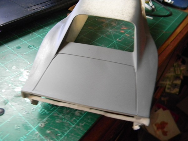

  4. getting close................fender wells inside from 58 chevy,,,firewall from 57 corvette hood is scratch built,,chassis(not shown yet) is 2 57 corvettes modified and front suspension is from 69 chevelle, seats from 57 corvettes modified.

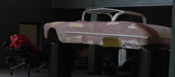

  12. Finally got some time and inspiration to get back to the Bently and get some colour on it......still have a long ways to go but getting there,,,,,,,,,,,The body, hood, and fenders are final colour,,,,still have the doors to sand and recoat,,,and the chassis,..more coming.

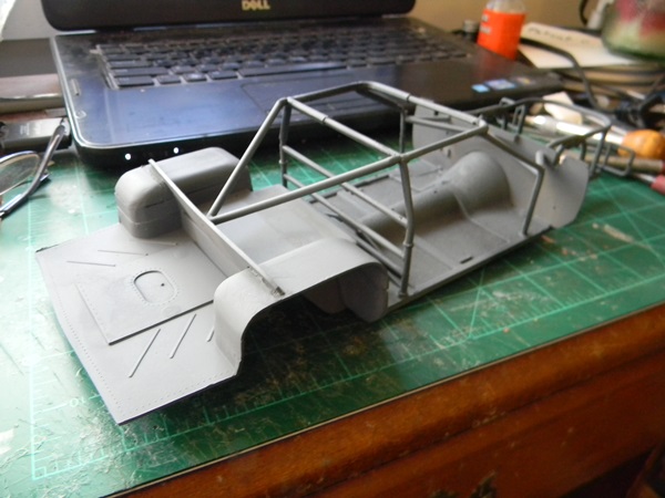

  13. more of the chassis done and the roll cage in,,,,,,,,a different wheel choice too
  14. very nice build,,,,great graphics
  15. body work on the rear quarters is done for now,,,,needs to have final sanding and blocking yet.............

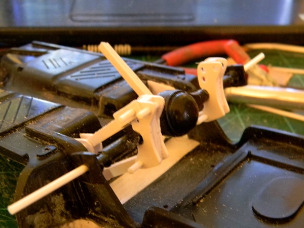

  17. test assembly of the rear traction rod.................. maybe they will work and maybe not..
  18. the frame work has been done on the back to get the rear suspension to be built,,,,I have included a photo from another build of what I am going to work off,

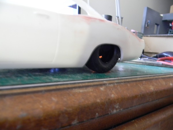

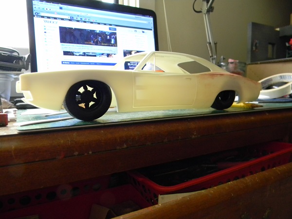

  19. Went to Hobby Lobby today and picked up a 1/16 scale Dukes Charger to put together before the end of the year,,,,,,of course I will be tricking it out,,,,,,,I need some nice heavy slicks for it tho...I will be dropping it into the weeds and beefing up the engine The biggest problem is the car is too narrow,,,,I have to widen the rear and front fenders out for a total of 1/2" I sliced this pristine body on top of the fenders and inserted a sliver of .40 styrene. That in turn raised the backlight and trunk some,,,I will use some filler to adjust the outside of the fender to level it out. This will permit me to use wide slicks and reduce the frame mods, and it looks tuffer this way
