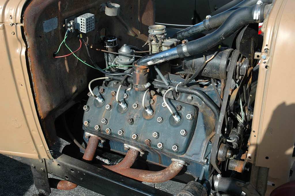

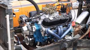

Antique Ford engine green
Ace-Garageguy replied to landman's topic in Model Building Questions and Answers
Looking through some web shots, these two look closest to what I've seen on "original" engines. The green is Model A, B ('32 & '33-4 with 4-cylinder engines), early flathead V8 through '41/'42. The blue is flathead V8 '41-'48 -
T engines were usually just black, and sometimes not painted at all, or had such a small amount of paint, they rusted pretty quickly. Early flathead V8 engines are a medium green, sometimes with a little bluish tinge. Some of the "correct" restoration colors you buy from different manufacturers don't match each other, so in the ballpark is pretty much good enough. And who really knows what color they were when they left the factory? There's no question the color would change after a few heating and cooling cycles. I've seen original engines that were different colors in different places, apparently caused by differences in the local highest temperature a particular area experienced. This is a Rustoleum forest green that I used for an early Olds...for which it's really a little too light, but it's pretty OK for an early Ford flathead V8.
