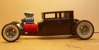

I'm not getting your point. The fab work looks good, and the frame appears to be relatively intelligently designed. Unlike a rat, there's no inherent reason this thing can't go as fast as its engine will push it. On the other hand, if it's not ever going to go faster than 25MPH, why bother with all the additional engineering complication of IRS, a custom-length torque-tube and shaft, and shift linkage to the rear? A no-go showboat doesn't need to handle well, so the Corvette IRS would be complete overkill...like the three blowers on the monstrosity shown elsewhere. Ah well. Never mind.
