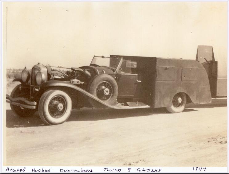

Hot Rod Duesenberg
Ace-Garageguy replied to Richard Bartrop's topic in General Automotive Talk (Trucks and Cars)
Nice project. Love those deck details. Just to clarify...the Flamethrower unit was a dual-point distributor, requiring two external coils, not a magneto.
