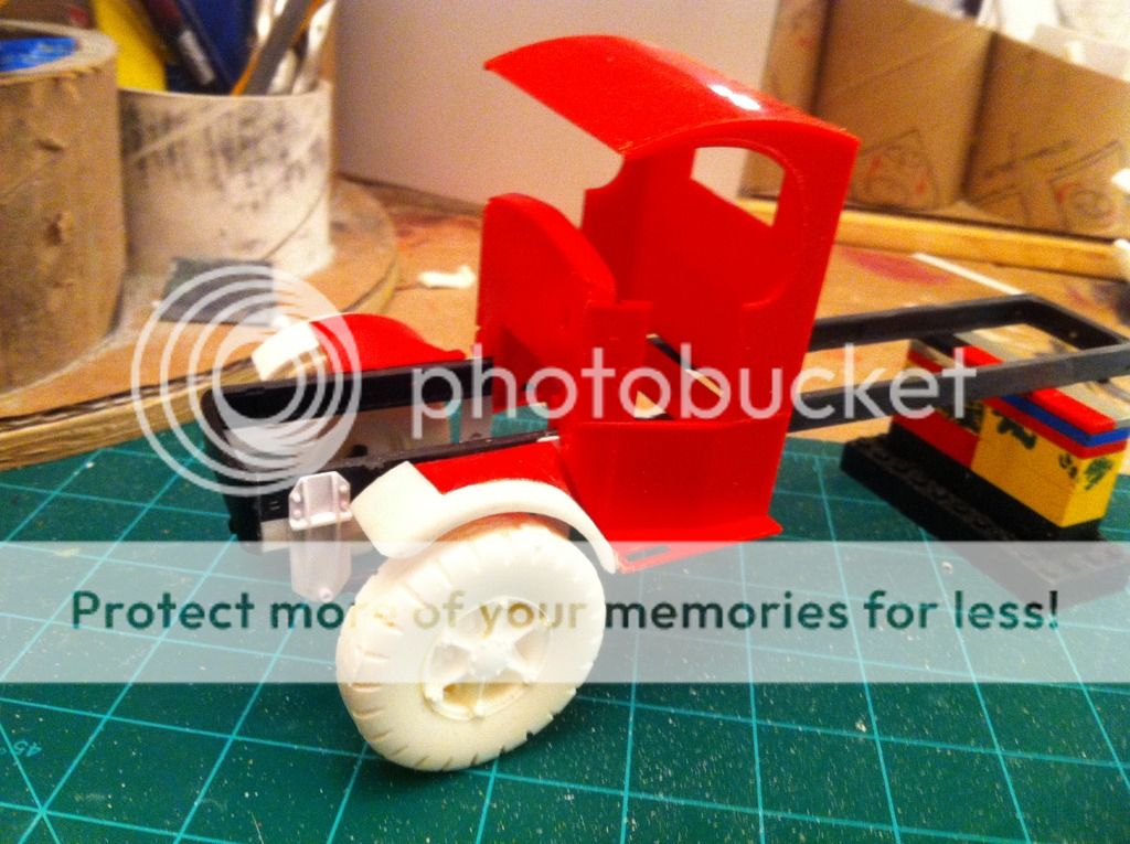

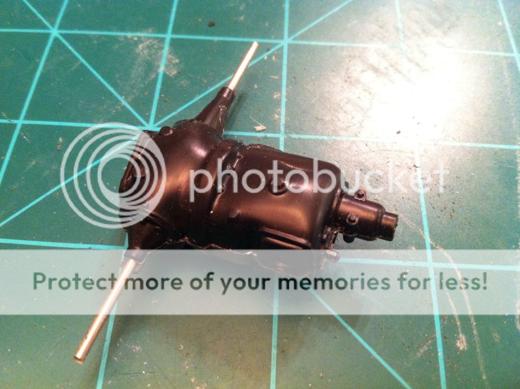

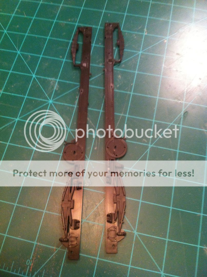

Superpeterbilt Posted April 2, 2015 Posted April 2, 2015 (edited) Heres the start of my Mack build. Im using the monogram 26 AC Mack kit with some resin wheels from AITM. For starters I removed the leaf springs from the frame because the front will be lifted and the rear will be much heavier. Using a triangle file, I cut slots to put a metal rod through the chain drive. I also started putting the cab together Edited June 17, 2015 by Superpeterbilt

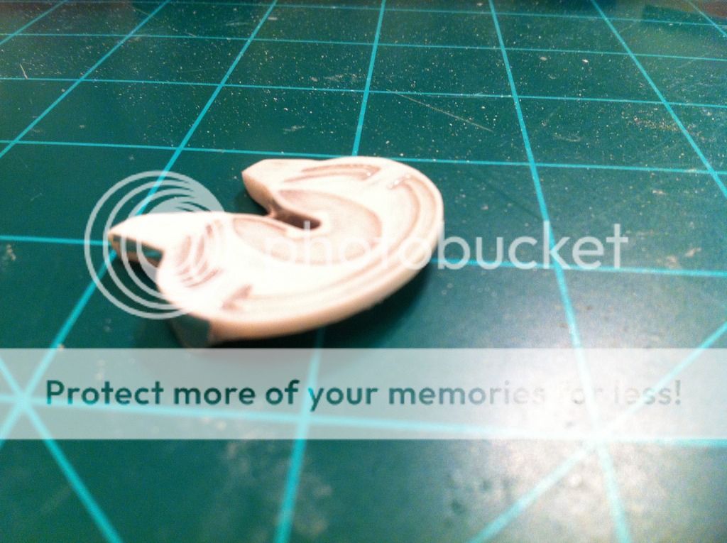

Superpeterbilt Posted April 2, 2015 Author Posted April 2, 2015 Thanks guys. I started modifying an AMT 5th wheel wheel. I wrapped the front with .010 x .125 styrene and puttied the recessed areas. Before After

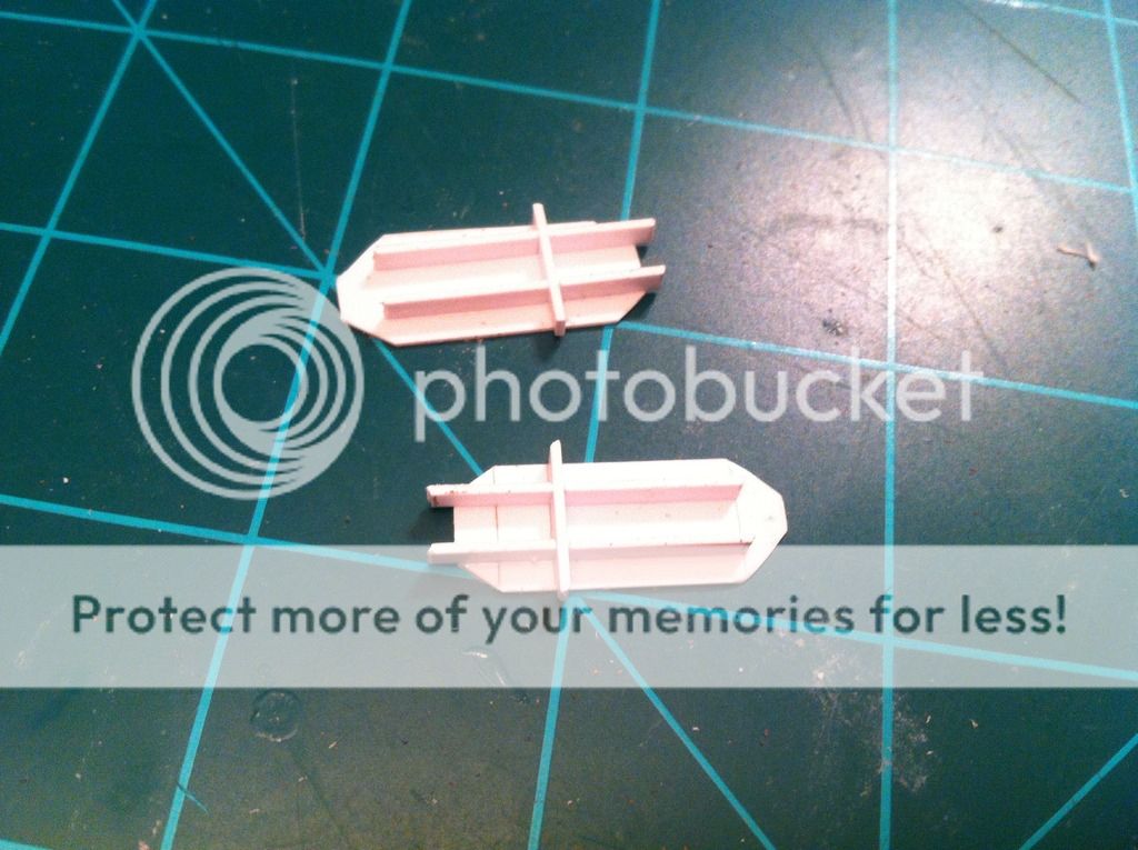

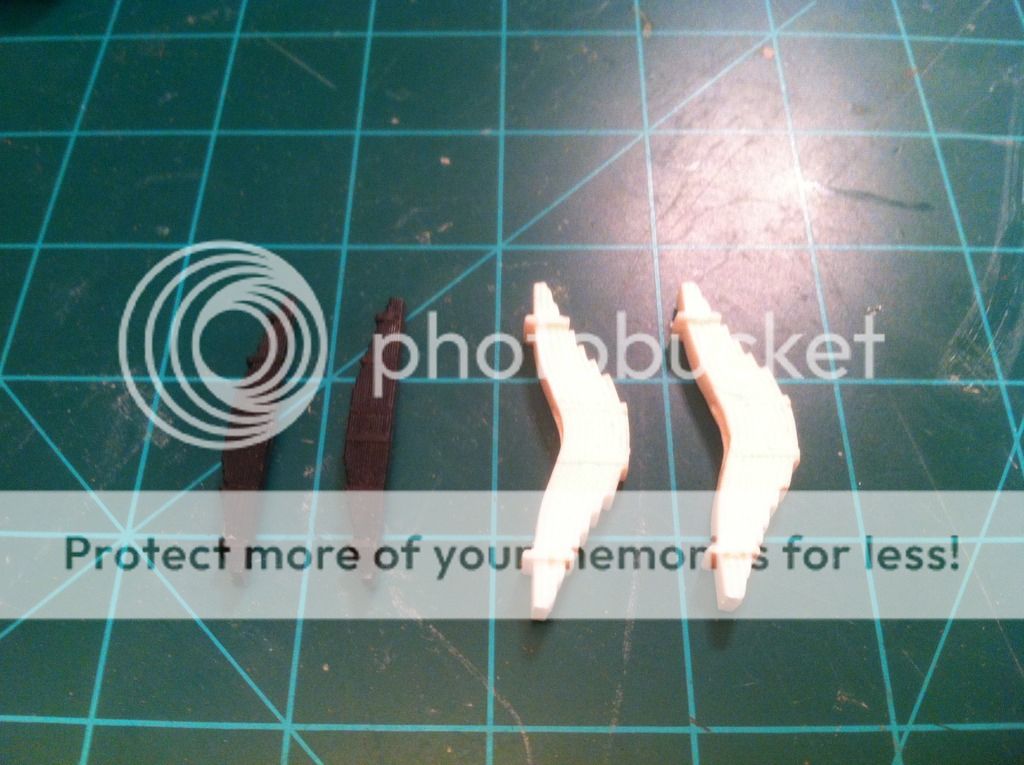

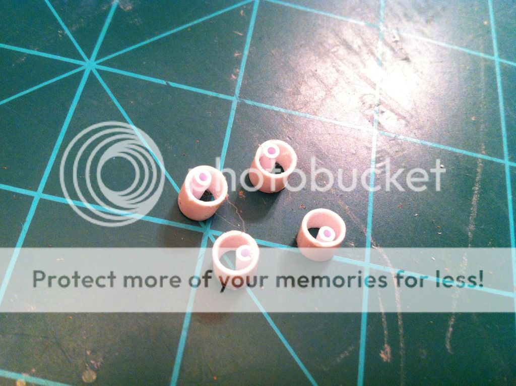

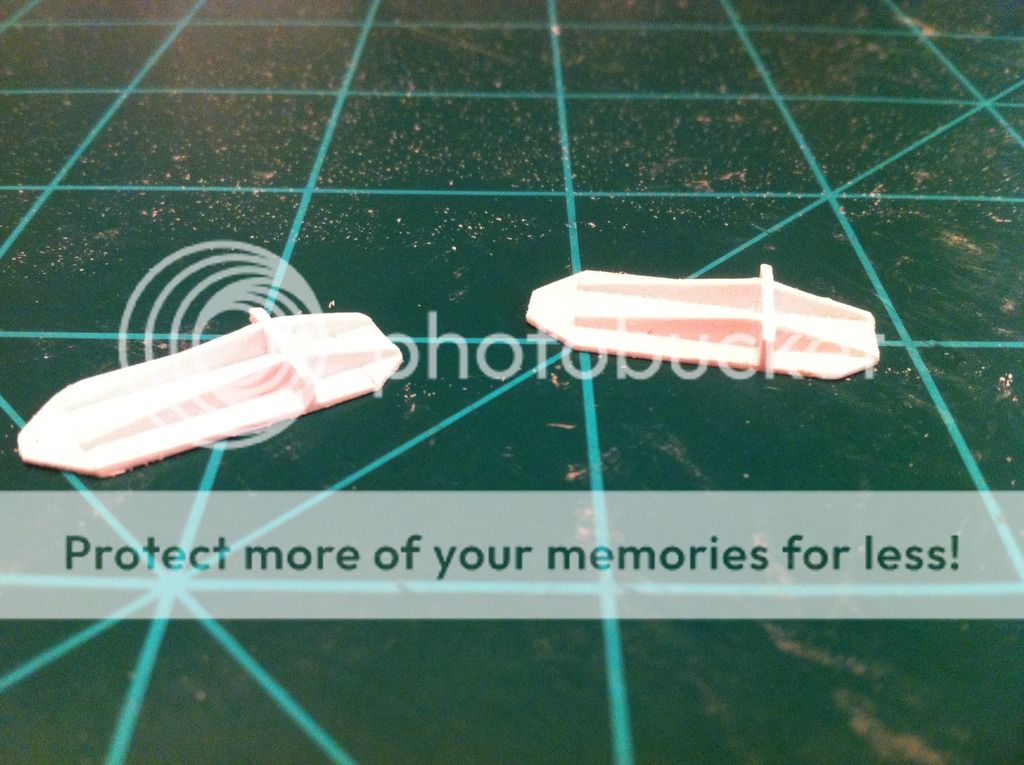

Superpeterbilt Posted April 3, 2015 Author Posted April 3, 2015 Here's some of the suspension work. I'm using the kit springs for the upper and the spring pack from the DM600 kit for the lower springs. They are not exactly the same shape, but it'll work. Here's the start of the end loops The small tube was glued inside the large tube. The large tube was then cut and coiled around the small tube. Then I filed a spot in the leaf springs and glued them on. I also made the radiator larger for the bigger engine. The hood will also be lengthened.
Superpeterbilt Posted April 3, 2015 Author Posted April 3, 2015 Thanks Benny! Here are the scratch built front spring hangers Taking a cue from the Old Buckaroo, with my Legos

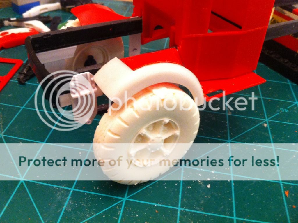

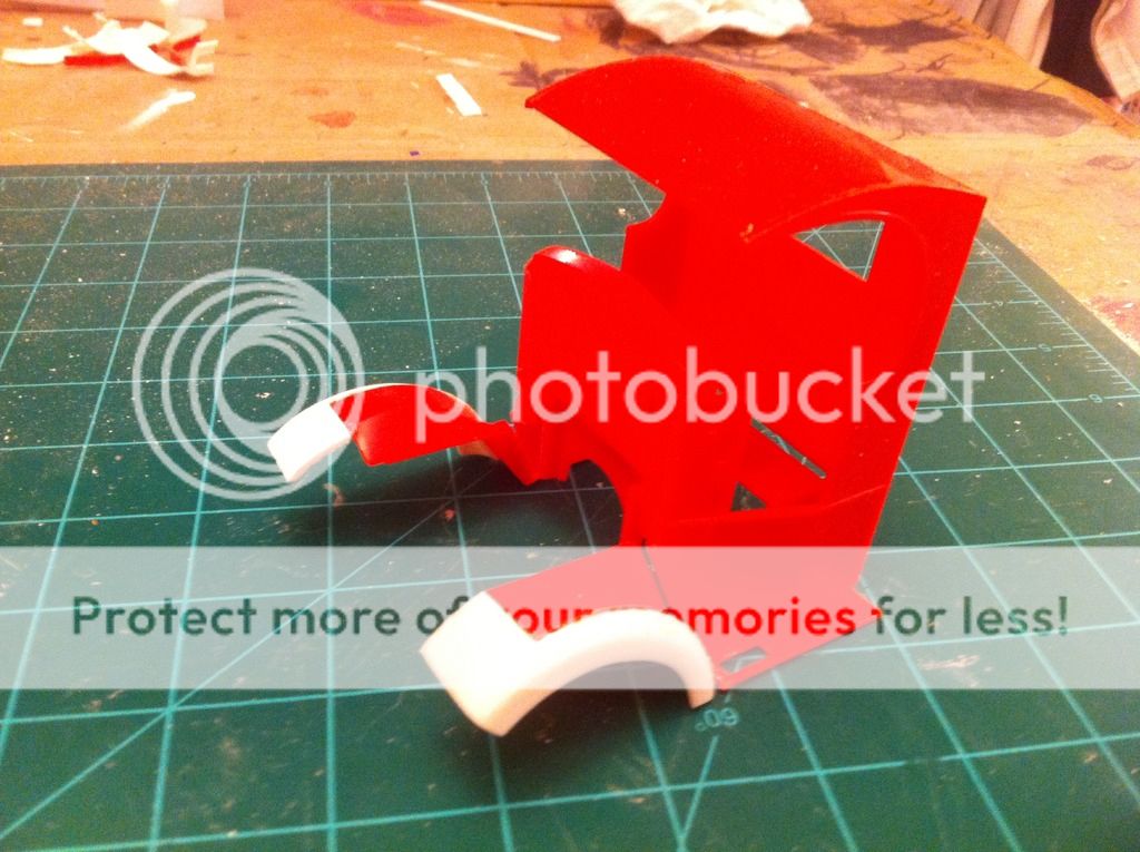

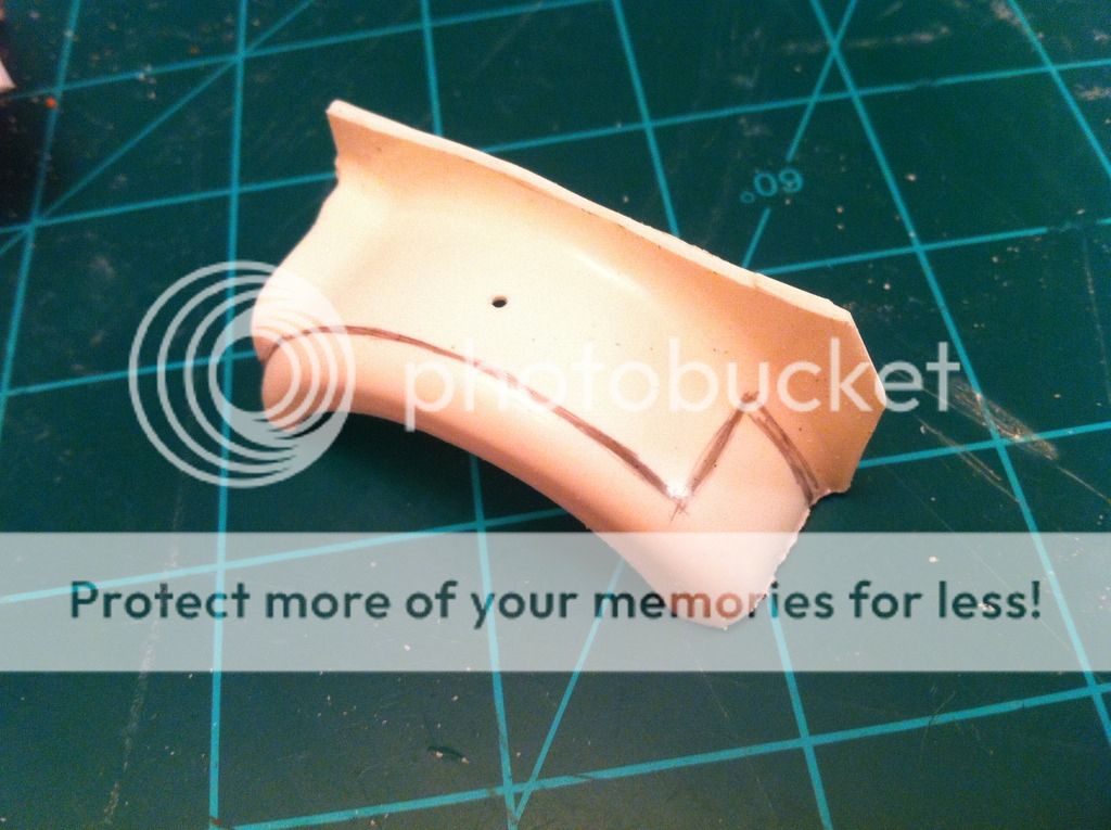

Superpeterbilt Posted April 4, 2015 Author Posted April 4, 2015 (edited) Thanks Gator, I'm glad you like it. I started working on the front fenders. I used some fenders from a chopped up KW hood to add a rolled edge to the existing fenders. I still need to do a little work on them, but I'm happy with the progress. Here are the KW fenders. I'm using the bottom side as the top. The pencil line is where I cut them. Before some enlarging of the wheel openings After some reshaping Edited April 4, 2015 by Superpeterbilt
