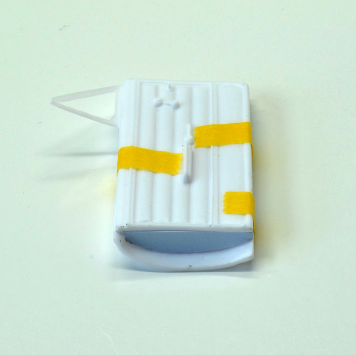

taaron76 Posted May 6, 2015 Author Posted May 6, 2015 Well, I wish hinging the doors was a lot easier than it looks. Cutting the door out was cake, just time consuming. Making the hinge the correct size so it didn't interfere with the rest of the interior and making sure door opened and was level, was another story. Practice makes perfect, hopefully! lol I ordered some hobby magnets to mount and conceal them in the doors and trunk to keep them closed. I'm using 18 gauge aluminum wire, which makes it strong enough to withhold normal opening and closing, but easy enough to bend and adjust, if needed. Tim Here is the passenger side door panels and doors carved out and hinged. Once everything dries good, I will make the door jambs. Just another shot to show a functioning, level door. There is piece of tape to keep the door closed. I'll crimp the tubing a little more to give it a little bit of friction and make it a little less easy to open. Typical hinges...
microwheel Posted May 7, 2015 Posted May 7, 2015 Great job on hinging the door Tim. Are ya planning to thin down the door and trunk edges a little so when opened, they look a little more like in scale natural body metal thickness? Mostly the outer and lower door edges that can be seen when they are opened. I usually do it. But I never did when I first started out. A guy I became really good friends with over the years taught me about it as my skills progressed. It's just a matter of filing or sanding them in a feather taper from the inside a little back from the edges out to the edges until you get the desired thiness you want on the edges. Not hard to do, but another one of those time consuming things lol. I used to open up alot of my models doors, but, as long as it takes me to build them, It was really slowing down the build times, as if they arent slow enough now lmao. But even if ya leave them as they are, it's still gonna be one cool build my friend.

taaron76 Posted May 7, 2015 Author Posted May 7, 2015 (edited) What I did was cut out some styrene and shaped it to the door and door panel. I glued and mounted the styrene to the door, that way I can paint the door jamb the same color as the body color and not have to worry about masking the door panels off. The door and door panel won't be glued together until final assembly. I will do the exact same thing for the door jamb on the quarter panel side of the car. Now that I've planned it out and tested my design, its a little easier than I anticipated. I still have to smooth out the styrene and put a dab of putty in there to cover the gap between the door and styrene itself, but I think primer might fill that void as well. I test fit the door back in and everything lines up and the door opens and closes with no issues. Tim Edited May 7, 2015 by taaron76
