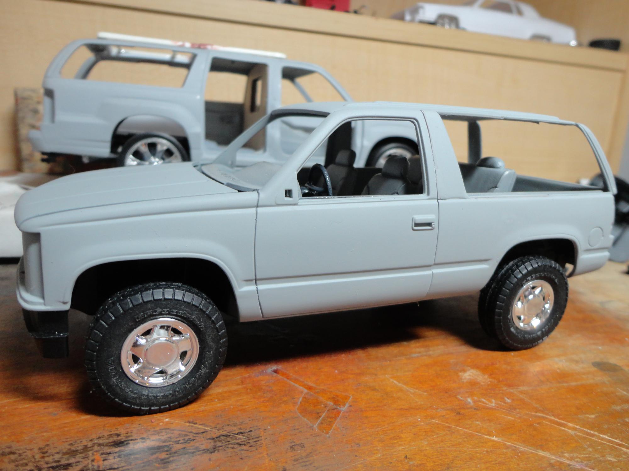

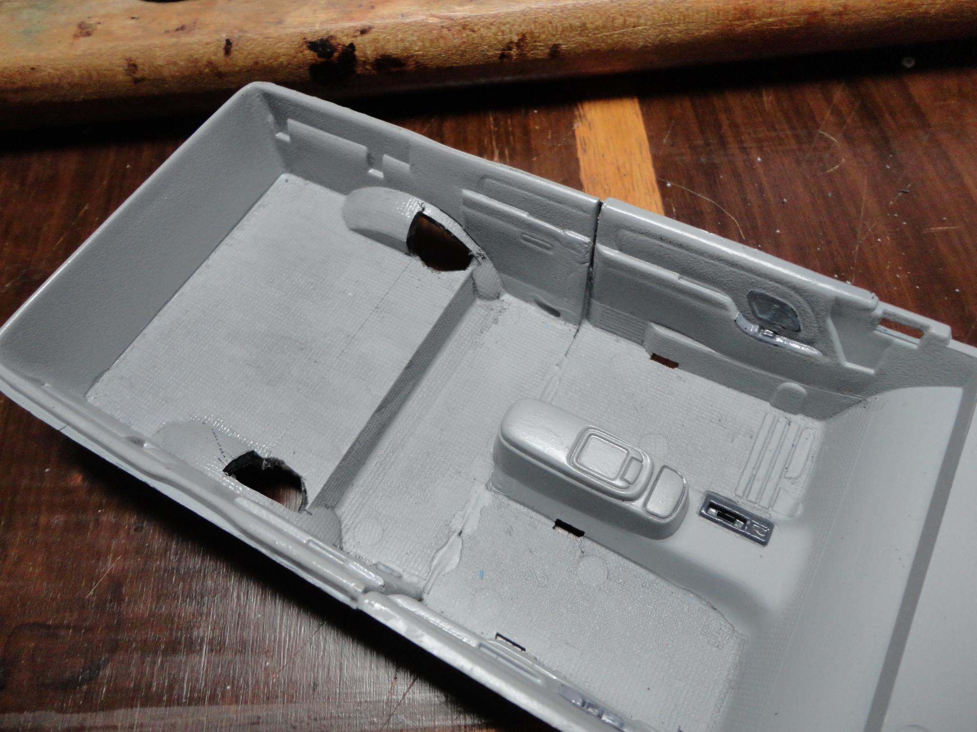

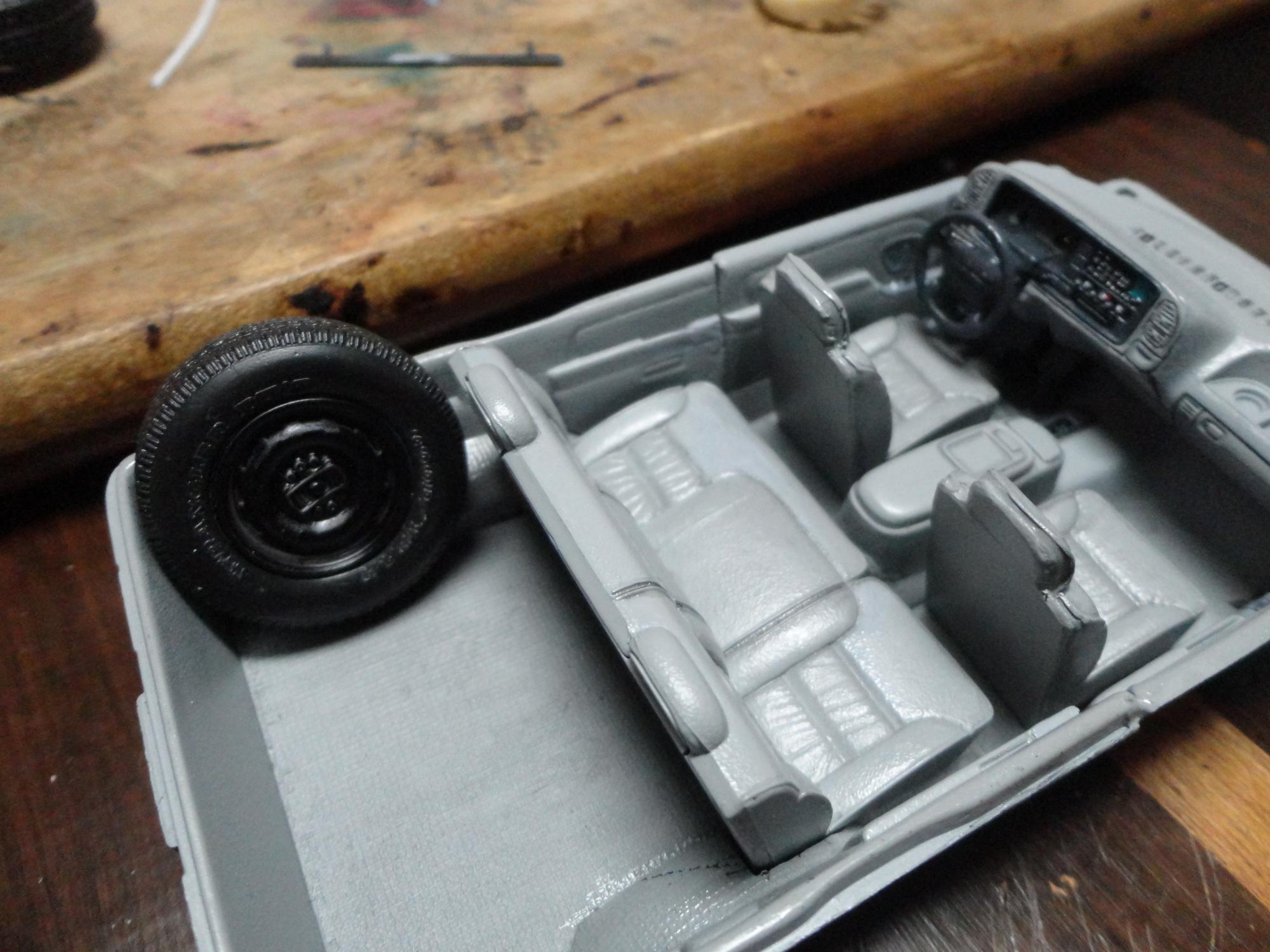

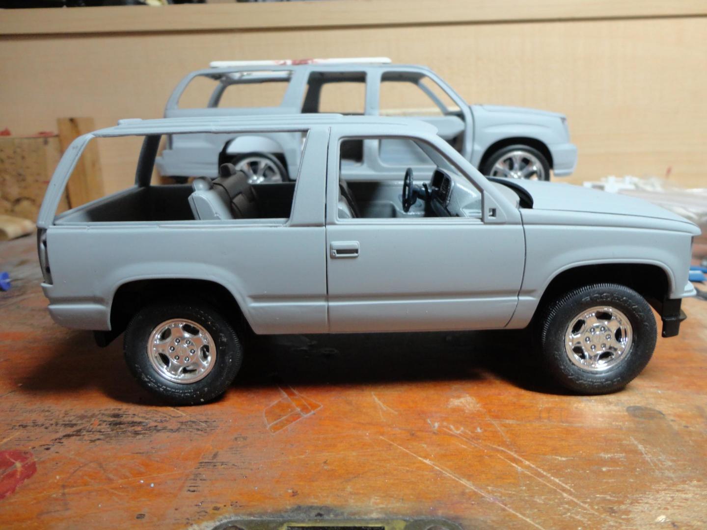

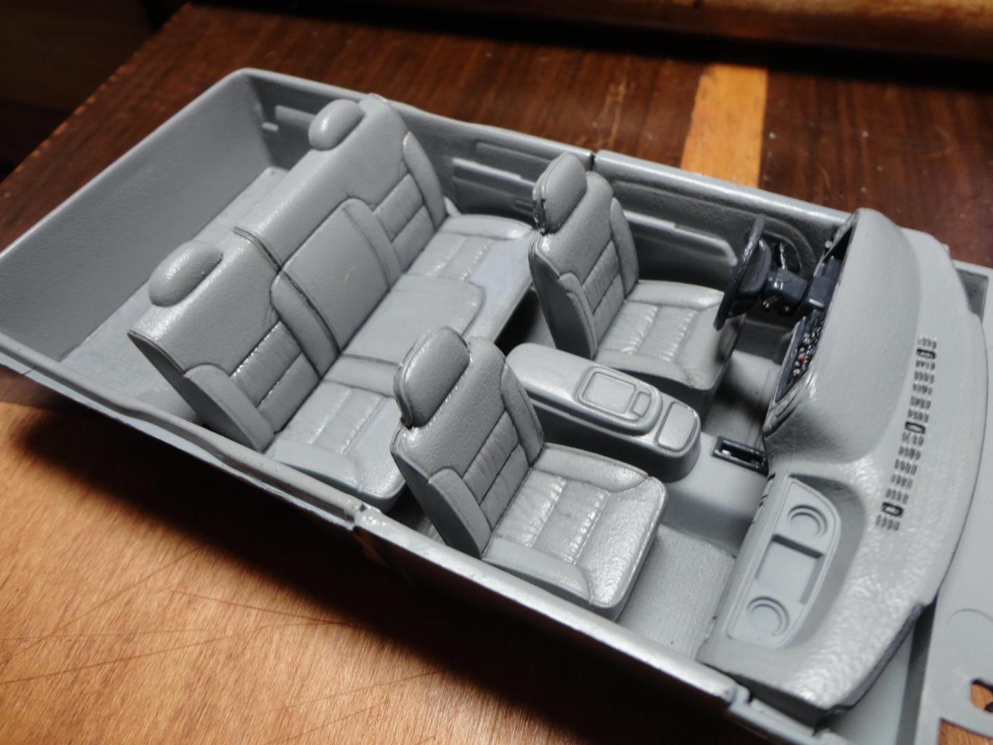

I'm calling the interior done. I'm sure it's not to spec but close enough. Had to notch the wheel humps a bit to get the rear seat to sit right. Also can't find the decal sheet so I'll be printing a copy of the instrument cluster.
Edited by Perspective Customs

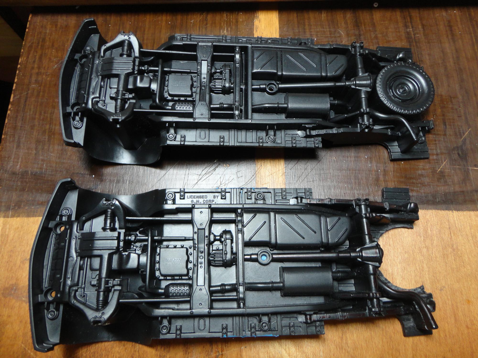

I cut the chassis down to size. Again, sure it's not exactly like the 1:1 but it works. I'm waiting for a couple of sets of wheels & tires I ordered from Scenes Unlimited before I touch the suspension. If they're to large for the stock set up I'll lift the suspension. Or I may just leave it stock and use the Silverado wheels & tires.

Thanks for the kind words guys,  I appreciate that. I prefer the 2 door over the 4 door Tahoe and even the Suburban.  It looks good stock, lifted and outfitted for emergencies.
I agree, the '99+ alloys look better than the stockers.  I think I'll de-chrome them, paint them silver and add some wash to them and see how that looks.
And since I have a spare chassis, I'll leave one at stock height and lift the suspension on the other.
Thanks again
