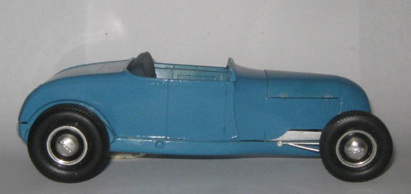

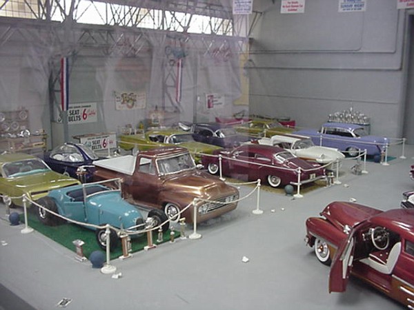

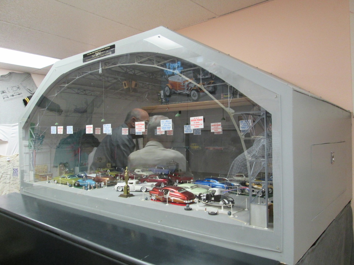

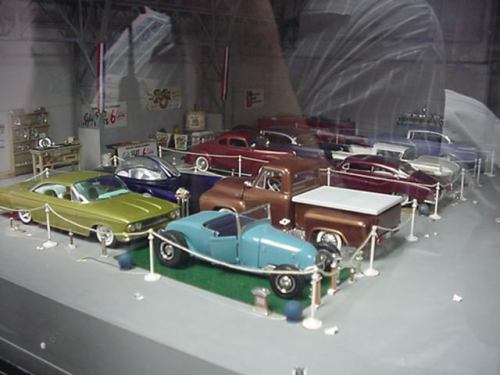

alan barton Posted September 21, 2015 Posted September 21, 2015 (edited) Hi guys,I have had plans on doing the Dick Flint roadster for years but I HAVE built not one but two versions of the Niekamp roadster.The first one I built has a windshield and lives permanently in the Oakland Roadster Show diorama in Salt Lake City. Some of you may have seen it before because it is in the front row of the display and often shows up in photos of the diorama.The second version is done sans windshield and with a tonneau cover as in the photo above. One twist - I put the steering wheel on the right as I do with most of my collection - it's an Aussie thing!I have my own vacforming machine and I carved wooden moulds for the nose, hood, bellypan floor and spring covers and then vacformed the parts with 1mm high impact styrene plastic. I used the photoetched grille that comes in Model Car Garage's Model T track nose part. This is a perfect size but has slightly squared off lower corners - at least they tend to be hidden behind the nerf bar. And yes, both my models are shortened 4mm to match the four inch shortening that Bill did to the real car. Remember, the real car had the left hand door welded shut so shortening it isn't that hard, especially if you hinge the shortened right hand door like I did.(By the way, I'm thinking that MCG's Model A track nose might be a good start on the Eddie Dye car.)I hand mixed the colour for my first version and airbrushed it but cheated on my second one using a Tamiya spay can but cant remember the name of the blue just now - maybe Leighton House blue? It was surprisingly close. I soldered up a half chassis from K&S brass and then slid it in to the front of the car - there is no point building a full frame as it is totally hidden by the bellypan. Instead, I inserted a length of aluminium tubing through the centre of the spring covers and then used the next size down tubing as a rear axle.The motor I used was the 49 merc flathead with 50 Ford chromed heads. There may be better stuff available now but I built both these in the early nineties so that's what I used. I made the unique taillights by doing some very careful cutting and filing on a set of 49 Merc taillights - you have to work with ridiculously small pieces of plastic here but they look convincing when done.Unfortunately I have been frustrated beyond belief trying to use Photobucket this year so I don't have photos to post - Tim, maybe you might have some somewhere that you could pop up here?CheersAlan Edited September 21, 2015 by alan barton Wrong name
alan barton Posted September 21, 2015 Posted September 21, 2015 Thanks Tom, that's my baby! Colour is a little deeper in the flesh. This version is based on Jim Jacob's restoration in the seventies.CheersAlan
Tom Geiger Posted September 21, 2015 Posted September 21, 2015 It's safe there Alan. And I visit it every two years just to be sure!
tim boyd Posted September 21, 2015 Posted September 21, 2015 More pix of Alan's Niekamp Roadster replica from my International Model Car Builder's Museum photo album..http://public.fotki.com/funman1712/model-car-events-co/international-model/ .. Alan's outstanding replica is the first one I know of....anyone else done one to date? TIM

Ace-Garageguy Posted September 21, 2015 Posted September 21, 2015 Richard, your work on the Niekamp car looks to have captured the particular curve of the nose and overall proportions very well. Alan, your version looks great too. I wish I'd known about this last time I was in Salt Lake City. Sure would have made time to see it.
alan barton Posted September 21, 2015 Posted September 21, 2015 Thank you Tom, Tim, and Bill,I started with the Revell track nose and massaged it quite a lot before casting a solid one out of Bondo to use as a plug for my vacforms. What I love about vacforming is that you end up with a rigid piece that is about .5mm thick and you can make as many copies as you like - I still have all the molds after 23 years and unlike RTV they don't deteriorate with age or use. I think I have sold 12- 20 sets of these parts over the years but have never seen another one built up.The new Revell kit would be nice for a Niekamp as I struggled to find suitable tyres, especially for my second, 1950, version and the separate molding on top of the cowl would be far more accurate for a lakes version. The front nerf was modified from an Edmunds Supermod kit and the rear is bent from a paperclip - a pig of a job as I remember!Richard, I used the Rod and Custom article in the seventies when Jim Jacobs found and started restoring the car and it included a reprint of the Hot Rod article. I was sure they said a four inch section and thinking about it as a hot rodder with a real '29 roadster, I can't imagine whay you would only shorten a car by 1 inch. I'm not saying that isnt what you read, it just seems such an awful amount of work for a teeny weenie change.
