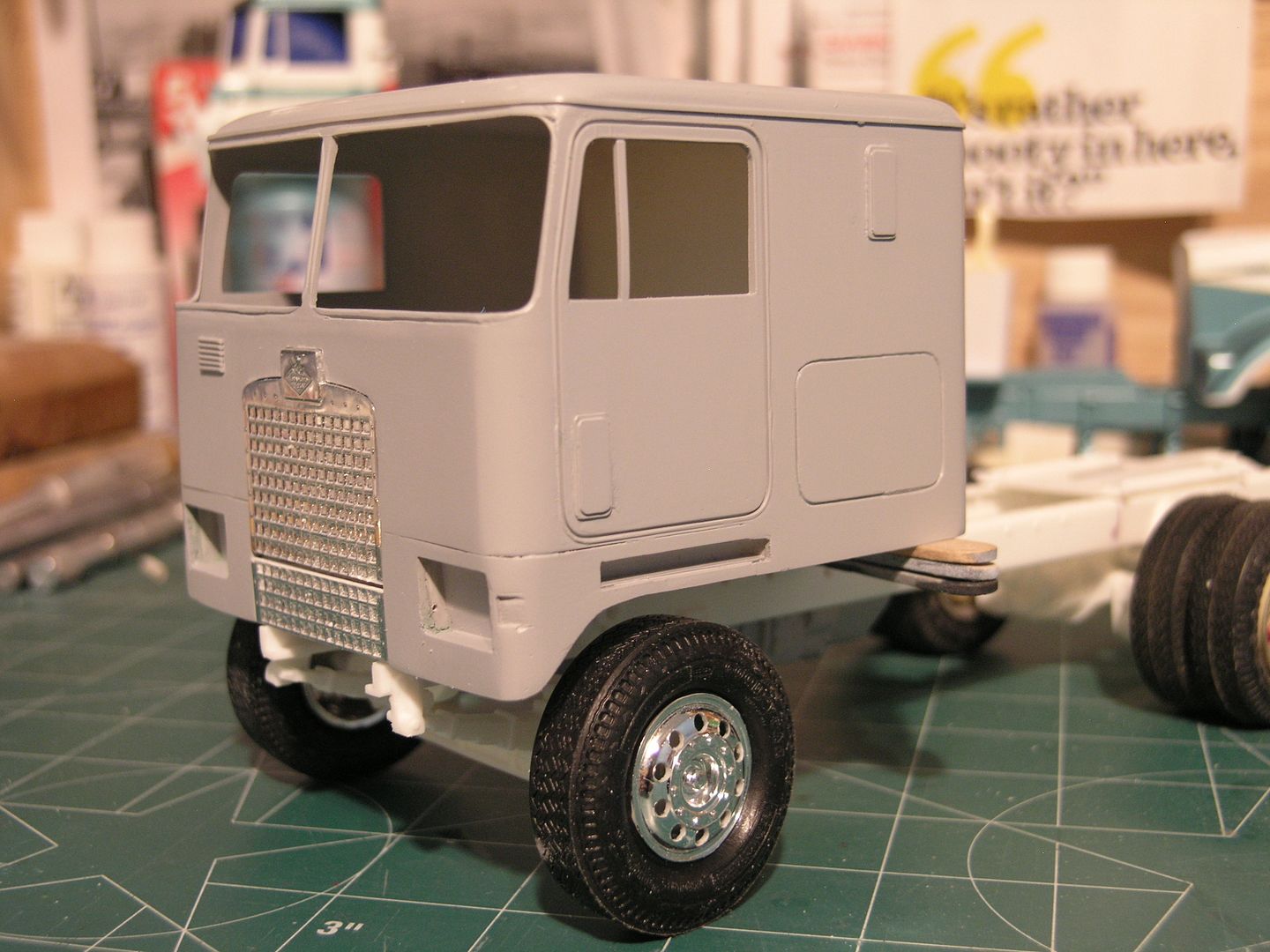

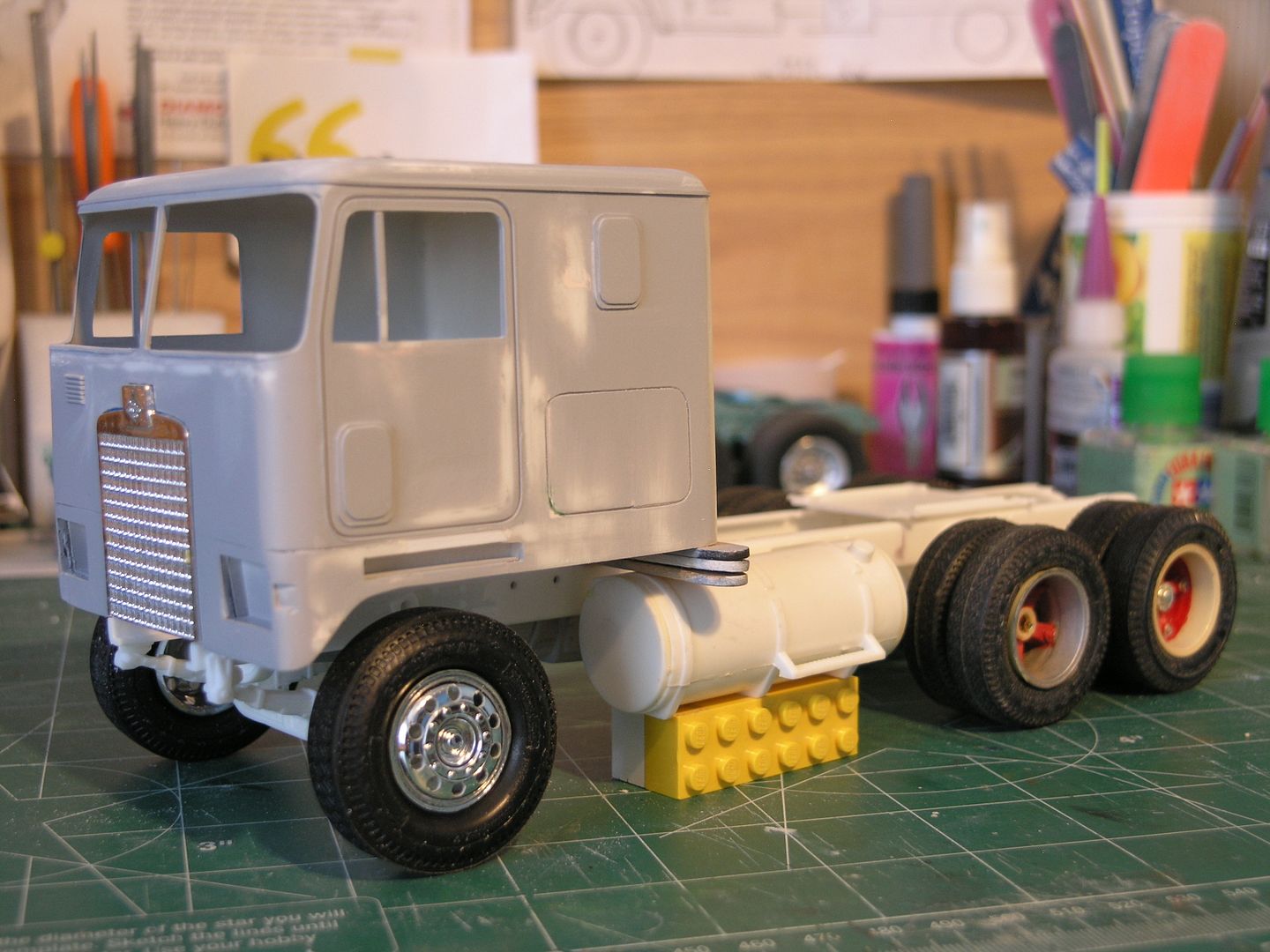

A quick mock up for pg 3.  The top of the doors have the KW taper removed and the vent window has been relocated.  I have also pretty much have found all the little gremlins on the cab. Lots of Mr. Surfacer 500 to fill small imperfections.
Now the real work starts - Making the cab mounts and cutting the grill where it will pivot.
Thanks for looking in :)

Ha, you dont know me very well. The more I look at something the less I like it.  Those cab vents were aggravating  me the more I looked at them, so out came the chisel bladed knife and off they went.  Made 4 more up that are not so fat looking - back to fixing gremlins.

When I started this project I was using a computer drawing of a Reo Royale ,it was great for rough cab work. But my mistake was using it for vent dimensions,apparently they were exaggerated in size as to let you know they were there .

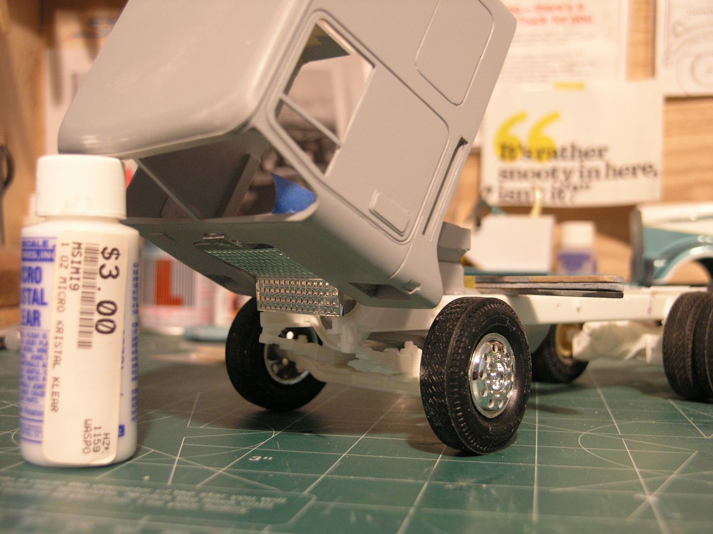

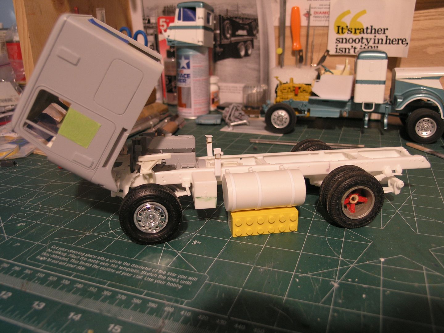

So after round four (yes I made 4 different sets) I am satisfied with these.  My other obstacle for the day was engineering the cab tilt.

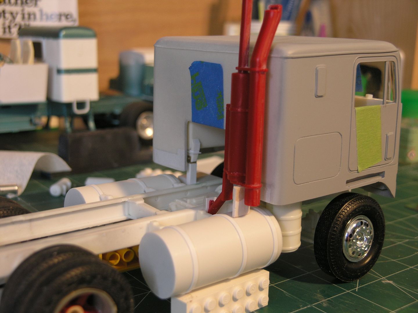

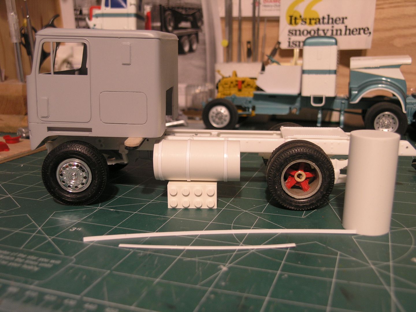

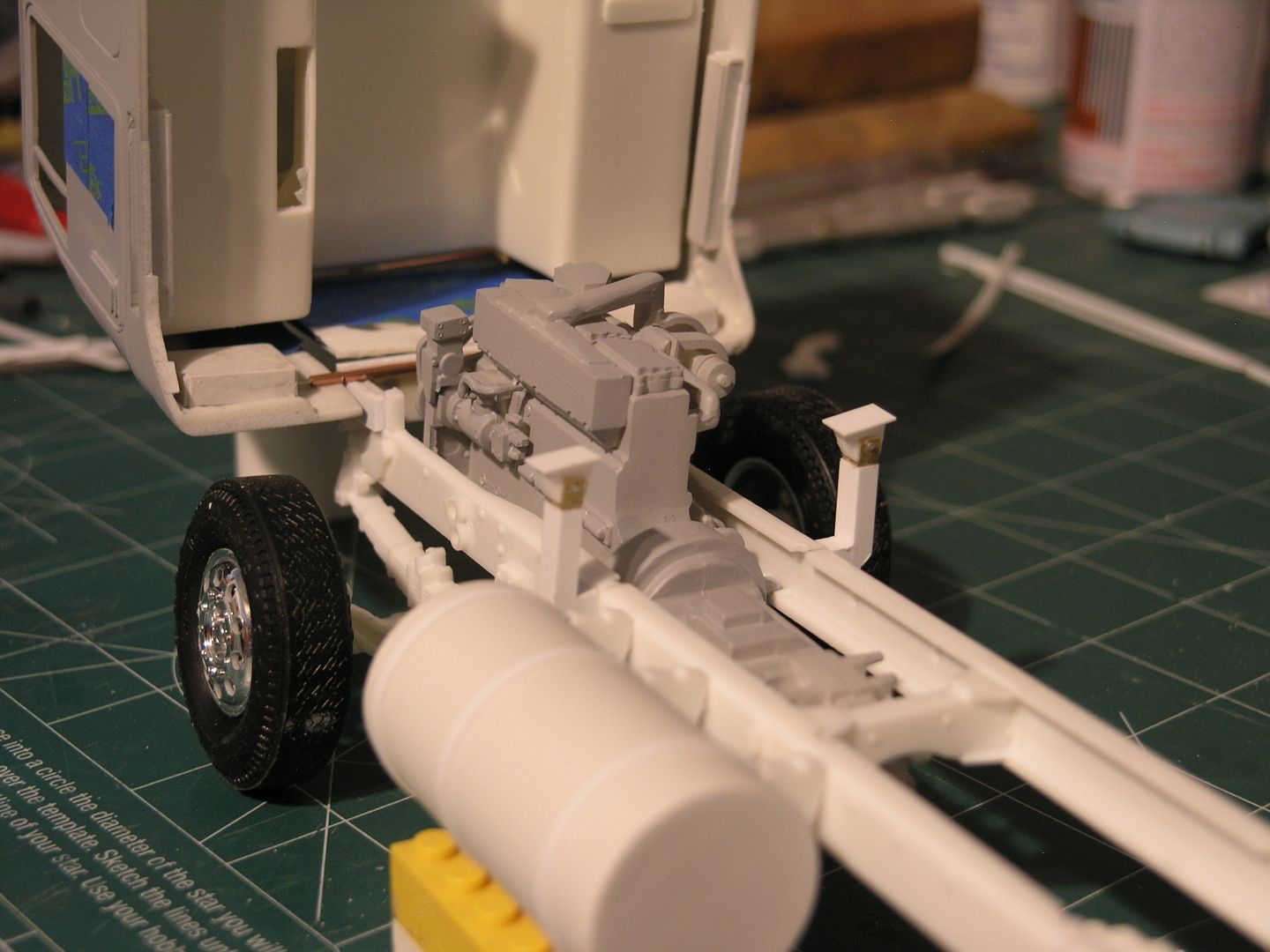

I searched and searched for suitable kit fuel tanks, nothing to be found.
I made these out of pvc and styrene for the end caps and strapping.

Gator - the tanks were way easier then modifying kit ones. Heck of a lot less sanding and filler work.
Today's little project - Rear cab mounts.  Once again I used my artistic license to manufacture these. The pads even pivot ;)

Slow progress, I built the double decker battery box and finished up the rear cab mounts.
And now I am dragging my feet - Piping , my Achilles Heel of a truck model.
