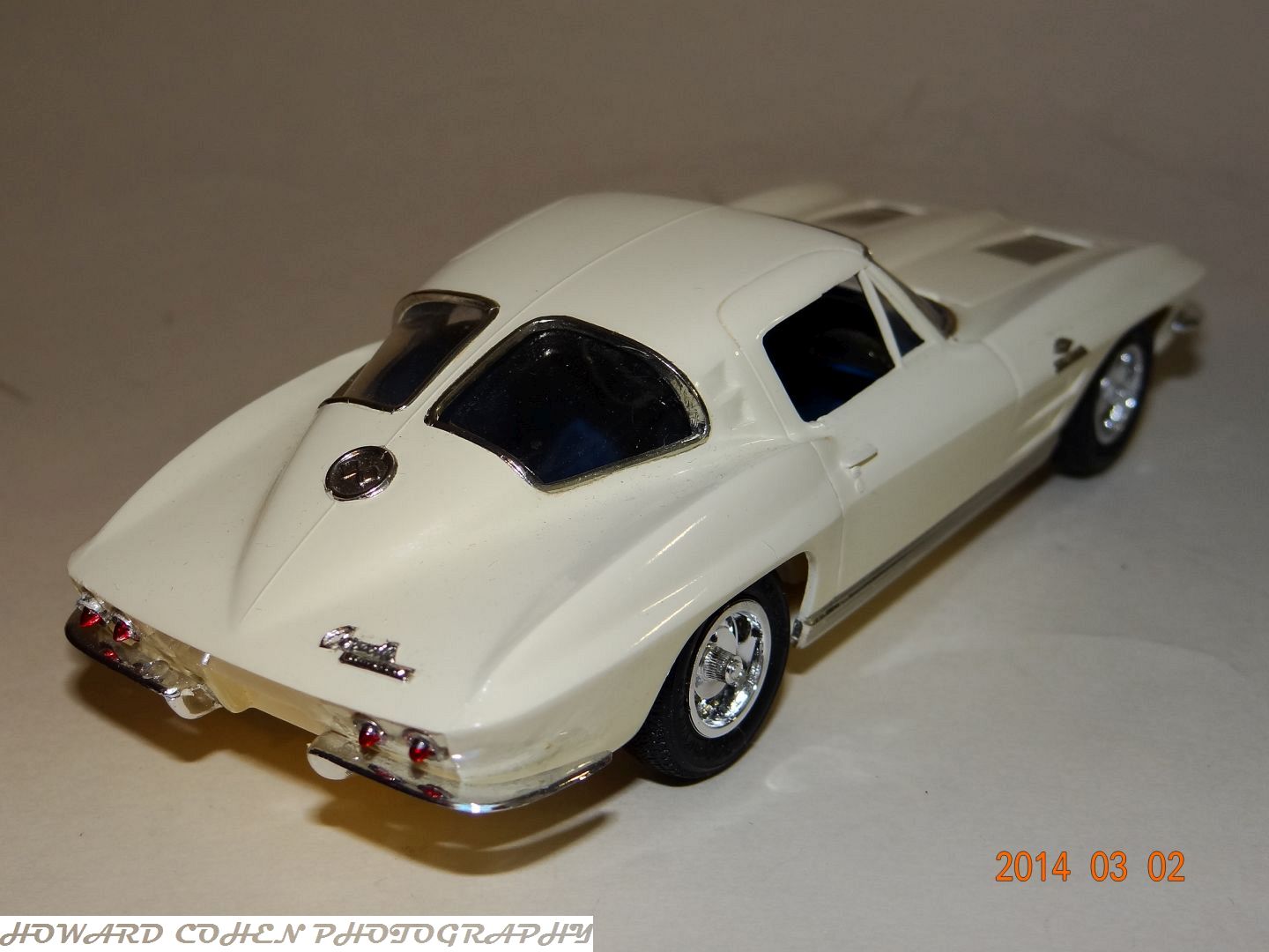

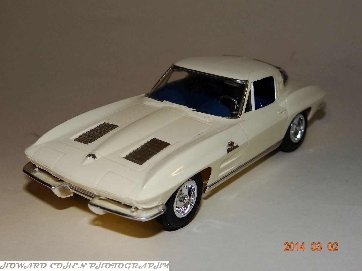

This is my original 1963 coupe that I did about 25 years ago, simple white with foil.

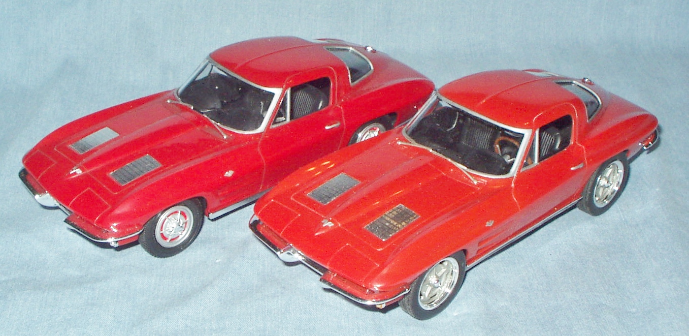

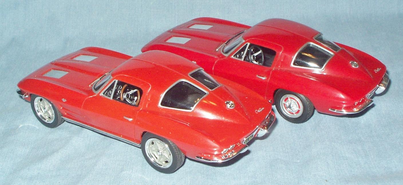

Having built several of each, I can tell you that the Revell Snapper has a much more accurate body shape than the AMT. But it's curbside. If you want a full-detail one, you'll have to do some kitbashing (after you cut out the hood).
Here's a pair of the Revell snappers, all-stock solid red and metallic red-orange with big wheels from the snapper '57 Chevy. Both are polished plastic, no paint (except details and trim).
