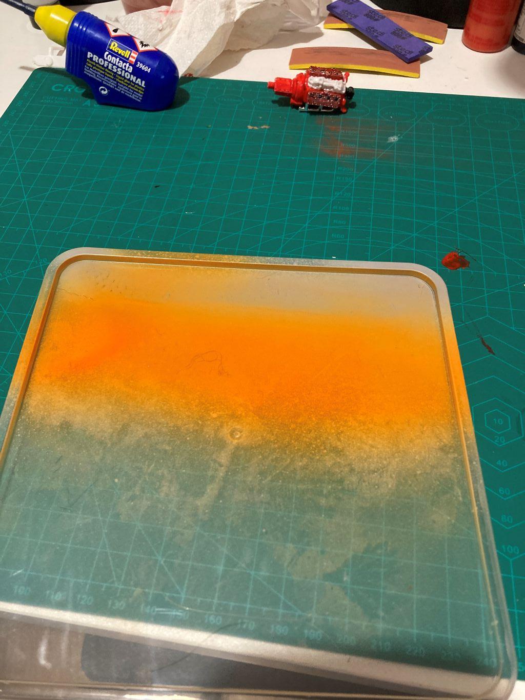

Donny Posted 19 hours ago Posted 19 hours ago On 1/17/2016 at 9:44 AM, MrObsessive said: My #1 rule when it comes to trying out paint! Plastic spoons to test are cheap------model kits are not. yep good idea, unfortunately for Aussie builders, plastic spoons are not available in Australia, banned - bad for the environment. Everything plastic is being phased out here 1
Cool Hand Posted 18 hours ago Posted 18 hours ago (edited) 46 minutes ago, Donny said: unfortunately for Aussie builders, plastic spoons are not available in Australia Thats not entirely true. Just need to know where to look. You can still get them, a quick search on ebay and you will find many sellers in Australia. Edited 18 hours ago by Cool Hand 1
Donny Posted 12 hours ago Posted 12 hours ago Thanks Luke, I tried Woolworths, Coles and a couple of places that supply picnic and catering supplies, all told me not available anymore. Usually eBay want to charge you six to eight bucks delivery. Today I bought a pack of plastic containers, thought I'd try them and see if they work, the lid Don
