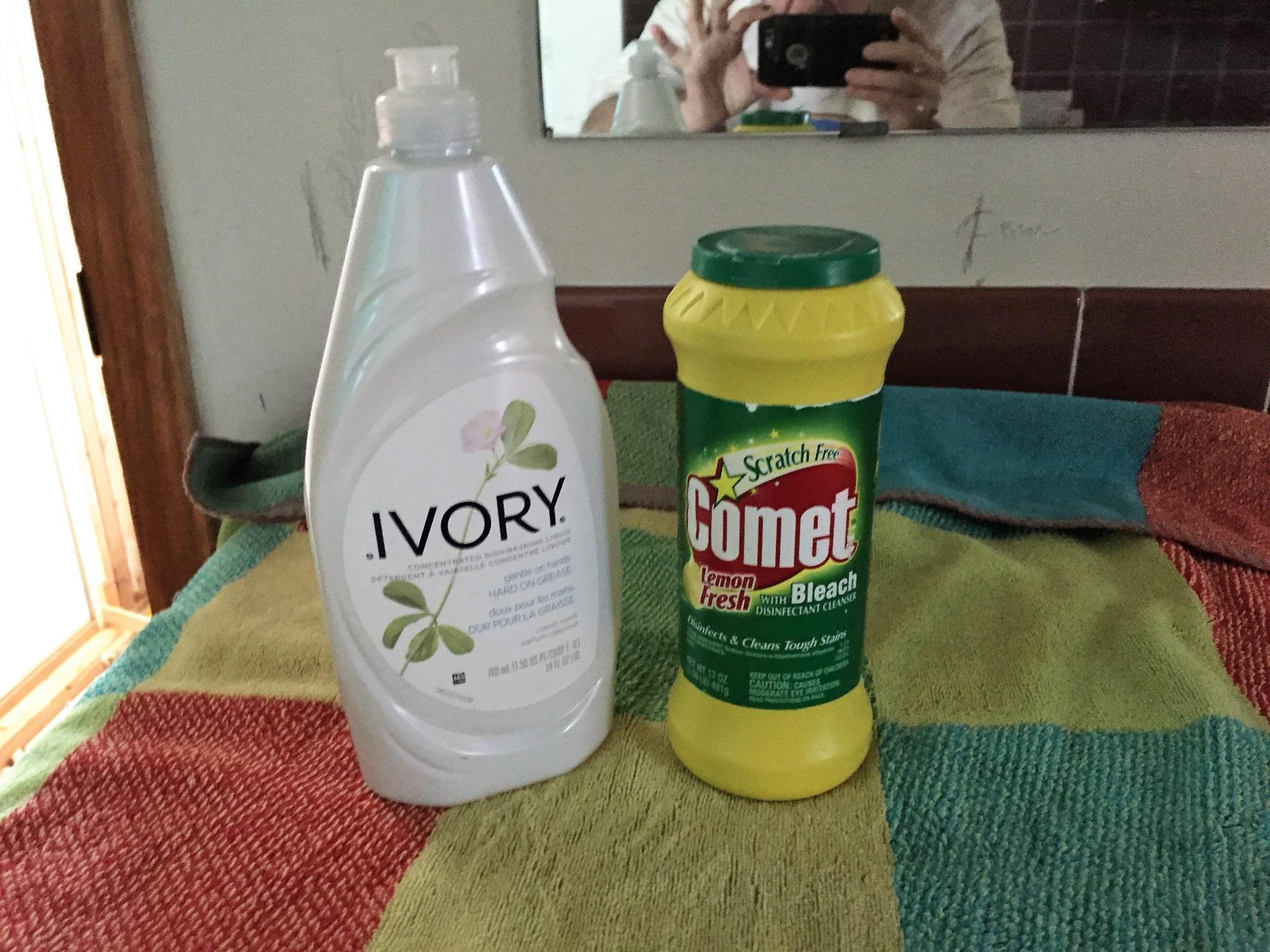

Cleanliness: The first step in preparing the surface is it a good bath in soap and water. Be careful here, not all soaps are equal. Most soaps contain a scent or perfume, Some of these agents come from the make up sector and contain animal fat. Fat equals grease, grease equals fish eyes or a surface that has a film that acts as a barrier that prevents a true clean surface.
The Gold standard of the 1:1 custom paint arena is IVORY original scent dish soap. This is a great product for your first washing and as a lubricant for wet sanding. A few drops in a bucket will help soften your wet/dry paper and will act as a lubricant for easier sanding and aids in paper clogging.
Tooth: For any primer or paint to stick to a substrate you need to create a mechanical bond, that process would be through sanding and scuffing the surface to create that tooth for the mechanical bond. A great aid in getting the surface scuffed and dulled to receive the primer and or top coat is Comet Cleanser and or Soft Scrub. After sanding and scuffing follow up with a mixture of water and cleanser to a consistency a little thinner than tooth paste, apply this with a medium bristle tooth brush. You can be fairly aggressive when brushing with this paste. When you are finished with this step wash the subject to remove all residue and dry. All surfaces should be dull (no shiny spots) if you have any areas that are not dull go back and work those area's until they are dull
There are many professional products in the 1:1 market that we use on a regular basis and they are part of our arsenal at the shop, We use products by the SEM company, they are SEM Soap and SEM Scuff & Clean, However you will  spend more than a few dollars for these professional products (fairly expensive) For a few dollars you can get the same results with household products. I used this method for years, I purchase the SEM products as a convenience and to maintain consistency within our group, a everyone on the same page scenario.

Good tips. I started using and recommending Comet somewhere around 2012, and it works great.
Like Jimmy says, you can be aggressive with the stuff without worrying about fubarring details. Sandpaper, on the other hand, will tend to soften and dull details, and it just can NOT get in all the little nooks and crannies next to chrome trim, door-handles, etc.
I've found a hot-water rinse is all that's needed to get all the Comet and residue off the model. I personally prefer to use el-cheapo recycled white paper towels, the grocery store generic brand, to mop up whatever water remains on the model.
Then, I've come to rely on a thorough wipe-down with clean paper towels and 70% isopropyl alcohol. It's the best wax-and-grease (and silicone too!!) remover I've ever found, and I use it on full-size custom and aircraft paint jobs where I simply can't afford a redo because of fisheyes. The stuff works.
