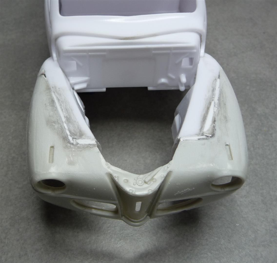

Exactly. The real '41-'48 Fords are entirely different (from the ground up) from the '40 (note: the '41 pickup is built on the the same platform as the '40) but parts will swap back and forth on the real '41-'48 cars with little difficulty. I've been fiddling with swapping the AMT '41 woody nose on to the Revell chopped '48. It looks to be pretty straightforward so far. (When I started on the IMC '48 swap, it was the only stock-roof available.)

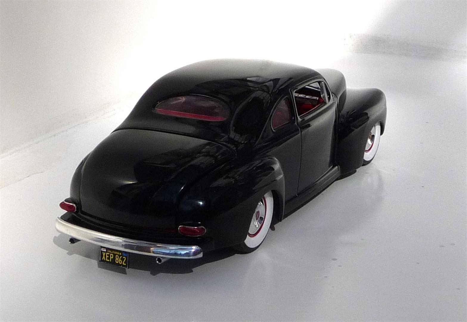

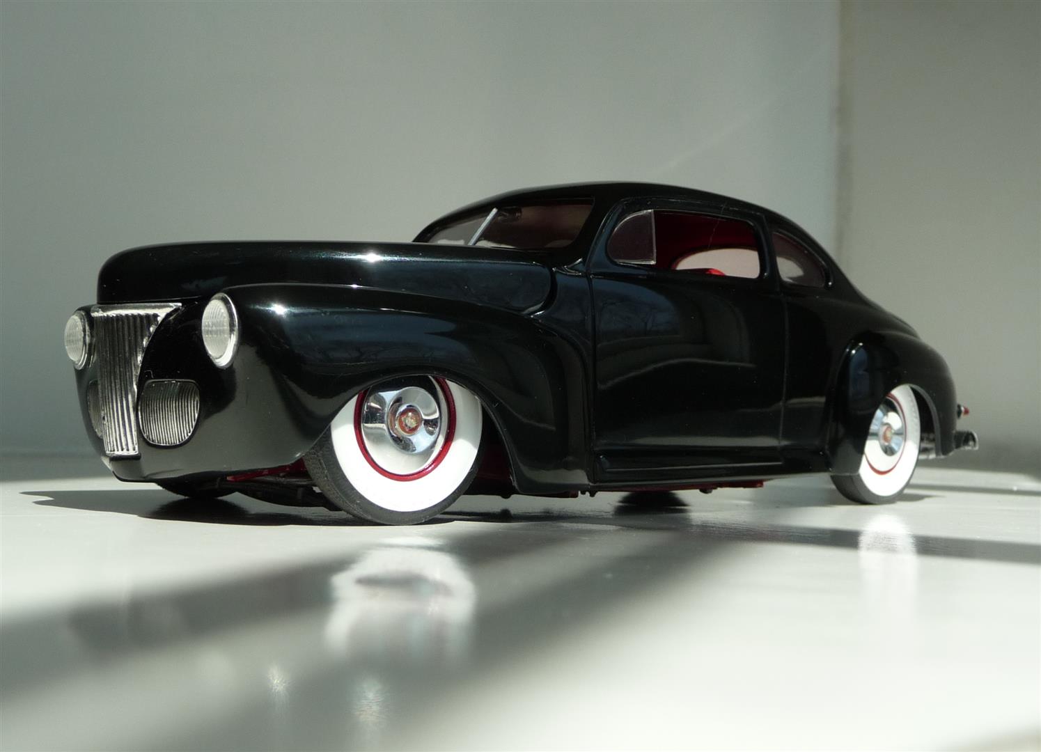

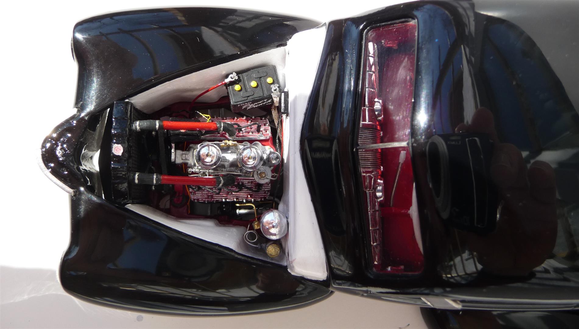

I built this one using the chopped Revell coupe. I'd expect most of the stock height roof Revell kit to be the same. Just don't expect the AMT front fenders to fit like a real car, leave some of Revell's fenders attached and make your splice a bit forward, something like my first picture.
