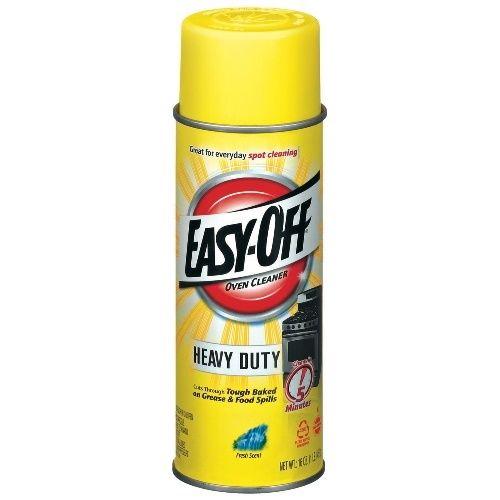

Snake45 Posted February 13, 2016 Posted February 13, 2016 I did a Chevelle in their TS silver or aluminum color. Rubbed through in polishing it, had to strip it, alcohol had no effect. But Easy-Off took it right off, just like Testor enamel. Go figger.

花火 Posted February 13, 2016 Author Posted February 13, 2016 I did a Chevelle in their TS silver or aluminum color. Rubbed through in polishing it, had to strip it, alcohol had no effect. But Easy-Off took it right off, just like Testor enamel. Go figger. what is Easy-off sir? this one???

Snake45 Posted February 13, 2016 Posted February 13, 2016 what is Easy-off sir? this one??? Yes. that's it. Contains lye, which is the chemical that does the job. Wear eye protection when using.
花火 Posted February 14, 2016 Author Posted February 14, 2016 Yes. that's it. Contains lye, which is the chemical that does the job. Wear eye protection when using. thank you Richard. Not really that sure how to find a similar staff in China.. guess I have to do some search

Mike_G Posted February 14, 2016 Posted February 14, 2016 thank you Richard. Not really that sure how to find a similar staff in China.. guess I have to do some search Look for sodium hydroxide as the active ingredient. FWIW, I haven't had much luck with lye removing TS sprays, but DOT3 brake fluid has worked for me in the past.
Art Anderson Posted February 15, 2016 Posted February 15, 2016 thank you Richard. Not really that sure how to find a similar staff in China.. guess I have to do some search "Lye" is a common English name for the chemical "Sodium Hydroxide" (also sometimes called "Caustic Soda" here in the US) Art
