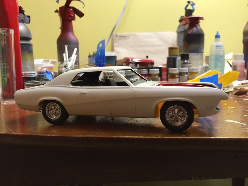

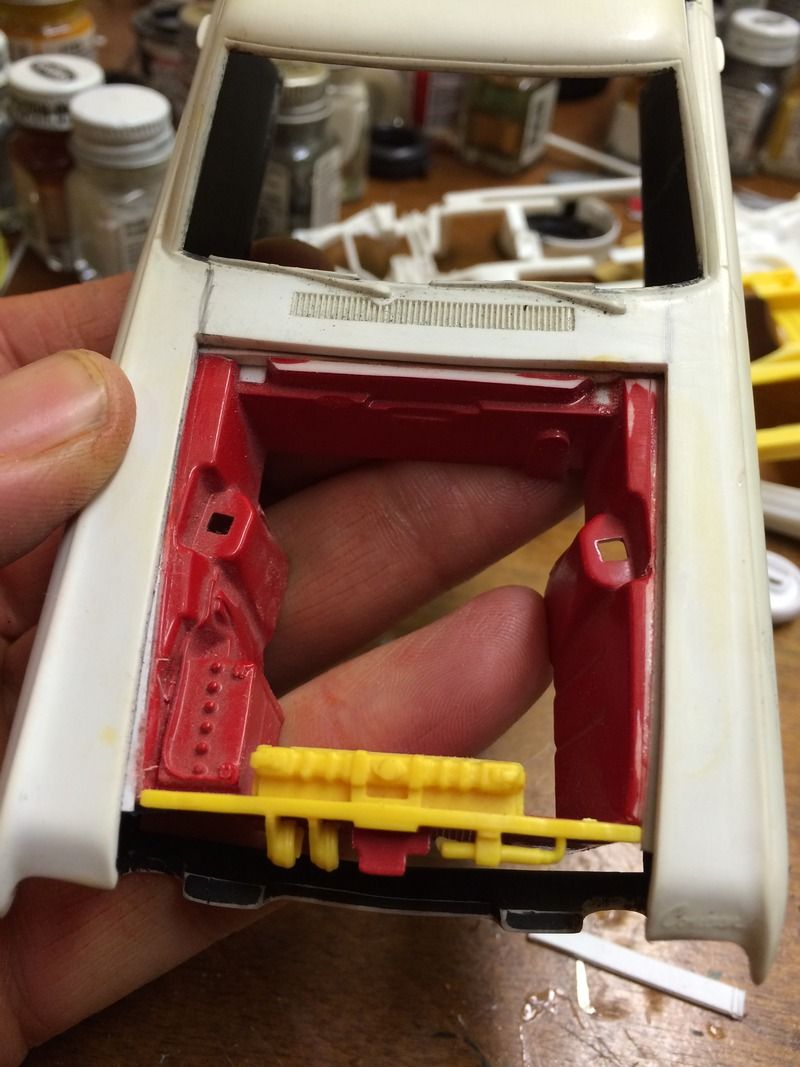

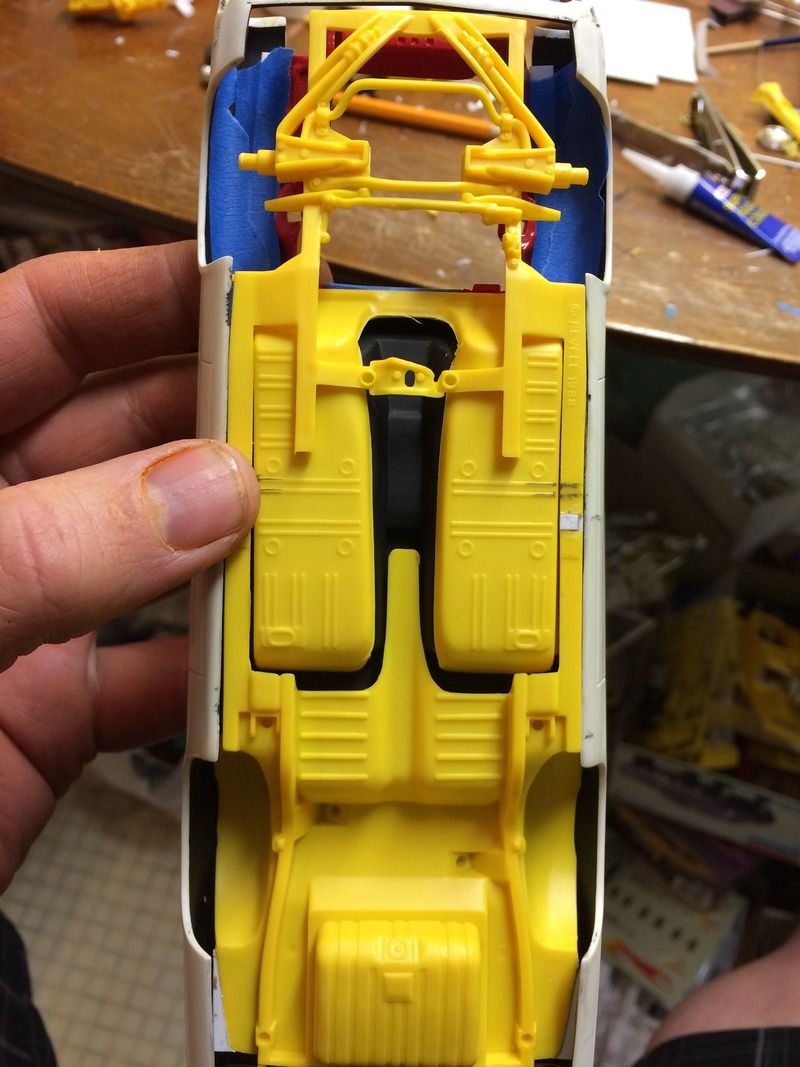

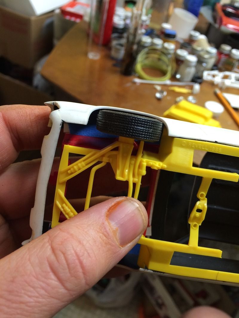

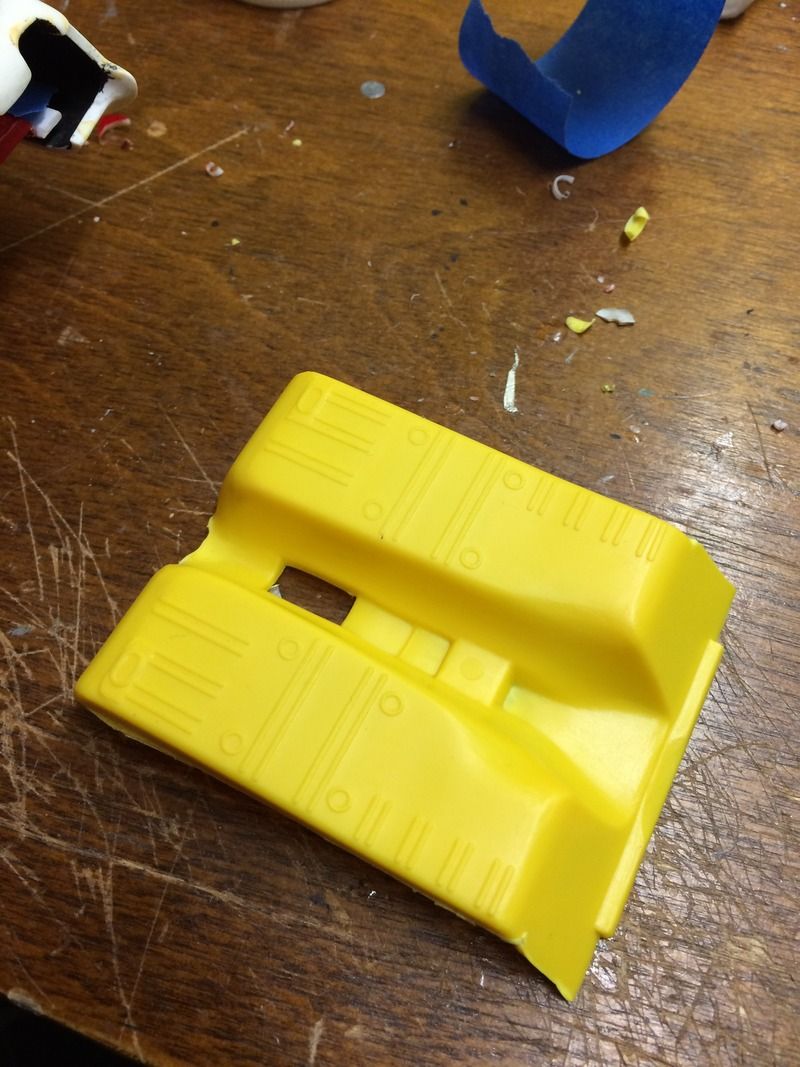

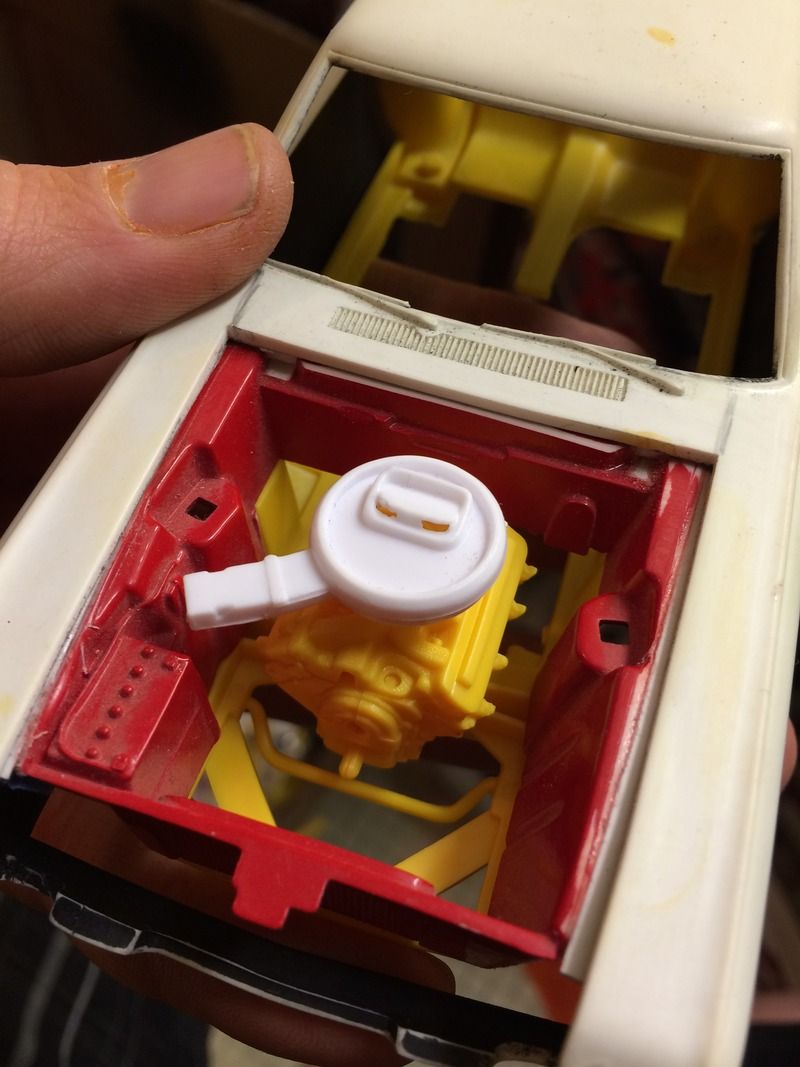

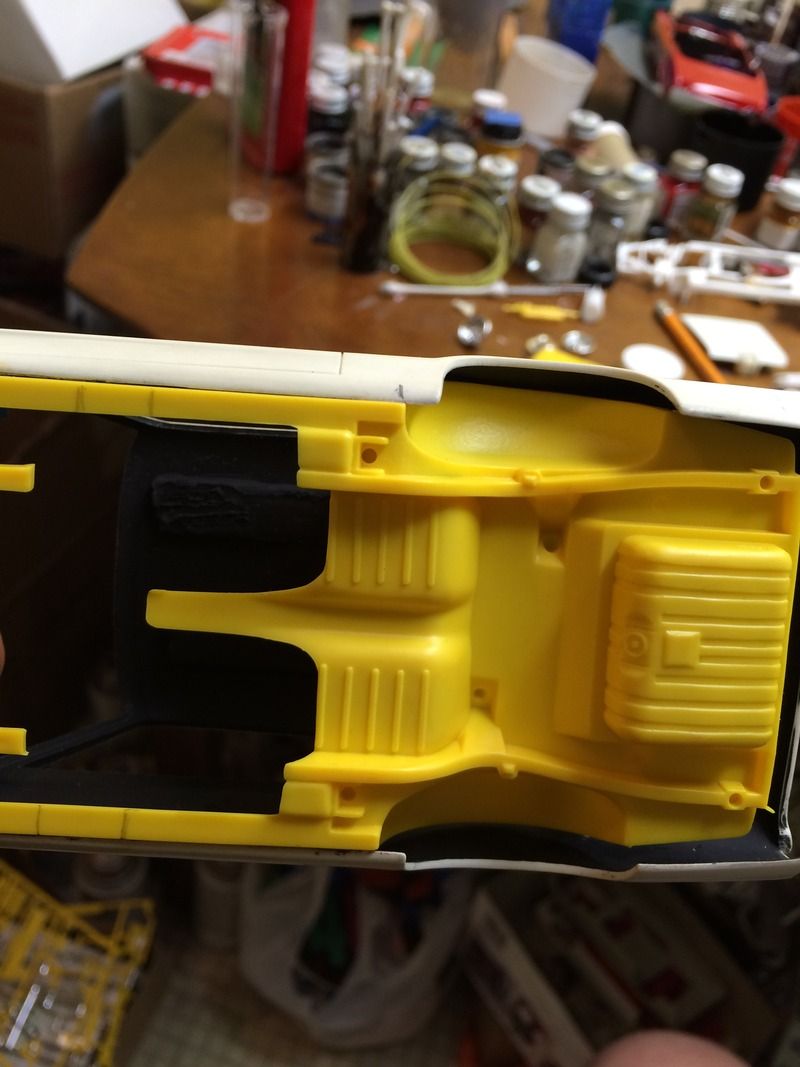

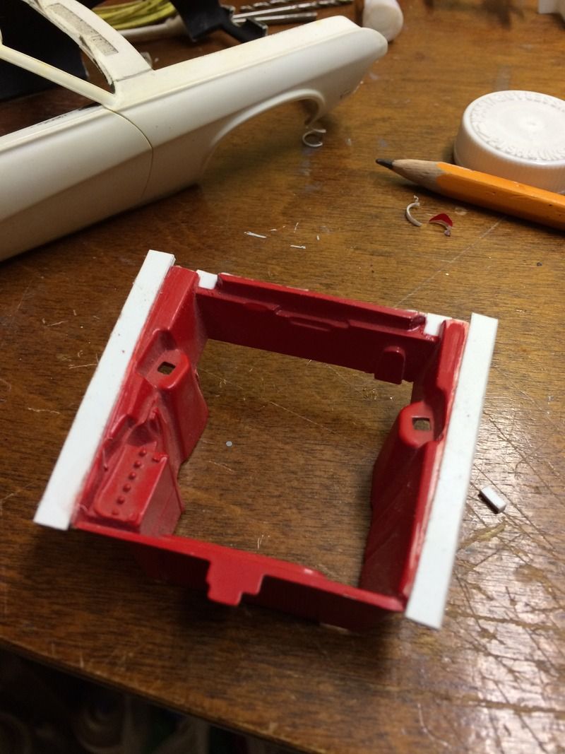

i got this kit from a friend as a rebuilder.  It's hard to find and expensive.  He started adding the better 73 cougar engine bay.  I thought there had to be a better option.  I cut up a revell 69 Mach 1 and used a 69 shelby as a donor.  I will be doing a grabber green 70 eliminator.  This is an easy great upgrade that is easy to do. I have the 67,68 and 69 Cougars as well and now they will all be getting this treatment.  Follow along. I will let the pics do the talking.  Happy to hear any comments or questions
Really, Really nice job adding the engine bay area to the cougar. Nice to see you saving a rare kit like this. Please keep us updated on your build and I definitely will be following.

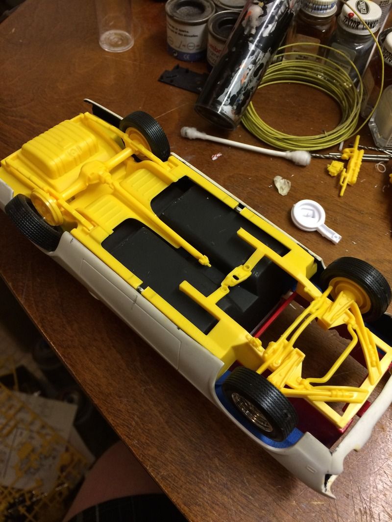

Interesting and very creative conversion. Could you share the reason for the floor boards being changed ? Also the Yellow Chassis looks like the rear wheel base is just a little short. I have not built this model, but wonder what the short comings are on the engine bay ?
I had to stretch the chassis about 3mm to set the wheel base.  The kit comes with a very generic plate chassis and the engine bay is not even close to correct.  I figured if I were going to cut up a rare model I might as well use the best parts to make a nice factory stock car that is seldom seen on the contest tables.  To my knowledge in the first to do this conversion ?

Good choice on the floor pans.  Those look to be pretty correct, as far as ribbing and drain plugs go.

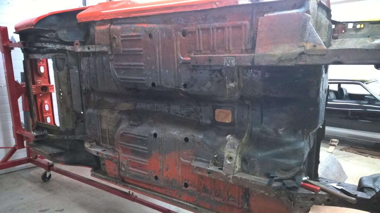

Don't forget, all Eliminators have a "slop gray" underside paint color.  This was typical for Cougars and Mustangs built in Dearborn, MI at the time.  For those who are unaware, "slop gray" was basically a slate / black-ish paint Ford used on various parts and major unseen areas of the cars.  Actual color varied because it was made up from all the waste-paint put into one vat.  So some cars will show metallic flake, others have a greenish tinge to the "gray".

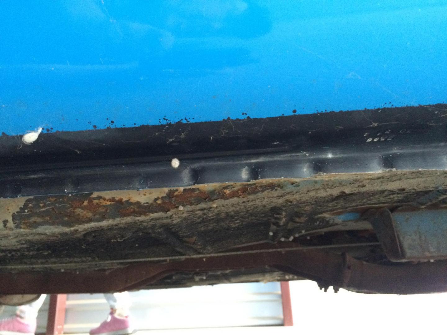

I've attached a pic of the original underside of a competition orange '70 Boss Eliminator.  You clearly see the factory orange overspray (no, it's not rust), as well as the "slop gray" / black underside paint.
The slop gray extends up to the firewall and basically ends at the end of the transmission tunnel.  Slop gray was also used on the shock tower support struts (connect between the shock tower and firewall).
Engine compartment is semi-gloss black (which over time tends to flatten out with heat / age).  Shock tower caps are "natural" - a dark steel color.
Another thing to mention is that they blacked out the pinch weld area at the bottom of the rockers (blue pic below).

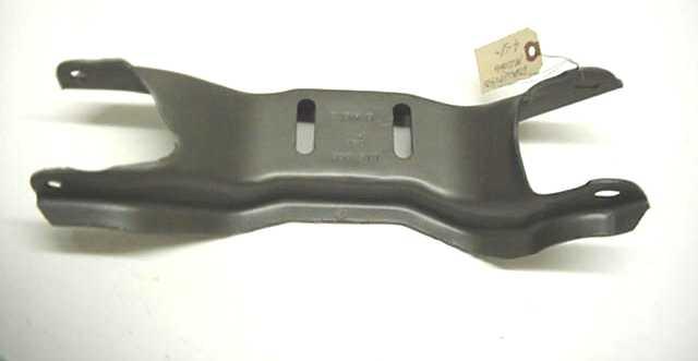

Also the transmission cross member on your model is styled to resemble the one used on an automatic transmission.  Attached a pic of the 4-speed cross member for '69 / '70.

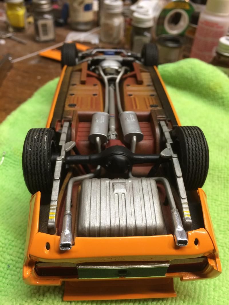

thanks! The kit has the xr7 interior so I don't know how far I will go with it.  Some pics would help.  I grew up with mustangs and torinos.  Dad had one cougar, a 69 xr7 390.  Done a couple restos as well. I've also seen red oxide on some Cougars I think it depended on what was on hand. Here is a mach 1 chassis I did.   I tend to stick to the factory stock fords as that's what I grew up with so, like you I know silly things like casting numbers etc lol

Great detail on the undercarriage!  Very cool!  So it sounds like you're an old hand at restoration details - that probably makes it easy scaling everything down :-)
As for the red oxide on the Cougars, they were built at several plants, and they all used different practices.  Eliminators were all built at Dearborn and should have had a slop gray underside.  But... there are plenty of them out there that have been restored with red oxide.  I doubt anyone will question it :-)

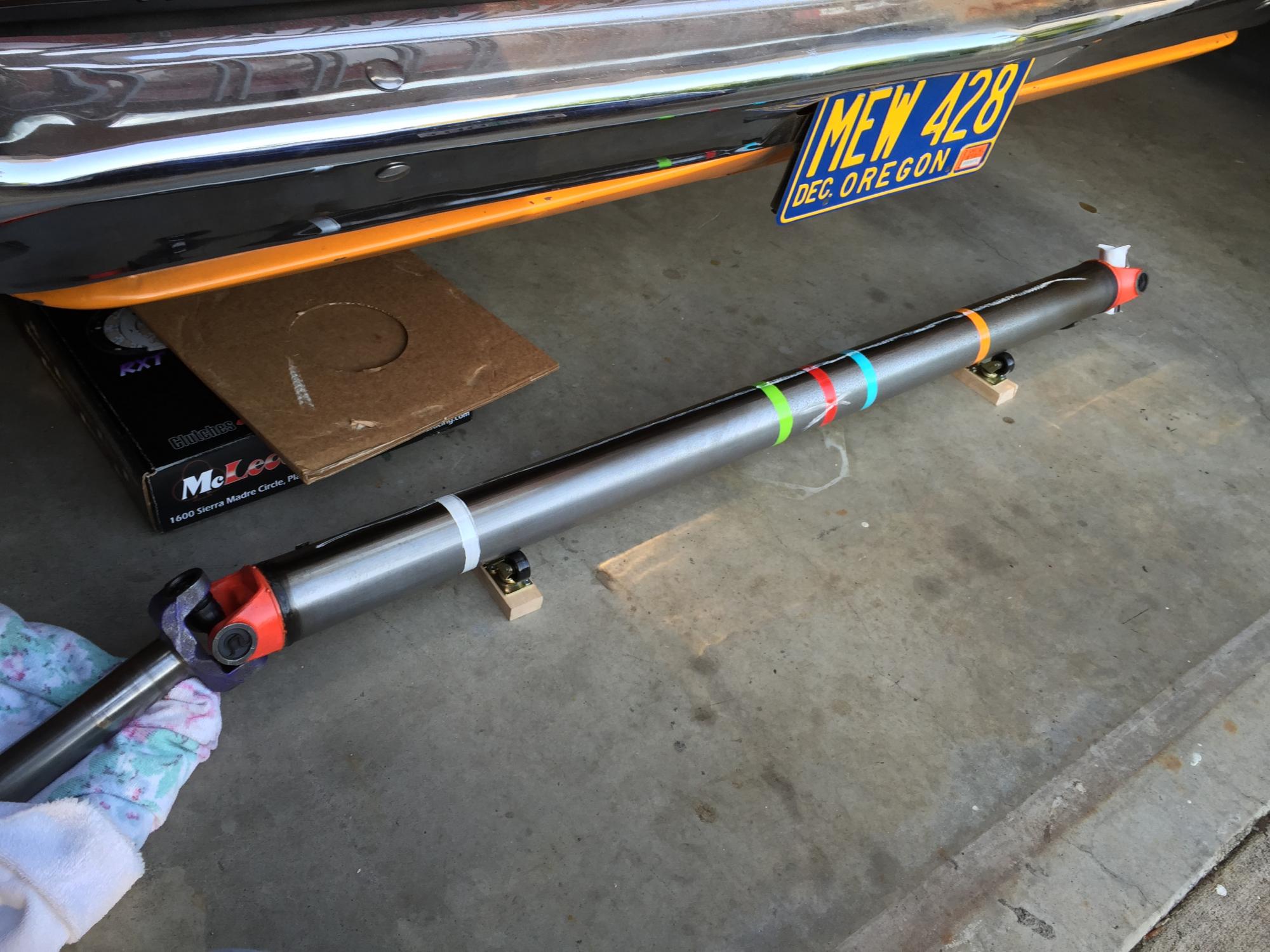

Here is a picture of a '70 Cougar SCJ / 4-speed driveshaft, for reference.  Transmission yoke ends had purple markings, driveshaft end yokes were a red-orange.  The white stripe went toward the front and an orange stripe toward the rear.  The three in the middle are correct colors, but in the wrong order - they should be blue / red / green, front to back (oops).
