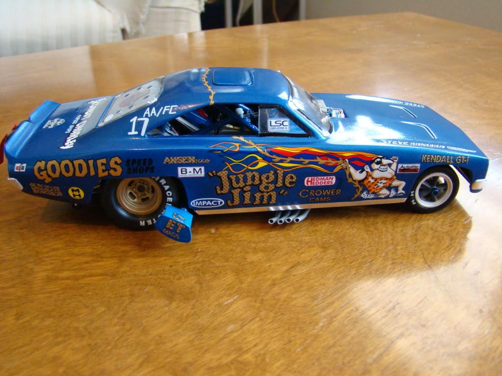

Nytrozilla Posted April 30, 2016 Posted April 30, 2016 I concur 100% on the canards Tim. I'm a big fan. Not for functionality, that subject's had a piano and an anvil dropped on it, then blew up. Canards are all about the look. They are just badd lookin'. I'm also in agreeance on the rear spoiler, although I could have lived with it. One more thing on the canards. Here's a pic of my Jungle Jim Charger phantom build, which is one of the correct ways to do it, in addition to putting them on the rear quarter panel. Following that is a pic of the wrong way to do it. Keep on rockin' Tim.

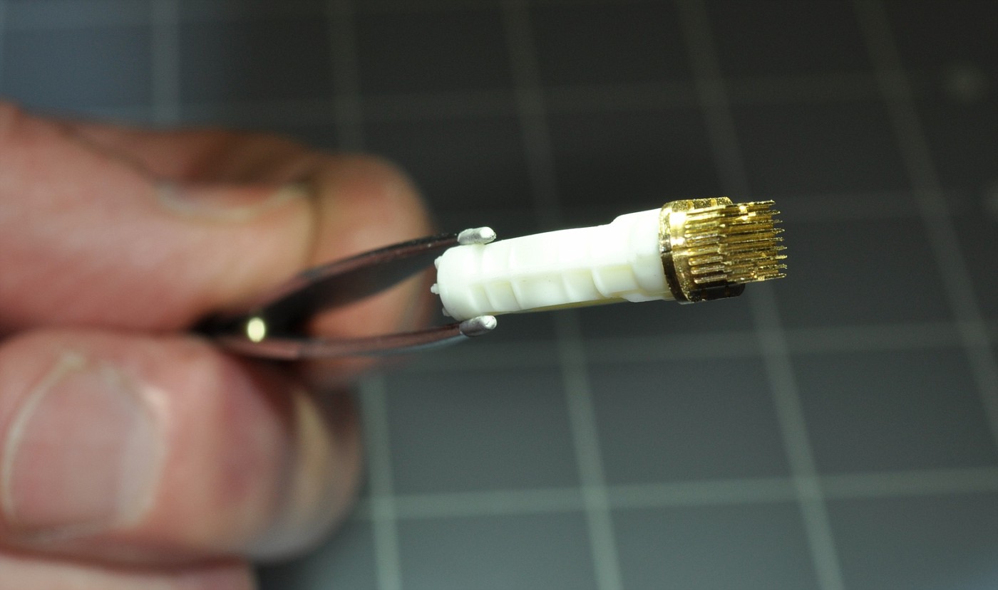

Codi Posted May 4, 2016 Author Posted May 4, 2016 Thank you Chris & Dave.....promise not to drop this one. Today I went forward with machining the quick change rear end. I was trying to choose between the typical Halibrand or a Frankland. I really liked the rear gear cover back in the day on the Frankland but I wasn't sure if I could machine it. The tricky part was continuing the fins on the back of the cover up and over the top and bottom like the original. Took a day to get it done but it's the most visual piece on the rear and I wanted to get it as correct as I could. It's a shade over 1 cm. I've got about a dozen more pieces to make for the rear to call it done. The grooves you see on the side of the rear end are for .8mm brass tubes that I'll solder in to replicate the real one. The fins are .22mm thick as an fyi. cheers, tim
Mooneyzs Posted May 4, 2016 Posted May 4, 2016 Tim... Holy Smokes that back plate is a work of art already. .22 mm thick fins... You are saying that the fins are .009" thick? Dang that is tiny and I am super impressed. I can't wait to see the next parts you make for this. Keep up the great work!! Glad you are back at the bench.
