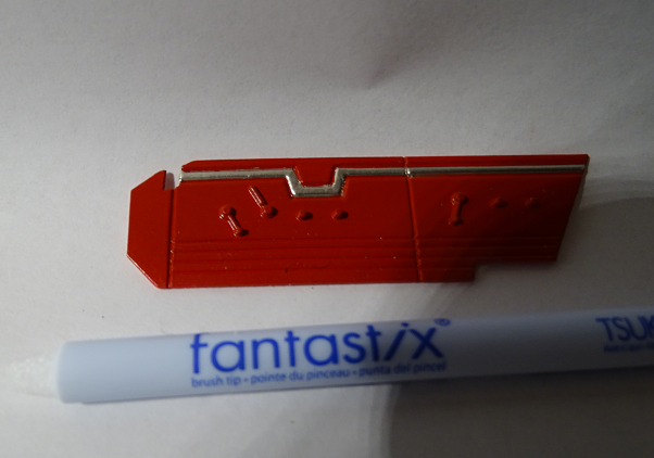

Jon Haigwood Posted June 17, 2016 Posted June 17, 2016 First time using BMF. I am working on a door panel for a 64 Belvadere and I want to put BMF along a section. The problem I am having is that when trying to remove the foil from the area that I don't want it to be it sticks so well that it damages the paint. The door panels were primed then painted with red. On my second attempt I put down a light coat of Future to give it a protective layer but that did not help. I thought about putting a light coat of wax along the outside edges so the foil would not stick but I plan putting a coat of semi-gloss clear to cut the shine put I am not sure how the clear would work on the waxed areas. If I put the semi-gloss down first I think the area I wax will then be to shiny for the look I want. I did try doing some touch up with a small brush but the paint did not work well with the Future.Looking for helpful advice from experienced BMFers

Drake69 Posted June 22, 2016 Posted June 22, 2016 I also suggest clear coating your paint prior to BMF. If it becomes too glossy you can go over it with Dullcoat to drop it back down again.
Jon Haigwood Posted June 24, 2016 Author Posted June 24, 2016 Thanks for all the info and tips. I repainted then let it dry fully. I didn't burnish it until after I cut the edges and removed the excess. Then I burnished it down with this fine tipped painting pencil I found at Michels (pack of 5 for $5). I know it is not perfect but it's a lot better than my previous results. Now I have to dull coat it and figure out how to do the door and window handles. Thanks Again You folks are the Greatest Jon
