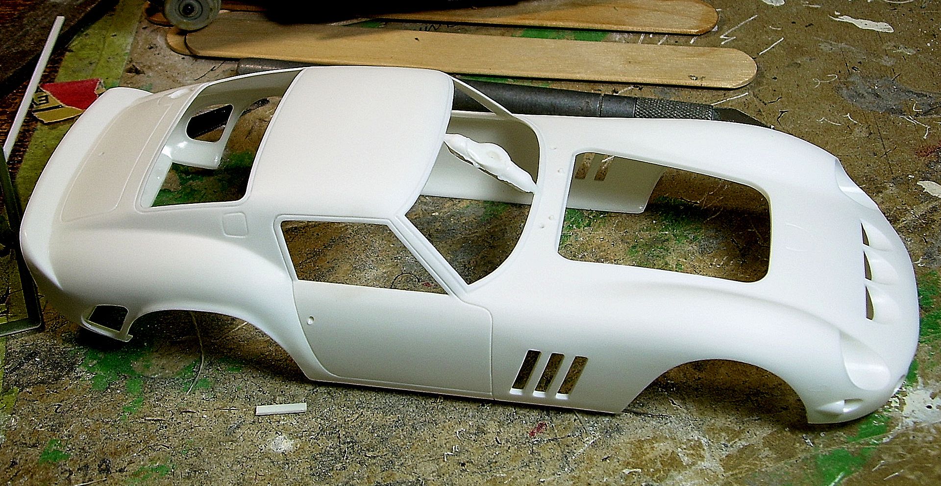

It's been a while on this one, but I've been doing some testing, learning how to deal with some problems, etc.
I tried a couple of different methods of shooting the body with HOT self-etching primer, in part because I'd wanted to leave her in chromate green through the build process. And she crazed like crazy no matter what I did.
Even though this particular kit misses the accuracy mark in a few places, overall I just prefer this rendition of the 250 GTO to even the real one...except that odd rear wheel arch. Adding material in the form of .030" strips...
While that was setting up, I started addressing the wheels I want to use. They're 1/25, and fall through the 1/24 tires I want. Solution: a strip of .020 styrene around the rim. And it's OK. Some of the earlier Americans had really thick looking rims.
After painting, they'll look close enough to possible period-correct for this build. Raised lettering is being removed from the tire as well. Took some more experimenting to get that working 100%, too.
Sculpting and rounding the first wheel arch...and the primer crazing is really apparent here. This is a fairly expensive kit, and giving up on it wasn't an option I liked.
About done with the first phase of the wheel arch mod...
Edited by Ace-Garageguy
Now for the really cool part (I think so, anyway).
She'd crazed down in the panel lines, and it also looked like by the time I had everything blocked, some of tthe lines would be getting pretty shallow.
So I bought a set of the Tamiya panel-line engraving tools. Expensive, and they took over 60 days to get here due to the Covid mess...but boy damm howdy, are they great.
Made a transfer template of the new wheel opening to insure the other side will match, with some reference marks.
Getting the wheel arches round is simply a matter of finding something with the right diameter and sticking some sandpaper to it...
Body with wheel arches done, puttied, and all the crazing sanded out, panel lines deepened...Even though the surface is level and smooth at this point, the effects of the crazing are still evident here. But I didn't want to get too aggressive and start losing body contours. In the event, the green was a good guide-coat for showing some mold lines and other imperfections. That apparent crack on the decklid was why I got a pretty good deal on this thing, too. Now fixed, permanently. There's a learning curve with the scribing tools, and you can see where my hand slipped a couple of times, but nothing terminal, and easily corrected.
Two coats of Tamiya fine white surfacing primer. Another first for me...and damm is that stuff great too. If you want good work without having everything go wrong, spend a few bucks for top-line materials. There are a few tiny flaws to address, another coat of primer, and she's ready for paint. I'm really happy I was able to save this one relatively easily...especially since I knew better but buggered her in the beginning anyway.
