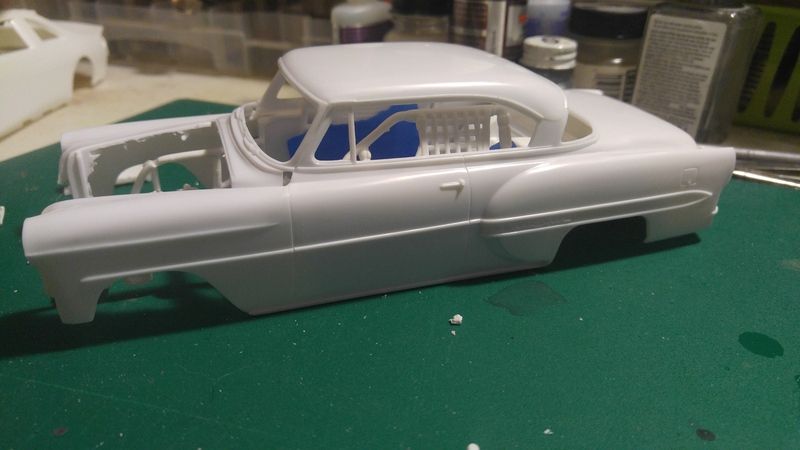

Jantrix Posted August 5, 2016 Author Posted August 5, 2016 Quick update. I've trimmed up the chassis and body, so that they will mate smoothly. The chassis still needs to be lengthened AND now based on this photo and my trusty caliper, it will need to be sectioned about 4.5mm. I was planning for this modification so it's no surprise. This kit definitely has some dimension issues in any case, and it will look much better once it's sectioned. I've channeled this kit once before about 25 years ago, and it looked great. I just wish I hadn't continued the custom work after that and screwed the whole thing up. I'll start by removing the side trim. Things are picking up at work for at least the next six weeks. So I'll get it done when I can.
JTalmage Posted August 5, 2016 Posted August 5, 2016 I like the look! Almost looks to me that it needs to be extended in front of the rear wheels to push the cabin on the chassis forward.
TarheelRick Posted August 5, 2016 Posted August 5, 2016 Going to be an interesting build. I sectioned one of those bodies many, many years ago ('71 I believe), used a hot knife blade. For some reason I never finished that build.
Jantrix Posted August 5, 2016 Author Posted August 5, 2016 I like the look! Almost looks to me that it needs to be extended in front of the rear wheels to push the cabin on the chassis forward. Thanks guys. Fabrizio, I agreee 100%. I think it's going to have a great look. Rick, I'm gonna do it the old fashioned way. Slowly, with the back of a #11 until the groove is deep enough and then bring in the zona saw.Jesse, you are exactly right. I'll be stretching the chassis right behind the seat about 8.5mm. That will get my wheelbase right and center the cage where it's supposed to be. I don't think chopping the top will be necessary based on my measurements. I'm not a fan of doing so in most cases.
JTalmage Posted August 5, 2016 Posted August 5, 2016 Depending on where the side roll bar ends up, might look better with out a chop. I don't personally like seeing too much roll bar visible in the side windows. But sometimes it's inevitable.

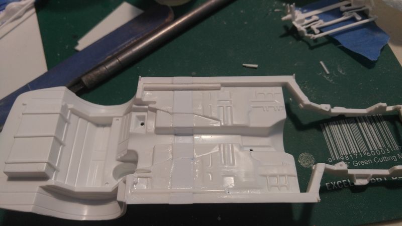

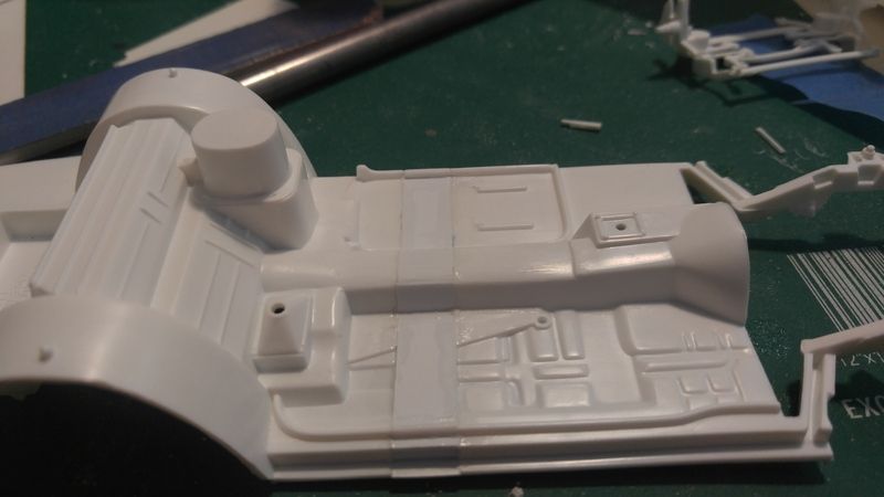

Jantrix Posted August 8, 2016 Author Posted August 8, 2016 On my one day off I was able to get the chassis stretch accomplished. Started here. Finished up here. The wheelbase is now spot on.

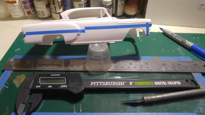

Jantrix Posted August 12, 2016 Author Posted August 12, 2016 Well the need to work and sleep is really cutting into the bench time. I can squeeze in about 30 minutes a day. I have the side trim removed and the tape cut for the section job. The horizontal tape is the portion that will be removed. The vertical line, is just a cut line. There's no need to section the grill. I'm going to take my time and get this cut over the next few days if I can get time. I want the cleanest cut I can get. I'm thinking about trying the method of melting sprue with MEK and creating a plastic paste to do the filling with. Since the cuts will be visible on the inside of the body too, I want them really clean. I never seem to get perfection with Bondo type fillers.
Jhedir6 Posted August 12, 2016 Posted August 12, 2016 Cool project Rob, been watching this, and looking forward to more. I saw a thread on another forum where a guy made filler out of CA glue and baby powder or corn starch?, Sorry I cant remember which but it seem to work really well. I havent tried it myself, but might not be a bad thing to experiment with? Good luck.David
Jantrix Posted August 12, 2016 Author Posted August 12, 2016 Cool project Rob, been watching this, and looking forward to more. I saw a thread on another forum where a guy made filler out of CA glue and baby powder or corn starch?, Sorry I cant remember which but it seem to work really well. I havent tried it myself, but might not be a bad thing to experiment with? Good luck.DavidI've kicked that around, but it's still a different material than the styrene and is harder to sand and feather out. I've been wanting to try this for a while anyway. Also to make the section easier I'm going to open the trunk I think.
