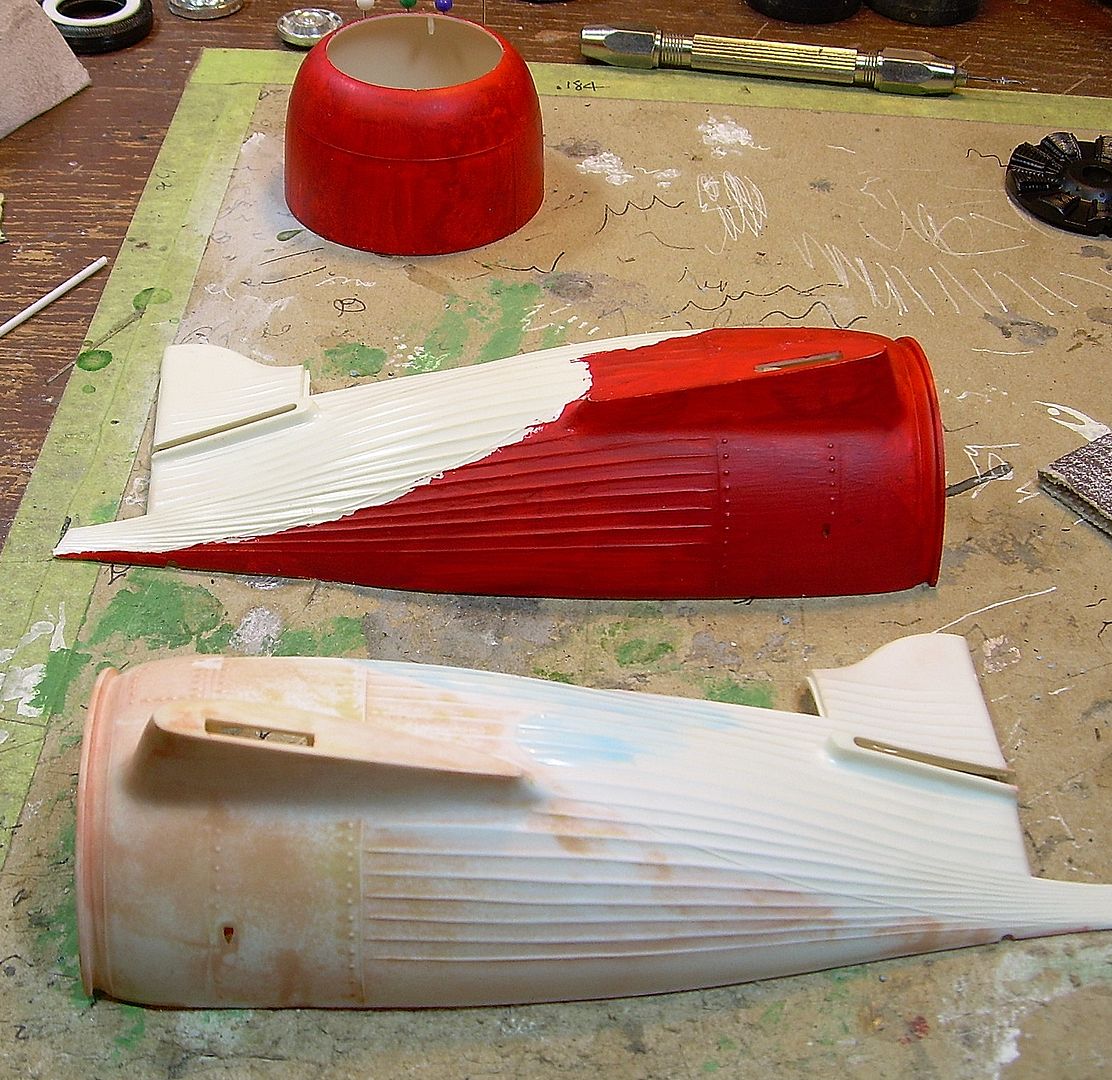

Ace-Garageguy Posted September 11, 2016 Posted September 11, 2016 Anyone ever used it? Does it work over paint/primer? Raw plastic? How well does it work? Give your opinion, thanks, Al RichI'm fixing to find out. I'm doing a 1/26 Gee Bee that requires intricate scallops to be masked over an irregular surface, and the only way I see to do it in any reasonable amount of time is with the MS blue goo. We shall see. I'm doing a removal test today.

Ace-Garageguy Posted September 12, 2016 Posted September 12, 2016 Okay, y'all just spending your money for products that don't work all that well.... I'm perfectly willing to try your magic Snake Mask. What are the rough proportions you use, or about what consistency to you try for? White glue is already about the viscosity of the Micro Mask I have, and it's easily controlled with a brush for fine edges. I just need more guidance on your concoction.

Snake45 Posted September 12, 2016 Posted September 12, 2016 I'm perfectly willing to try your magic Snake Mask. What are the rough proportions you use, or about what consistency to you try for? White glue is already about the viscosity of the Micro Mask I have, and it's easily controlled with a brush for fine edges. I just need more guidance on your concoction. I can’t tell you any "proportions" or ratios because I just make the stuff by the seat of my pants. Basically, I take an old plastic 35mm film thing (you could use a pill bottle, old paint bottle, or anything else that will seal when you’re done) and fill it about 1/3 or so full of Elmer’s glue. This is then diluted with HOT water (cold water takes forever to mix, hot just mixes better/faster). It will take much less water than you’d think to dilute the Elmer’s to a paint-like consistency. If you use too much water, just squirt in some more Elmer’s (or dump it all and start over). You can make the stuff any consistency you want. I prefer an almost gel-like formulation—to where it just won’t quite run off a paintbrush. Now mix in a couple drops of dishwashing liquid. This improves flow and keeps the stuff from drying with air pockets/bubbles. It also seems to improve "removability" of the dried goo—I’ve never had any problem pulling it off any painted surface, as can sometimes happen with commercial latex-based stuff. I add a few drop of red food coloring to help me see where I’m painting it, and to assure complete coverage when I’m finished. I haven’t had the food coloring "leach" out and stain anything yet. Paint it on with any common paintbrush of whatever size, right down to your smallest if that’s what you need to do. Paintbrushes clean up with warm running water in seconds. I haven’t had much luck cutting the stuff to shape when dry. I usually end up pulling up the edge and ruining it and having to re-do it. So I just take care to paint it exactly where I want it. If you do have trouble removing the dried mask when you’re finished, it will come right off under warm running water. So that’s how you make Snakeskin liquid mask. Give it a try.
Ace-Garageguy Posted September 12, 2016 Posted September 12, 2016 So that’s how you make Snakeskin liquid mask. Give it a try. Thank you sir. Will do. I really need something I can rely on to do what I'm trying to do.

Ace-Garageguy Posted September 12, 2016 Posted September 12, 2016 Hokay...here's my dilemma. I have to lay razor-edge scallops on this fuselage with all the ribbing. I've tried most of the tapes on the market, and even if carefully burnished down, they all have lifted just enough to get a fuzzy line in places. That's why I'm leaning towards a liquid mask. Anybody have any better ideas?
MrObsessive Posted September 12, 2016 Posted September 12, 2016 Hokay...here's my dilemma. I have to lay razor-edge scallops on this fuselage with all the ribbing. I've tried most of the tapes on the market, and even if carefully burnished down, they all have lifted just enough to get a fuzzy line in places.That's why I'm leaning towards a liquid mask. Anybody have any better ideas?Bill, I think one of the items that gives the most razor sharp edges as far as that would BMF. I've used it a number of times when I want a crisp, clear separation. Yeah, it's a little pricey to go this route, but it's worked well for me.
Art Anderson Posted September 12, 2016 Posted September 12, 2016 Bill, I think one of the items that gives the most razor sharp edges as far as that would BMF. I've used it a number of times when I want a crisp, clear separation. Yeah, it's a little pricey to go this route, but it's worked well for me.Exactly Bill! How many times have we heard that advice: "You get what you are willing to pay for?" I'm taking a break from masking the exterior of my Tamiya Toyoda Model AA--and I'm I'm already cursing Frog Tape--the stuff will just NOT stay down as I would like. But, for masking those rolled edges around the windows, strips of BMF (albeit from an almost used up sheet are the berries for masking in those window reveals.As you well know, and have shown, it pays to experiment some times, and at times "BLAH_BLAH_BLAH_BLAH the Torpedoes--FULL speed ahead!" is great advice. For those reading this, DON'T be afraid to experiment a bit--try things, see what works for you and what does not. It's not very possible to indulge Champagne tastes on a beer budget most of the time--sometimes, to achieve the look, that "degree of perfection" it does take risking that extra $10 bill or so--but in the end, if the project comes out at or beyond your wildest dreams--wasn't it worth it, for all the pleasure and satisfaction (and hopefully some accolades from your peers in the hobby)? Hmmmmm?Art

Snake45 Posted September 12, 2016 Posted September 12, 2016 Bill, I think one of the items that gives the most razor sharp edges as far as that would BMF. I've used it a number of times when I want a crisp, clear separation. Yeah, it's a little pricey to go this route, but it's worked well for me.I can't disagree with that at all. There are times when nothing will mask better than BMF, and this might be one of those times. I don't think ANY liquid mask will work well for making this edge, including my own formula. To do this, I would probably: 1. Lay down the first color, then lay BMF for about a half-inch or so on either side of the desired line. 2. Lay the line out with strips of razor-cut masking tape or thin drafting tape. 3. Use the tape as a guide to cut the BMF to the desired curved line. 4. Remove the BMF from the area to be painted, and remove the guide tape. 5. Airbrush the FIRST color along the border line (or clear), to help prevent the second color leaking under the edge. 6. Remove mask, marvel at your masterpiece. Or plumb the depths of despair, whichever applies. It is NOT necessary to mask the whole job with expensive BMF, just the border. The rest of the masking can be done with liquid, Walmart masking tape, or whatever you want.
