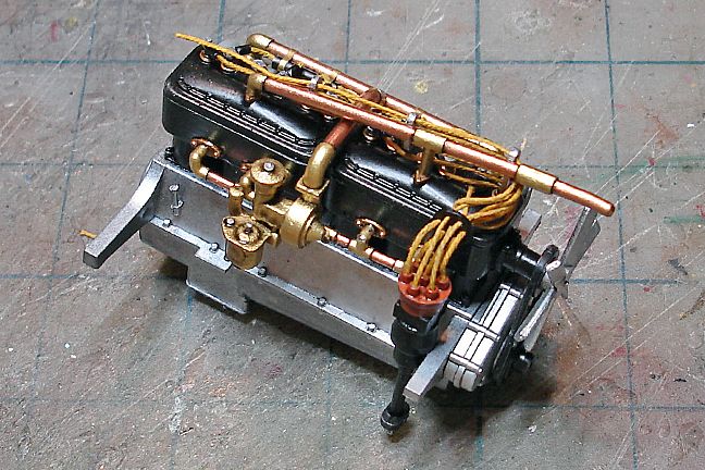

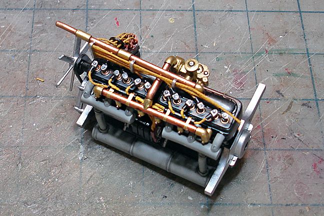

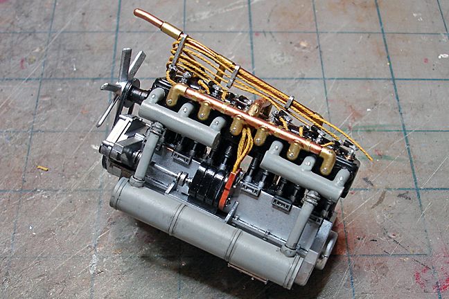

Harry P. Posted October 5, 2016 Author Share Posted October 5, 2016 Still adding engine details. But getting close to finished...I'd say I'm about 80% there at this point... The hardest part for me is working this small. Yes, the model is "large scale" (1/16), but some of those engine details are tiny. I scratchbuilt the wiring looms on the exhaust side of the engine, and the one just above the distributor... they aren't included in the kit. The ignition wires are painted heavy thread to simulate the cloth-covered ignition wires seen on cars of the era. Quote Link to comment Share on other sites More sharing options...

gtx6970 Posted October 6, 2016 Share Posted October 6, 2016 (edited) Does it have both a Magneto and a distributor ? I did some work on an early 30s General Monarch Firetruck a few years back that had the dual ignition. It had a BIG 6 cyl Buddha engine in it Edited October 6, 2016 by gtx6970 Quote Link to comment Share on other sites More sharing options...
Harry P. Posted October 6, 2016 Author Share Posted October 6, 2016 Does it have both a Magneto and a distributor ?Yes. Quote Link to comment Share on other sites More sharing options...

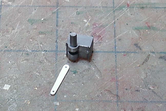

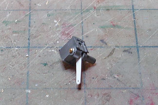

Harry P. Posted October 6, 2016 Author Share Posted October 6, 2016 Putting aside the engine for the moment... let's work on the steering box. Remember, I modified the front axle to allow for poseable wheels, so the steering box will also need to be modified in order for the Pitman arm to move. First step is to cut off the molded-in arm and using a razor saw and sharp X-acto, cutting a slot into the bottom of the steering box... Next, a new arm needs to be made of sheet styrene and drilled on both ends... Finally, I drilled a hole through the steering box and used a brass pin as a pivot for the Pitman arm. A drop of CA on the head of the brass pin holds it in place. Now all I need to do is paint the completed steering box steel and install on the frame rail. Quote Link to comment Share on other sites More sharing options...

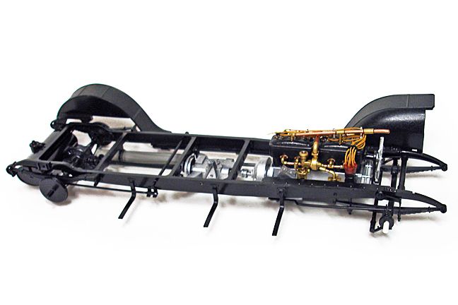

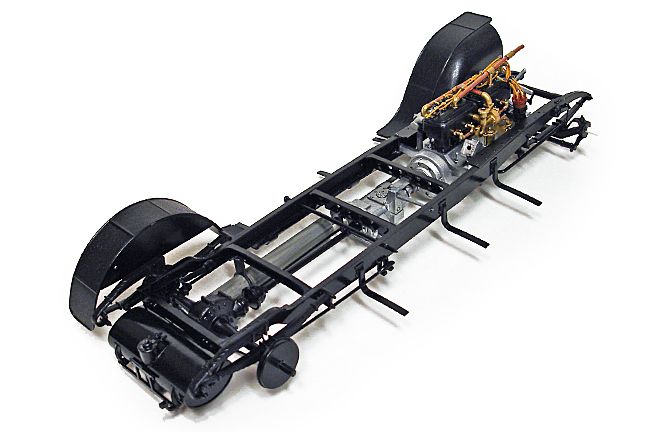

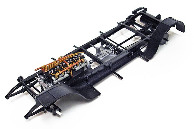

Harry P. Posted October 9, 2016 Author Share Posted October 9, 2016 Lots of progress since my last post. The chassis is very nicely detailed and went together without a hitch except for the driveshaft, which was about 1/8" too short. A bit of styrene solved that problem; otherwise everything else fit very well. The chassis has lots of little separate detail parts... just the way I like it! The front axle stubs are white because I had modified the axle to allow for poseable steering... so I had to remove the molded-in stubs and replace them with styrene rod... remember? The fenders have some sort of "leather" like texture molded into them... I guess the real car had some sort of leather or fabric-covered fenders? Strange. But the texture is definitely there and not a mistake. Quote Link to comment Share on other sites More sharing options...

sjordan2 Posted October 9, 2016 Share Posted October 9, 2016 The Sotheby's website says the rear fenders were made of flexible patent leather so that loading the balloon basket wouldn't cause damage. Quote Link to comment Share on other sites More sharing options...
Harry P. Posted October 9, 2016 Author Share Posted October 9, 2016 Unfortunately, the kit's front fenders also have this molded-in texture, which is probably incorrect (front fenders would have been steel). But I'm too lazy to fix it... going to live with it as is. Quote Link to comment Share on other sites More sharing options...
sjordan2 Posted October 9, 2016 Share Posted October 9, 2016 Unfortunately, the kit's front fenders also have this molded-in texture, which is probably incorrect (front fenders would have been steel). But I'm too lazy to fix it... going to live with it as is.In either case, I would assume that, as patent leather, the fenders would be somewhat shiny though not glossy, as seen on the recreation at the Sotheby's site. Quote Link to comment Share on other sites More sharing options...

Ace-Garageguy Posted October 13, 2016 Share Posted October 13, 2016 (edited) You're doing your usual beautiful job of bringing plastic to life with all your added detail and textures. Glad to see you building, and I hope we'll be seeing your inspiring work for many years to come. The painted thread to represent old fabric-covered wires is sheer genius. Edited October 13, 2016 by Ace-Garageguy Quote Link to comment Share on other sites More sharing options...

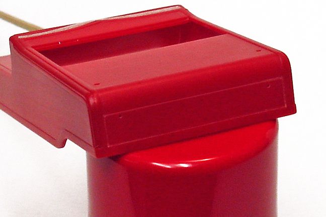

Harry P. Posted October 13, 2016 Author Share Posted October 13, 2016 Skipping around here and there... holes had to be laid out and drilled for some missing rear deck details. It's kind of hard to see, but I also had to scribe in some missing panel lines... Quote Link to comment Share on other sites More sharing options...

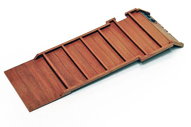

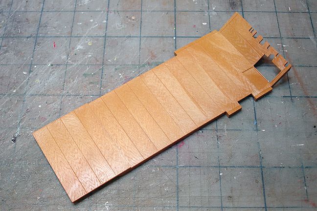

Harry P. Posted October 13, 2016 Author Share Posted October 13, 2016 Ordinarily I would replaced the kit's plastic floorboards with real wood, but in this case the floorboards are molded in a fairly convincing "wood" color, so I thought I'd try to work with the kit piece and see what I can do to improve it... I stained the piece, added a black wash to bring out the joint lines, and finally gave it all a coat of matte clear. The finished product looks passable as "wood," and was much easier than scratchbuilding a new frame and floorboards of real wood. Quote Link to comment Share on other sites More sharing options...
CrazyCrank Posted October 13, 2016 Share Posted October 13, 2016 (edited) Looks like real old weathered wood...superb ! Edited October 13, 2016 by CrazyCrank Quote Link to comment Share on other sites More sharing options...
