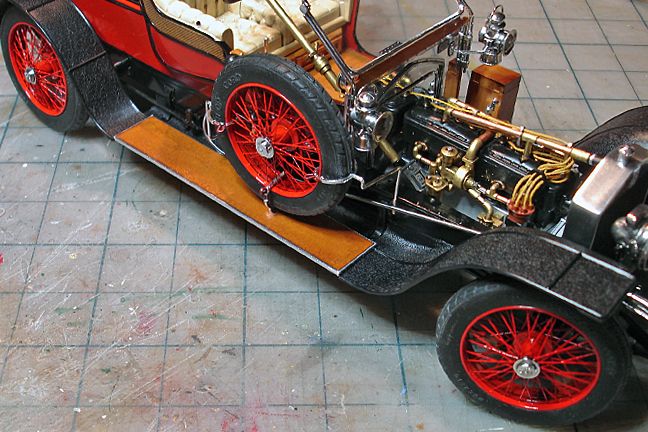

Harry P. Posted October 21, 2016 Author Posted October 21, 2016 I stained the running boards, trimmed the edges with BMF, then gave them a black wash to tone them down a little...

Harry P. Posted October 25, 2016 Author Posted October 25, 2016 I decided to go with red wheels instead of black. I think they give the car a sportier look...

blunc Posted October 25, 2016 Posted October 25, 2016 painting the wheels red was a great choice, in addition to the "sportier look", it draws the eyes to the excellent work you put into these wheels.

sjordan2 Posted October 25, 2016 Posted October 25, 2016 Red wires are definitely the best choice. Did you primer them?
Harry P. Posted October 25, 2016 Author Posted October 25, 2016 Red wires are definitely the best choice. Did you primer them?No.
