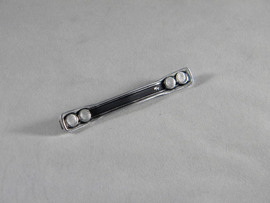

Can-Con Posted October 9, 2016 Posted October 9, 2016 (edited) I put a little clear blue wash on the bottom and a little clear smoke wash on the top. Makes li kinda look like the natural reflection in the light. ,, but even with a replated part, drilling out and replacement with something better is best. If you're worried about ruining your grille. just start with a small hole in the center of the light and carefully make it bigger with a sharp x-acto and needle files. That's how I always do it. This is the original kit plating on this grille, not replated after drilling out the lights. If you're careful, it's not that difficult and nothing is damaged. Edited October 9, 2016 by Can-Con

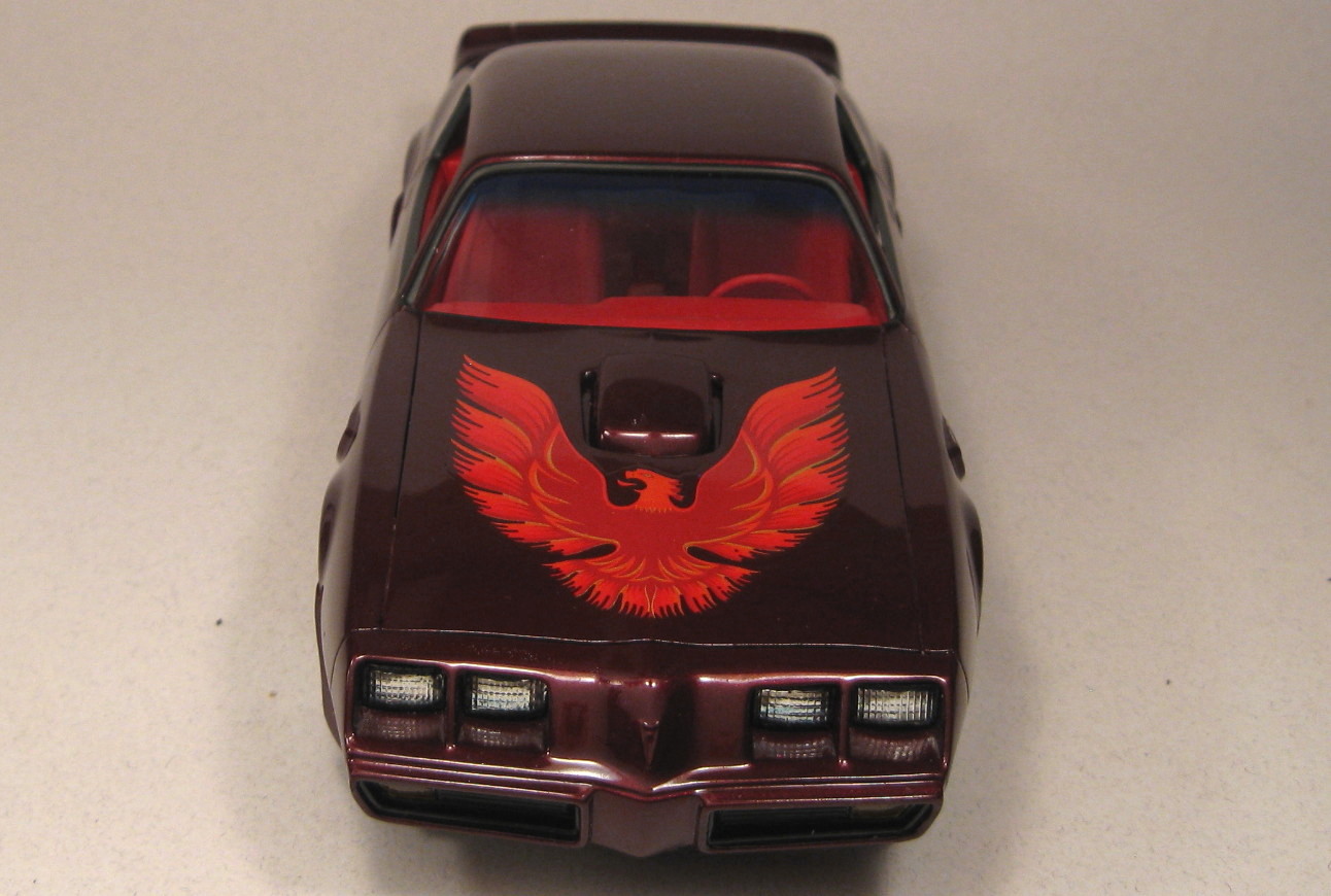

Intmd8r Posted October 11, 2016 Posted October 11, 2016 Lots of good suggestions here, although I never had any sort of success with the Testors clear cement/window maker. Lately I've been using Microscale Kristal Klear. Its better than nothing, but not quite as good as the lenses sold by Scale Productions. Literally just apply a drop on top of the molded headlight lenses as needed with a toothpick and watch it dry. No further effort needed. I have a sneaky suspicion that this stuff is just a rebottled container of Elmer's school glue! The M.V. Products Head Lamps plus sold by Detail Master work well too, and seem to be a cheaper alternative to the Scale Productions products, sold at $4.50Eur . Must say, Can-Con looks to have the technique mastered! This one was build with the M.V. lenses: This one was build with Krystal Klear over the molded lenses: (unfortunately the Krystal Klear wasn't totally dired when I took this pic) -Steve

peteski Posted October 12, 2016 Posted October 12, 2016 (edited) On 10/11/2016 at 7:06 PM, Intmd8r said: This one was build with the M.V. lenses: This one was build with Krystal Klear over the molded lenses: (unfortunately the Krystal Klear wasn't totally dired when I took this pic) -Steve The MV lenses have very realistic looking reflectors, but the smooth lenses don't look realistic. Headlamp lenses (used in the standard U.S. specs headlamps) have optical facets molded in the glass. Lack of that detail really kills the realism. I've scribed the facets into the MV lenses in the past but it is a tedious process which (since it is done freehand) is not perfect. Speaking of the headlight lens optics (facets), I see lots of modelers not paying attention to how those facets line up. In real cars the headlamp unit is keyed to only fit in the headlamp holder one way. That is because the headlamp optics produce asymmetrical beam of light. If not installed properly the headlight could blind incoming cars, or not illuminate the road properly. The general rule is that the majority of the lines (facets) in the lens need to be perpendicular to the road surface. If they are not the realism is lost again. The above model has the lines in the lenses not perpendicular to the road. It might look cool, but it is not realistic for a road vehicle. It doesn't take any extra time or effort to properly position the kit-supplied lenses, but it makes a big difference in realism. Edited October 12, 2016 by peteski
Intmd8r Posted October 12, 2016 Posted October 12, 2016 On 10/12/2016 at 5:08 AM, peteski said: The above model has the lines in the lenses not perpendicular to the road. It might look cool, but it is not realistic for a road vehicle.It doesn't take any extra time or effort to properly position the kit-supplied lenses, but it makes a big difference in realism.Before anyone gets too critical, the red car I showed was done that way by design for the Rat Rod CBP.It was never intended to look like a concourse restoration. You're probably the first to notice that detail.Anyways........ M..V lenses are just fine for a shelf model that most of us build for fun. I use Krystal Klear over the moulded headlights so the facet detail is not lost. This style of headlight is one of the worst things a kit manufacturer could do to us builders.
