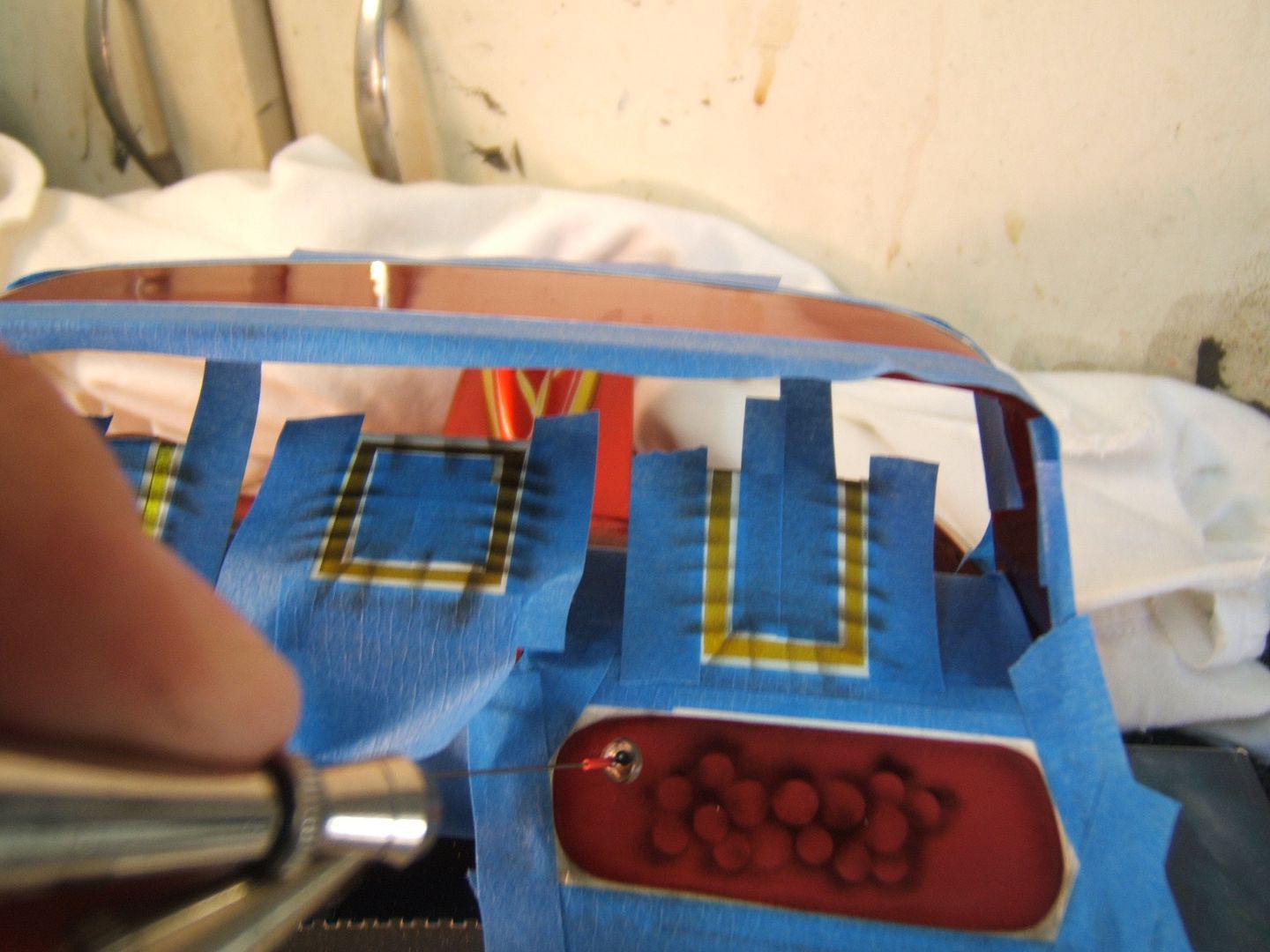

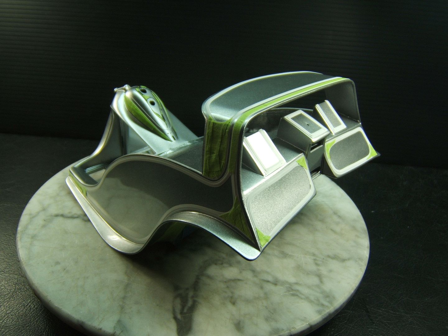

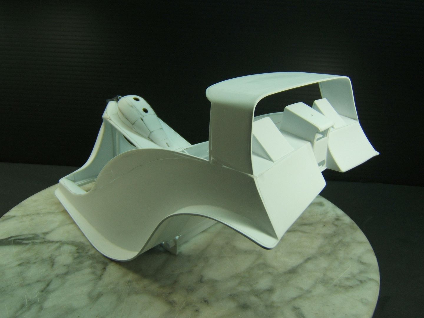

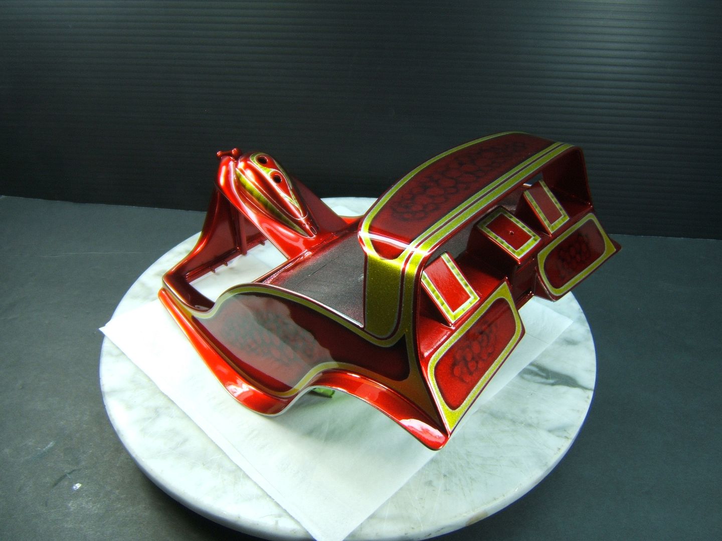

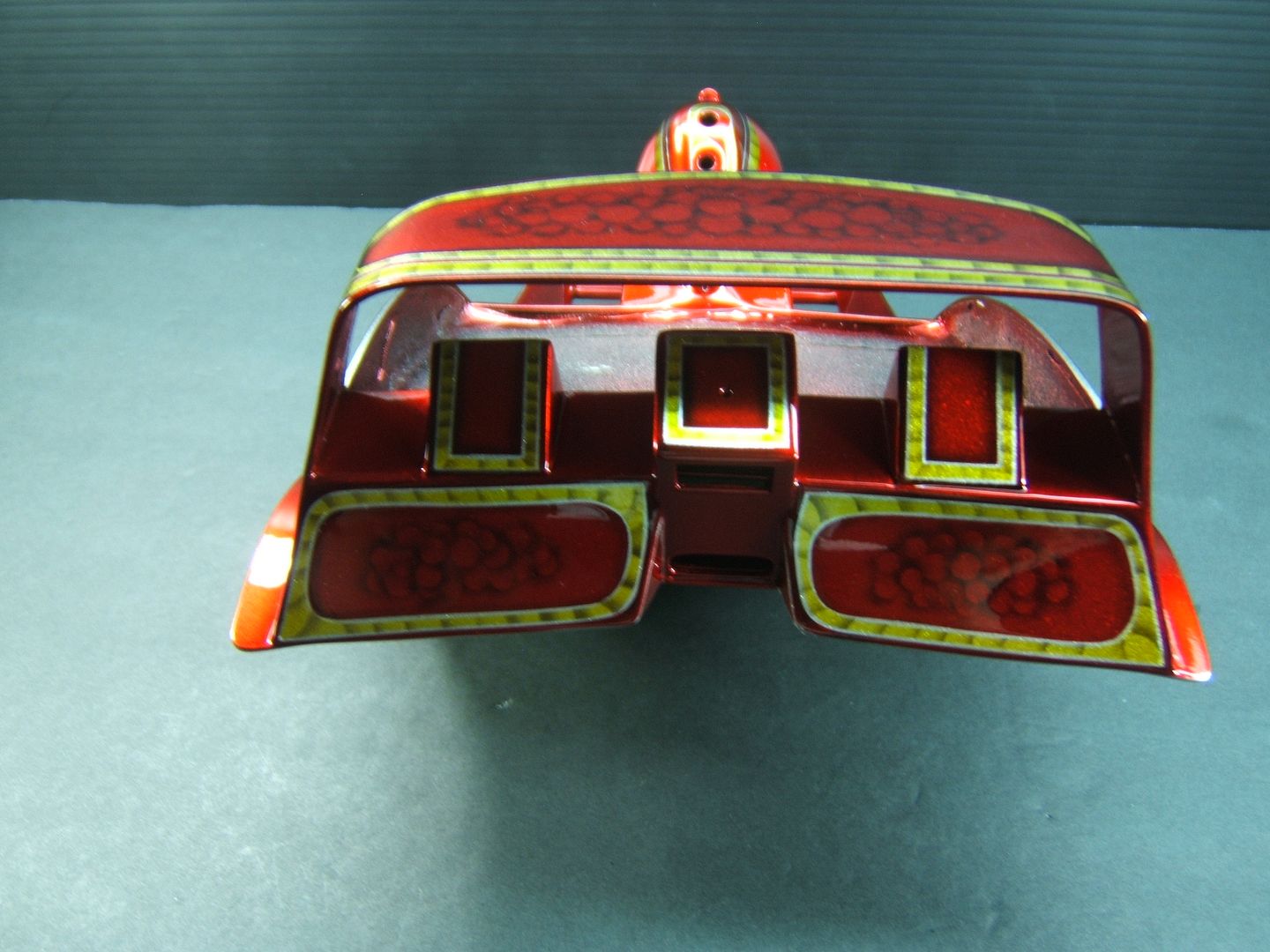

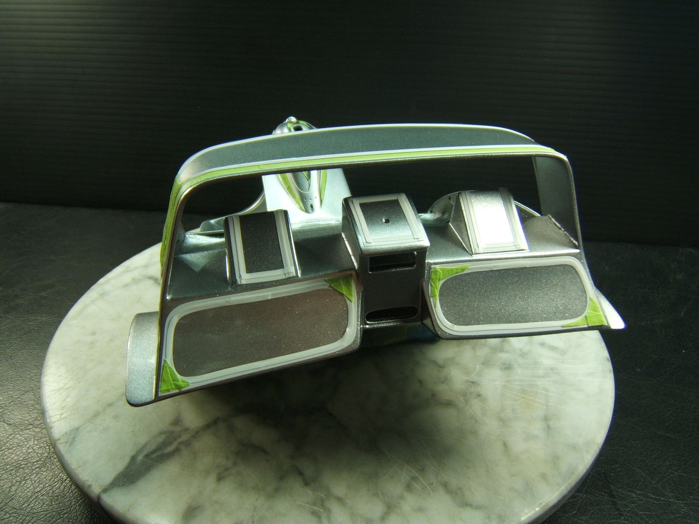

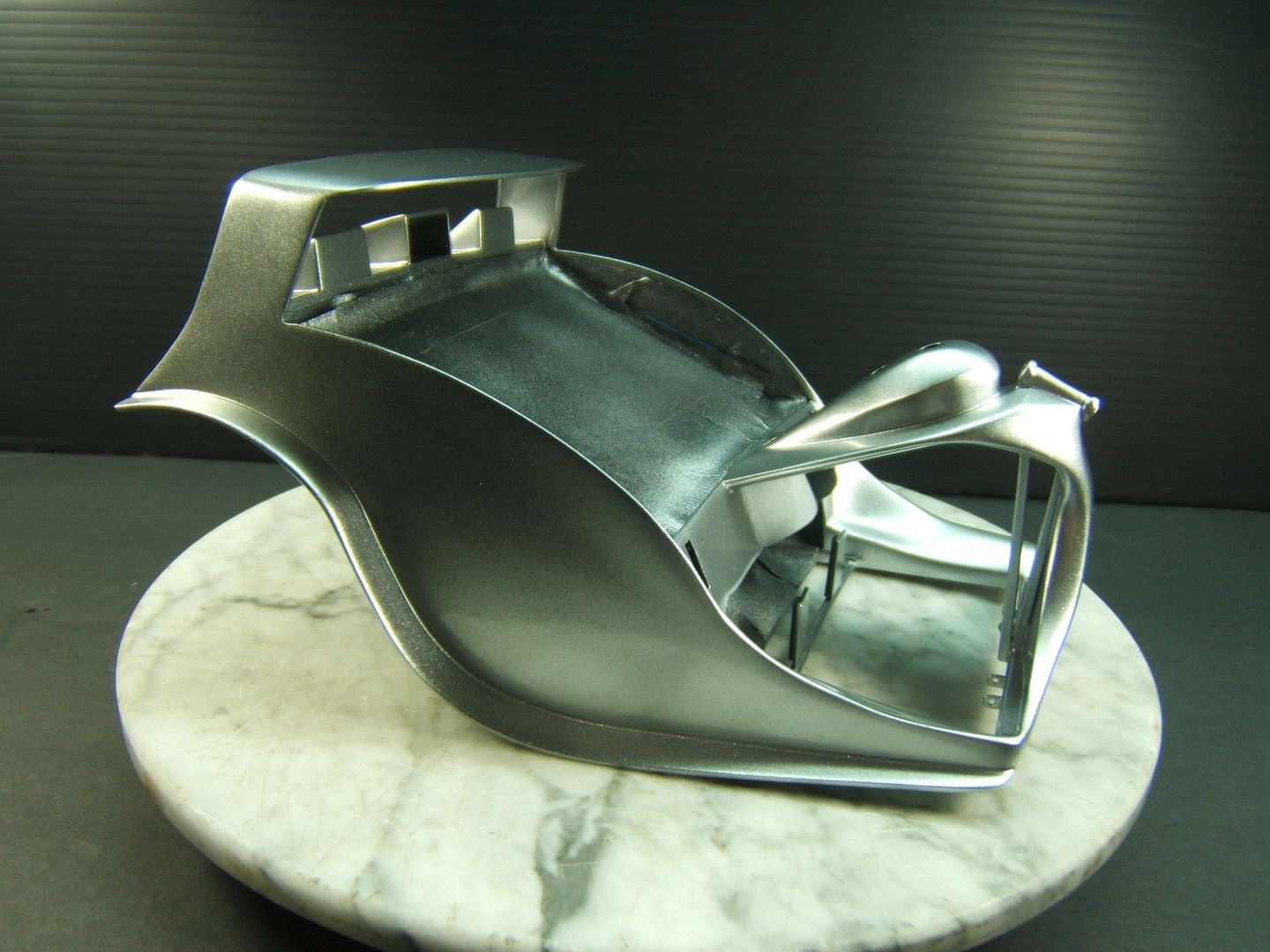

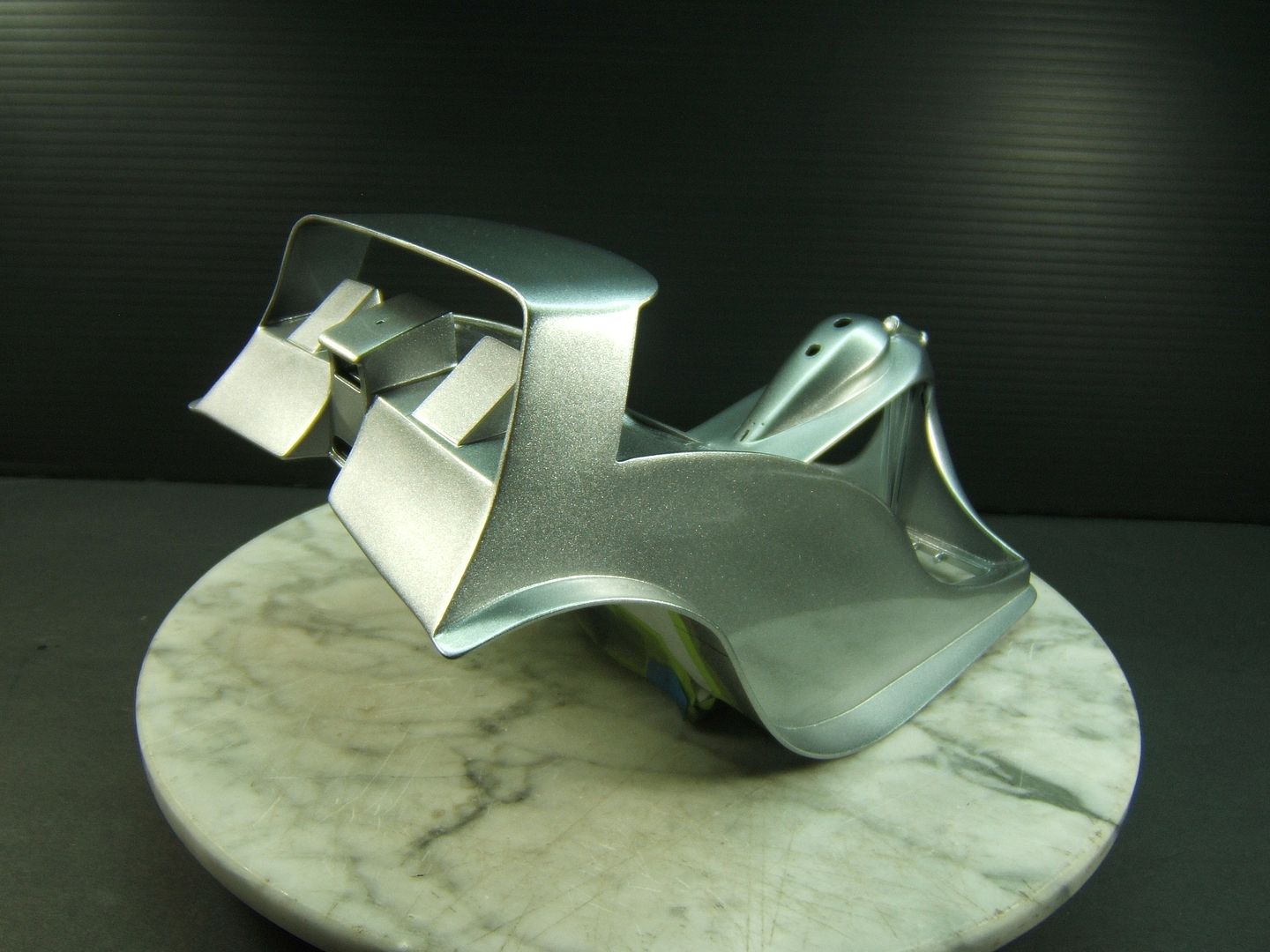

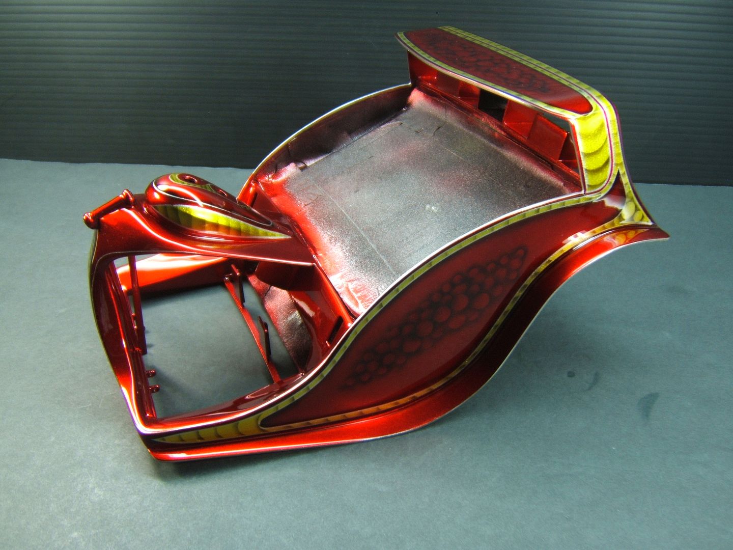

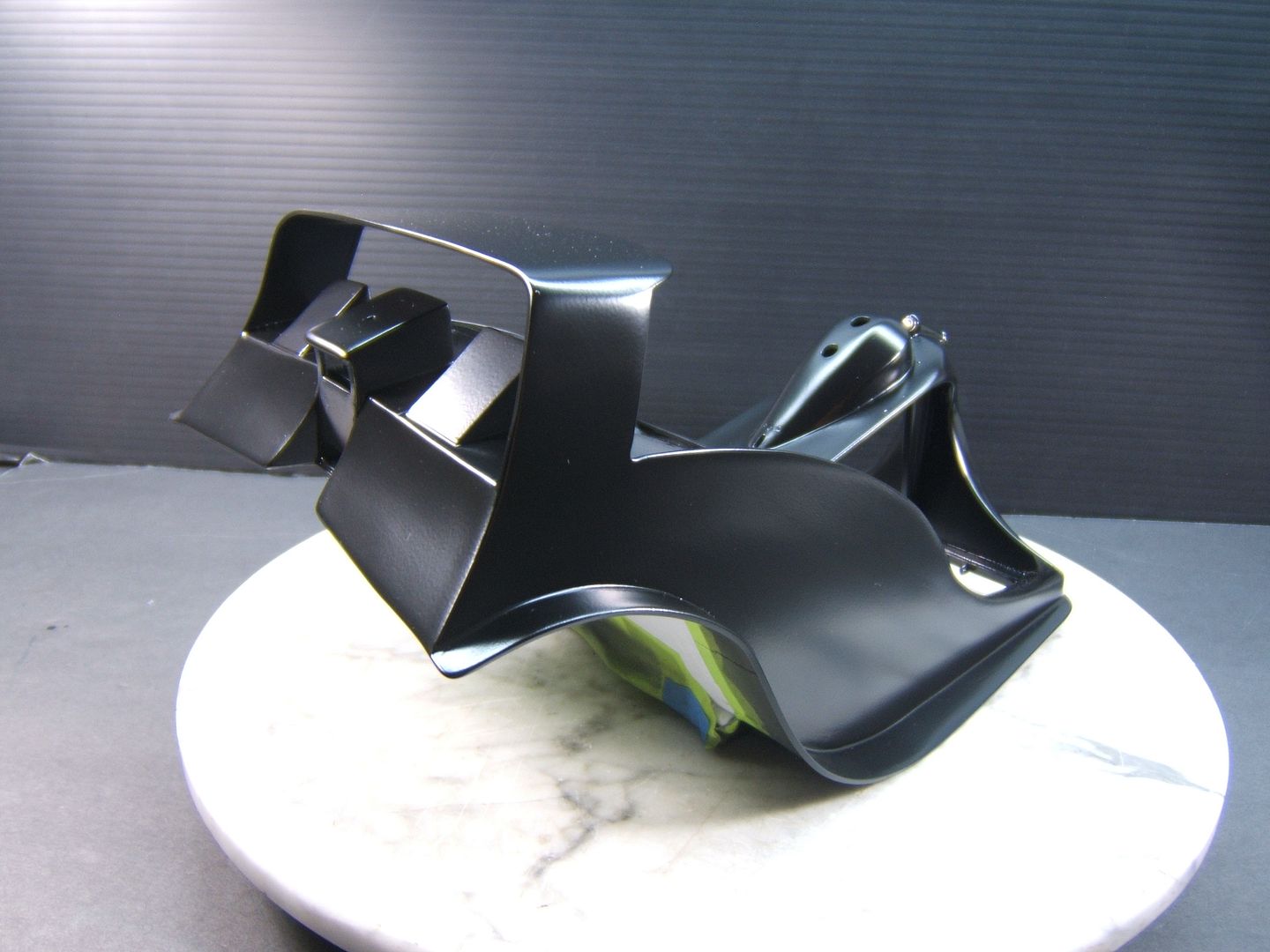

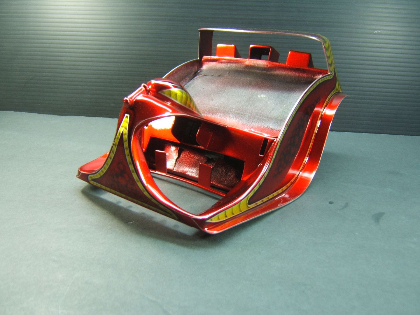

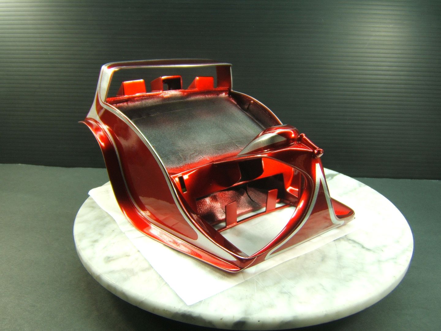

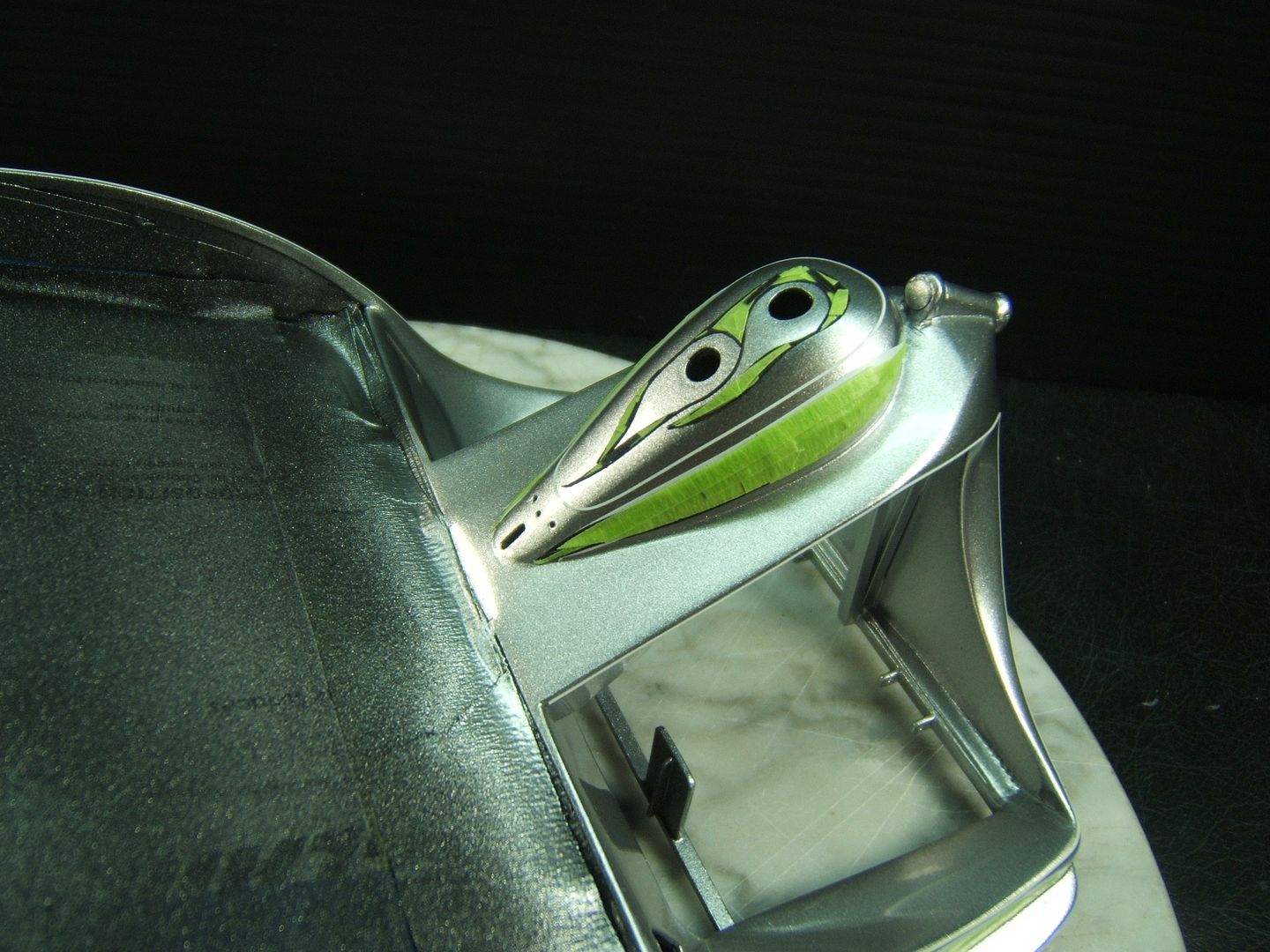

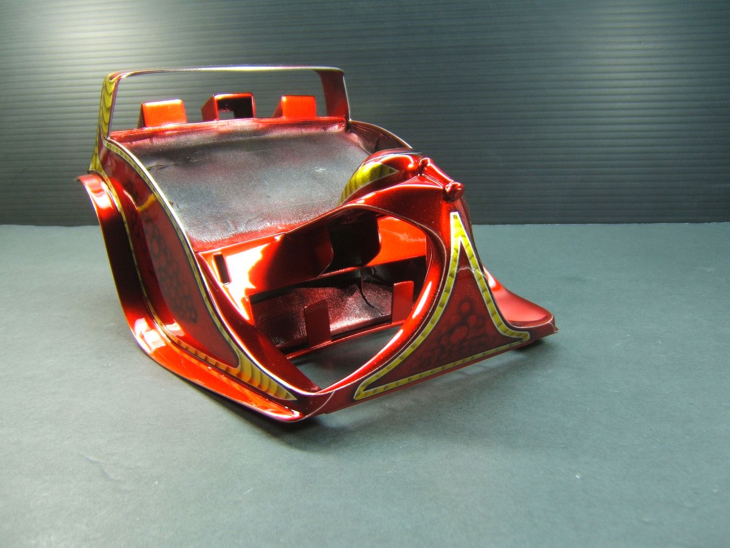

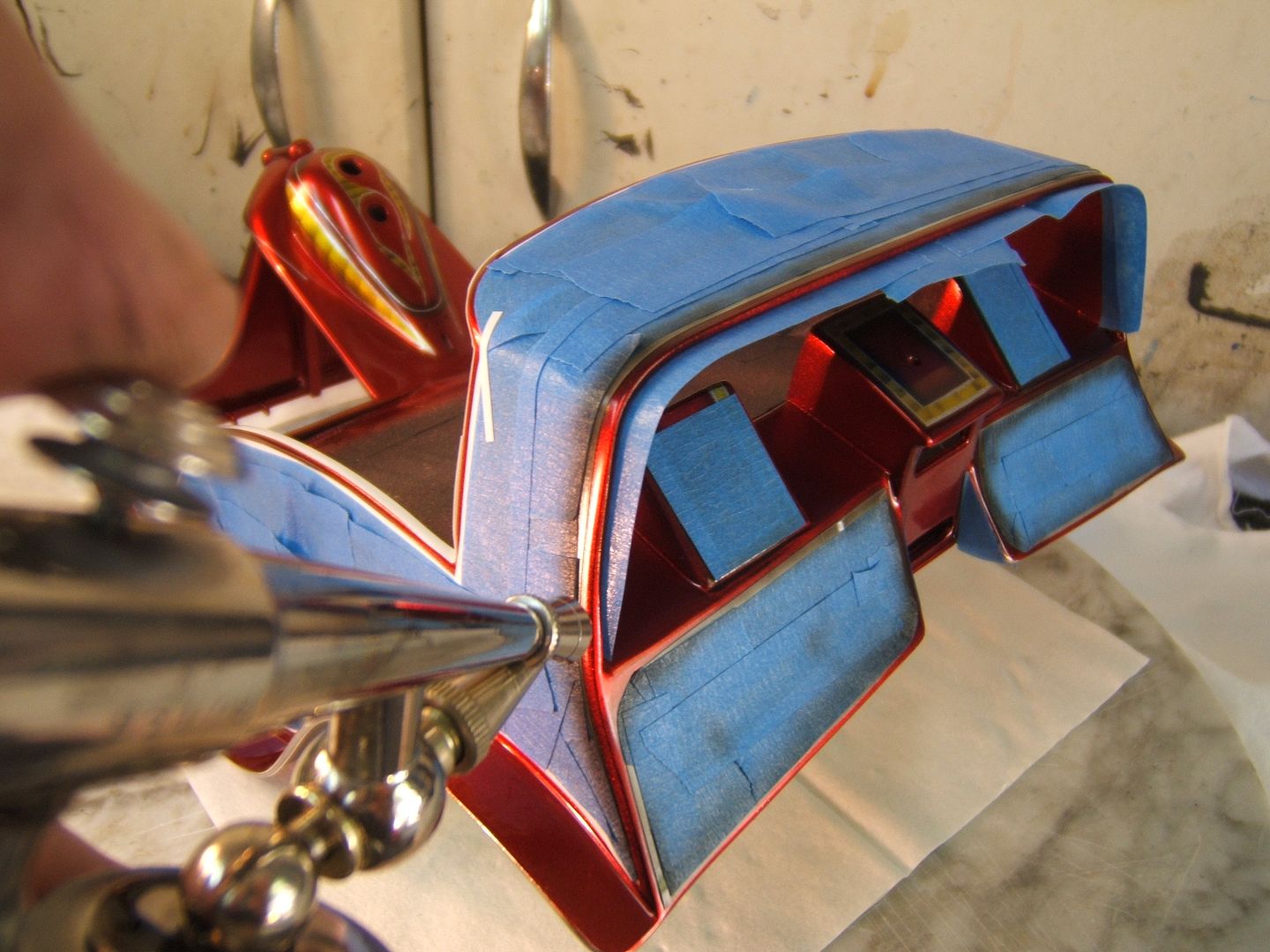

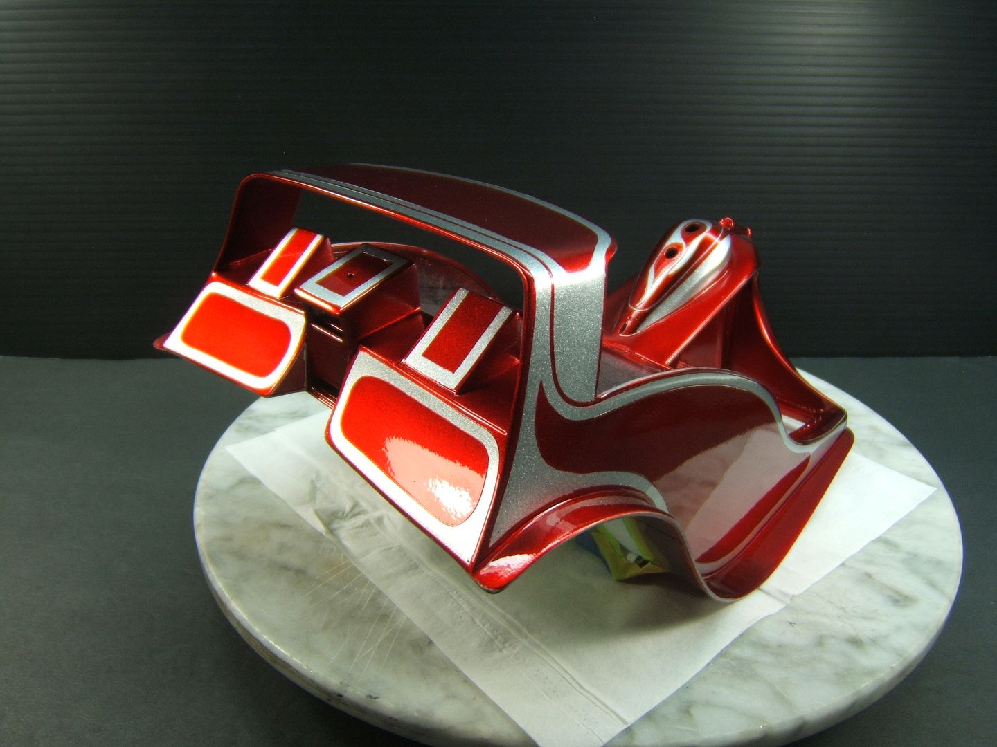

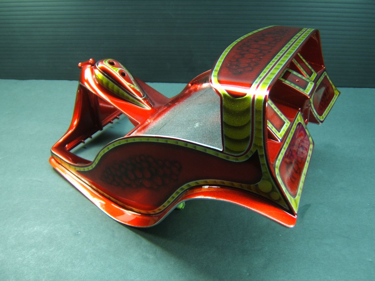

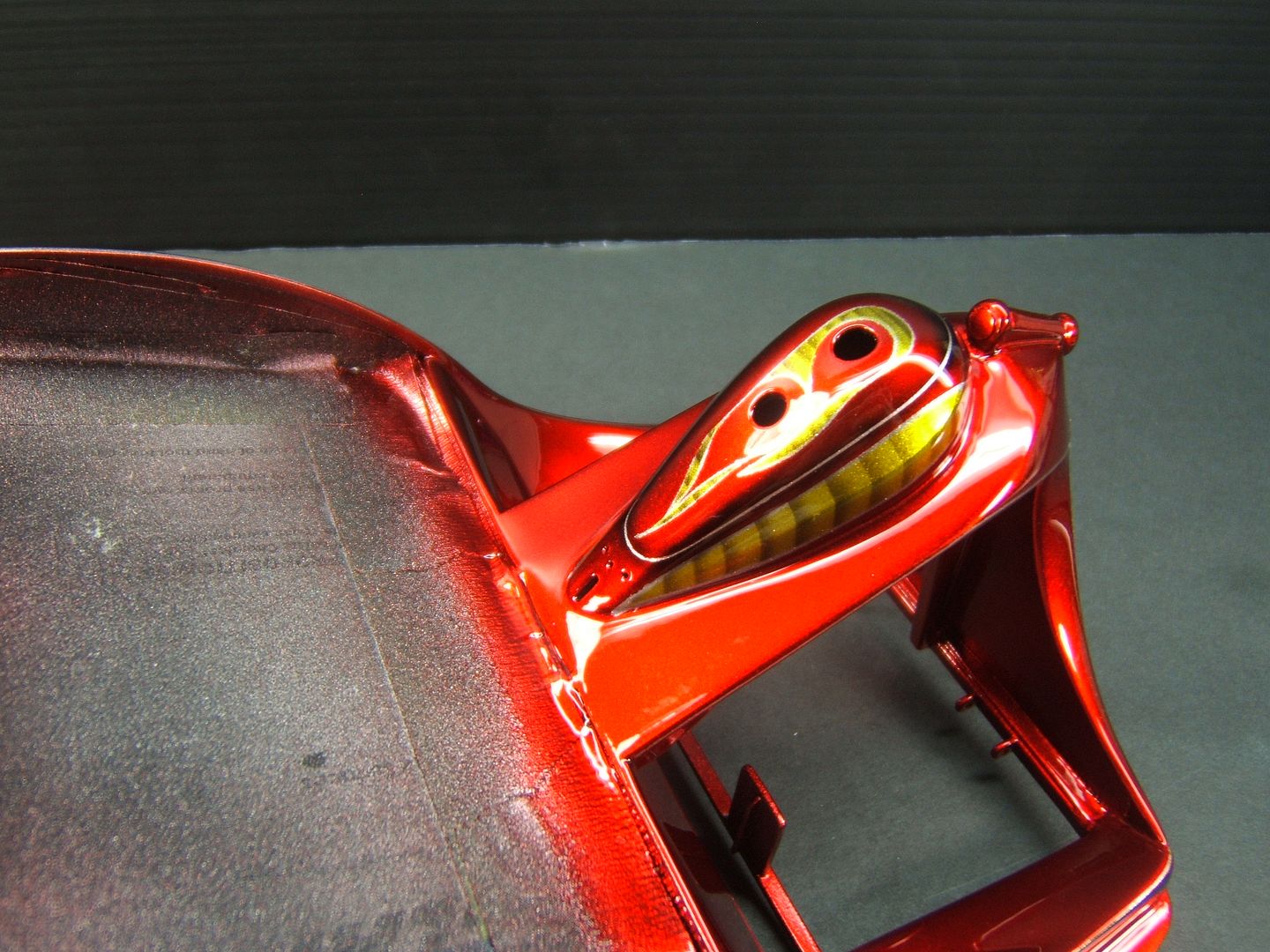

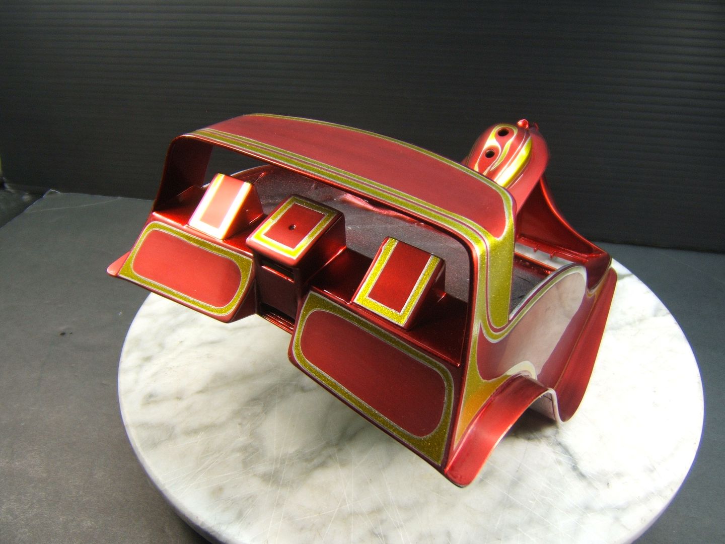

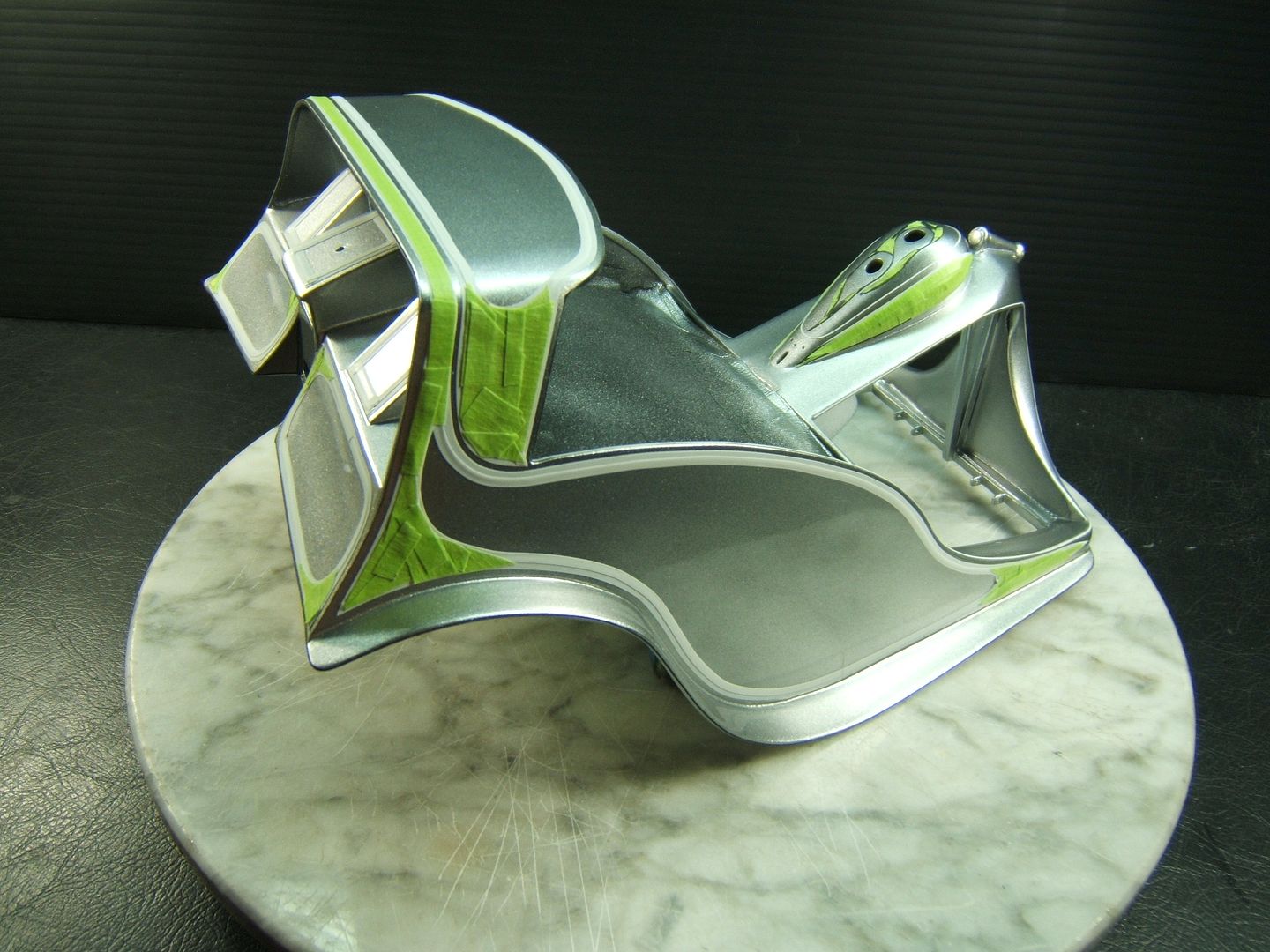

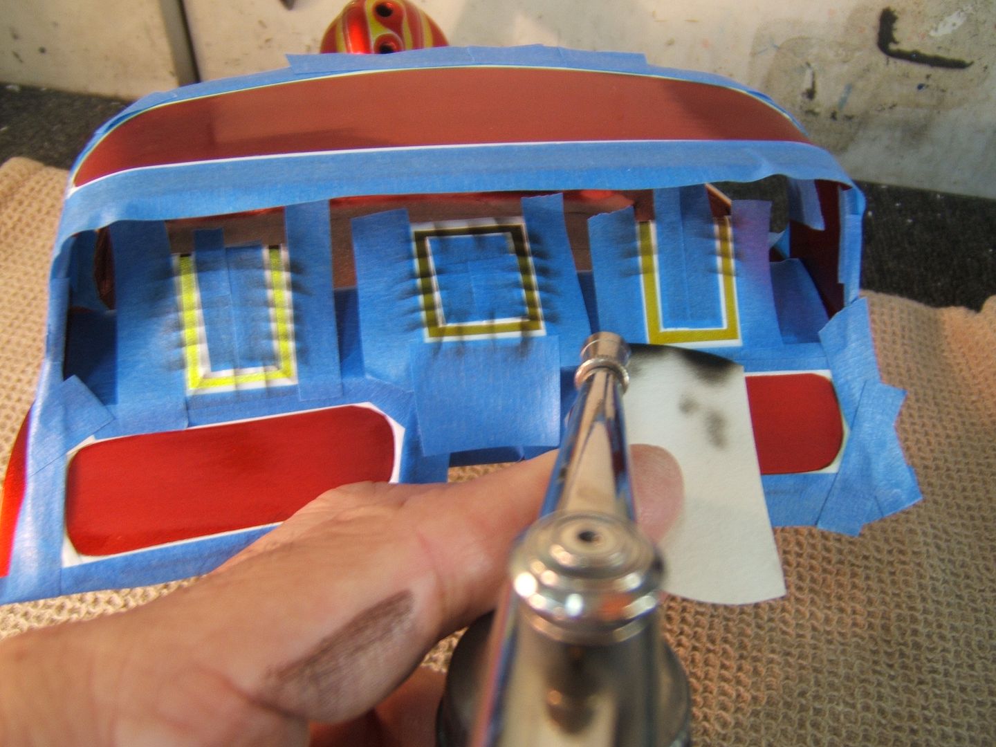

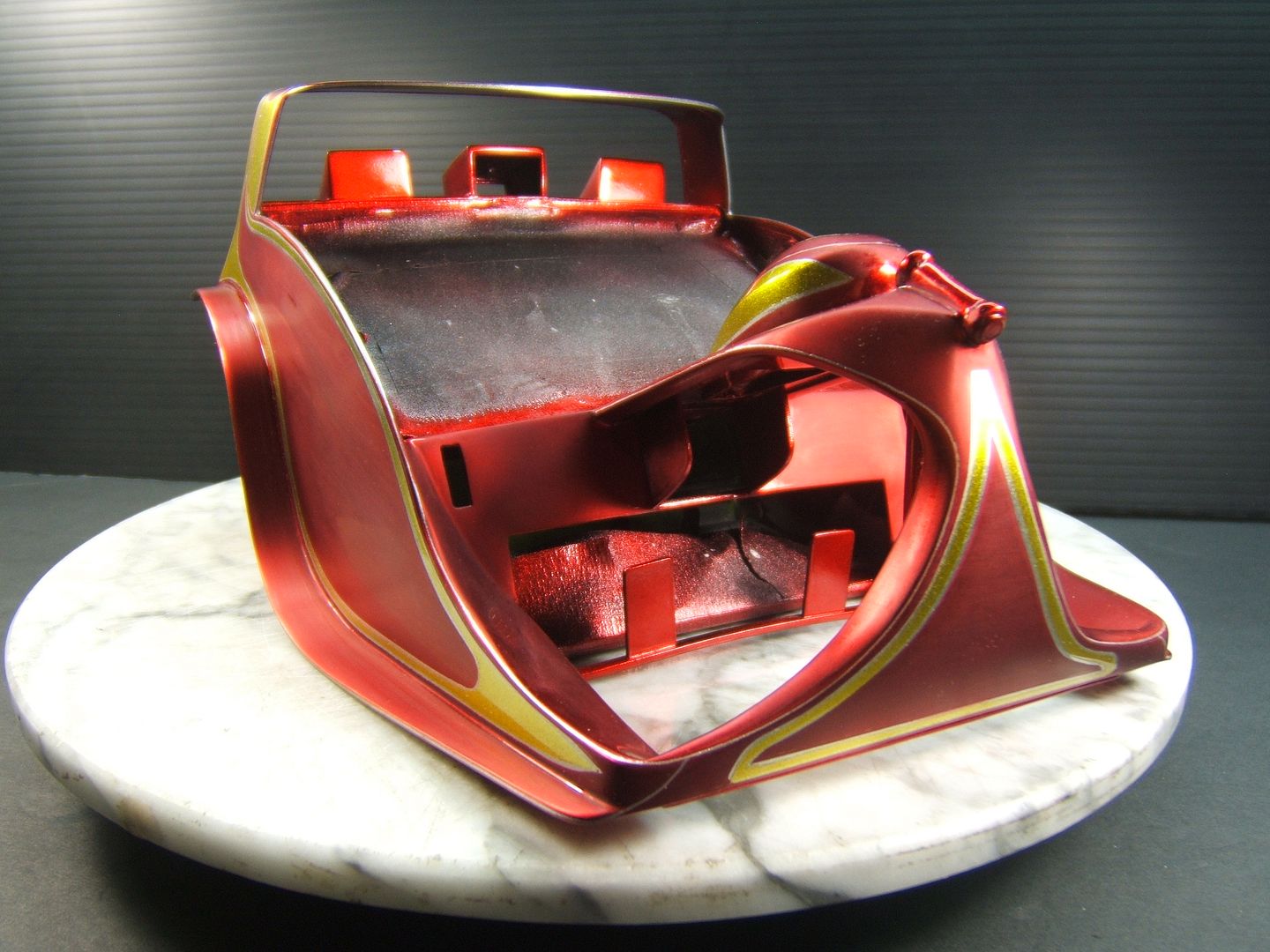

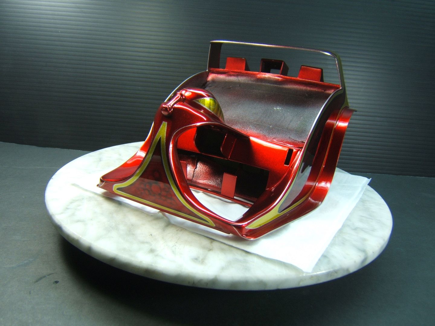

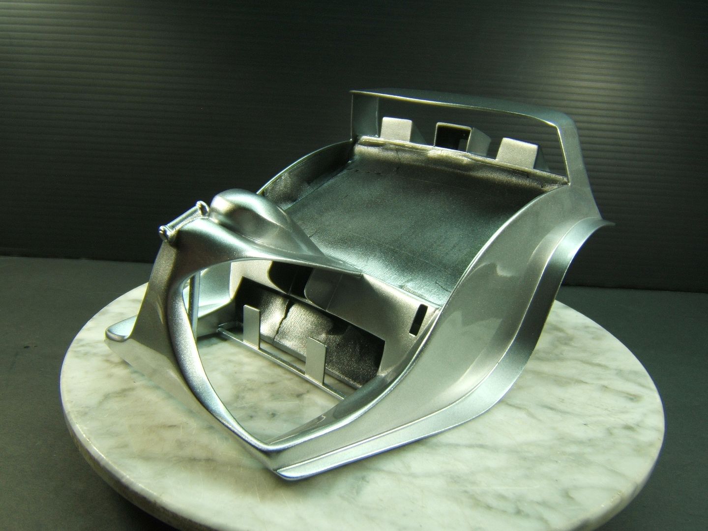

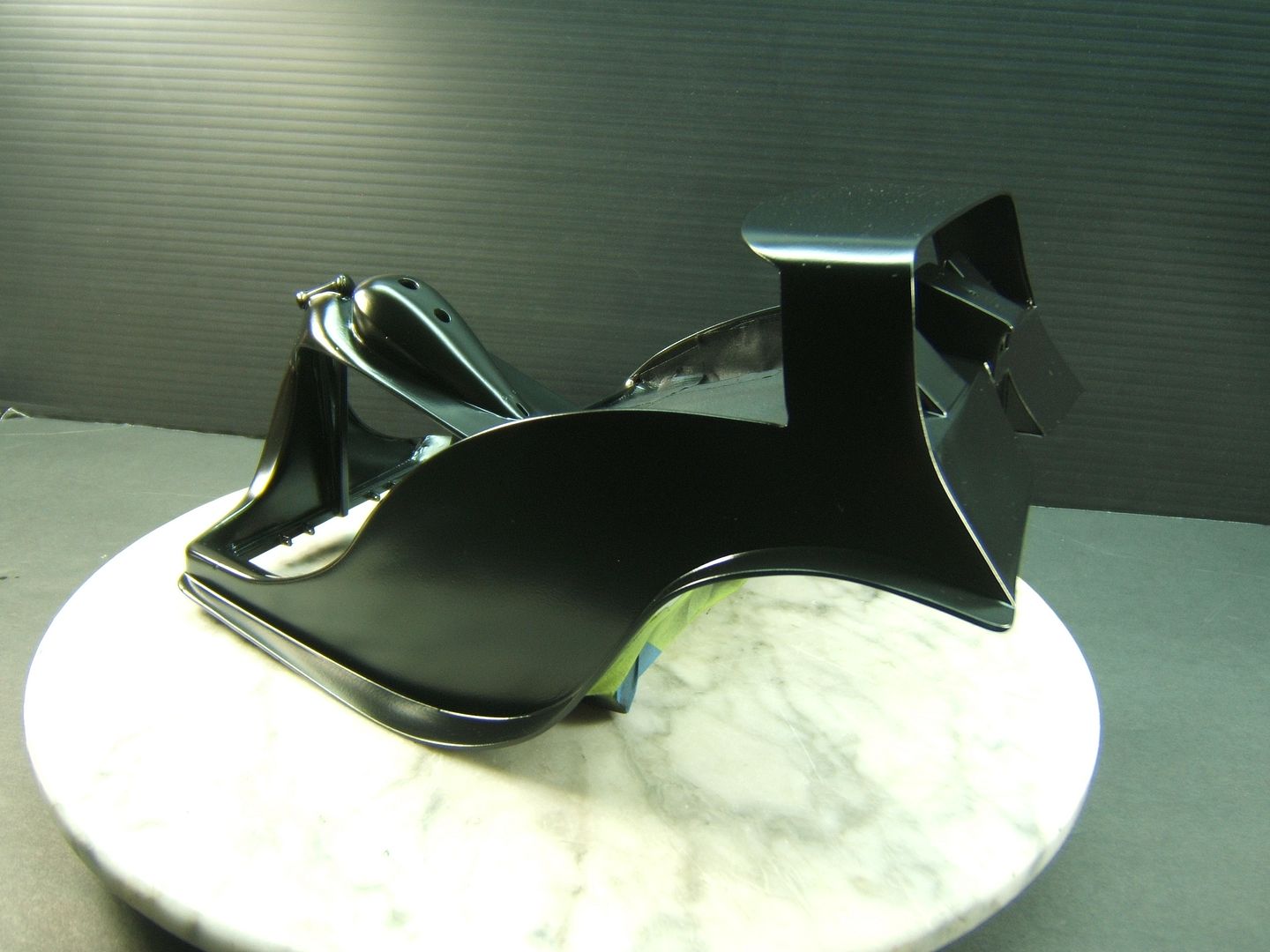

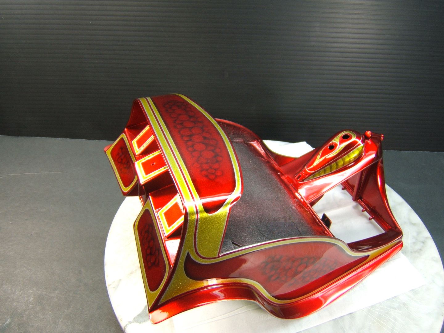

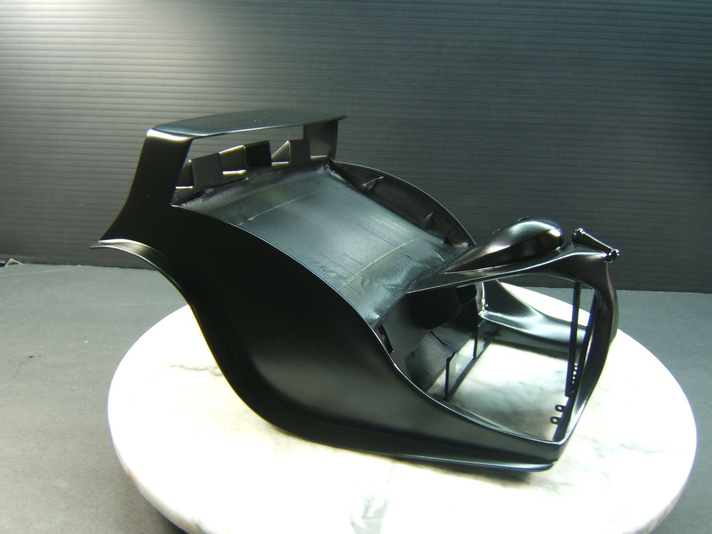

Hello......thank you all so very much for the kind comments and for the interest in this build.....I really do appreciate it:).......Sorry I have`nt posted in a while.......I have been very busy working on and painting the body......it`s almost done.....I just need to wet sand and give one last clear coat.......I scratch built the body.......primered and puttied .......I gave a base coat of H.O.K. Shimmering  Silver......I taped off the graphics for the H.O.K. Pagan gold......I painted the main portion of the body H.O.K. Kandy Apple Red.......then I taped off and painted the H.O.K. Pagan Gold.......then I taped off and airbrushed the graphics a couple of times with H.O.K. Black.......I clear coated in between colors ......then taped off one last time to fog around the edges with H.O.K. Black......... I`m just about ready to add the engines and drive train......thanks for looking
John... It is so great to see this thing in paint. I know you have put in a bunch of hard work into this and it sure has paid off. This this looks sweet. Now I can't wait to see it all together. Keep up the great work!!

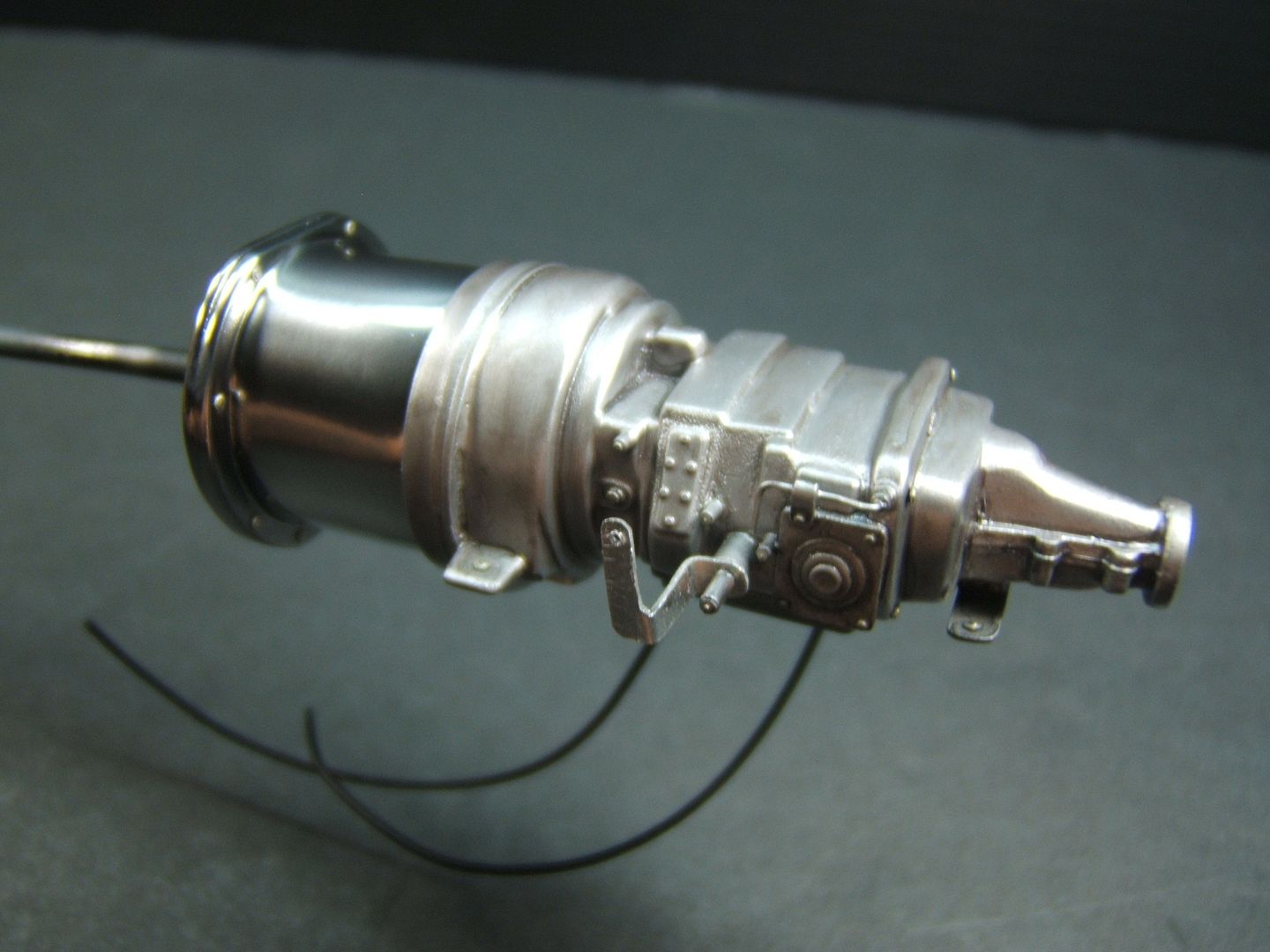

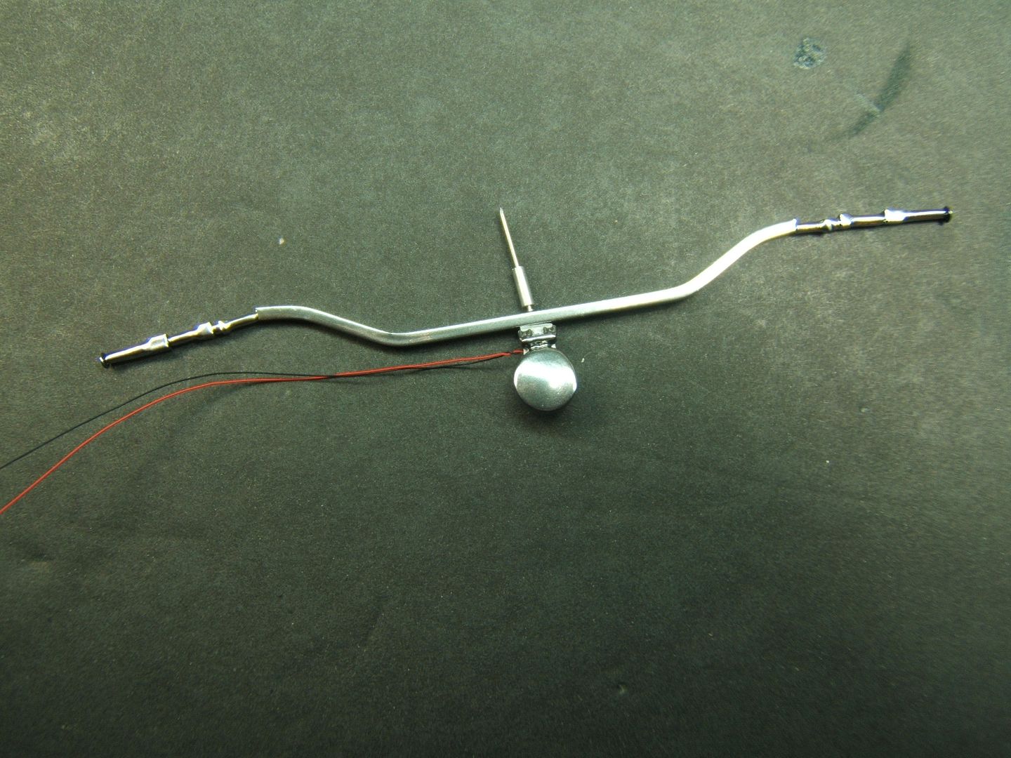

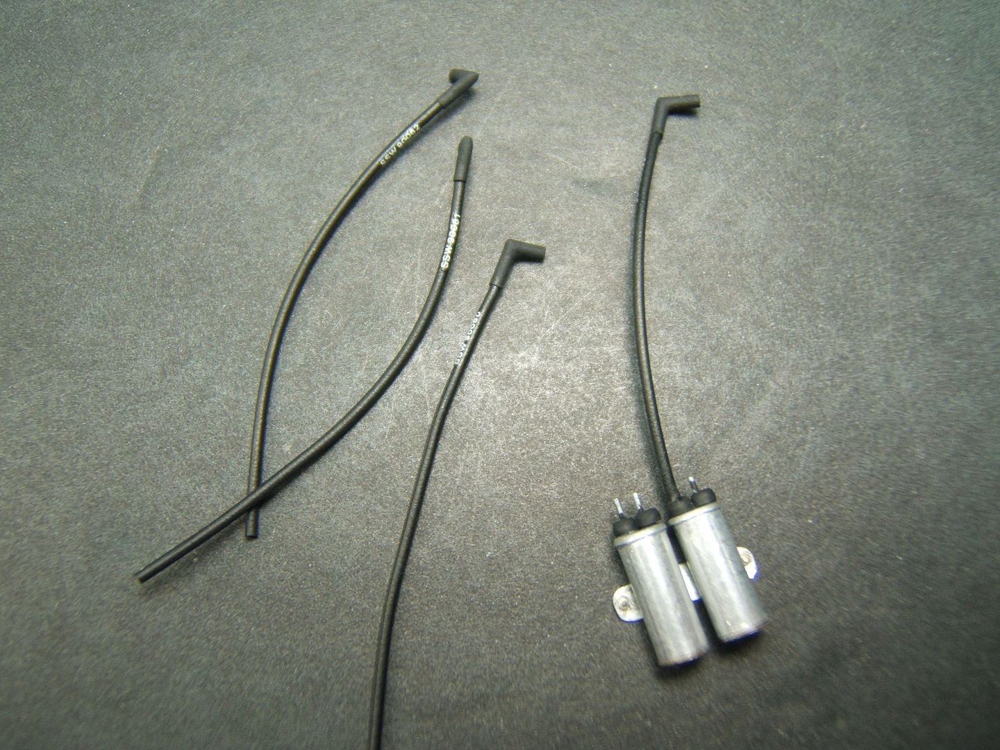

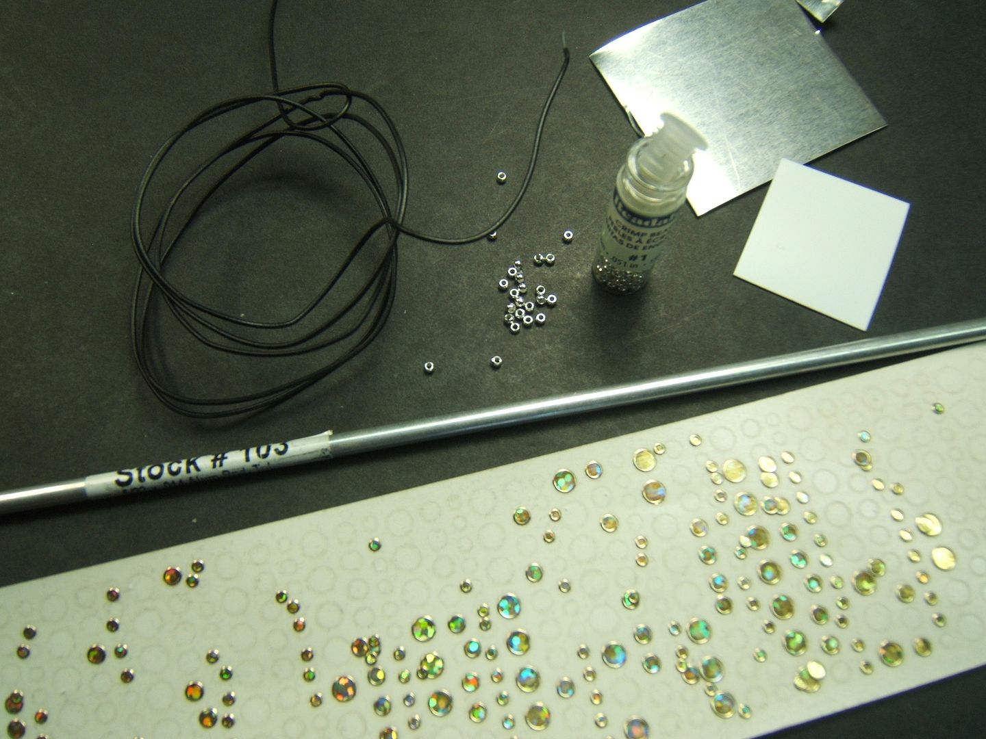

Hello......thank you all so very much for the kind comments......I really do appreciate them:)......I made a oil tank and painted it Alclad and got that installed .......I made dual coils and plug boots.......and attached one of the engines to the body......I also made the footpegs and a horn and got them installed .......I modified a Trans and painted it Alclad and silver and gave it a light wash and added "Pro Tech" nut and bolt ends.......I will attach the other engine tomorrow and the drive train.......thanks for looking.
