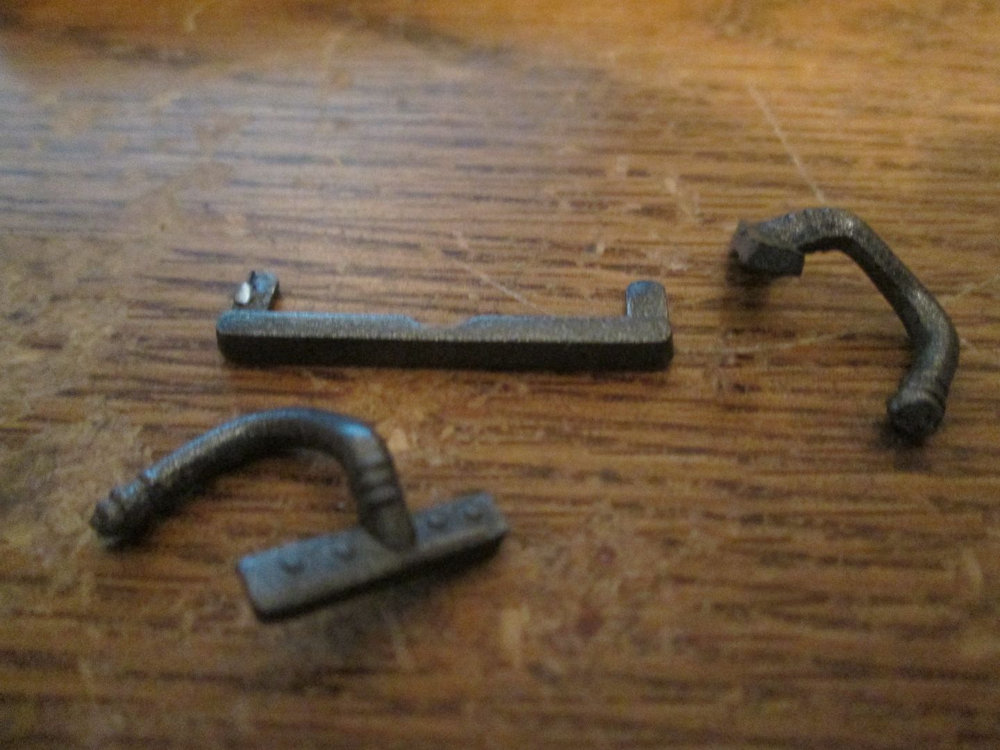

landman Posted November 6, 2016 Posted November 6, 2016 How would one go about reproducing the texture on the intakes parts here. They look like the wrinkle finish on some Ferrari engines and on some Hemi valve covers. real wrinkle paint is off scale. Perhaps

Harry P. Posted November 6, 2016 Posted November 6, 2016 In 1/25 scale, the wrinkle finish on the parts in the photo would be basically invisible.
landman Posted November 6, 2016 Author Posted November 6, 2016 Looking at it again, it could very well be a metallic instead of wrinkle. the "mottled" kind of metallic.

Snake45 Posted November 7, 2016 Posted November 7, 2016 I don't think it's wrinkle finish. Look at how that breather or whatever it is is reflected. I've never seen wrinkle paint do that. Has anyone else?I think it's black or a dark gray with a heavy "flake" type element to it, and pretty shiny, too.I think Testor has a black metalflake in their line that might give you the look you want.
Ace-Garageguy Posted November 7, 2016 Posted November 7, 2016 (edited) I don't think it's wrinkle finish. Look at how that breather or whatever it is is reflected. I've never seen wrinkle paint do that. Has anyone else? I think it's black or a dark gray with a heavy "flake" type element to it, and pretty shiny, too. I think Testor has a black metalflake in their line that might give you the look you want. I had exactly the same thoughts. It COULD be wrinkle-paint buried in clear. I've seen equally missing-the-whole-point "restoration" work done more than a few times. BUT...wrinkle paint in photos can actually look kinda like the original post too, appearing to be more reflective that it really is. It depends on your mind's interpretation of the image. Edited November 7, 2016 by Ace-Garageguy

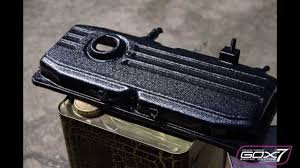

crazyjim Posted November 7, 2016 Posted November 7, 2016 That's NOT a wrinkle finish. I believe it's called a hammer finish and I've seen 1:1 rattle cans that will do that particular look.
Ace-Garageguy Posted November 7, 2016 Posted November 7, 2016 (edited) That's NOT a wrinkle finish. I believe it's called a hammer finish and I've seen 1:1 rattle cans that will do that particular look. I disagree (but I CAN be wrong). I use a lot of both products in my big-car work. A "hammered finish" is essentially a forced fisheye effect. It looks like this in full scale. NOTE: I TOOK THE ORIGINAL FULL-SIZED IMAGE DOWN. IT HAD DEGRADED AND NO LONGER LOOKED CORRECT. POSSIBLY SOME PROBLEM RELATED TO HOT-LINKING TO ANOTHER SITE. I'M LOOKING FOR A SUITABLE REPLACEMENT. HERE'S ONE. The appearance is somewhat similar but also quite different from wrinkle paint. Edited November 7, 2016 by Ace-Garageguy
