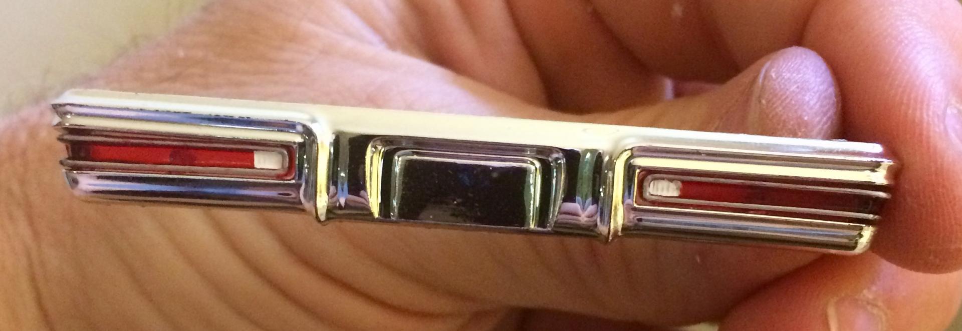

Can-Con Posted November 23, 2016 Posted November 23, 2016 OK, Here's a couple pics of the bumper from the '70 sitting on the '72 body. ,, looks OK to me. Not perfect, it is a touch wide but "OK". I did widen the bumper from the '72 and it's in the mail on it's way to the platers now as they were wider. As for the Reliable Resin piece, I just looked on his site and I don't think the back bumper comes with the body.
Kmb0319 Posted November 24, 2016 Author Posted November 24, 2016 Thanks so much for the pictorial evidence!! The bumper from that kit is a MUCH better fit. Looks like I'll be buying that one instead of the Reliable Resin body. I'm placing my order tonight for throttle springs, carb linkage, window crabs and other detail parts along with the Pontiac 421 kit. Looks like the parts are altered but the plan is back rolling! Thanks and Happy Thanksgiving everyone!!

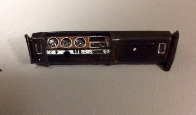

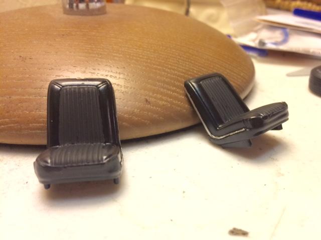

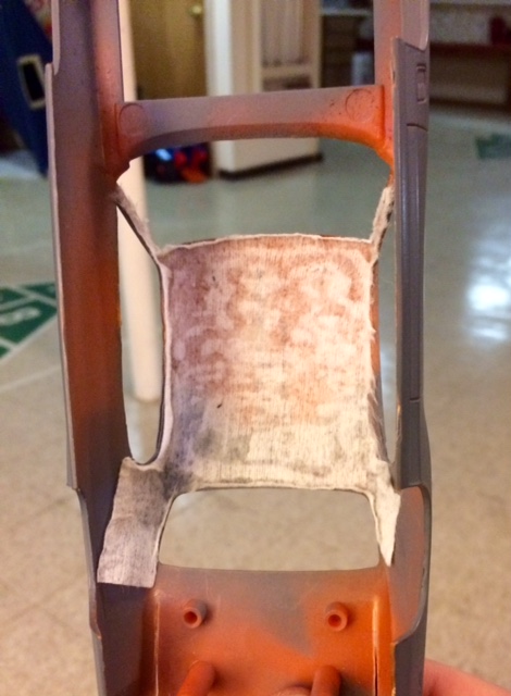

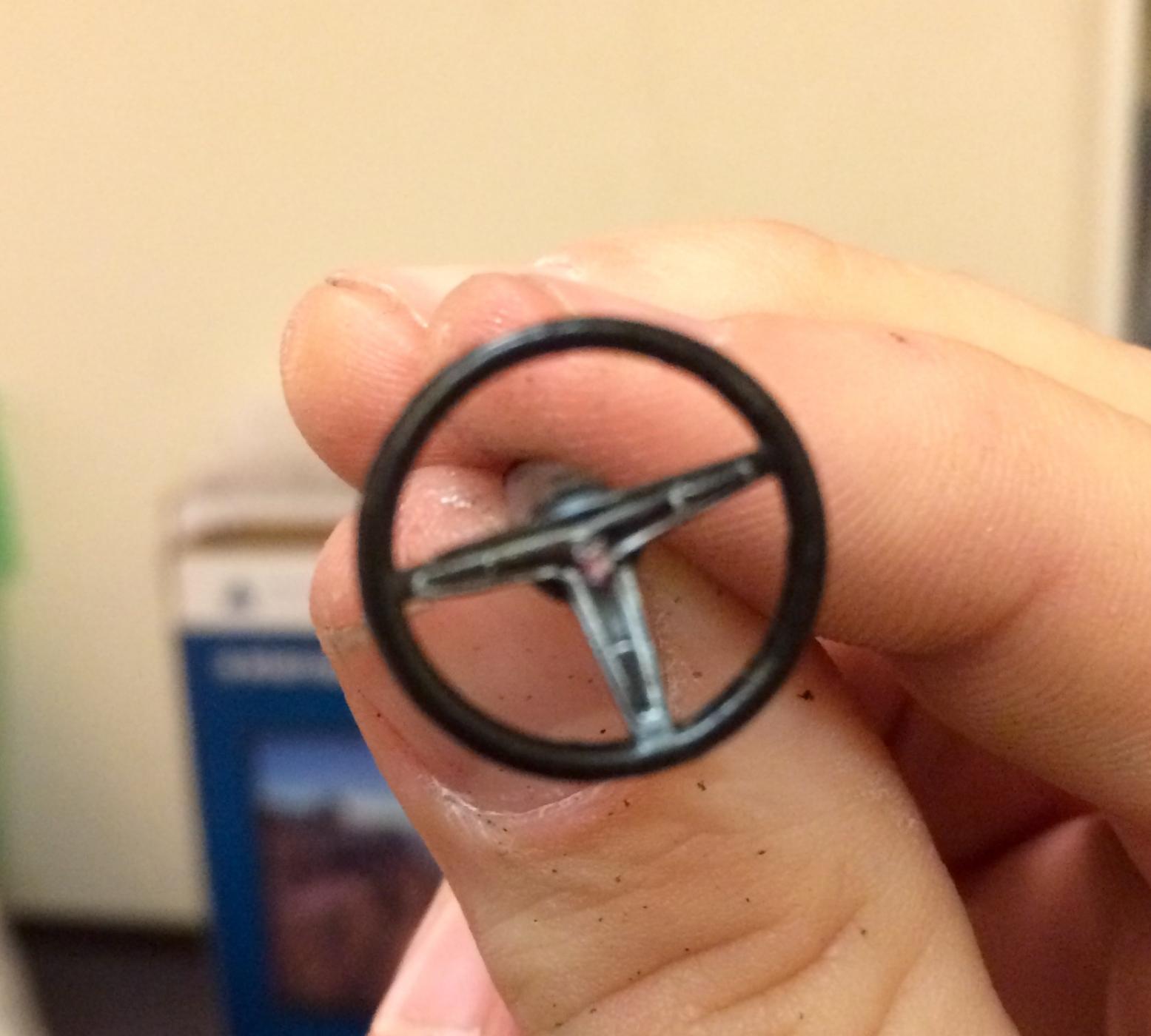

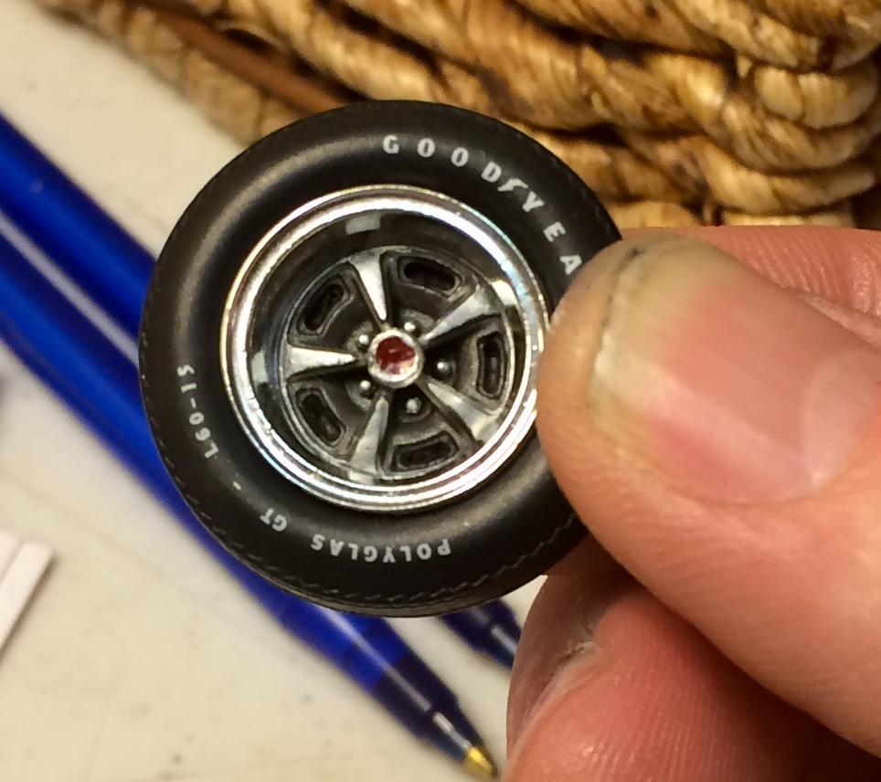

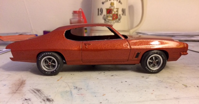

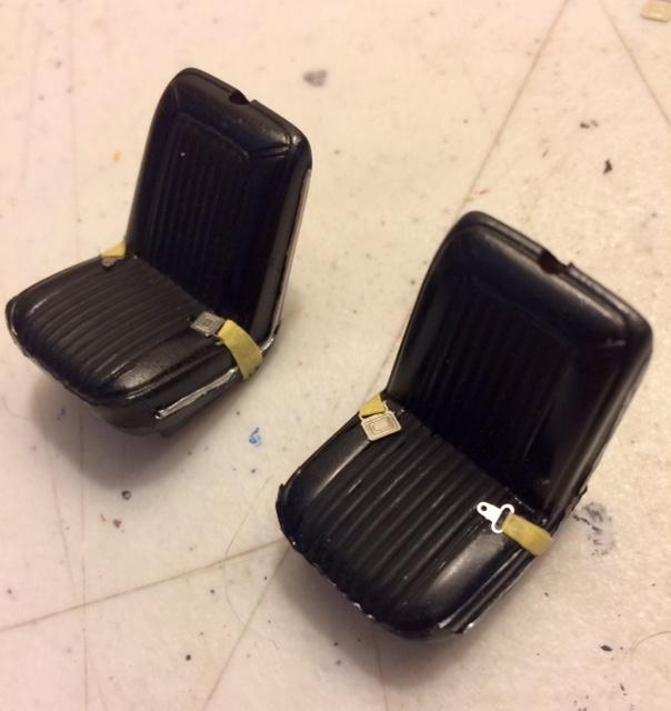

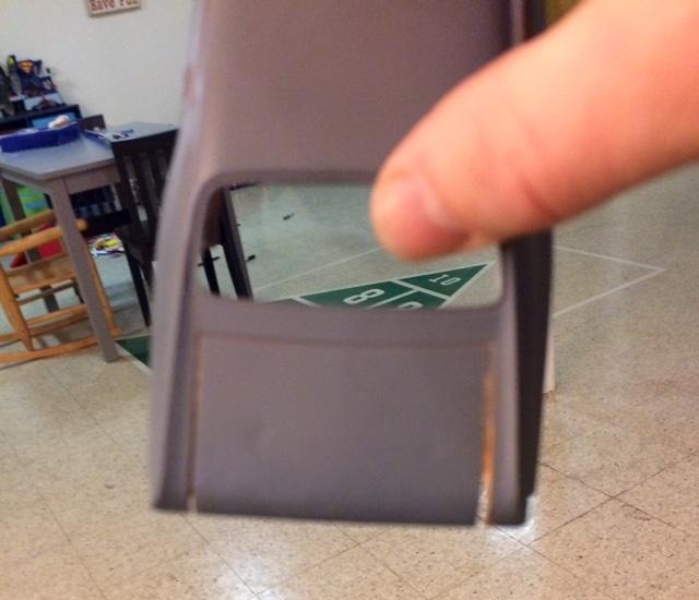

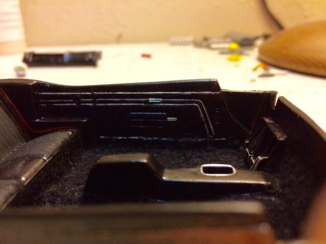

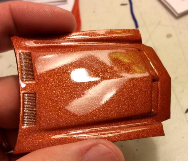

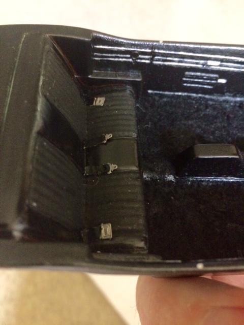

Kmb0319 Posted April 17, 2017 Author Posted April 17, 2017 (edited) Well, this has been sitting for a few months, but I got back on it last week and accomplished a little. I still have to purchase one of the Revell parts pack engines and probably some photo-etched interior details, but I got a few key things accomplished: This is a total experiment, but I thought I'd try. I glued a baby wipe into the roof to make a headliner, then trimmed around the edges: It's not perfectly clean, but my blade isn't sharp enough. For the bumper, I decided to try to the cut-the-trunk method. It will look a little wonky in the end, but the 70 GTO kits are getting really hard to find, and the cheapest I've seen is $65. So, I'll try this: Got the tailight trim painted and the lights installed, just need to paint the license plate frame and I can try to make it fit. Next, seatbelts. Rather than use the fabric belts, which are too wide for the openings in the photo-etched buckles, I cut some masking tape down, so I can run them through and fold over to actually have the buckles/clasps properly attached. Then I glue them down and paint the tape. Attached: And painted: Finally, I needed get paint on. I used Testors Fiery Orange Metallic one-coat lacquer... 3 coats. After wet sanding and compounding, I used the Mr. Hobby clear glaze... 3 coats again. I like the finish: Then I painted in the side vents and did the wash in the panel lines. This is the easiest kit I've ever done those on, as the lines are quite promient Finally, stuck the chassis and interior bucket into the body and put two of my wheels on to get a test stance: Lots more to do, but I'm glad to have finally made a little more progress. Edited October 11, 2017 by Kmb0319 Reduce attachments
