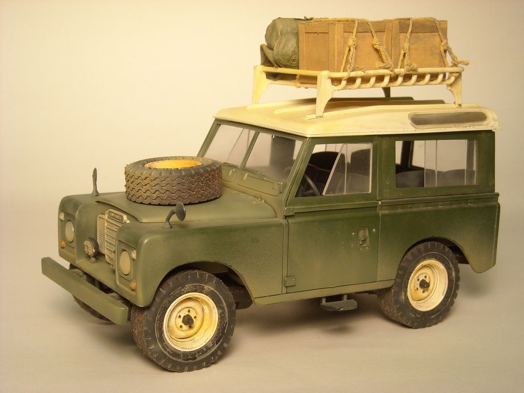

This is the Monogram kit. I picked it up at an auction for peanuts. Imagine my surprise when I saw what they sell for online!

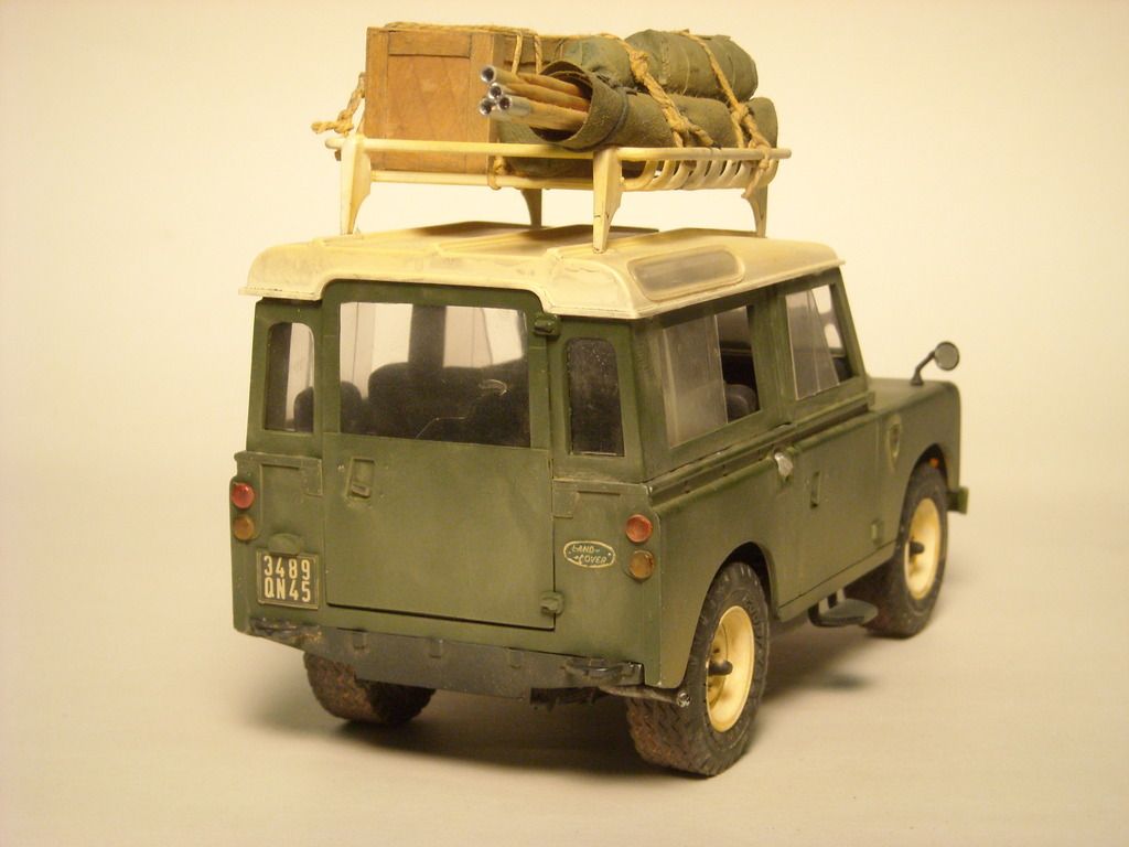

This is my first attempt at serious weathering. I was going for a dusty, "Africa" look.

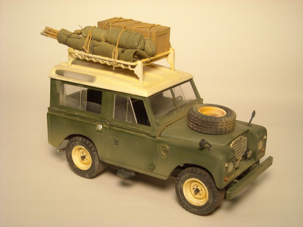

The "tent" is some toothpicks and a piece of an old bed sheet. The duffels and dry bag were molded out of Milliput, and covered with the same bed sheet. The crates are just blocks of wood with some strips of veneer for framing.

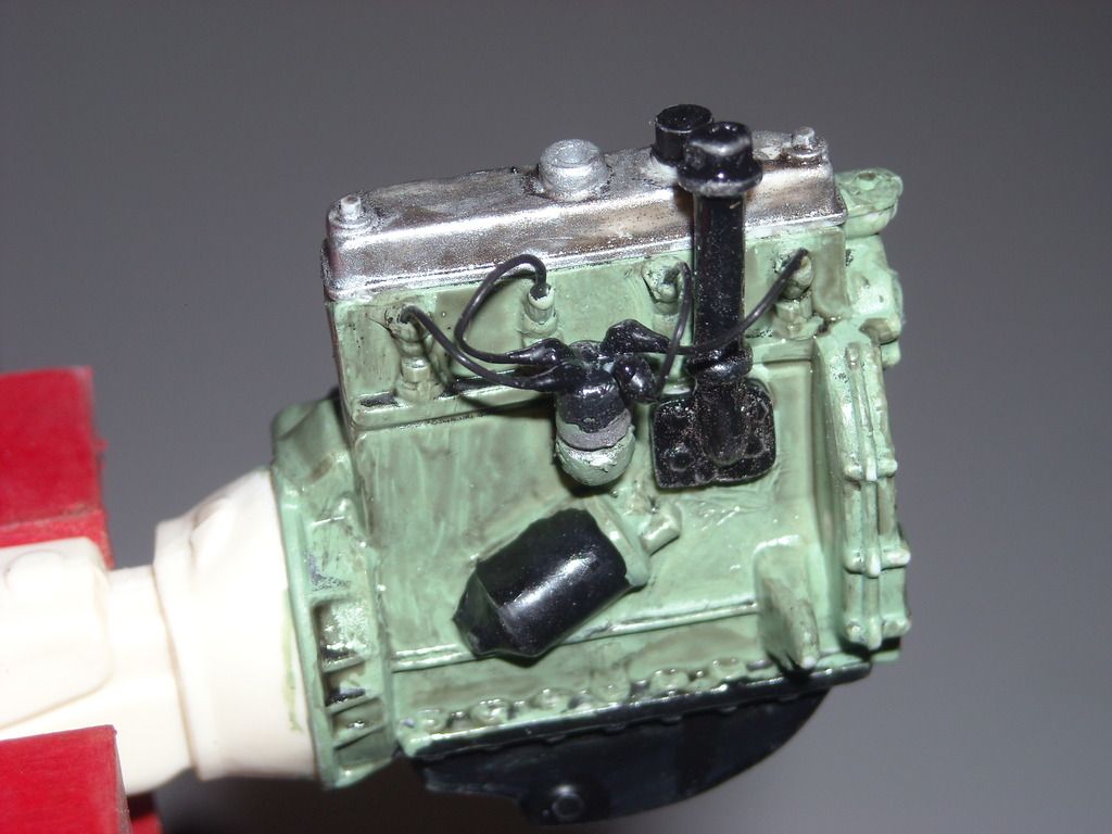

The only thing missing was a distributor, which I made. Overall, a really fun kit to build.

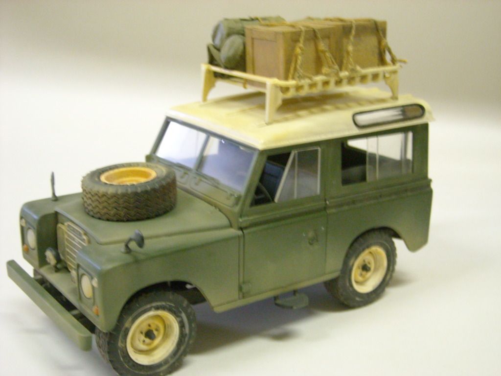

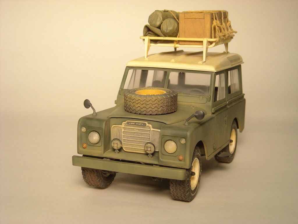

After looking at my photos, there was one area I was not happy with. So I popped out the "skylights", and painted the rubber gaskets around them.
This is where I am now.
Weathering looks perfect to me, wouldn't change a thing. I like how you created all of the roof cargo.
Thanks, David!  The kit came with that roof rack. I either had to leave it off or put something in it.:)
Thanks, JT!
Awesome weathering. What was your technique that you used, also what product?
Thanks, Scott!  Most of the dust is Testors paint, a mix of flat brown and flat white. It was very thin, and I set the airbrush so almost none came out. That way I could build it slowly, and add more in some areas than others. I also used a Vallejo gray wash, and little spots of Tamiya smoke. The final touches were done with ground up pastel powders.
FANTASTIC BUILD!!!!! Everything looks realistic!!, Wish I could find this kit........I have the Italeri kit, but its a long wheel base, and I need the short one like this. I suppose I could shorten it, but i'd much rather get the kit you built. Thanks for sharing!!
