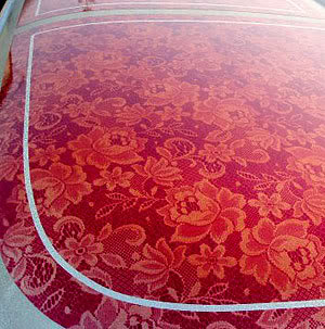

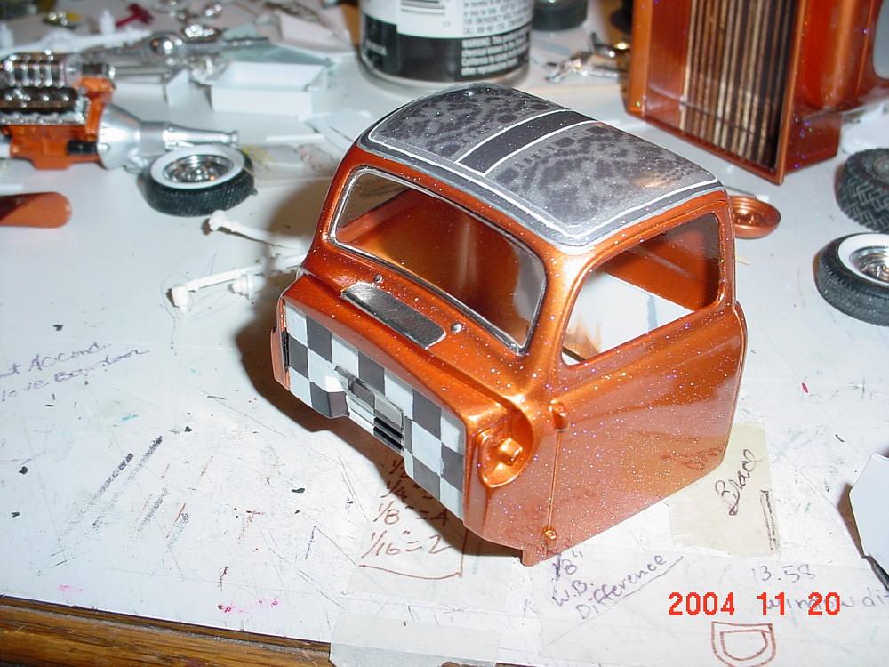

stitchdup Posted March 1, 2017 Posted March 1, 2017 I use actual lace, if you look in the fabric section of a store (if your lucky there will be loads of different designs) for lace ribbon it is what I use. Just mask off where you dont want lace, then place the lace over the top and tape down the edges, and just a couple of very light dust coats of the colour you want the lace should give you the effect you want. Just be sure to remove the lace as soon as it's done as it can leave bits behind in the paint if it dries. Thats how I did my caddy and vw van roofs (both on here somewhere)
Joe Handley Posted March 1, 2017 Author Posted March 1, 2017 How is it in scale though? That is my concern, I've thought of Doll House lace curtains, hoping they would be long enough (AMT '61 Ranchero side coves) and small enough to not look out of scale.
Snake45 Posted March 1, 2017 Posted March 1, 2017 Joe, I asked exactly the same question not long ago. Some good discussion on the topic here: As to your specific use on the side coves of '61 Ranchero, I'm working on that very kit at the moment and I think that would be tough to do, even in 1:1. The concavity would make it hard to get the lace to lie down flat. I believe in the real world, lace was usually done on flat or convex panels. The lace was just stretched tight and taped down at the edges and the paint shot at low pressure. I think maybe some painters would dampen the lace with water from a spray bottle to give it a little bit of "cling" before laying it on.
