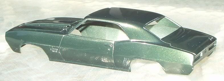

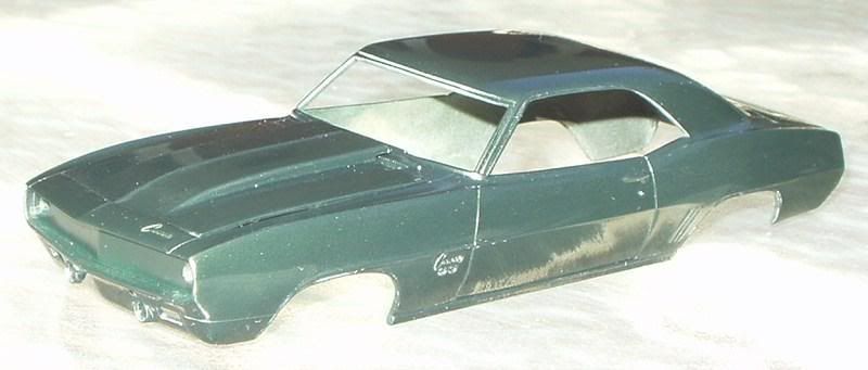

For example, here's a couple I used no clearcoat on, just rubbed out direct. I was going for a Day Two (factory finish) look on this MPC '69 Camaro, so I laid the Model Master Brit Green on as smoothly as I could (airbrush) and then gave it only a very LIGHT rubout, normally a no-no with metallic paint, but I thought I could get away with it. And I did. I deliberately left just a hint of "orange peel" for a factory look.

Dan, I'd love to hear your opinion of these.
Its hard to give you my opinion on the Camaro with all the residue left on it, but the Corvette to me doesn't look "out of scale" glossy to me. I think it looks pretty nice! All the seams look pretty crisp still, even with the slightly "fuzzy" photos.
Residue? I suspect what you're seeing is the reflection of the wavy-textured glass patio tabletop it's sitting on. :D
