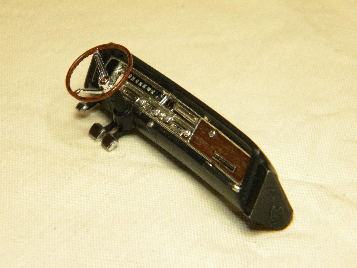

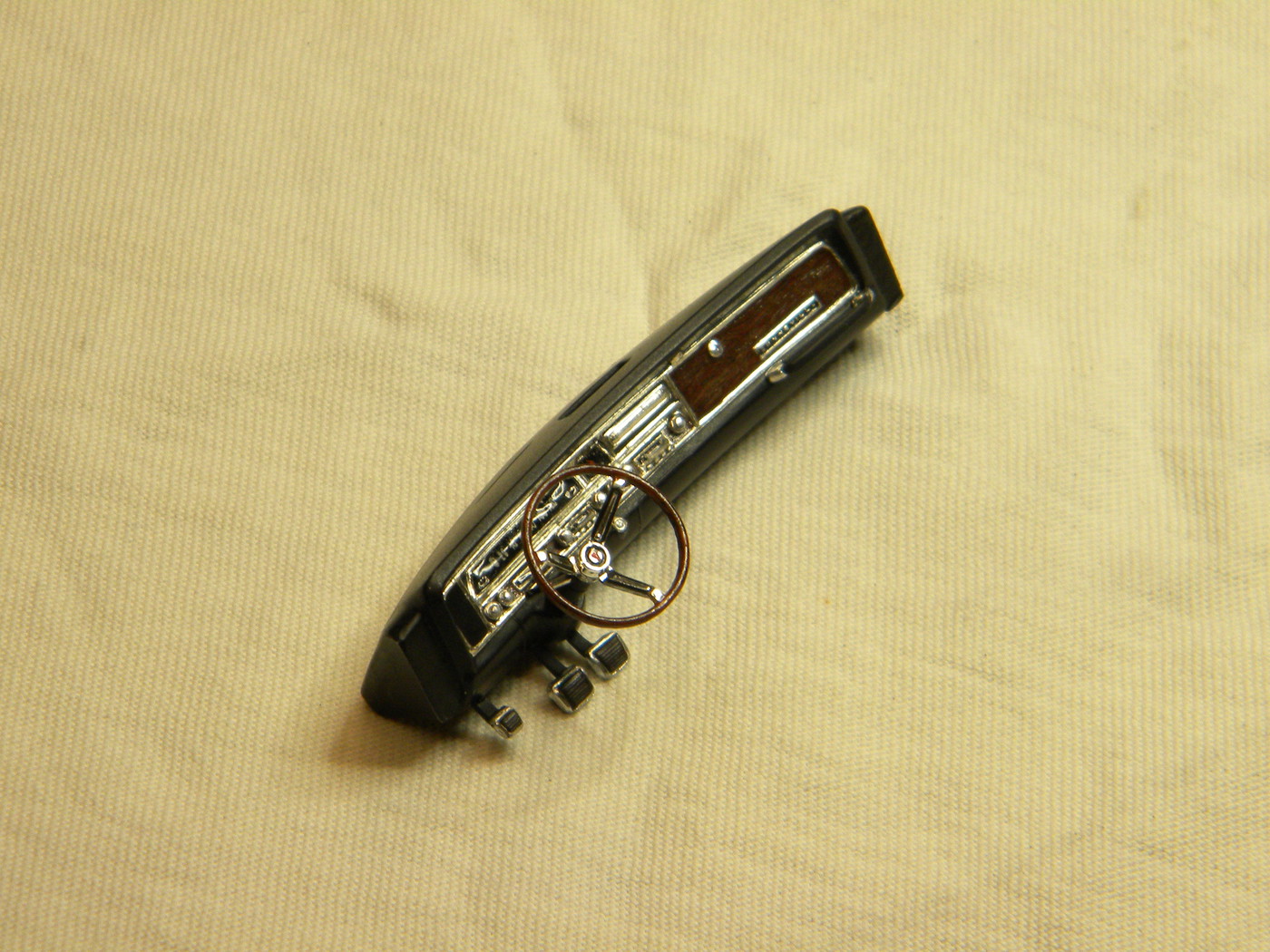

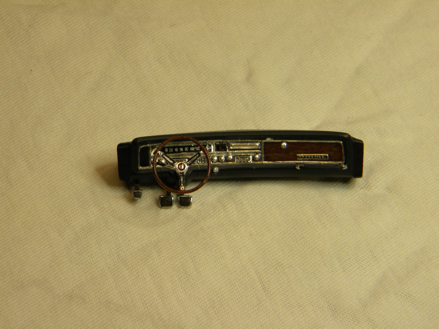

Slow progress continues.
The interior is getting very close to finished.
The dash is done!
I used parts from the Revell '66 GTO kit, including the steering wheel & column, grab bar & pedals.
All of the dash knobs were drilled out & replaced & the dash pad had a speaker grille & defroster vents added.
Hopefully the next update will be soon when the interior is complete.
Steve
Looks really good Steven, you're really going all out with this one.

That's pure magic Steven. That dash is like jewelry.
I was wondering what you use to mask your seats when you do a multicolored treatment?
Eric
Eric
Most of the time I just use Tamiya tape & occasionally a little BMF for the tough spots.
Steve

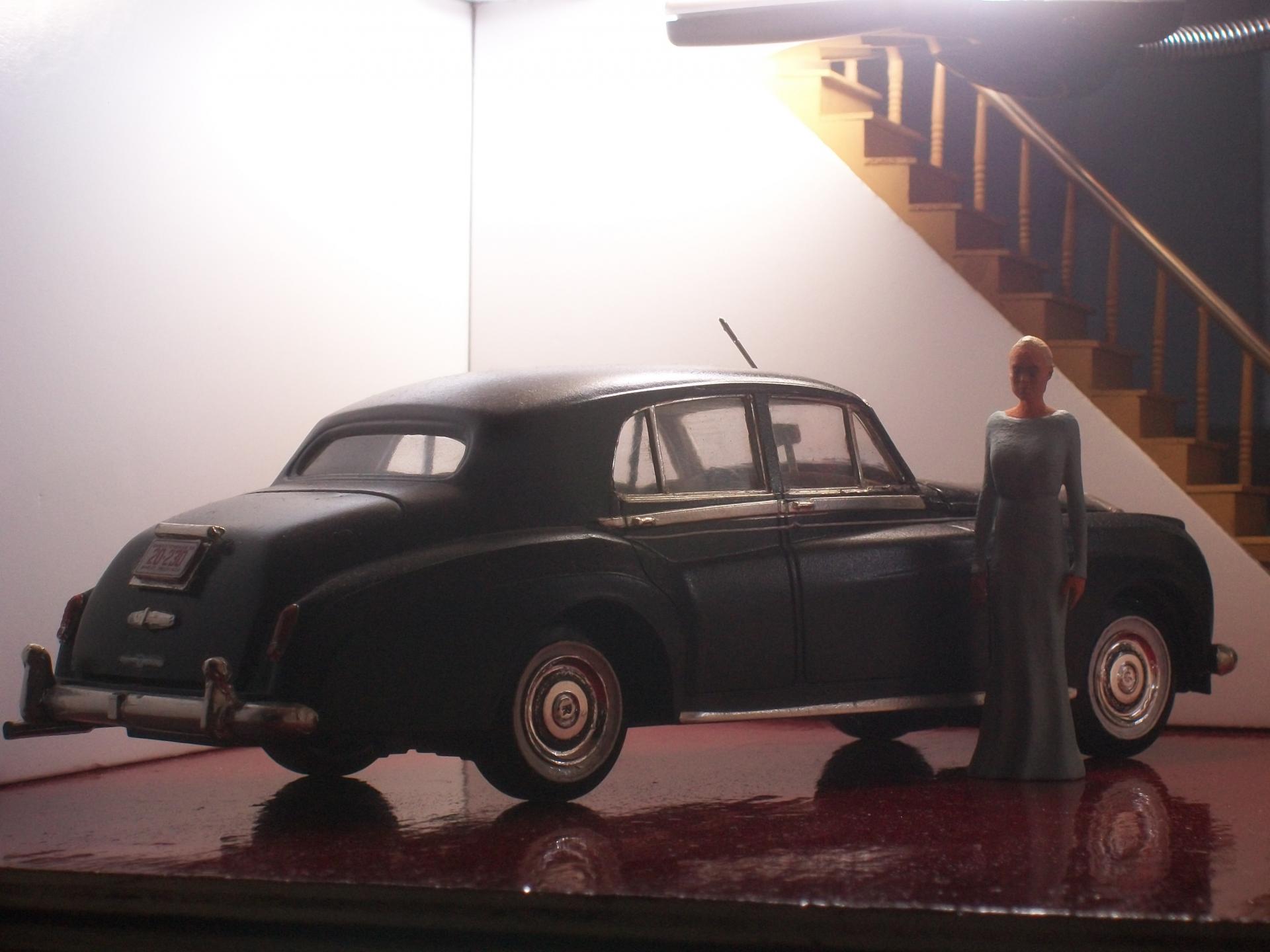

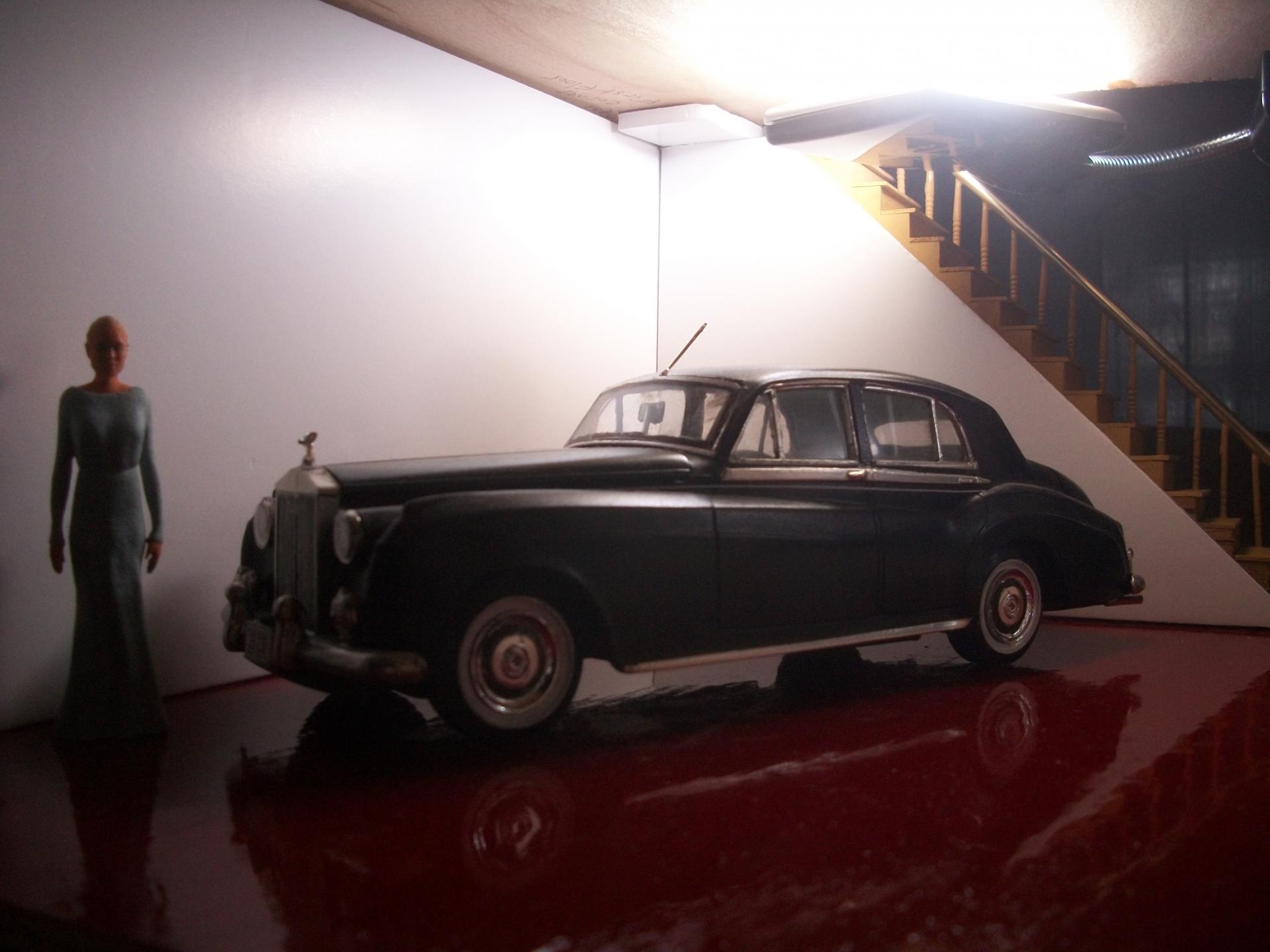

Thanks very much Steve, and I had a feeling the Bonneville kit was a rare one. The potential price of $200.00 is £150.00 GBP so it would take a brave man to have a go at a conversion that wasn't guaranteed to work!
I will have a look round for MPC kits from '67 and '68, while I am sourcing Rolls-Royce Silver Cloud kits from Minicraft, Entex, Academy, Masterkit and Revell, maybe try a few resin body shell producers. I have moulded and cast two body shells successfully so far for this car that is 1955 -1959 only.
I suppose the '66 GTO you mentioned is a different body altogether?
David

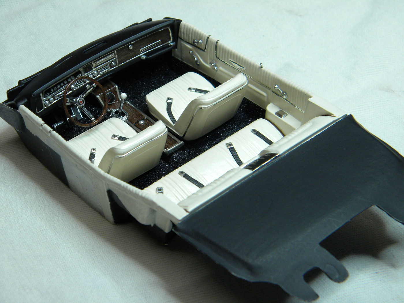

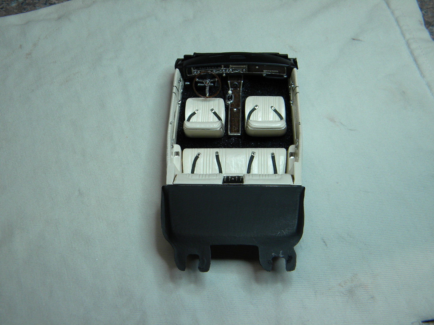

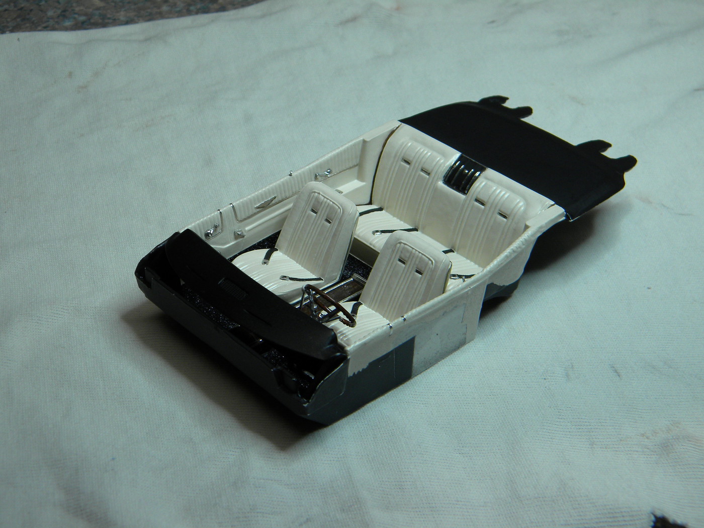

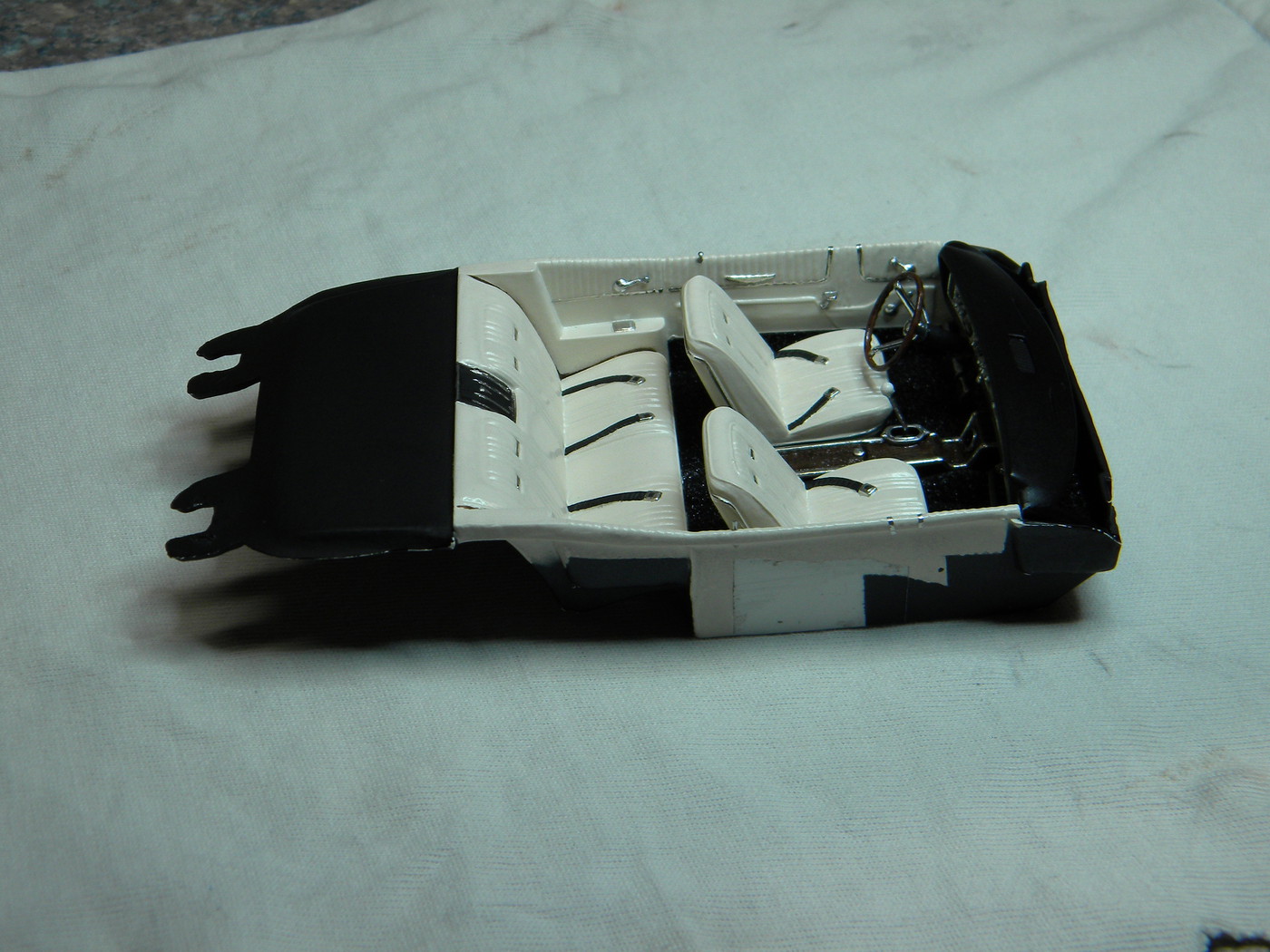

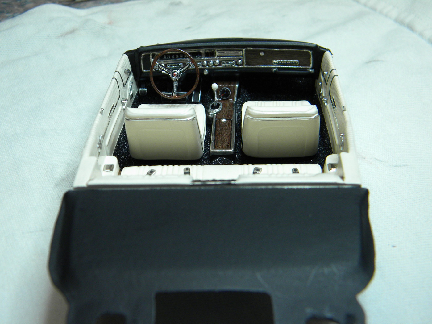

I've finally finished something on this project!
The interior modifications include:
The steering wheel, steering column, grab bar, & shifter gate section of the console came from the Revell '66 GTO kit.
The console mounted tach was swiped from an old Johan kit.
The dash pad was modified by adding a speaker grille & a pair of defroster vents.
The window cranks & door latches were cast from Laser Bond & chromed with Molotow pen.
Floors were covered with embossing powder & door lock buttons were added.
All dash knobs & locks were drilled out & replaced.
Other than that, it's all just paint & foil.
Steve

Fantastic result on your interior Steve and I bet you're really pleased with that. You can focus on other areas of the build now I guess. I am finding myself using the Molotow Liquid Chrome pen more than BMF these days, even though I am a firm believer in BMF.
David
David
Thank you David.
I only use the pens where it's not practical to use foil.
I still have reservations about the durability of the Molotow ink.
Steve

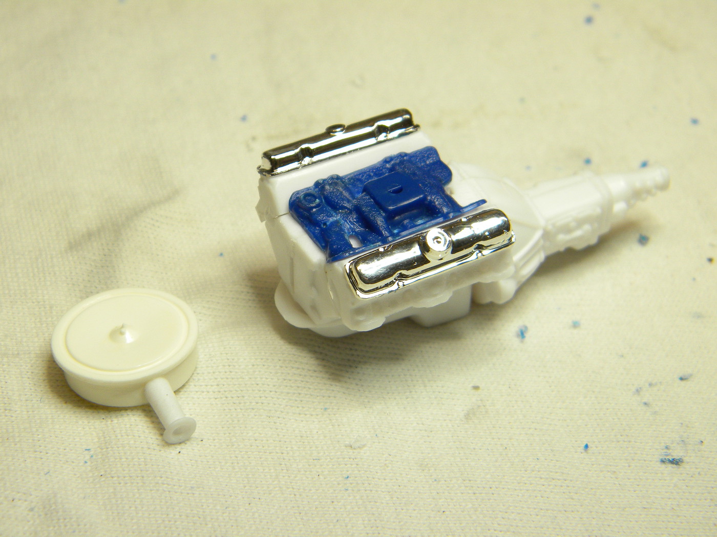

I think that I have the engine figured out.
I'm using the Revell '66 GTO basic engine assembly with the intake & valve covers from the MPC '69 Firebird kit.
The air cleaner is an old annual kit piece from "who knows where" with a scratch made snorkel.
Just need to find a half way decent carb.
Steve
